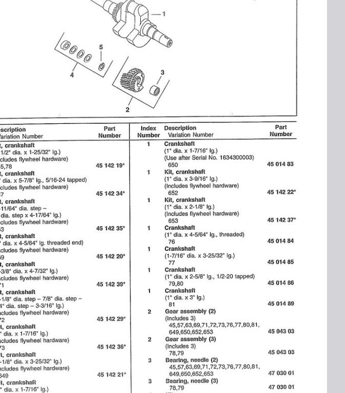

WHX?? 58,290 #29 Posted December 22, 2024 Question here ... how does one know if a motor has got them in or not without opening ... year, serial no or spec?? Do all magnums have them? 1 Share this post Link to post Share on other sites
ebinmaine 80,881 #30 Posted December 22, 2024 7 minutes ago, WHX?? said: Question here ... how does one know if a motor has got them in or not without opening ... year, serial no or spec?? Do all magnums have them? My understanding is that some early 10 HP did not... All other K Series do. Magnum.... ?? @kpinnc @Pullstart 1 Share this post Link to post Share on other sites
Bar Nuthin 3,339 #31 Posted December 22, 2024 (edited) 21 minutes ago, WHX?? said: Question here ... how does one know if a motor has got them in or not without opening ... year, serial no or spec?? To expand on this question - Is there any way to know if they've been previously removed without pulling the pan? I'm guessing not, unless you have an expert ear maybe. My K301 has a 0.20 over piston, so someone has had it apart. Don't know if they had the sense to pull the balance gears. Does it make sense to pull a good running engine to remove them, or better to leave it alone? Edited December 22, 2024 by Bar Nuthin 1 Share this post Link to post Share on other sites
RED-Z06 2,720 #32 Posted December 22, 2024 I pulled them out of my M12 because i had noise, it shook so badly afterwards I really didnt use it much, some remove them and have no vibration. 2 Share this post Link to post Share on other sites
pfrederi 21,215 #33 Posted December 22, 2024 (edited) 2 hours ago, WHX?? said: Question here ... how does one know if a motor has got them in or not without opening ... year, serial no or spec?? Do all magnums have them? Quick look at Magnum 16. That list of variations that have the gears must be over 98% of all of them Edited December 22, 2024 by pfrederi 1 Share this post Link to post Share on other sites
WHX?? 58,290 #34 Posted December 22, 2024 1 hour ago, Bar Nuthin said: any way to know if they've been previously removed without pulling the pan Look down the oil fill with a bore scope of sorts??? 1 hour ago, Bar Nuthin said: pull a good running engine to remove them, Another million dollar ? I vote leave them in unless a noise. But then again they could go at any time with out a notable noise. . We've had this discussion before and I think the general consensus was pull the motor and just do it. A motor @Achto put on his puller we pulled them out. Didn't hear the motor run before hand but the needles looked shaky when out. 20 minutes ago, pfrederi said: variations that have the gears Run the spec number then is what your saying. I would agree. I posted this in another thread but worth repeating here. https://origin.kohlerenginesparts.com/oemparts/c/kohler_engines_k_series_k91_662_kt17_21/parts https://origin.kohlerenginesparts.com/oemparts/c/kohler_engines_magnum_m_mv8_20/parts 4 Share this post Link to post Share on other sites
Lagersolut 806 #35 Posted December 22, 2024 2 hours ago, RED-Z06 said: I pulled them out of my M12 because i had noise, it shook so badly afterwards I really didnt use it much, some remove them and have no vibration. This is why I'm nervous pulling them out of my 416 - it's a perfectly running K341 with no noise - other side if they let loose 99% chance its a boat anchor 2 Share this post Link to post Share on other sites
ebinmaine 80,881 #36 Posted December 22, 2024 2 hours ago, Bar Nuthin said: Does it make sense to pull a good running engine to remove them, or better to leave it alone? 17 minutes ago, WHX?? said: We've had this discussion before and I think the general consensus was pull the motor and just do it. IMHO.... Get em OUT while you can. It's a good running engine. Keep it that way!! 4 Share this post Link to post Share on other sites
squonk 48,207 #37 Posted December 22, 2024 My K321 in my 953 was rebuilt by Richmond Red. There is more vibration in it than my 321 on my Power King and my 341 on my C160. I wear Mecanixwear impact gloves and the vibration doesn't bother me From Miller's site: Various Kohler engine models K241, M10, K301, M12, K321, M14, K341, M16 and K361 use a Dynamic Balance System, which are two out-of-balance gears that rotate on stub shafts that's pressed into the PTO side of the engine block. These counterbalance gears rotate in opposite direction of the crankshaft. These gears reduce the rotating side thrust (vibrating affect) of the crankshaft. Most Kohler K-series K241 and Magnum M10 engines came from the factory without balance gears. Only thirteen K241 engines came from Kohler with balance gears installed. These engines have the specification numbers: 46578, 46634; (Allis Chalmers); 46590 (Yazoo); 46593, 46608, 46633 (John Deere); 46664, 46718, 46764, 46803 (Simplicity); 46809, 46810 (Grainger); and 46838 (Ingersoll Rand). And only four M10 engines came from Kohler with balance gears installed. These engines have the specification numbers: 461509 (Ingersoll Equipment); 461513, 461526, 461550, 461551 (Ingersoll Rand); 461534 (Cub Cadet); and 461543 (Compair Kellogg). All other specification numbers for the K241 and M10 engines have no balance gears. However, if your engine vibrates a lot, it should to be dynamically and precision spin-balanced. But most K241 and M10 engines (without balance gears) run smoothly from the factory without balance gears originally installed 3 Share this post Link to post Share on other sites

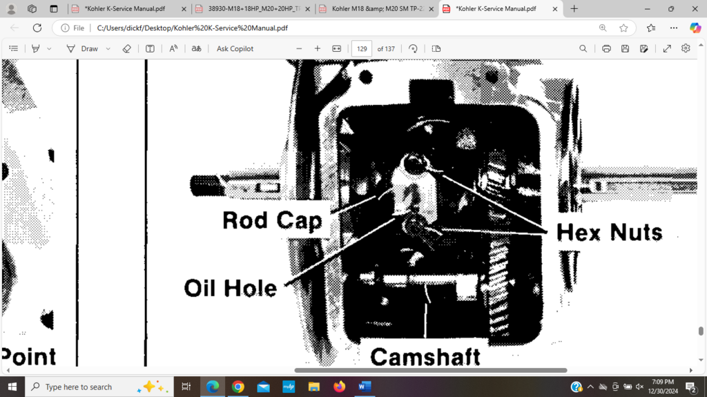

fourwheelhorseman 362 #45 Posted December 30, 2024 Hey would anyone have a link to the kohler k341 manual on here? I can’t seem to find it. I’m looking at proper piston and rod orientation when I rebuild this week. 1 Share this post Link to post Share on other sites
ebinmaine 80,881 #46 Posted December 30, 2024 2 minutes ago, fourwheelhorseman said: Hey would anyone have a link to the kohler k341 manual on here? I can’t seem to find it. I’m looking at proper piston and rod orientation when I rebuild this week. @gwest_ca. ? 1 Share this post Link to post Share on other sites
fourwheelhorseman 362 #48 Posted December 30, 2024 13 minutes ago, pfrederi said: Man that was fast! Thank you Sir! 1 Share this post Link to post Share on other sites
WHX?? 58,290 #49 Posted December 30, 2024 2 hours ago, fourwheelhorseman said: proper piston and rod orientation If using old piston I put witness marks on so it goe's back it the way it was. Hole in big end of rod must face the camshaft. 1 1 Share this post Link to post Share on other sites
953 nut 69,724 #50 Posted December 31, 2024 53 minutes ago, WHX?? said: Hole in big end of rod must face the camshaft. That is the Holey Grail of Kohler engine assembly, get that wrong and the rod won't last five minutes. 2 Share this post Link to post Share on other sites
