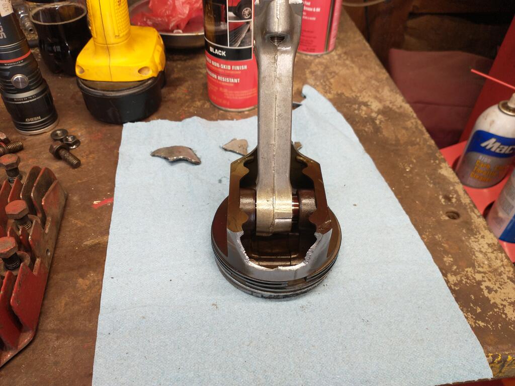

squonk 48,207 #21 Posted December 16, 2024 When the rod breaks near the piston, quite often the engine is salvageable. When the rod ruins the crank is where cost and parts availability become a problem. 2 Share this post Link to post Share on other sites

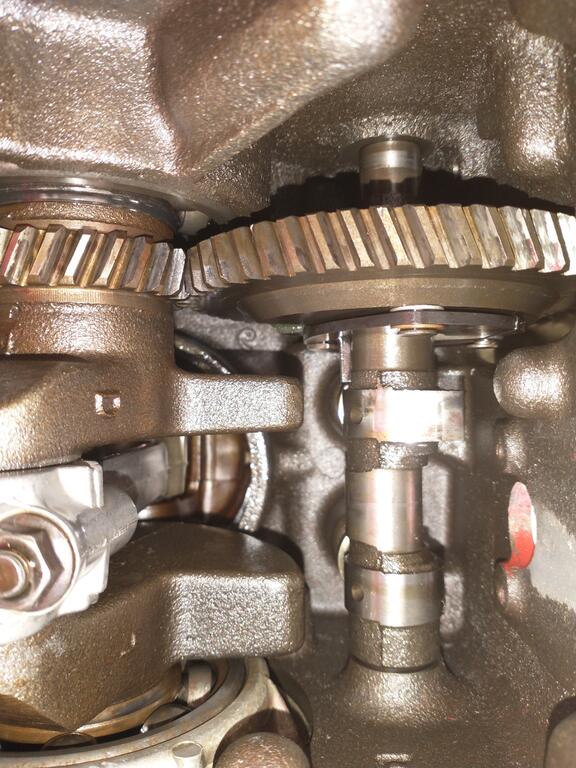

squonk 48,207 #23 Posted December 16, 2024 This K341 was running with a small strange noise. I pulled the engine and tossed in a spare. When I got this engine years ago it smoked and the oil was like coal. Kept changing it and it cleaned up. Ran it for like 8 years before I decided the noise was enough of a concern. I have no idea how long the piston was broke. 3 1 Share this post Link to post Share on other sites

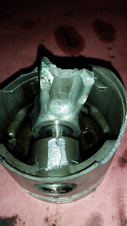

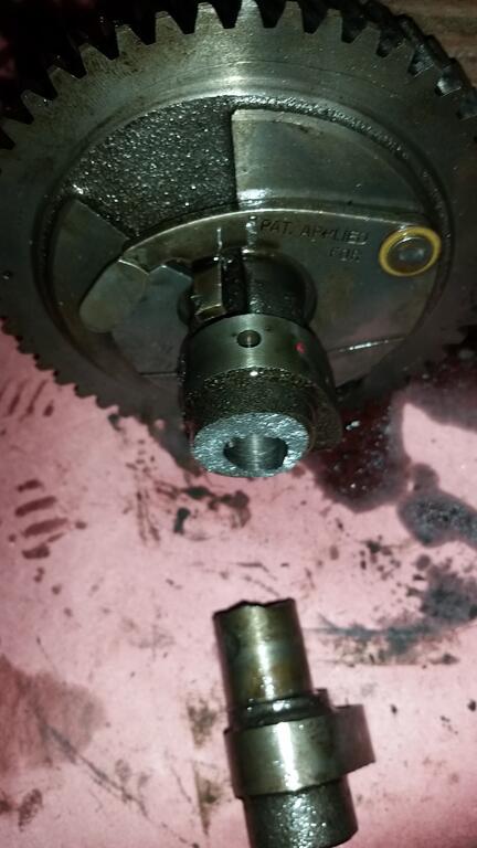

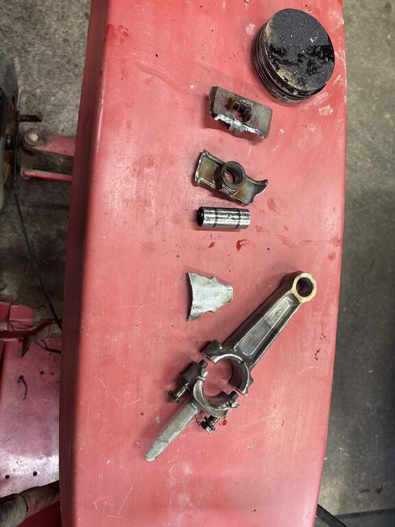

fourwheelhorseman 362 #24 Posted December 21, 2024 Well, those balance gears struck again! It would appear that the upper balance gear, closest to the piston skirt actually came into contact with the skirt and busted it. The last tooth on the balance gear is missing, so that’s why I say this. Anywho here are some photos. The connecting rod is fine, the bore is fine and the crank is as well.. I’m pretty fortunate, all I need is a rod a piston and a set of rings as well as an oil pan gasket and I’ll be back in business! Btw .. I removed the balance gears by tapping the rod inward and then replacing the rod. IMG_2877.mov 6 Share this post Link to post Share on other sites
RED-Z06 2,720 #25 Posted December 21, 2024 4 minutes ago, fourwheelhorseman said: Well, those balance gears struck again! It would appear that the upper balance gear, closest to the piston skirt actually came into contact with the skirt and busted it. The last tooth on the balance gear is missing, so that’s why I say this. Anywho here are some photos. The connecting rod is fine, the bore is fine and the crank is as well.. I’m pretty fortunate, all I need is a rod a piston and a set of rings as well as an oil pan gasket and I’ll be back in business! Btw .. I removed the balance gears by tapping the rod inward and then replacing the rod. IMG_2877.mov Makes sense, it didnt have the earmark symptoms for a rod, they usually let you know. 2 Share this post Link to post Share on other sites
