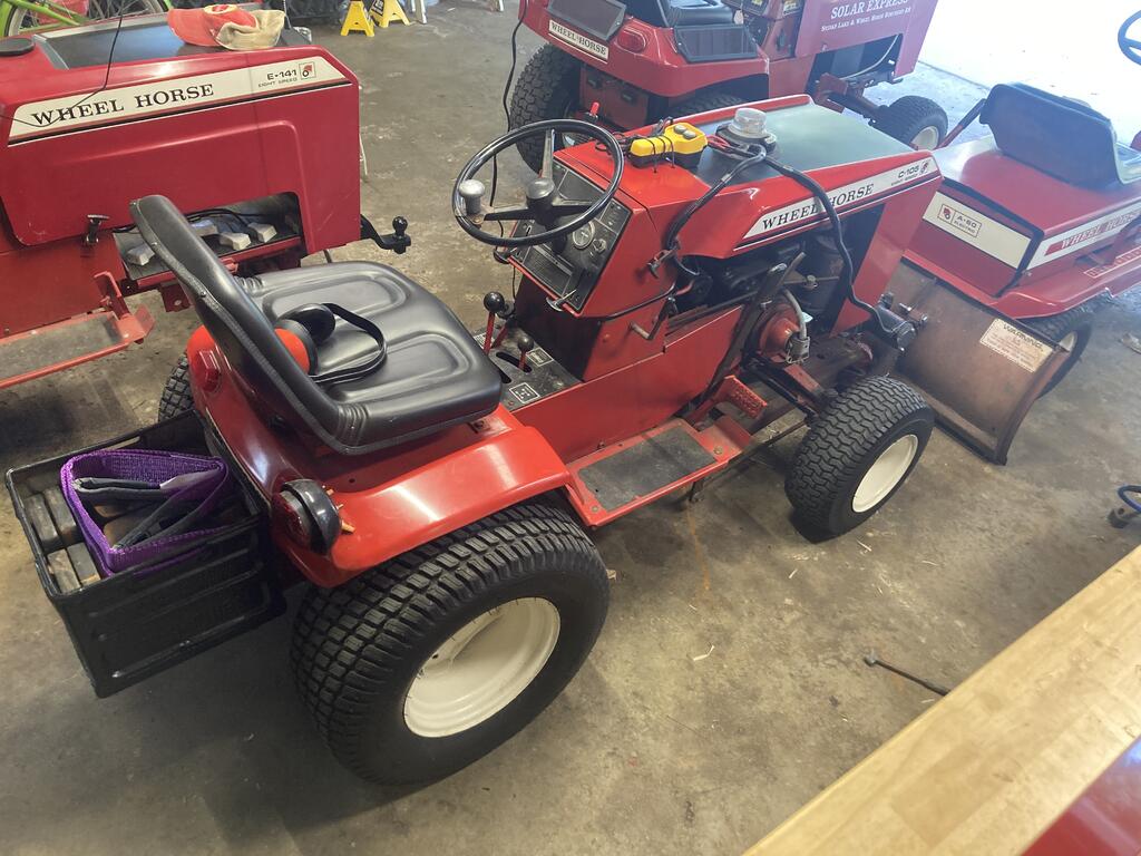

Achto 32,964 #14 Posted September 15, 2024 You already have a hydro pump on the tractor for the drive. I would just gather the parts to add the lift. Don't really need a new rock shaft, you can cut the lift handle off and add a piece of metal to the bottom of it for the ram. Will try to get better picture later, but this is how it was done on my Raider. 3 5 1 Share this post Link to post Share on other sites

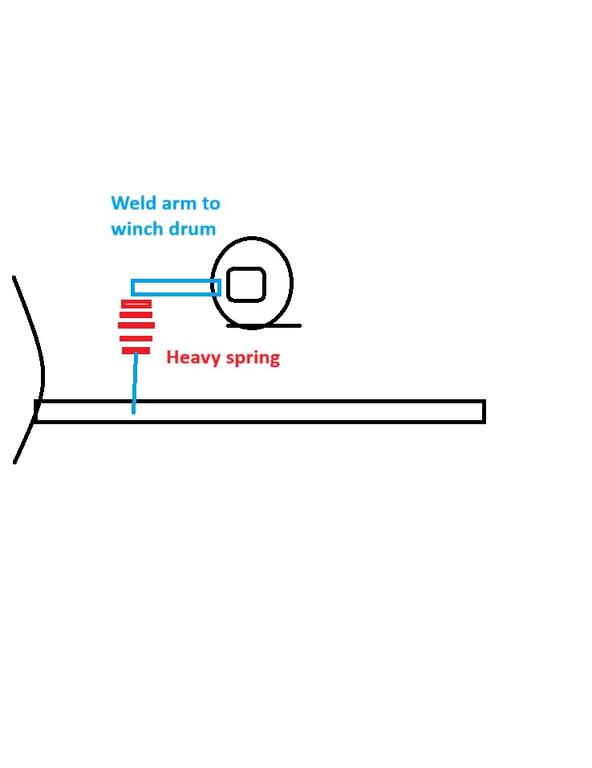

wallfish 20,744 #23 Posted September 18, 2024 Throw this into the mix for faster winch lifting. 4 1 Share this post Link to post Share on other sites
