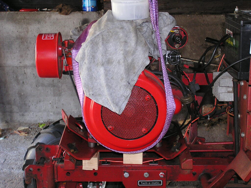

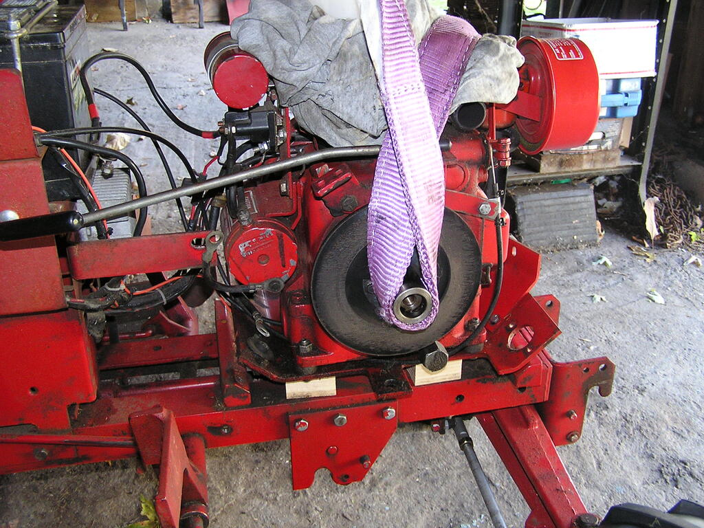

ri702bill 12,495 #3 Posted August 12, 2024 (edited) Yes, there is one vendor on the "Bay site that sells a nice set of CNC'd aluminum solid mounts for about $60 USD. I purchased a lightly used set from an RS member and installed them on my C81 8 speed. No more shake, and NO more engine twist with the PTO engaged. A true drop-in replacement. Requires lifting the engine and loosening up the rear triangilar frame block to get all 4 in at once... Some folks opt for tubular spacers instead. Edited August 12, 2024 by ri702bill 2 Share this post Link to post Share on other sites
