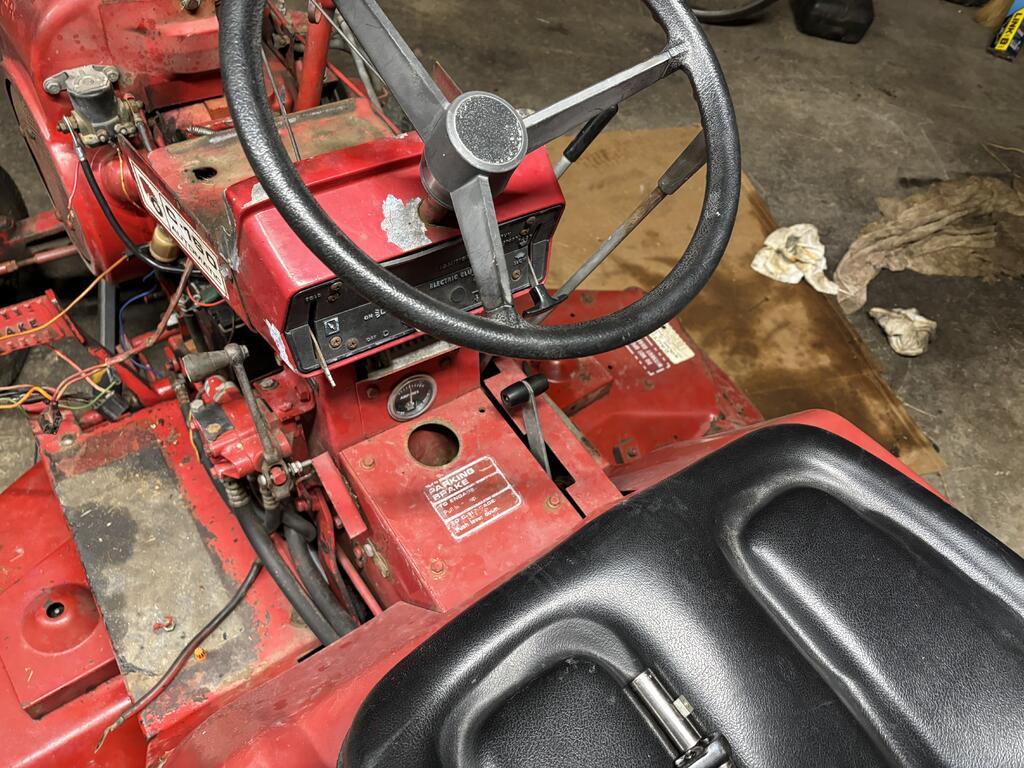

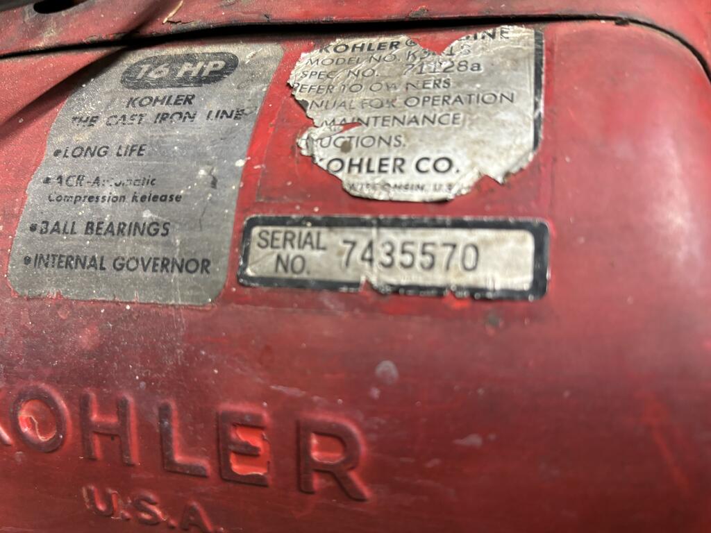

fourwheelhorseman 362 #27 Posted August 8, 2024 So here’s some more pictures, the engine is a 1976, I’m not sure of the tractor itself. I’m in the process of rewiring it, when I get my volt meter and new ignition switch I’ll go at it till I’m done. 1 Share this post Link to post Share on other sites
ebinmaine 79,491 #28 Posted August 8, 2024 20 minutes ago, fourwheelhorseman said: How do I become a supporting member? And that’s the plug that goes to my ignition switch. I should have stated that originally. Your name looks great in red!! That plug itself looks OK but the wiring colors, I'm not so sure. 2 Share this post Link to post Share on other sites

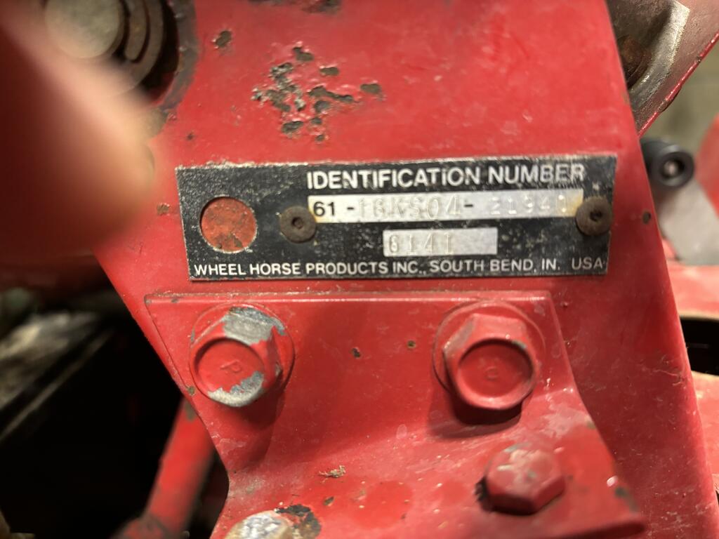

ebinmaine 79,491 #29 Posted August 8, 2024 12 minutes ago, fourwheelhorseman said: So here’s some more pictures, the engine is a 1976, I’m not sure of the tractor itself. I can't see that ID number very well but if you search that at the top of the page you may find more info. Share this post Link to post Share on other sites
fourwheelhorseman 362 #30 Posted August 8, 2024 Here’s the number, 16KS04-21941 2 Share this post Link to post Share on other sites
fourwheelhorseman 362 #31 Posted August 8, 2024 So I found from my search that’s it’s a 1976 c160 auto, so now I need a simple, descent wiring harness diagram for it. I’m pretty sure I have an idea of how it gets rewired, but a good diagram would for sure help. Google Search shows a few, but am unsure of the model/year of the models covered. 1 Share this post Link to post Share on other sites

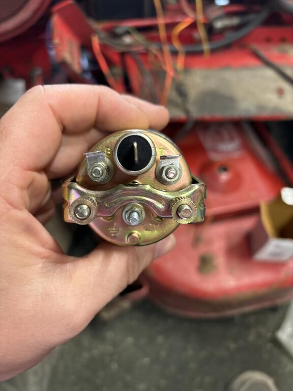

fourwheelhorseman 362 #39 Posted August 8, 2024 So, in looking at my volt meter, the middle blade is hot and the bolt is the ground I assume? Share this post Link to post Share on other sites
ebinmaine 79,491 #40 Posted August 8, 2024 1 minute ago, fourwheelhorseman said: So, in looking at my volt meter, the middle blade is hot and the bolt is the ground I assume? The lower bolt has a ground symbol next to it so that's correct. The upper blade though... Do you have an instruction sheet? I see a "B" and an "I" next to the terminals. Share this post Link to post Share on other sites
fourwheelhorseman 362 #41 Posted August 9, 2024 So there is no directions AND it’s a cheap Chinese peice of crap… ya buy Chinese junk ya get Chinese junk!!! I spent 2 hours fighting that volt meter, it fit perfect in the hole, when it came with these cheap aluminum thumb screws that would never tightened up, so I replaced them some correct threaded nuts. When I tightened the nuts, the one tightened perfectly, the other stripped and then stripped the post inside the housing…it was stuck inside the hole until i managed to retrieve it…. errggh!!!!!! So I’m going to use my old ammeter after all. I am however going to put a fuse block in between my battery and the ignition switch to protect the wiring this time. I did however manage to change out the ignition switch that seems fine. I’ll work on it tomorrow, my problem is TIME, I simply don’t have the time I used to for these hobby/ projects! Even on the weekends things just seem to pop up out of no where and there goes my whole day!!! ok enough venting!! I’ll post tomorrow… thanks for all the replies and help! Beleive it or not this is hobby is great therapy!! Share this post Link to post Share on other sites

Handy Don 16,907 #43 Posted August 9, 2024 I suspect you have an illuminated gauge. The separate B and T terminals are likely for the metering and for the internal lamp. But which is which? BeaTs me. 😬 1 Share this post Link to post Share on other sites
