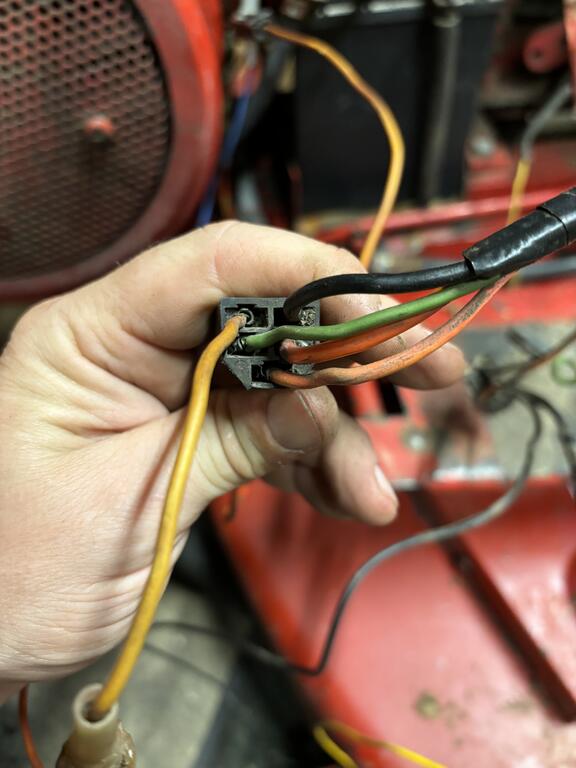

fourwheelhorseman 362 #21 Posted August 8, 2024 So, according to the wiring diagram that has been provided for a. 1976 c160, this plug is wrong.. unless I’m missing something? I can post a certain amount of photos, but ill post what I can. Thanks in advance! Share this post Link to post Share on other sites

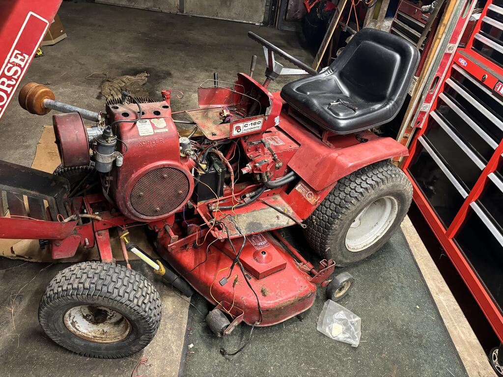

fourwheelhorseman 362 #22 Posted August 8, 2024 Here she is in all her unwired glory! 2 1 Share this post Link to post Share on other sites
ebinmaine 80,078 #23 Posted August 8, 2024 4 minutes ago, fourwheelhorseman said: I can post a certain amount of photos If you become a Supporter you can post all of em. You can also downsize your pics. (I don't know how).... What's that plug for? Share this post Link to post Share on other sites
fourwheelhorseman 362 #24 Posted August 8, 2024 27 minutes ago, ebinmaine said: If you become a Supporter you can post all of em. You can also downsize your pics. (I don't know how).... What's that plug for? How do I become a supporting member? And that’s the plug that goes to my ignition switch. I should have stated that originally. 2 Share this post Link to post Share on other sites
