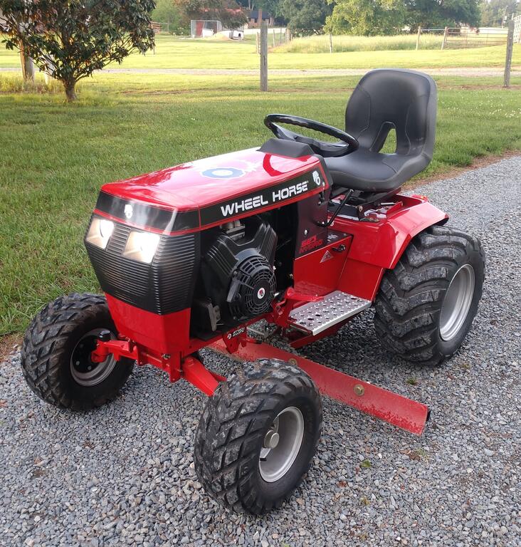

RGK 7 #11 Posted May 24, 2024 I put a cheap set of LED’s on my 856. Wired directly to the original light switch. They work perfectly. They are small and I think they go well with the tractor. 3 Share this post Link to post Share on other sites
Sparky-(Admin) 26,185 #12 Posted May 24, 2024 8 hours ago, RGK said: I put a cheap set of LED’s on my 856. They are small and I think they go well with the tractor. Were the housings red? Or did you paint them? Share this post Link to post Share on other sites
RGK 7 #13 Posted May 28, 2024 I painted them. They were black. 1 Share this post Link to post Share on other sites
