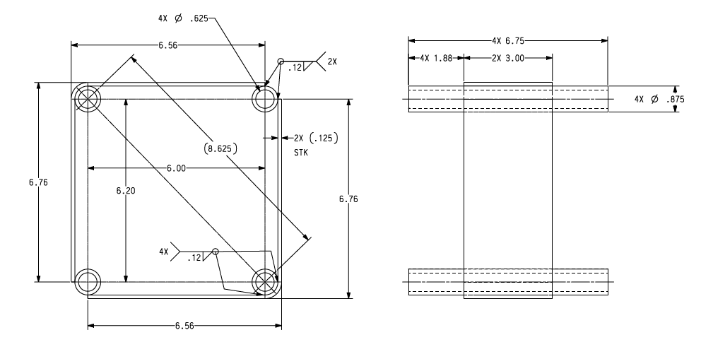

Keaton 466 #1 Posted February 29, 2024 i want to put duals on my wheel horse 701 so i can get a plow and pull it, i am not shure what do , i found a kit for $130 it has a big ring and come long bolts. bit could i make something, i think i can get a second set of tires, but what do i do to tie the togher? any ideas will help, thanks Share this post Link to post Share on other sites

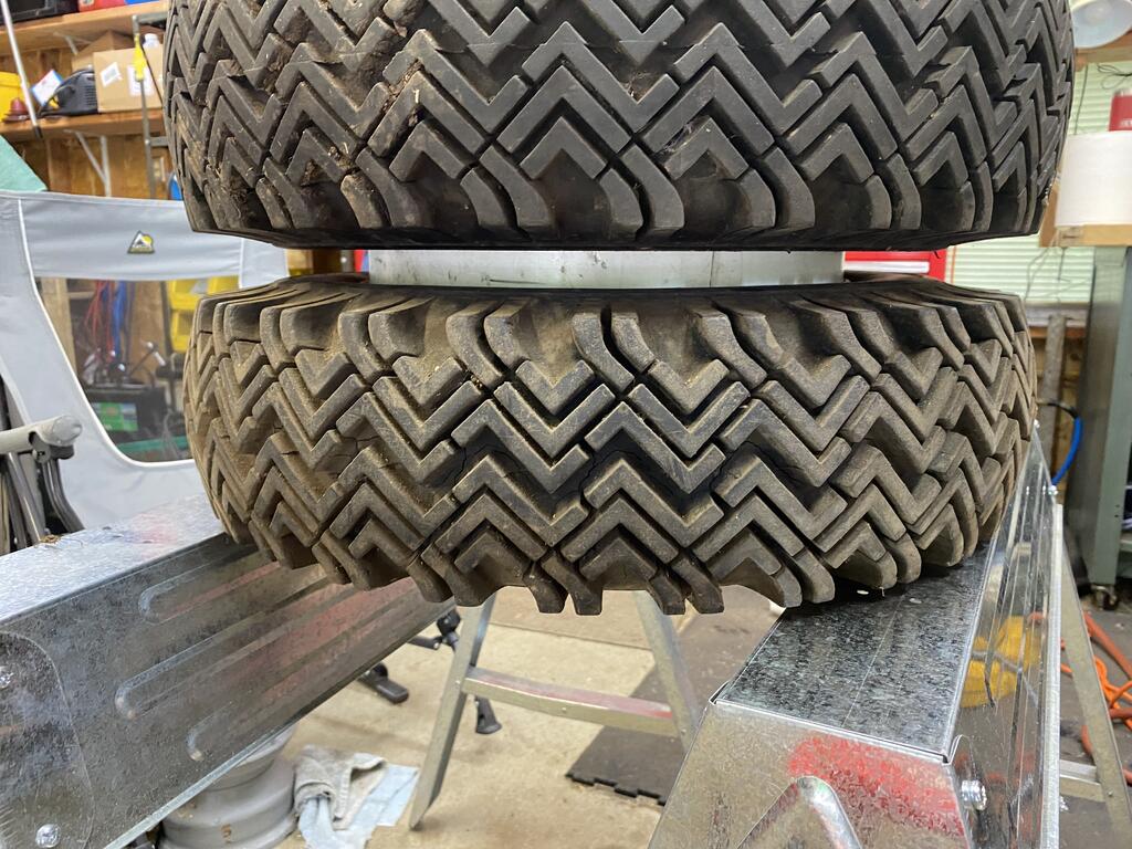

JoeM 9,330 #2 Posted February 29, 2024 I had an issue trying to use the ring type where the tire were to close together. I figure on your 701 those would work fine. I like the style shown myself. 3 Share this post Link to post Share on other sites
ri702bill 10,801 #3 Posted February 29, 2024 A note of caution - you probably still have the 3-of-5 cast iron rear hubs. They are rather delicate and with the added side load may fail. You may wish to consider upgrading to the 854 or 855 style full circle 5 bolt hubs. And be sure to add a second lock screw at 90 degrees to the original if it has only one.... 2 Share this post Link to post Share on other sites

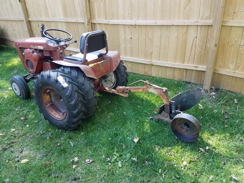

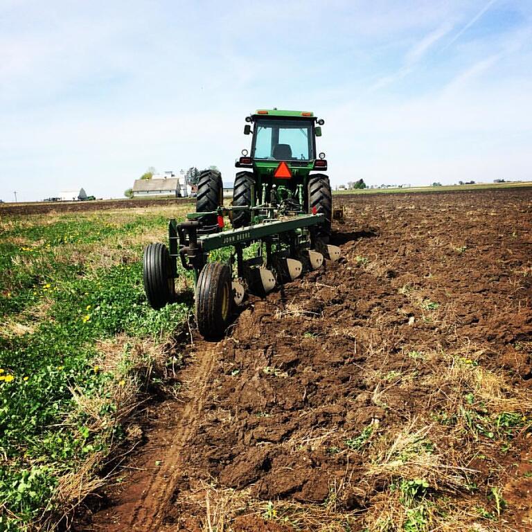

Achto 30,310 #5 Posted February 29, 2024 (edited) 1 hour ago, Keaton said: i want to put duals on my wheel horse 701 so i can get a plow and pull it If you are talking about getting a moldboard plow, then you can run duals on the left hand side of the tractor but not on the right hand side. The right hand tires need to run in the furrow and a dual wheel would not allow for this. Example: Edited February 29, 2024 by Achto 5 1 Share this post Link to post Share on other sites
Achto 30,310 #6 Posted February 29, 2024 Jim pulling an 8" plow with my 701. Could have use a little extra weight in the rear (wheel weights or fluid in the tires) and some weight up front to keep it on the ground. Other than that it did real well with the 6 x 12 ag's on the rear. 6 2 Share this post Link to post Share on other sites

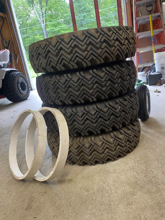

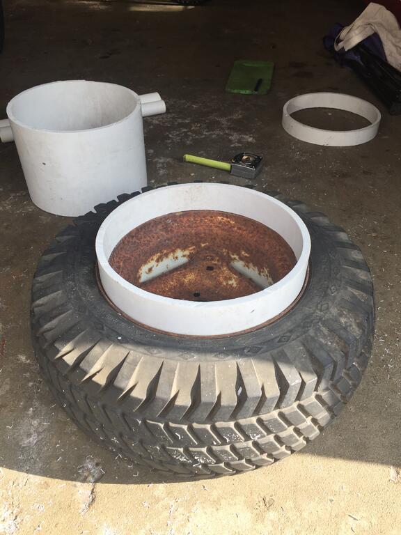

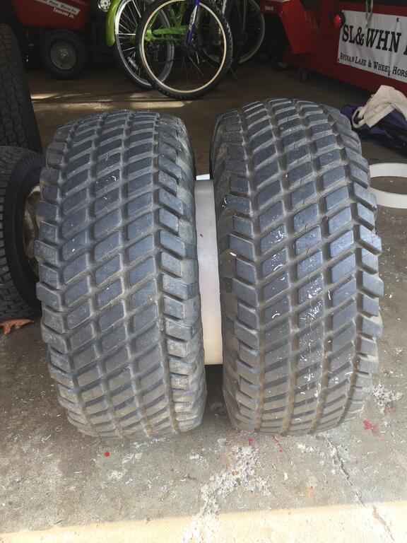

SylvanLakeWH 30,014 #8 Posted February 29, 2024 Here's how i did it... tractor is now at@Pullstart Stables... 12" pvc 1 3 Share this post Link to post Share on other sites

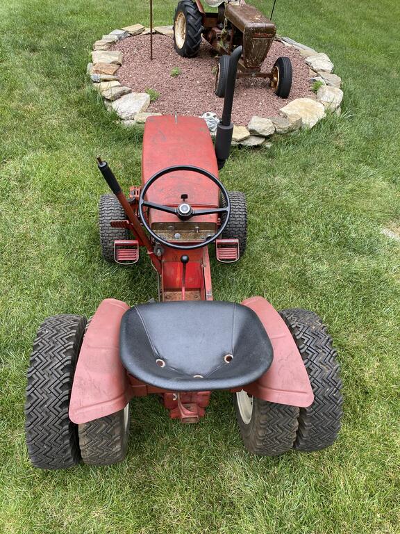

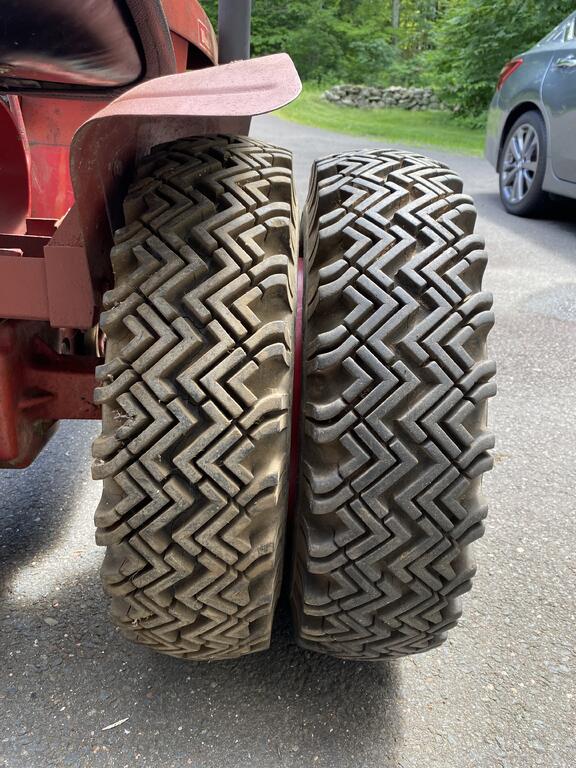

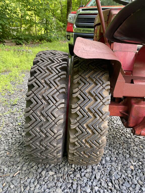

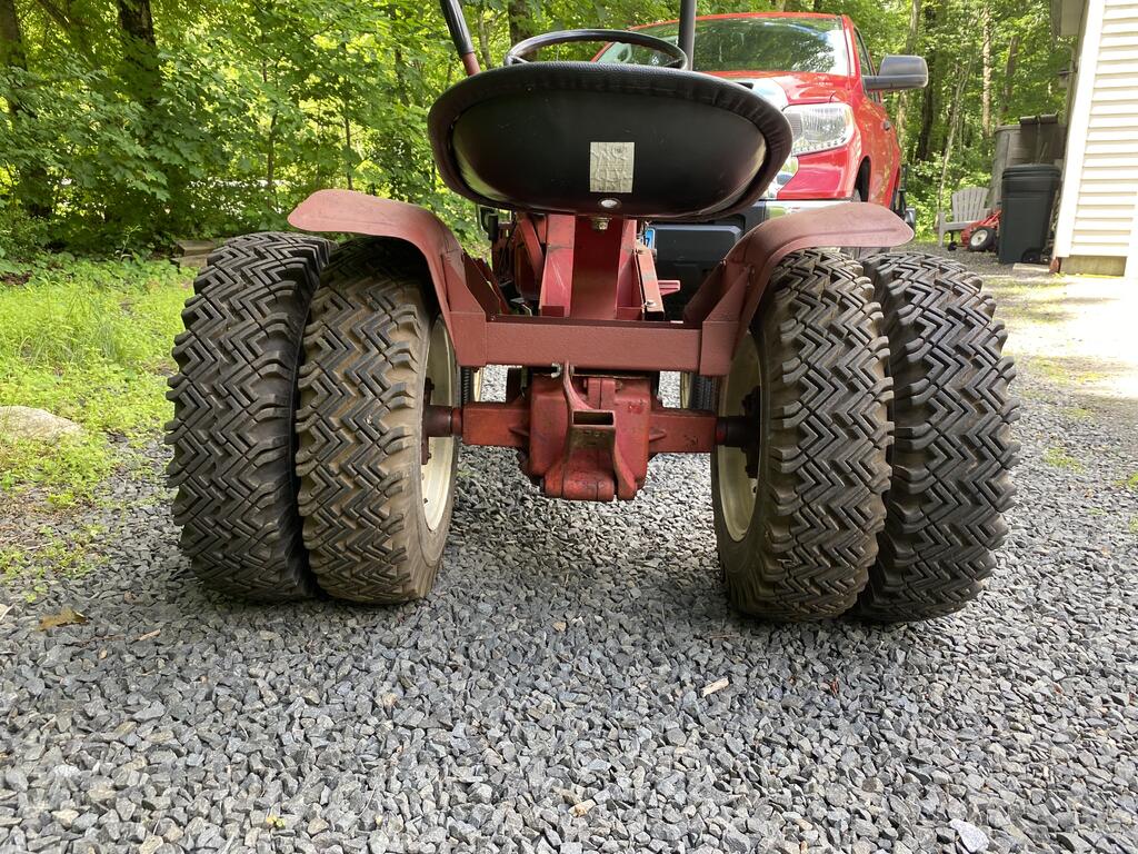

Sparky-(Admin) 24,107 #9 Posted February 29, 2024 I also used the PVC ring method. Trimmed the rings down to keep the tires real close, and shot em with some red paint. 2 6 Share this post Link to post Share on other sites

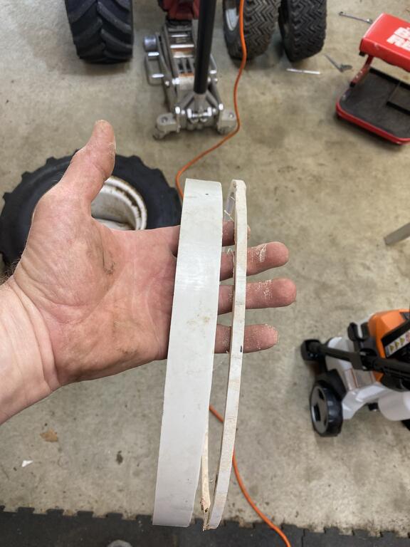

Keaton 466 #10 Posted February 29, 2024 wound a pice of a 5 gallon bucket work i just thought of that cause i can not find pvc that big Share this post Link to post Share on other sites

ri702bill 10,801 #14 Posted February 29, 2024 46 minutes ago, Keaton said: wound a pice of a 5 gallon bucket work i just thought of that cause i can not find pvc that big Too thin a cross section - would probably squish out like a rubber band! Share this post Link to post Share on other sites

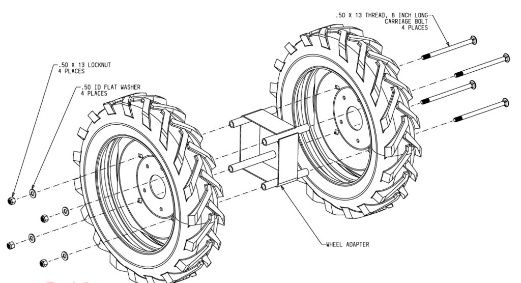

kpinnc 16,328 #19 Posted March 1, 2024 16 hours ago, Keaton said: any ideas will help, thanks I have a set of the square ones like the diagram shows, but they were made wider as to work with 8.5 inch standard wheels. They could be shortened to work with 6 inch very easily. PM me if interested. Otherwise I'll stick them in the classifieds. Share this post Link to post Share on other sites
