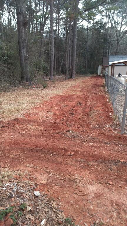

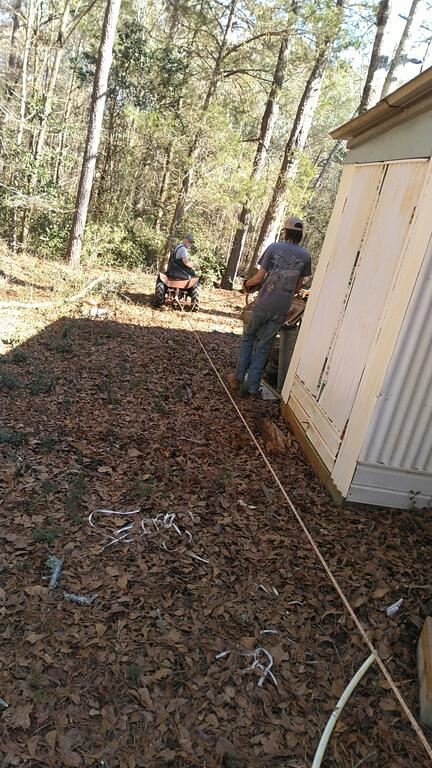

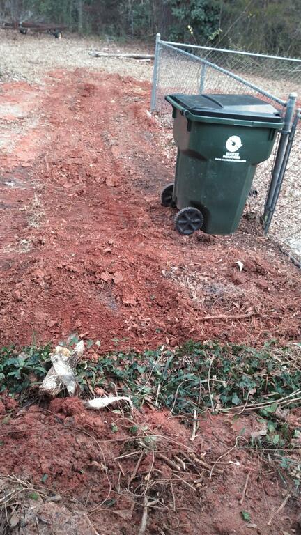

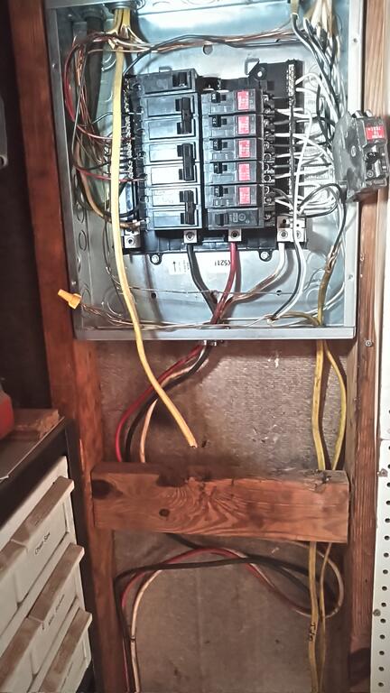

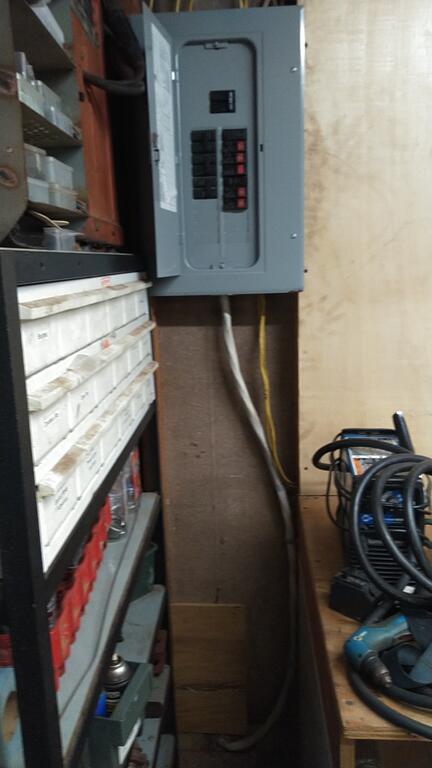

JPWH 6,542 #1 Posted February 10, 2024 I have been using my shop with only a 30 amp service but with the equipment I'm adding this will no longer be sufficient. The panel is also too small so I purchased a 100 amp 20 circuit panel and have been collecting the 1 1/2" conduit left over from jobs that was going to be thrown in the dumpster. A couple weeks ago we pulled out some #2 al ser cable used for temporary. There were a couple of long runs that did not get cut up as usual so I was able to get enough to run to my shop. My neighbor has a small Kubota with a backhoe so I asked if he would have the time to dig a trench for me he said sure no problem. As it worked out he has a small storage building he wants to wire up so we did some bartering and he got my old panel, conduit and wire I had intended to run for my shop that was no longer big enough so he gets a 70 amp service to his storage shed for digging my 150' trench. I also gave him 100.00, an old compressor I no longer use and bought all the fuel and gave him 5 gallons to have on hand. Last Saturday my son and two grandsons come to help me install the new service and water line. Of course a wheel horse had to be involved so Hank became the wire tugger. Old service. New service Wheel horse tugger Hank has some grading to do after the rain quits for a couple of days. 9 3 Share this post Link to post Share on other sites
ri702bill 11,366 #2 Posted February 10, 2024 OK by local code to bury the cable without conduit??? Here, I had to bury the 110 volt underground wire to the pool pump 18" deep - in plastic conduit... 1 Share this post Link to post Share on other sites
JPWH 6,542 #3 Posted February 10, 2024 The cable is in conduit at 24" deep. The water line is in the same ditch about 12' deep. 6 1 Share this post Link to post Share on other sites

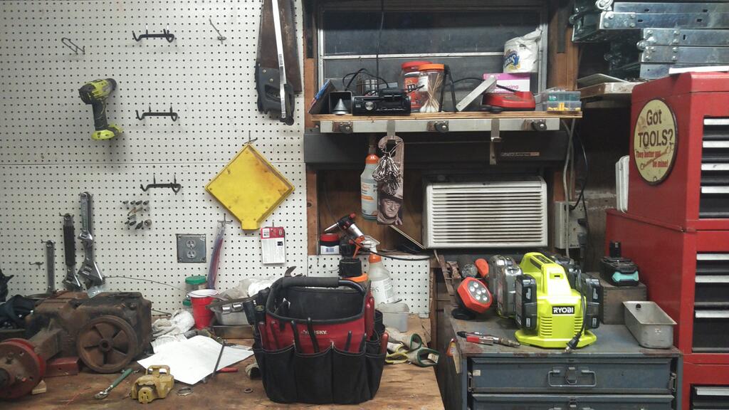

JPWH 6,542 #6 Posted February 10, 2024 (edited) I posted the shelves in another thread but thought I would add them here. The same neighbor that dug my ditch took the old shelves. I also moved.some tools from my workbench wall and moved them close to my work table. I removed all the pegboard from over the workbench and I am building a tool rack and shelves for that area. Edited February 10, 2024 by JPWH 8 Share this post Link to post Share on other sites

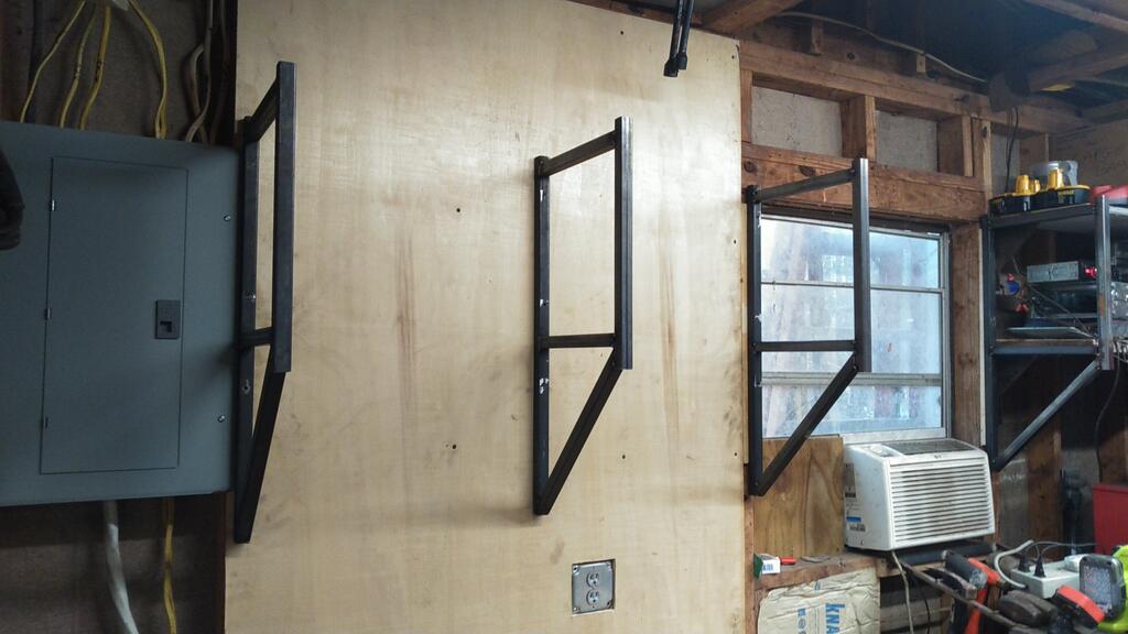

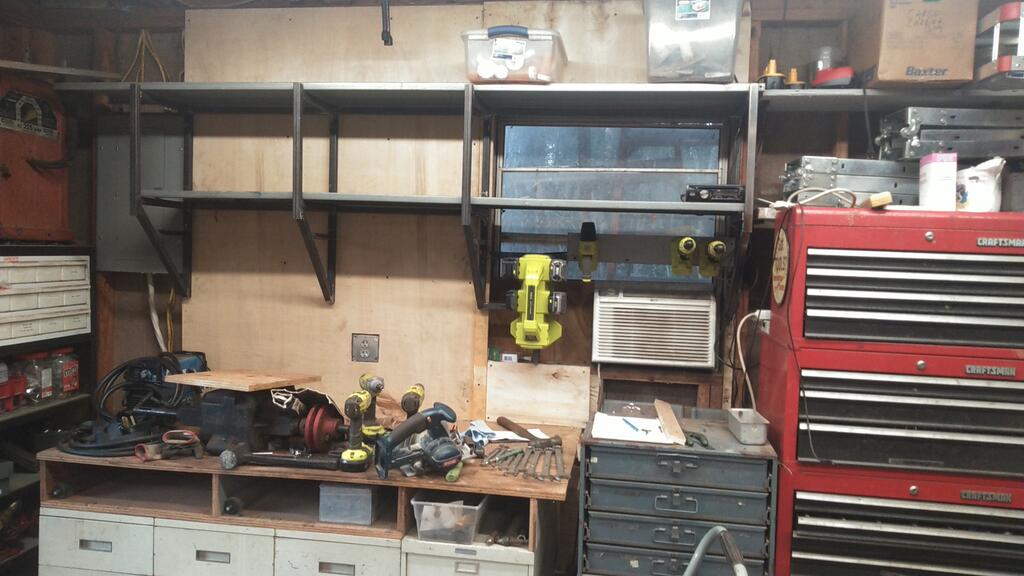

JPWH 6,542 #9 Posted February 10, 2024 I got the tool rack and shelf frames tacked together and temporarily installed to get some measurements to complete the frame for the tool holders then I will finish installing the insulation and plywood around the window before final install. I will have my cordless tools, battery's, charger, and some misc. hand tools (wrenches, crescent wrenches, screwdrivers, and a couple of hammers) hanging on this rack. 5 1 Share this post Link to post Share on other sites

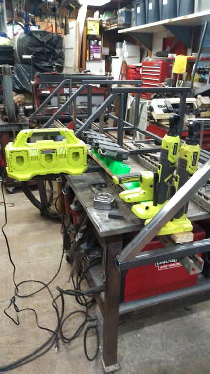

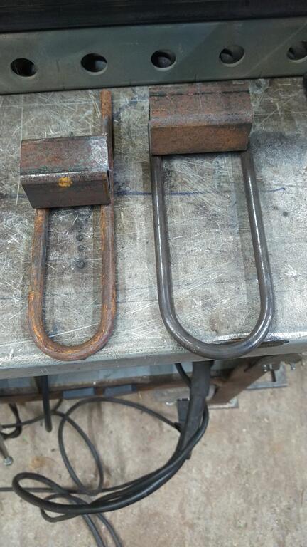

JPWH 6,542 #13 Posted February 13, 2024 I got the rest of the frame tacked together and the charger, batteries, and a few tool holders mocked up. Then I started cutting and bending the adjustable tool holders. 2 4 Share this post Link to post Share on other sites

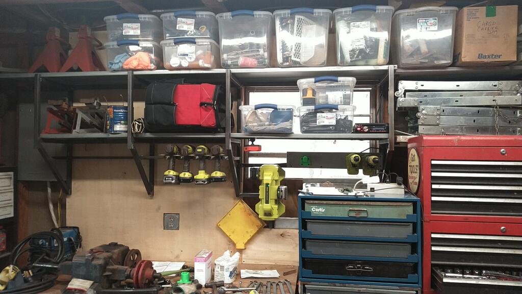

JPWH 6,542 #15 Posted February 24, 2024 (edited) I got the shelf's and tool storage installed today. Now to build the tool holders. Edited February 25, 2024 by JPWH 3 1 Share this post Link to post Share on other sites

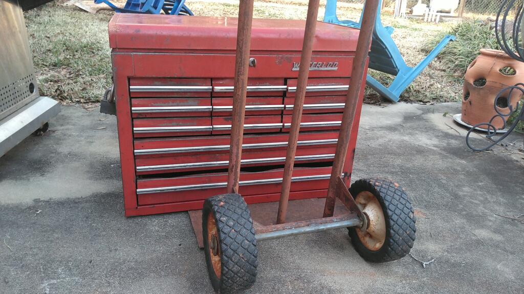

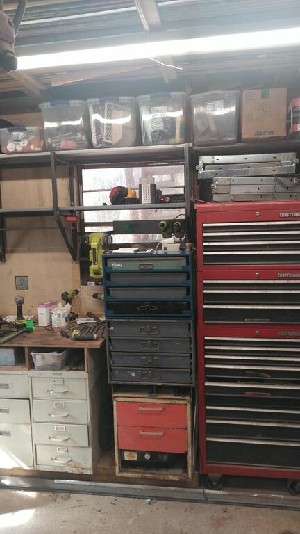

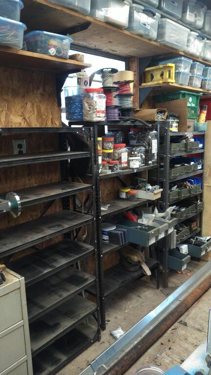

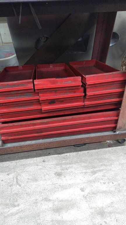

JPWH 6,542 #19 Posted March 10, 2024 I'm making some progress. Slow baby steps but moving forward. I have moved all the stuff from the back room shelves to the new shelves. @squonk Mike the tool box lid is clear. I added another 4 drawer cabinet and it now holds my note pad. I have been looking for a large machinist box for a while but not wanting to spend big money. Found this on a Saturday sitting in front of a thrift store that I pass every day on my way home from work. It was very dirty and some drawers were bent on the fronts but still a good deal for 150.00. even has a key for the lock and some tools as well. It's too heavy for me to lift by myself so I removed the drawers and fixed the bent ones as I removed them. So while it is apart this far I took everything off I could so I can prep and paint it later. 5 Share this post Link to post Share on other sites

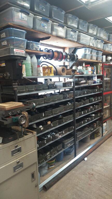

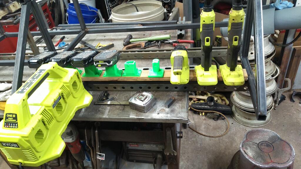

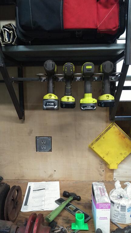

JPWH 6,542 #22 Posted March 17, 2024 I have been moving more stuff to containers for storage on the new shelves. I am one container short to have them full. I also got the adjustable battery drill holders built and installed. The drills set far enough from the wall so bits do not have to be removed. 1 4 Share this post Link to post Share on other sites

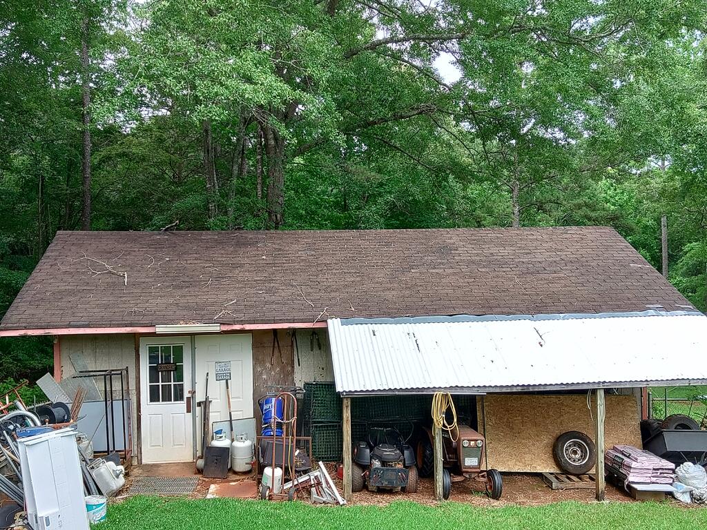

JPWH 6,542 #23 Posted June 5, 2024 I haven't been able to work in my shop for a while but the upgrades are still ongoing. I have made arrangements for a new roof. Existing shingles have been there over 30 years and has sprung a couple of leaks. Project is supposed to start Friday if the rain holds off. 3 Share this post Link to post Share on other sites

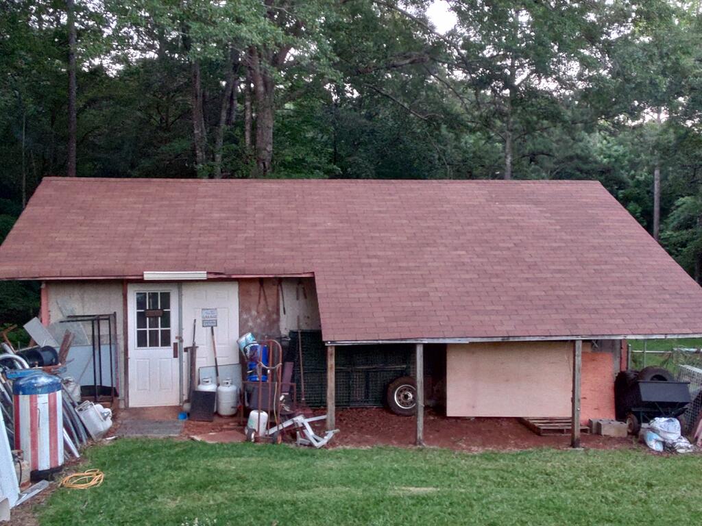

JPWH 6,542 #24 Posted June 8, 2024 Roofers showed up at 6:30 this morning and finished the roof about 1:30. Also had to replace about 125 sq feet of plywood and add plywood for the lean to. Now I need to add gutters. Old roof. New roof 1 1 Share this post Link to post Share on other sites
Moparfanforever 925 #25 Posted June 8, 2024 New roof really changed the look. Looks nice!! 1 Share this post Link to post Share on other sites
