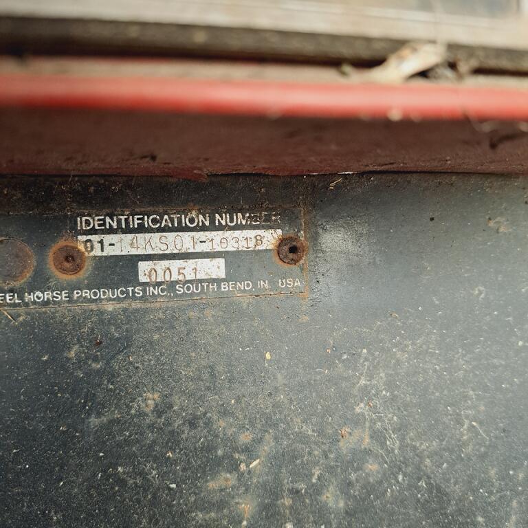

WHX?? 57,645 #29 Posted February 5, 2024 (edited) 2 hours ago, oliver2-44 said: hook down on the mule drive. I asked him about that. What he rigged up to pull it out. I was looking for a winch under there! 2 hours ago, oliver2-44 said: I keep looking for a C with an Eaton Hydro for a mower tractor for my sons Not this one then Ollie.. Sundstrand. They went to Eatons late 1980 so this one is a early 80. The serial number shows up in the files so this one has been seen here before. Not sure on the hood paint will look today. Just assumed it was a repaint. Edited February 5, 2024 by WHX?? 2 Share this post Link to post Share on other sites

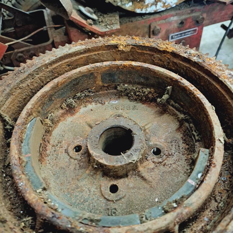

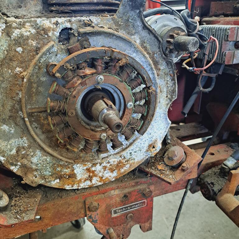

WHX?? 57,645 #47 Posted February 5, 2024 (edited) 34 minutes ago, 953 nut said: Jim, I better pass on the 953 No problem I'm sure we'll find someone that can use it. More joy ... every magnet loose. What adhesive did we say is preferred? Edited February 5, 2024 by WHX?? 2 Share this post Link to post Share on other sites
JoeM 10,122 #48 Posted February 5, 2024 1 hour ago, WHX?? said: What adhesive did we say is preferred? I use JB Never had a failure. 1 1 1 Share this post Link to post Share on other sites
