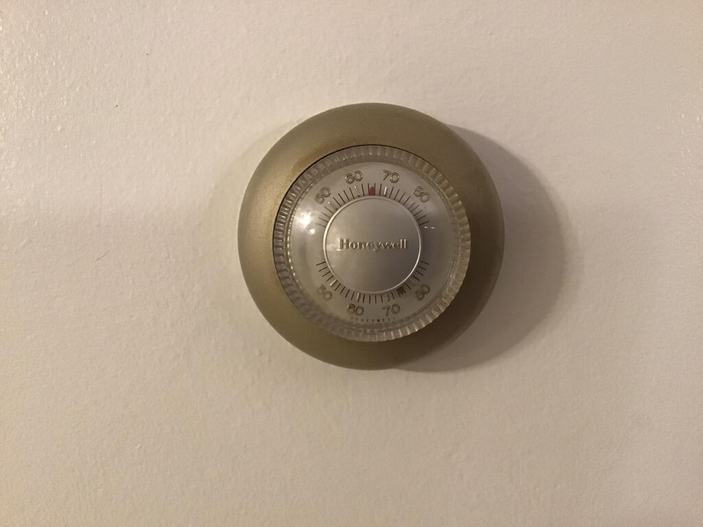

c-series don 11,481 #6 Posted January 30, 2024 @JCM Do you mean like this one? Set on 65, but it’s 72 because of my wood stove! 1 Share this post Link to post Share on other sites
JCM 10,780 #7 Posted January 31, 2024 I have 5 zones here at home that have Honeywell T stats with a Burnham cast iron boiler with cast iron baseboard heat. I still prefer the mercury ones. The new ones that replaced those are a bit of a PITA. Tough to beat old school stuff. Love the patina on that old Stat @c-series don . Share this post Link to post Share on other sites
c-series don 11,481 #8 Posted January 31, 2024 (edited) @JCM Ha! I have three of those hooked to a Burnham and baseboard also!! Since my kids grew up and moved out, the second floor is basically shut down to 50 degrees. My wife and I live on the first floor and I can heat that with the wood stove. I try my best not to burn oil, but I still need hot water! My daughter said I should replace the thermostat with an electronic one, I said NOPE this thing needs nothing, is not broken and I’m not changing it! Edited January 31, 2024 by c-series don 1 1 Share this post Link to post Share on other sites
