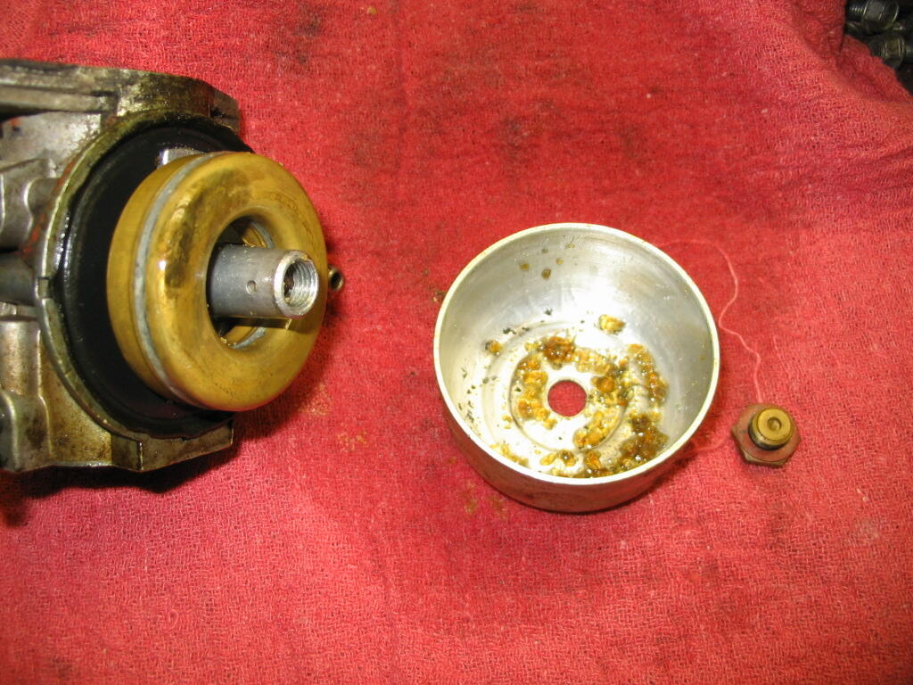

daveoman1966 3,885 #5 Posted January 19, 2024 This is the carb from my K241 engine. See all that jelly-like sh__ in the bowl. THAT is what ethanol-gas does. I, for one, with NEVER...not EVER... use anything but Ethanol-FREE gas in my tractors. 7 5 Share this post Link to post Share on other sites

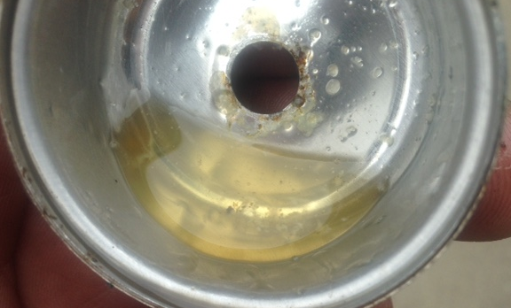

JoeM 10,318 #12 Posted January 19, 2024 As long as I can afford it and not traveling far to get it, I am using non e fuel. But it is only about a buck a gallon more here. All my carb issues went away, the machines start easier in cold weather and use less fuel. I think it is a win to use. I have same experience a @daveoman1966 and @rmaynard Ethanol Pearls I will say if storing machines for an extended period I like running them dry. Regardless of the fuel type. 3 Share this post Link to post Share on other sites

JoeM 10,318 #14 Posted January 19, 2024 I should have included, the bowl in the pic was fuel treated with Lucas fuel conditioner. I later found read were it doesn't work for other people etiher. 1 Share this post Link to post Share on other sites
