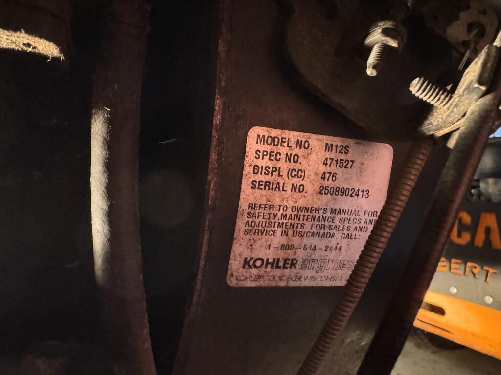

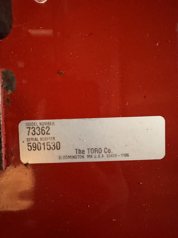

JoeM 10,121 #26 Posted January 14, 2024 Got a model number from the seat pan will be necessary to tell for sure on your stator style. engine tag will tell help to to id the system. Share this post Link to post Share on other sites

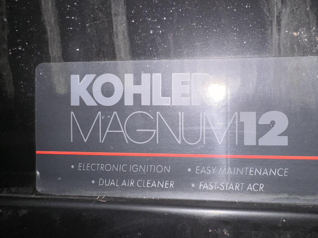

Handy Don 17,192 #30 Posted January 14, 2024 As @JoeM noted, we need the tractor model number from the tag near the seat and, ideally, the engine model and specification numbers from the tag on the engine cowling. Lots of WHs look alike and there was variety of engines within even the 312-8 line. Share this post Link to post Share on other sites

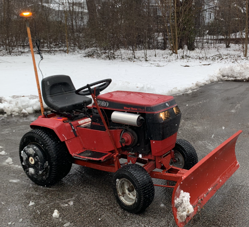

Andy N. 2,805 #32 Posted January 14, 2024 In addition to the LED front and rear lights, I have these rechargeable magnetic base flashers that I put on whichever WH that I'm using at the time to clear snow. Batteries have lasted much longer than it takes me to clear the driveway and highly visible for any vehicles passing by since I do push some of the snow across the street into a ditch. There's 3 or 4 different flash settings for the front light bar. https://www.amazon.com/gp/product/B07VQ7JQSQ/ref=ppx_yo_dt_b_asin_title_o08_s00?ie=UTF8&th=1 https://www.amazon.com/gp/product/B08S7LKKKR/ref=ppx_yo_dt_b_asin_title_o07_s00?ie=UTF8&th=1 IMG_0576.mp4 IMG_0575.mp4 2 Share this post Link to post Share on other sites
Handy Don 17,192 #33 Posted January 14, 2024 Exactly yes! So this is a 1995 tractor. 12hp Magnum Owners manual: https://www.wheelhorseforum.com/files/file/2652-tractor-1995-312-8-da-om-wiring-snpdf/ 2 Share this post Link to post Share on other sites
Handy Don 17,192 #34 Posted January 14, 2024 (edited) So you have a very solid and reliable Magnum 12. It does indeed have a magneto, but it (and the touted Electronic Ignition) solely power the spark plug. Since you’ve already downloaded the OM (owner manual) -- you did, right? -- you note the wiring diagram for the 312 Model on page 18. It shows a regulator which is converting the engine’s stator output AC to DC (12 -14 volts) and sending it out on a white wire to the L (lights) terminal on the ignition switch. From there power goes to charge the battery, to the light switch, and to the safety relays (read up on the safety operations in the manual, please!) So bottom line, you need not do any rewiring to accommodate the PAR 36 LED headlights. Many of us do recommend that you add a dedicated ground wire from the headlights to somewhere on the tractor frame since the hood hinge is less than ideal as an electrical connection. The above notwithstanding, the dimming you are seeing could have a few causes: - a weak battery that is not holding its charge so when the engine is running too slow to deliver a charging voltage the battery is unable to provide full power (take your battery to be tested at an auto parts store or good mechanic) - poor electrical connections in the wiring, including connections to ground (cleaning them all and coating with dielectric grease might help) - a faulty regulator that is delivering a voltage higher than 14vdc (this is not very likely--if you have a good volt meter you can test for this -- ask if you don’t know how) Edited January 14, 2024 by Handy Don 1 Share this post Link to post Share on other sites

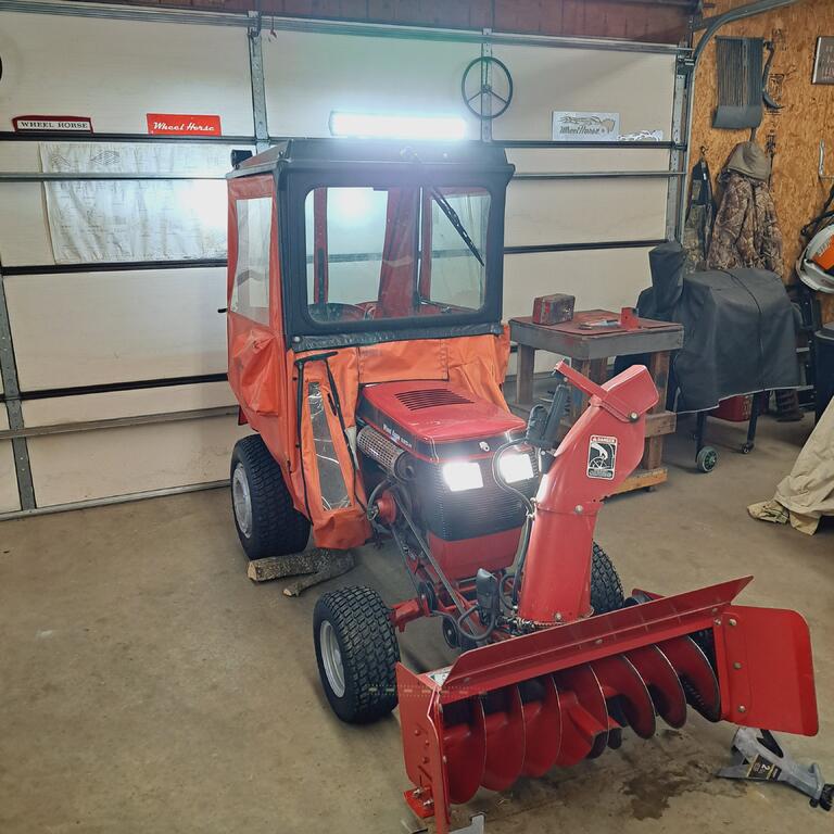

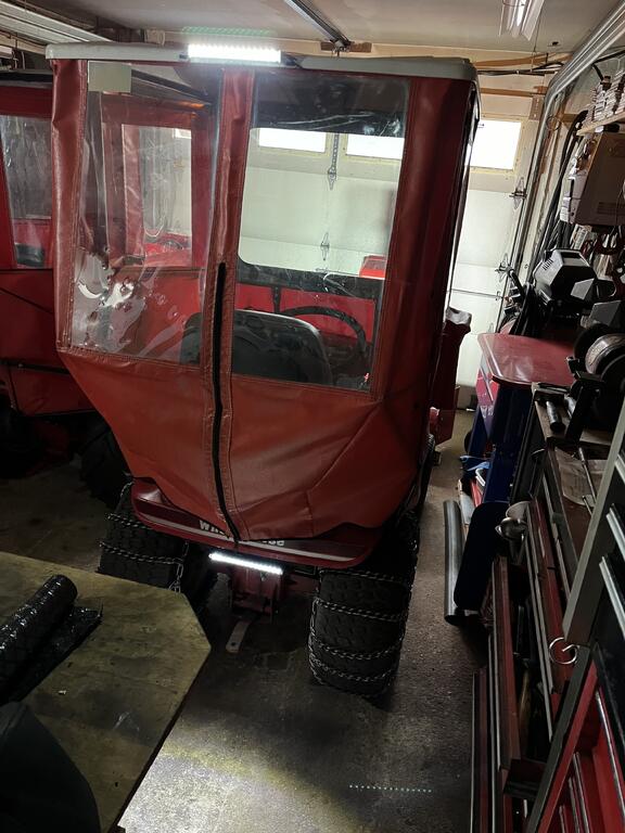

RJC1965 173 #42 Posted January 15, 2024 I would look at these lights as you can change the color setting. I just mounted these and do not have a lot of time with them if I get a chance to take a few pictures at night in the snow I will post them. I also read that an amber light can help if it’s snowing out. Got these off of Amazon and mounted to my cab. Also get the kit needed two of them. Helps on a cab to angle the lights. 1 1 Share this post Link to post Share on other sites

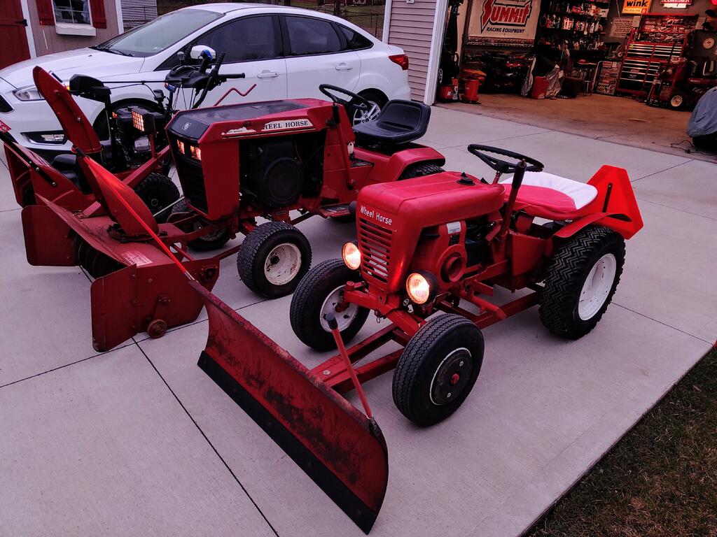

paulyv56 152 #45 Posted January 17, 2024 I just installed Vstar LED Par36 5000 K. on my 312-8 Plug and play, BRIGHT! Share this post Link to post Share on other sites

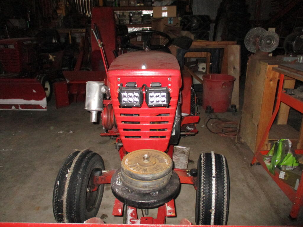

pfrederi 20,992 #46 Posted January 17, 2024 These are very bright and white, Mounted without drilling any new holes in the hood used the headlight bucket holes. But I do not plow after dark ! 1 Share this post Link to post Share on other sites

Handy Don 17,192 #50 Posted January 18, 2024 2 minutes ago, Lagersolut said: This time of year I'm pushing and blowing snow at night a lot of times and down on the road - not a busy road at all but I still like being fully lit up . I’d suggest adding a pole-mounted amber LED that emulates a rotating beacon, as well. Not much money for a LOT of visibility. My son was at the end of the sidewalk waiting for traffic to pass so he could turn around safely and cars in both directions stopped and waved him to go ahead! 2 Share this post Link to post Share on other sites
