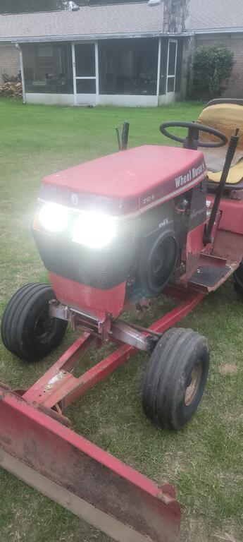

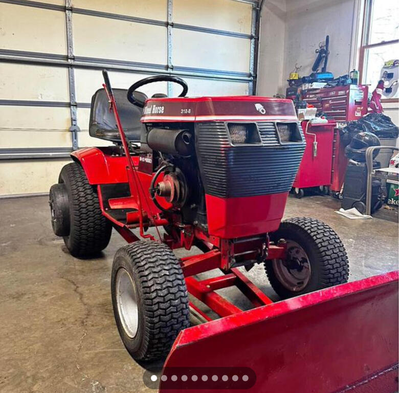

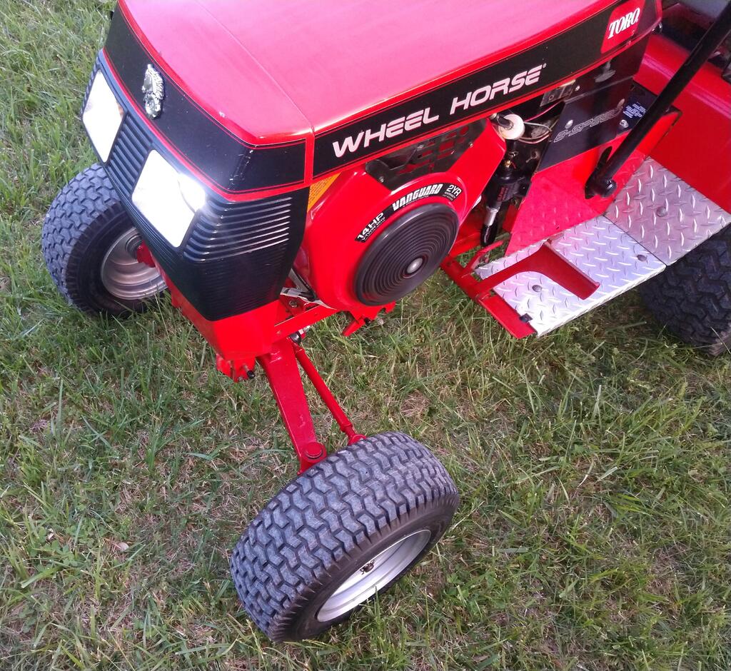

RKCrizzle 16 #1 Posted January 13, 2024 Hi Guys, I just bought myself a Wheel Horse 312-8 with plow setup after my old smaller Wheel Horse died plowing in the last storm. I am curious as to if anyone has experimented with putting LED lights on one of these things and could share any insight with me. Preferably a setup that includes headlights or a LED bar and lights for the back too. I've attached a picture of the tractor for your viewing pleasure. 7 Share this post Link to post Share on other sites

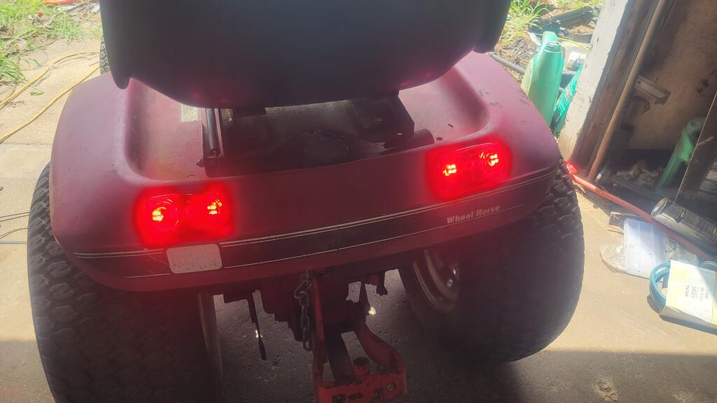

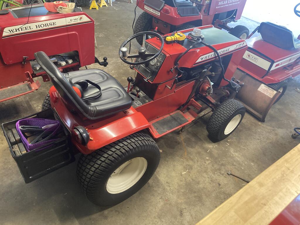

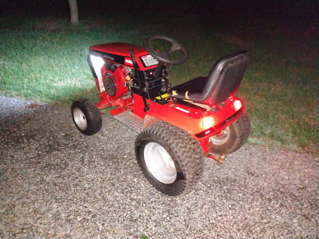

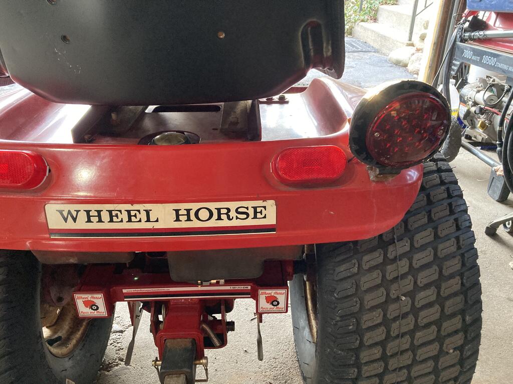

SylvanLakeWH 31,996 #5 Posted January 13, 2024 (edited) And I added a very bright red led on the rear and a plug in flasher on the hood... You can see both in the pics below... Edited January 13, 2024 by SylvanLakeWH 2 Share this post Link to post Share on other sites

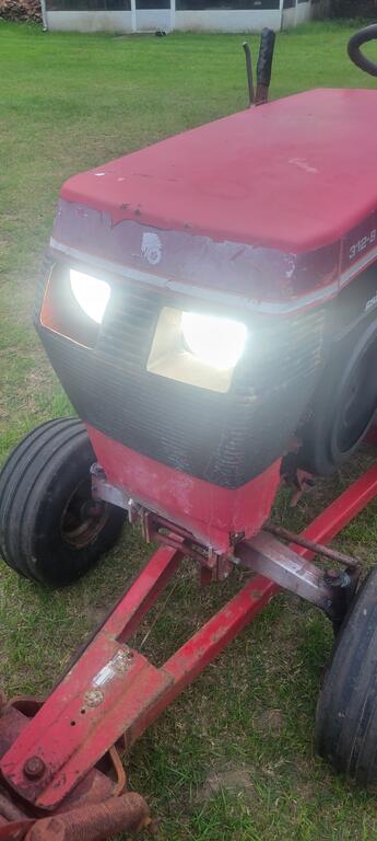

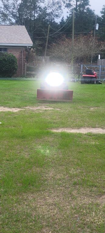

kpinnc 18,851 #6 Posted January 13, 2024 (edited) Replacing the headlights with PAR36 12W LEDs is a smart upgrade. Direct plug and play, and pulls much less amps than factory incandescents. The pic below is mine. They are 4000K, which is close to white. Higher numbers lean towards blue, lower lean pink. If you're thinking of adding more, then as has already been said- verify your charging system can handle it. Edited January 13, 2024 by kpinnc 5 5 Share this post Link to post Share on other sites

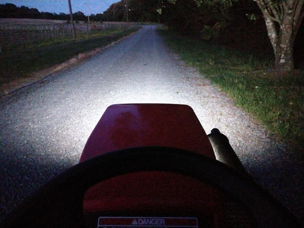

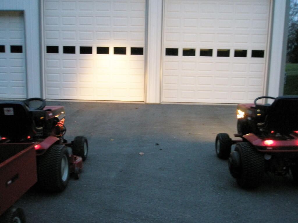

lynnmor 8,970 #7 Posted January 13, 2024 Here is a comparison between original halogen and LED, as you can see the LED lights spread out evenly and the halogens are more of a spot light. Be aware that the LED lights are available in different angles of coverage. In this photo the LEDs are illuminating everything in the picture making the halogens appear better than they are. 3 1 Share this post Link to post Share on other sites

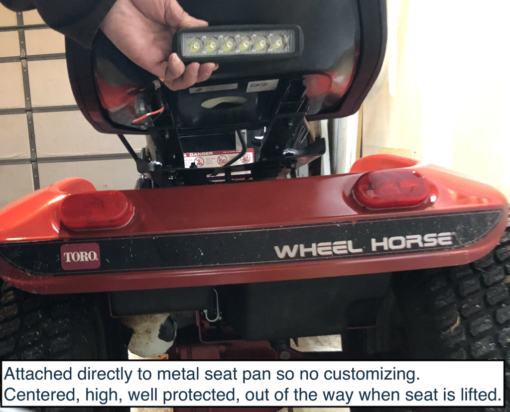

Handy Don 17,191 #8 Posted January 14, 2024 We added the LED PAR lights to the front and then wanted rear-facing light. This was our solution. Power and ground supplied from taps into the tail light wiring, via a waterproof two-conductor connector and up into the bottom of the seat between the pan and the cushion and on to the light. We added a separate switch next to the light bar so it can be on only when needed. 5 Share this post Link to post Share on other sites

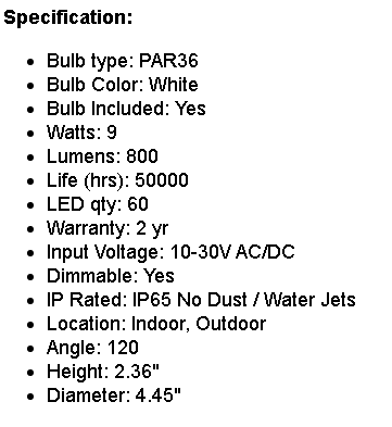

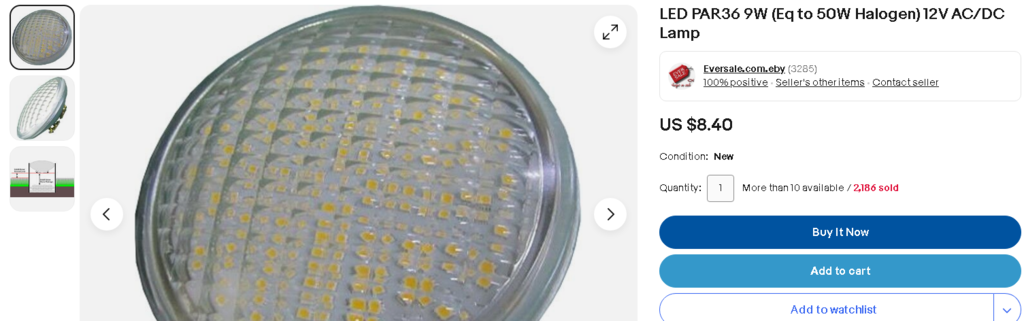

JoeM 10,121 #14 Posted January 14, 2024 25 minutes ago, Lagersolut said: or are the LED's okay with variable voltage I would say they will, that is AC on the stat-or. i believe. Have to get the AC/DC one that are dim-able. But I would still go to the battery connection. These are the 9 watt ones but they come in the brighter 12 watt ones like kpinnc has and are much brighter 1 1 Share this post Link to post Share on other sites

Handy Don 17,191 #16 Posted January 14, 2024 3 minutes ago, JoeM said: I would say they will, that is AC on the stator. Stator output on a P216 at full throttle can be 40+ VAC. Suitable as input to a voltage regulator but not to an LED with a 30 VAC max. I can’t speak to Kohlers for this. 1 Share this post Link to post Share on other sites

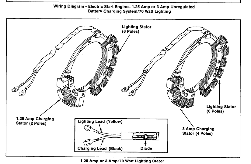

JoeM 10,121 #19 Posted January 14, 2024 Some WH tractors came with a duel stator. One dedicated to lights the other for charging. I am not sure which ones but figure some magneto engines came this way. One issue with using the AC side, no lights if the engine is not running. 3 Share this post Link to post Share on other sites

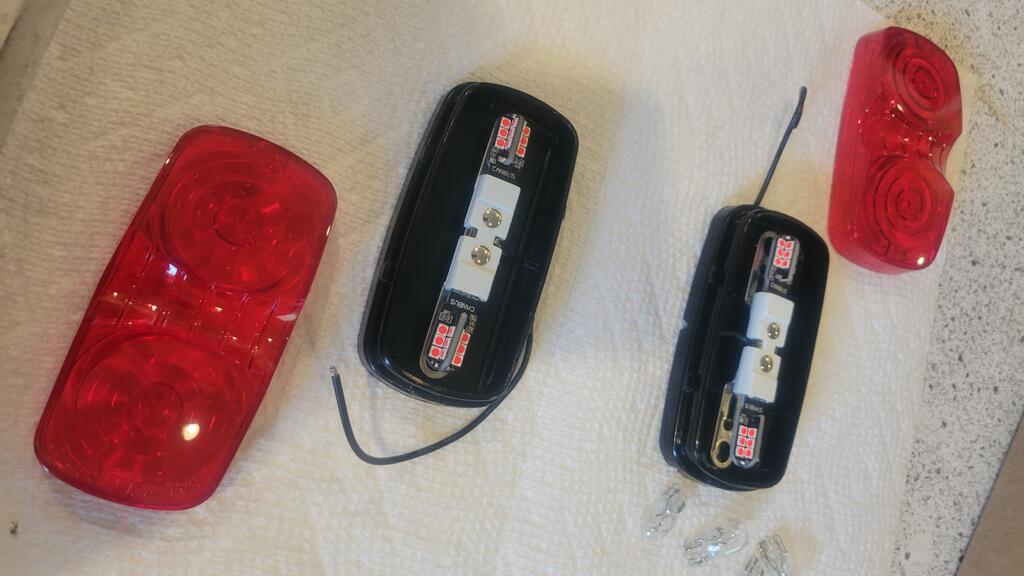

RED-Z06 2,718 #20 Posted January 14, 2024 I did the PAR36 led upgrade on my 416 and 312, one had the flood pattern, one a spot pattern..both incredibly bright. Did a dual led tail too. 7 Share this post Link to post Share on other sites

ebinmaine 80,078 #22 Posted January 14, 2024 8 hours ago, JoeM said: Some WH tractors came with a duel stator. One dedicated to lights the other for charging. I am not sure which ones but figure some magneto engines came this way. There were Kohler single cylinders built in the early to mid 80s with that system. Also the GT Series with the Briggs during the same time period. 2 Share this post Link to post Share on other sites
