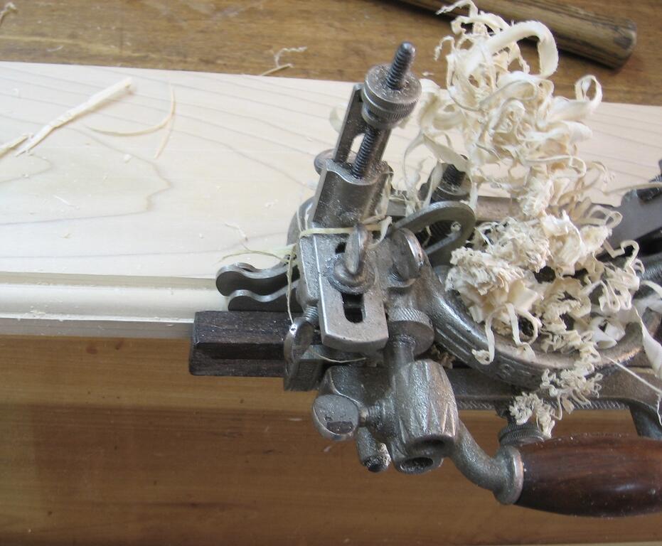

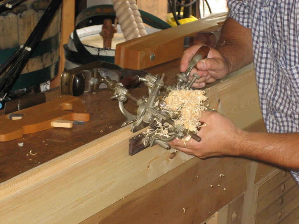

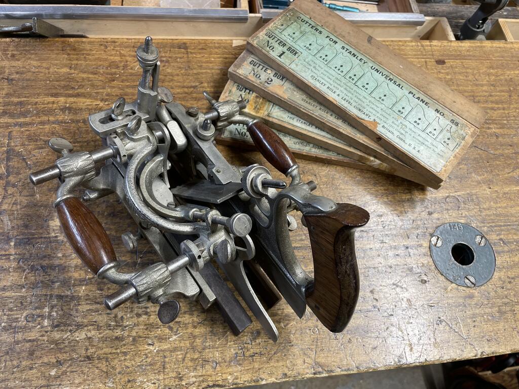

formariz 12,381 #5 Posted January 8, 2024 At the time your house was built indeed many of items in it such as sashes, cabinetry and possibly some moldings were built on site. Readly availability of such items was not easy and carpenters then were well versed and trained on making those items. Over the years due to increased mechanization and bulk availability of all items needed within a house, the ability and knowledge to make such items basically all but disappeared. If one has the time and a little patience the moldings you need can be easily made. Although I am not trying to advocate my methods, or as my wife calls it “ my madness” , hand tools are many times the simplest, easiest and most pleasurable way to do such a task. One does not need to make or have a dedicated plane. For short runs such as what you need for the top of doors using good straight clear material if you had access to a Stanley 55 you can duplicate almost any molding with the exception of a large crowns. As intimidating as the tool looks it is rather simple to set up and use and with a little practice and experimenting one can duplicate most moldings which is the original intent of the tool. It was introduced as an option to having a dozen or more planes in tool box each only dedicated to one specific function. In the photo below tool is in full array with all components installed but it is rarely used that way. I have over the years successfully made miles of moldings using it. 2 1 Share this post Link to post Share on other sites
