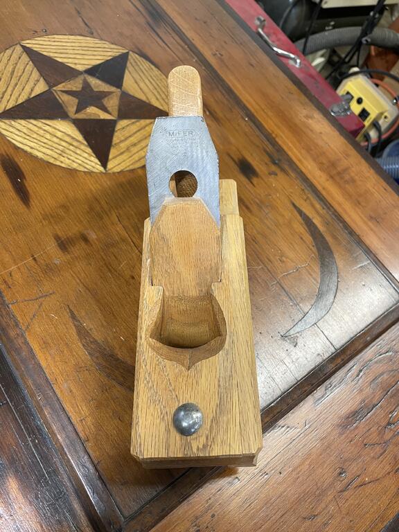

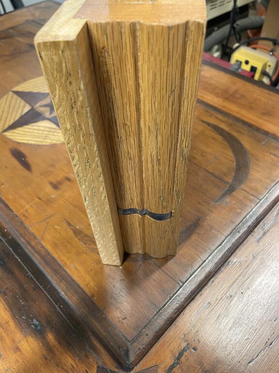

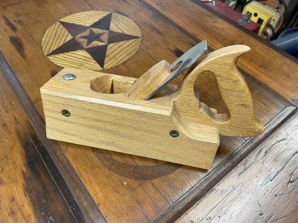

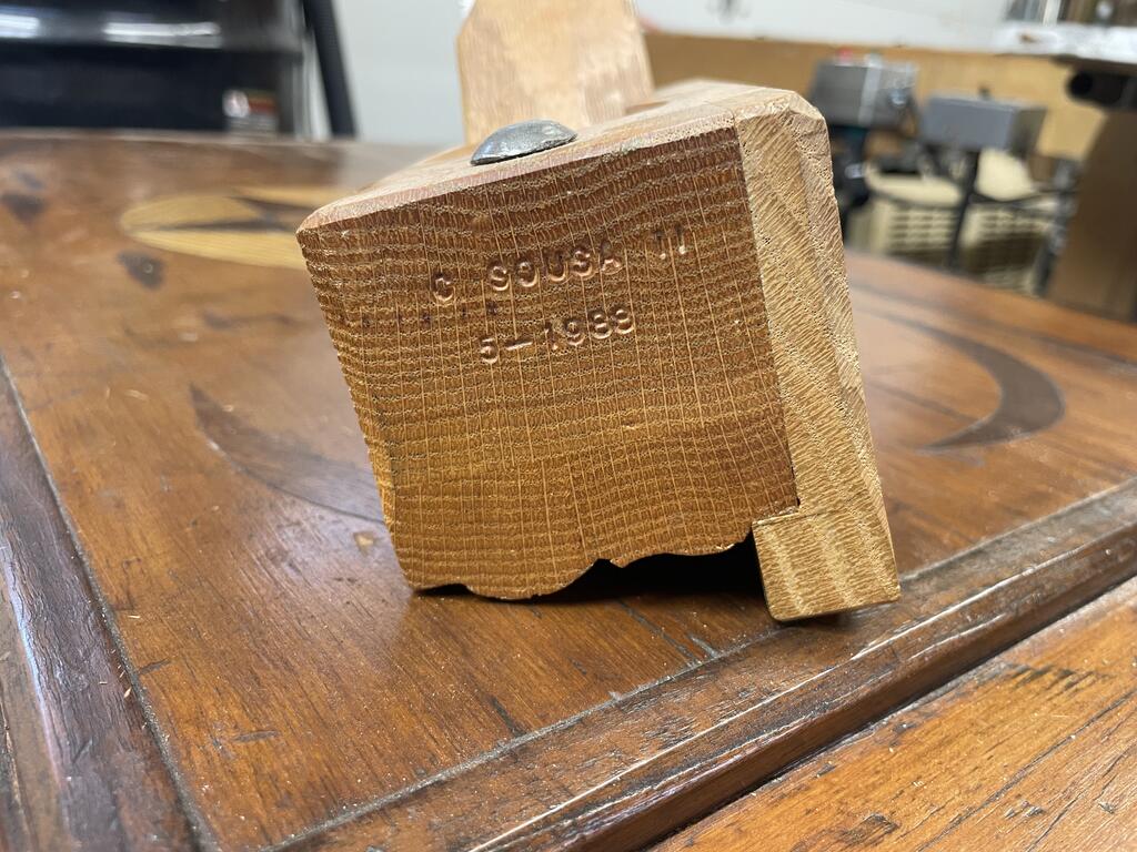

formariz 12,381 #40 Posted January 1, 2024 23 hours ago, Handy Don said: I’m fairly sure you could still find a shop that would make you a cutter using the profile of your existing moulding. @formariz might have a suggestion! As expected my suggestion will lean towards a hand tool. In 1988 I needed to duplicate a small crown not readily available then. All I needed was about six feet of it. A chunk of scrap red oak and this is what I came up with. It has by now probably made a dozen miles worth of it. No noise, no mess, no danger to fingers and a pleasure to use. Different fences on it allow for another couple of different moldings. 4 3 Share this post Link to post Share on other sites
Tractorhead 9,218 #41 Posted January 1, 2024 I admire your craftmanship Cas. Wood is not my kind of Material i preferr, but i admire the results you made with these simple Tools. it must be a lot of patience to do that. I am too impatient for that. 1 1 Share this post Link to post Share on other sites
Handy Don 17,735 #42 Posted January 1, 2024 38 minutes ago, formariz said: As expected.... Kinda sorta I can see grinding, filing, honing a plane blade to the proper shape until the profile matches the sample molding. Experience and materials to hand are pretty important here, of course. Maybe @8ntruck could do this! How, though, does one make the base of the plane body conform to the blade? Share this post Link to post Share on other sites
formariz 12,381 #43 Posted January 1, 2024 (edited) 1 hour ago, Handy Don said: Kinda sorta I can see grinding, filing, honing a plane blade to the proper shape until the profile matches the sample molding. Experience and materials to hand are pretty important here, of course. Maybe @8ntruck could do this! How, though, does one make the base of the plane body conform to the blade? This may be another good thread if there is interest in it and as to not hijack (any more)the original subject in this one. 1 hour ago, Handy Don said: How, though, does one make the base of the plane body conform to the blade? Actually the opposite is done. The blade is shaped to conform to the plane body. Sole of plane is first shaped to conform to desired shape of molding using a variety of possible methods such as using other planes, scrapers or even multiple passes using a table saw with a fence set at steep angles to blade such as when making a cove in it. Blade is then shaped to follow that shape. Edited January 1, 2024 by formariz 1 Share this post Link to post Share on other sites
formariz 12,381 #44 Posted January 1, 2024 1 hour ago, Tractorhead said: I admire your craftmanship Cas. Wood is not my kind of Material i preferr, but i admire the results you made with these simple Tools. it must be a lot of patience to do that. I am too impatient for that. Thank you for the kind words. Patience is definitely a must but not always automatic . Mood and life many times dictate the amount of patience available therefore certain projects either get pushed back a little or they are spontaneously tackled. To me things such as this always have a therapeutic effect whether in times of stress or even grief. 1 2 1 1 Share this post Link to post Share on other sites

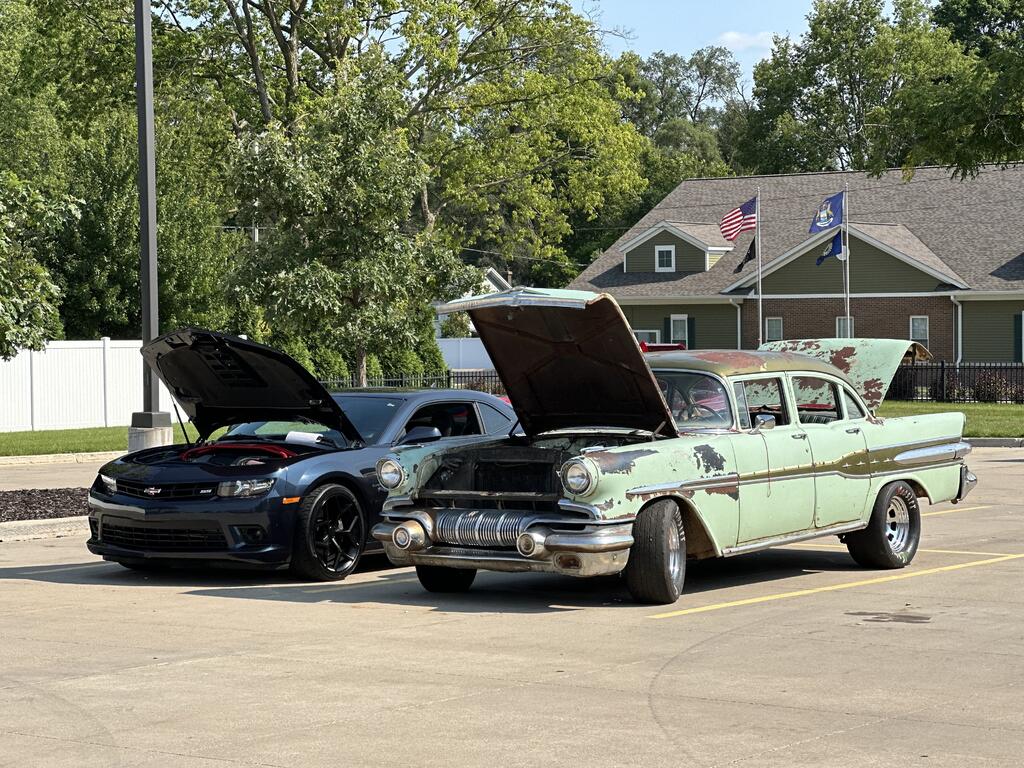

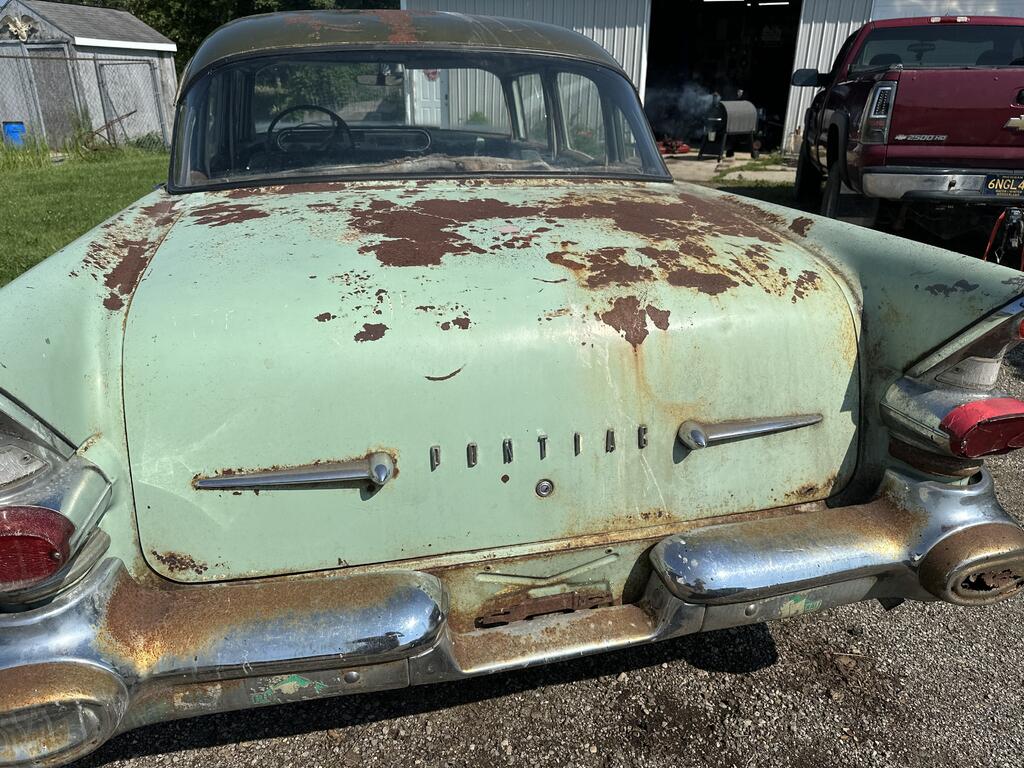

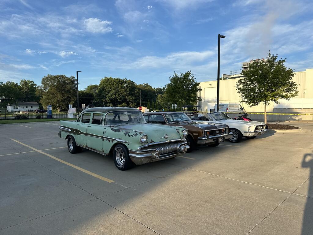

Pullstart 71,563 #45 Posted August 9, 2024 I did some cleanup, and placed second out of forty in Mrs. P’s company car show! A beautifully restored Chevelle Ss with a 396 and Tremec 6 speed took the prize, by just 4 votes! 2 Share this post Link to post Share on other sites

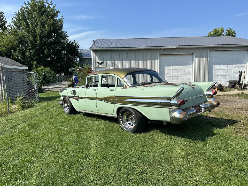

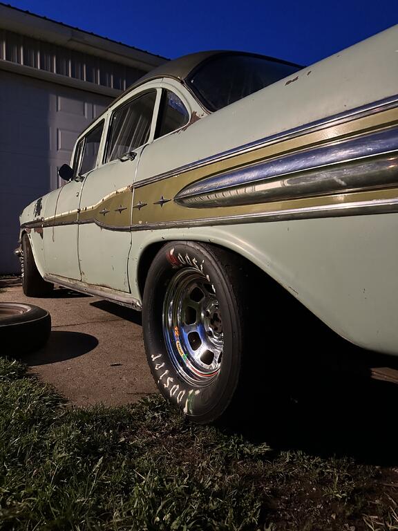

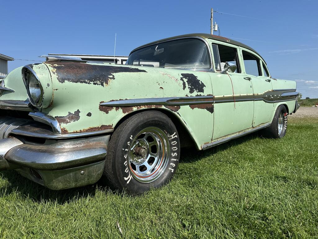

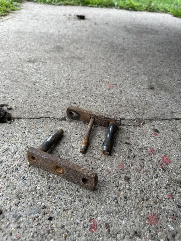

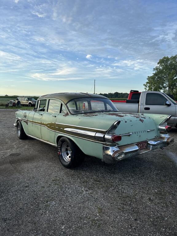

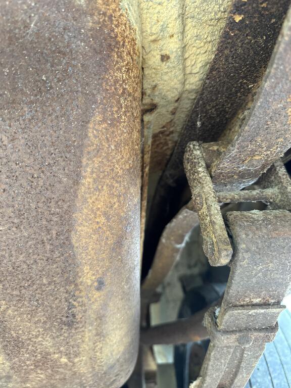

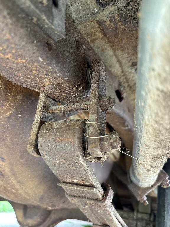

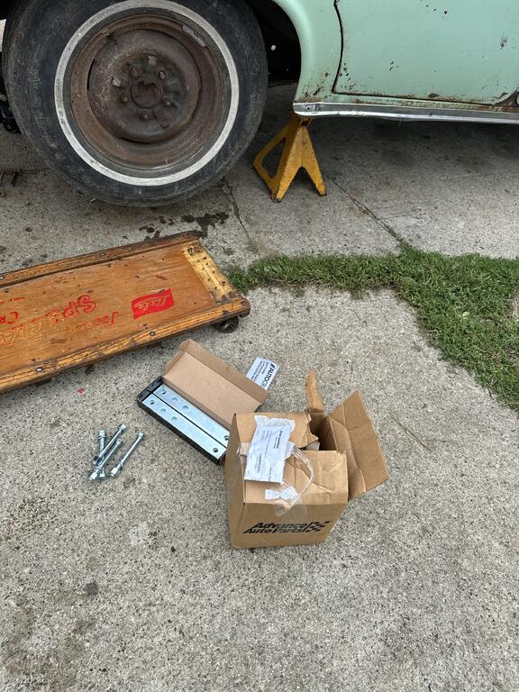

Pullstart 71,563 #47 Posted August 9, 2024 (edited) I ended up using 8” race wheels front and rear, neutral backspace in the rear and 5” backspace in the front. 26.5x8” tires up front, 27x10’s in the rear. A 56” leaf spring from an F250 high boy was added to the rear packs, along with a shackle kit to clear the tires. I still had a tickle of rub on a couple bumps along the way. I found this shackle kit from Advance Auto Parts. It was in stock in the big city, about a 20+ minute trip each way. I selected the $8.99 same day shipping option on their website and the kit arrived just 55 minutes after I placed my order! Edited August 9, 2024 by Pullstart 1 1 Share this post Link to post Share on other sites

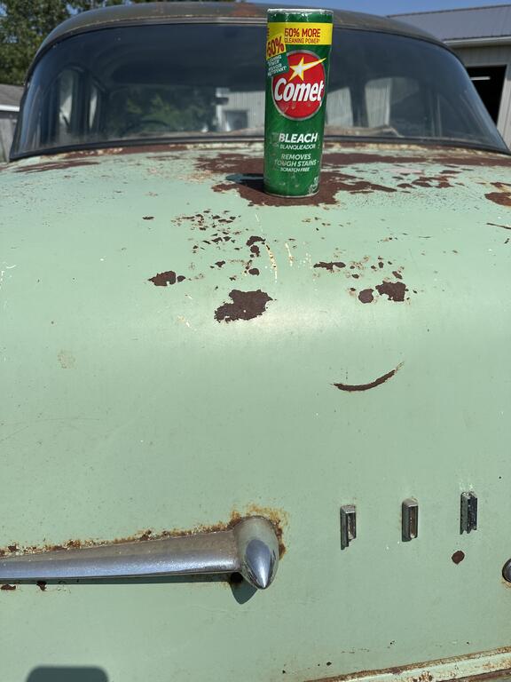

Pullstart 71,563 #48 Posted August 9, 2024 I’ve heard and seen good things about this Comet wash. It did wonders! 2 1 Share this post Link to post Share on other sites
adsm08 5,247 #49 Posted August 9, 2024 7 hours ago, Pullstart said: I’ve heard and seen good things about this Comet wash. It did wonders! Be careful using Comet on a Pontiac. Compatibility issues and such. 4 Share this post Link to post Share on other sites
Pullstart 71,563 #50 Posted August 9, 2024 I see what you did there! 1 Share this post Link to post Share on other sites
