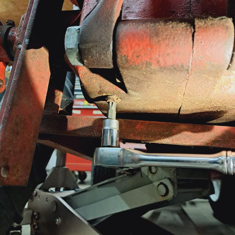

ri702bill 13,398 #7 Posted December 15, 2023 (edited) 1 hour ago, WHX?? said: Changing tranny fluid on the 502 and of course the allen plug stripped out. Can easily weld a nut on Key word here is "easily". Not a fan of MIG welding upside down. MAYBE best to pull the Unidrive and rotate it up.- NO electrical issues either that way... Welding the nut - have done that before - the heat from welding helps to make removal easier. Have you tried using a Torx bit?? The right size pounded in may do the trick. Done that too. Edited December 15, 2023 by ri702bill 1 2 1 Share this post Link to post Share on other sites

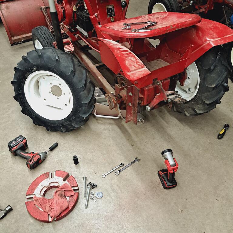

WHX?? 58,388 #20 Posted December 15, 2023 2 hours ago, SylvanLakeWH said: Wait... Whats the question...? Can you weld on a horse without damaging electrical. Hey wait a minute didn't I lay a bead on a NOS A-60 Dan? How's that one running for ya Sylvia? Well as Ritchie @19richie66 might say... put the welder down, put you hands in the air and slowly step away... I used Bill's torx suggestion and hammered one in. Just as she was about to strip out it busted loose. Bill. Plan B was T bear's allen wrench. Did I mention I suck at welding? Broach the hubs, new hardware and call it a day for this girl for now. Gotta love it when seals leak and hubs slide right off. 3 3 1 Share this post Link to post Share on other sites
