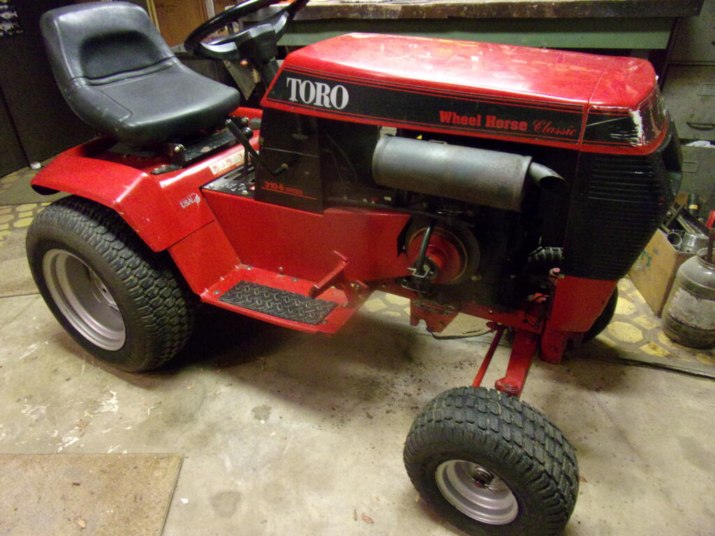

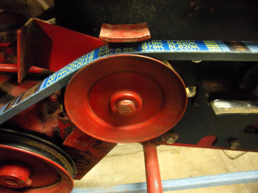

Ed Kennell 46,569 #28 Posted December 4, 2023 60F and sunny yesterday so I rolled her outside and gave her a bath. Cleaned up real well. Picked up a new TSC drive belt. $26.99 Perfect fit. A few months back there was a discussion about weather the belt retainer on the idler pulley helped to stop the belt from moving for smooth gear shifting. I didn't have a gear drive at the time, but now am able to demonstrate how effective this belt brake really is, I am aware the early gear drives did not have the stationary tab where the belt could be pinched by the moving retainer on the pulley. Take notice, this is a new stiff belt and there is no belt guard or belt guides around the engine pulley, but the belt stops instantly when the clutch is depressed. 2 4 Share this post Link to post Share on other sites

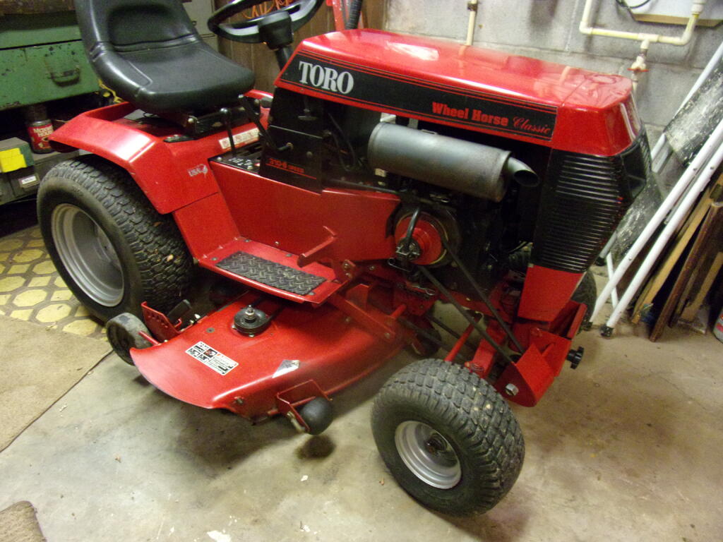

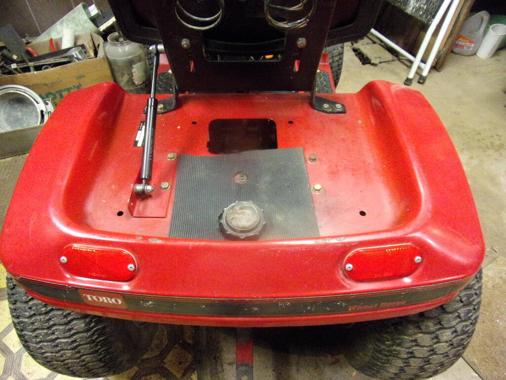

Ed Kennell 46,569 #31 Posted December 6, 2023 On 12/4/2023 at 6:26 PM, peter lena said: , sleep till spring Oiled up and soaking till Spring Pete. New bearings in the front wheels. New fuel filter. Changed fluids and greased all zerks. Made some rubber pads to quiet the seat and hood rattles. The left side tunnel plate was broken where the seat mounts. Added 1x1 angle iron to beef it up. 4 Share this post Link to post Share on other sites

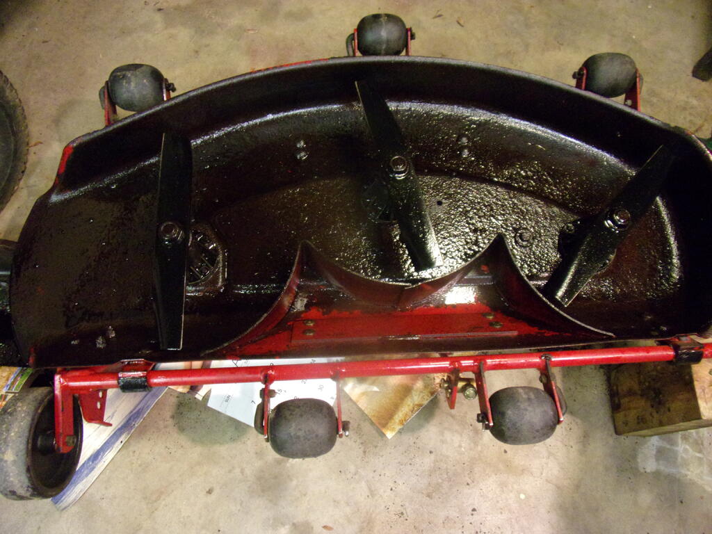

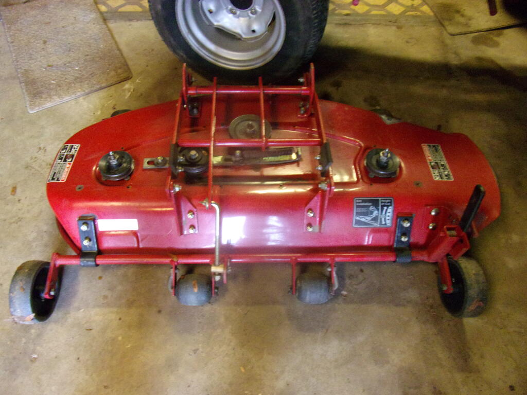

paulyv56 152 #36 Posted January 3, 2024 On 12/5/2023 at 7:20 PM, Ed Kennell said: Oiled up and soaking till Spring Pete. New bearings in the front wheels. New fuel filter. Changed fluids and greased all zerks. Made some rubber pads to quiet the seat and hood rattles. The left side tunnel plate was broken where the seat mounts. Added 1x1 angle iron to beef it up. Nice Work!, Can i ask what type of oil for the bottom of the mowing deck. I want to preserve my 28 Y.O Mint mower deck. Looks great. Share this post Link to post Share on other sites
Ed Kennell 46,569 #37 Posted January 3, 2024 25 minutes ago, paulyv56 said: Can i ask what type of oil for the bottom of the mowing deck. I'm almost embarrassed to tell ya. I save all my drainings when changing oil in my vehicles, so it's mostly used 10w30w. I don't get a lot, but the marine lower unit oil from my outboards sticks well and I use most of that on trailer springs of boat trailers that are constantly dunked in salt water. I don't think the type oil is important. The key is to remove all grass and rust each fall, turn it up side down, and soak it with oil allowing it to penetrate for a week before turning it back over to drain before winter storage. If you need to buy material, May be @peter lena will offer advice. Pete is our resident expert on grease and oil. 1 Share this post Link to post Share on other sites
paulyv56 152 #38 Posted January 3, 2024 I will save my lower unit oil in the spring and use that. Makes sense. Thank You 1 Share this post Link to post Share on other sites
peter lena 9,940 #39 Posted January 4, 2024 @paulyv56 very often state to , " break the GRUNGE CYCLE " my decks are clean / clear , and soaking now over winter till spring with lubrication soak. another thing thats common with an oiled surface is that it will easily release , any acumination , pops off easily . decks were , also exposed , bottom side to the sun , actually dry it out , hot surface , then penetrating oil , shat soaks in , then a heavier oil , to retain metal feed . my decks are stained black , from gear spray . just a suggestion , Pete 1 1 Share this post Link to post Share on other sites
