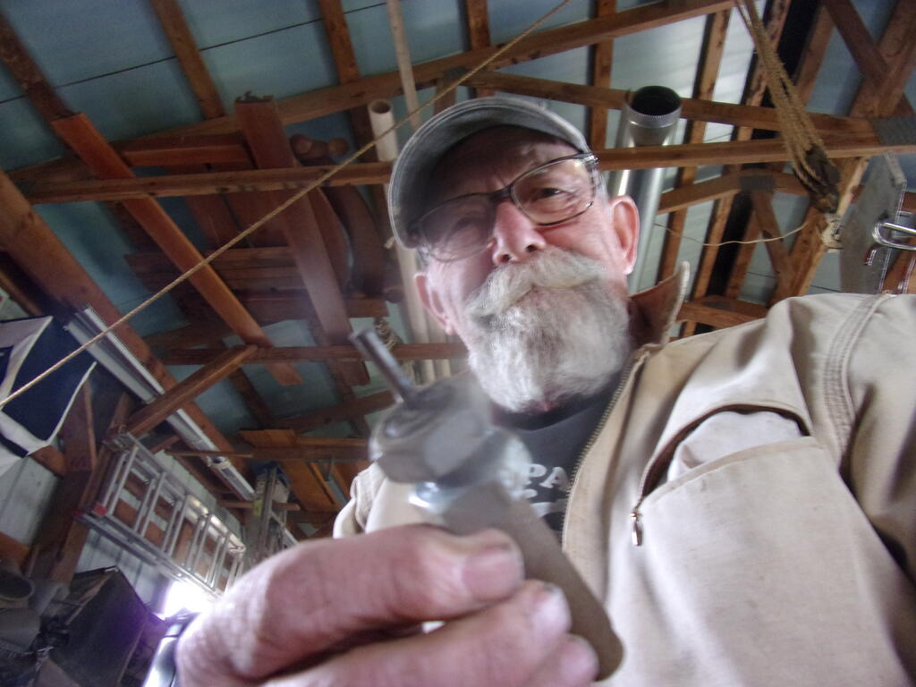

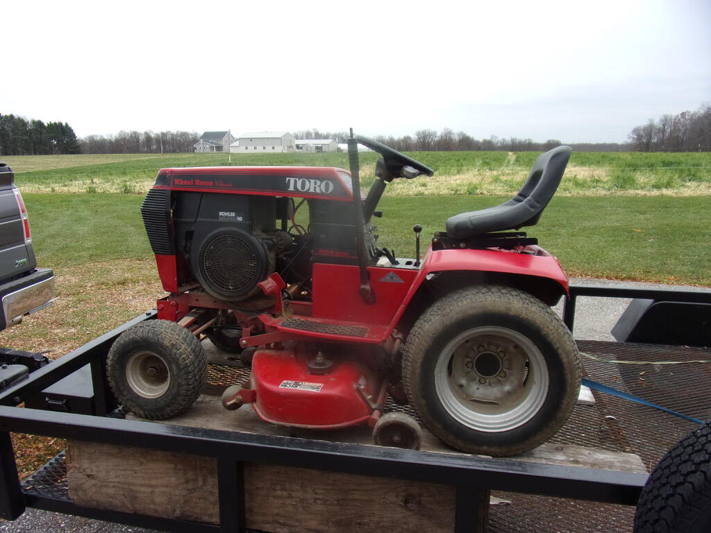

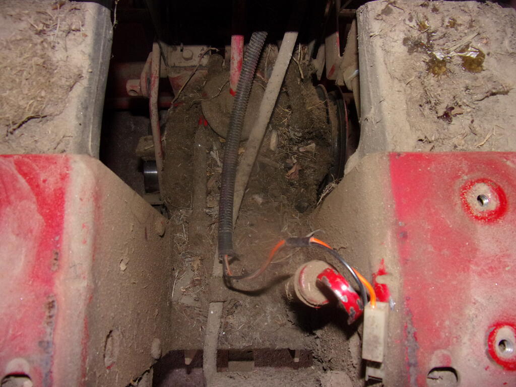

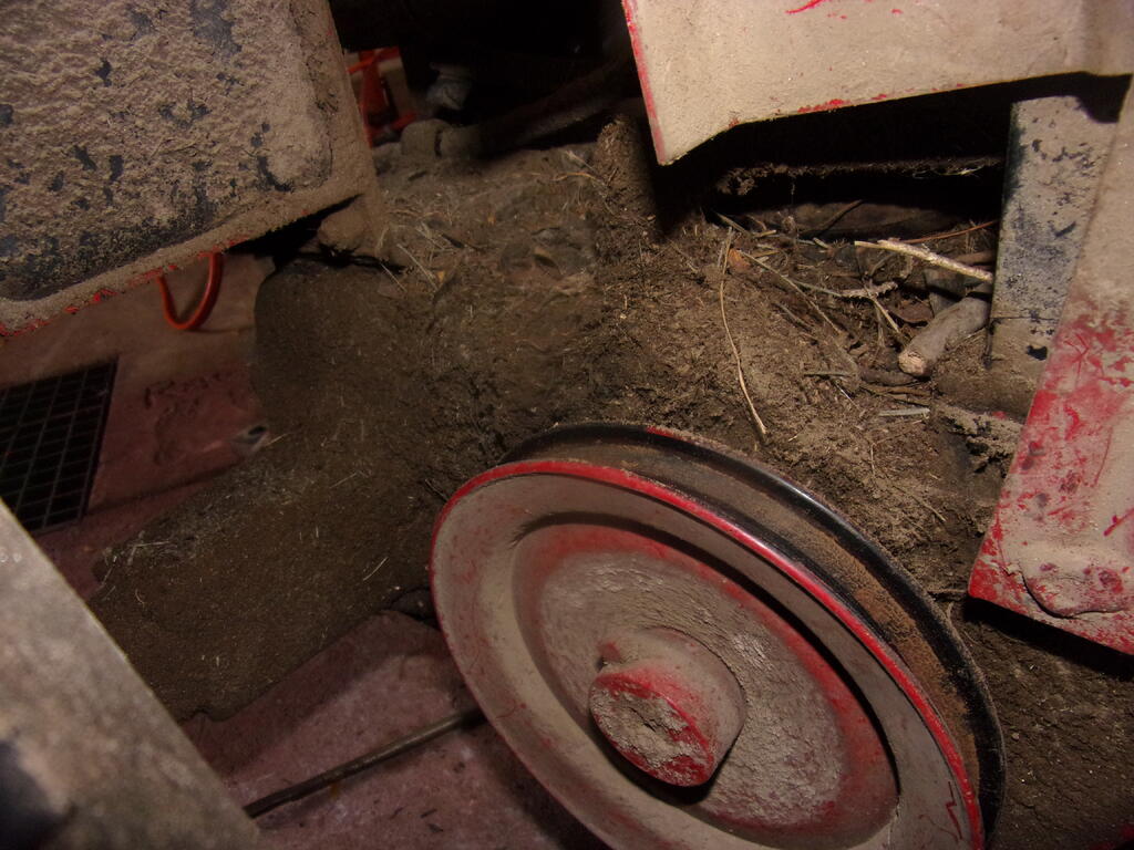

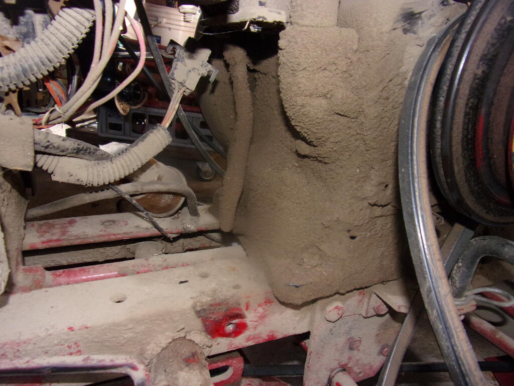

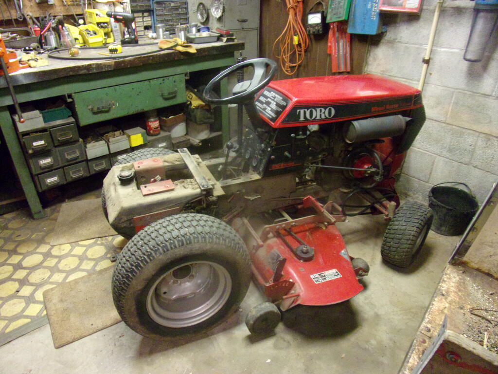

Ed Kennell 47,554 #1 Posted November 27, 2023 This is the tractor I recently purchased as a non runner with a locked up clutch pedal. I saw the ad on Marketplace and bought it for the deck. The owners Father purchased it new in 1992 and installed a new 42" SD deck in 2018. He said he was mowing this summer when the clutch locked up and now it won't start. He just wanted it gone so he could get his car in the garage. I'm a hydro guy and don't know much about these gear drives. What I found may help you gear jammers some day. I thought the belt probably came off and jammed the idler pulley against the tunnel. The belt was worn, but still in place on all three pulleys. When I pulled the tins off to find what what was locking the clutch cross shaft, I found one of the dirtiest tractors ever. Did you spot the problem? The worn belt had allowed the plate that contacts the clutch damper to go under the plunger that then sprang back out and locked the clutch. This damper and a worn belt changed this working Wheel Horse into a junk priced roller. She sounds happy to get some fresh air in her lung and the deck is quiet. 9 5 1 Share this post Link to post Share on other sites

ri702bill 13,164 #3 Posted November 27, 2023 (edited) So much for the PO's stellar Maintainence record...... But - no traces of oil leaks..... Edited November 27, 2023 by ri702bill 1 2 Share this post Link to post Share on other sites

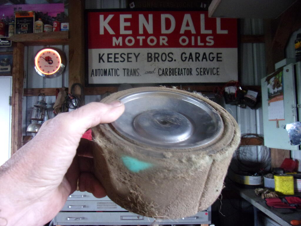

Ed Kennell 47,554 #4 Posted November 27, 2023 4 minutes ago, ri702bill said: no traces of oil leaks. Even the axle seals look tight and the differential gear oil looks clean. The engine oil is past due, but at least it's on the full mark. It just amazes me that it could even run with a 99% blocked air filter. The locked clutch may have saved this horses life. 4 2 Share this post Link to post Share on other sites

Ed Kennell 47,554 #9 Posted November 27, 2023 Does anyone know what models and years have this clutch damper? @gwest_ca Share this post Link to post Share on other sites

elcamino/wheelhorse 9,363 #11 Posted November 27, 2023 You can quit smiling any time Ed. You may want to wear a hazmat suit when you start cleaning. If you don't feel like clean it, haul it down south to my place, I work on it all winter. 4 2 Share this post Link to post Share on other sites
oldlineman 1,814 #12 Posted November 27, 2023 I have a 1989 414-8 with that damper Ed 1 Share this post Link to post Share on other sites

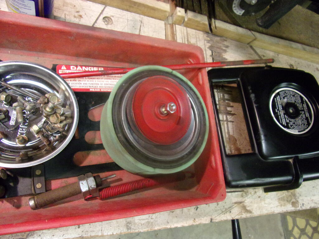

gwest_ca-(File Mod) 12,505 #13 Posted November 27, 2023 1 hour ago, Ed Kennell said: Does anyone know what models and years have this clutch damper? @gwest_ca It looks like the first version they used and was simply an air dampener. Pedal pushed down allowed air to enter it and on pedal release air was exhausted through a small hole in the back end of it. Could be a dirty environment for such a design. Have cleaned them out and returned to service. In 1991 the 416-8 started using a gas strut which was a retrofit for the older models. 1 1 Share this post Link to post Share on other sites

Racinbob 13,210 #16 Posted November 28, 2023 15 hours ago, Ed Kennell said: Does anyone know what models and years have this clutch damper? @gwest_ca Here's a service bulletin on those contraptions. WH61-90 #413 Clutch Idler Damper 1988-on.pdf - Service Bulletins - RedSquare Wheel Horse Forum I wonder how many of the 'experts' that made up these new rules ever drove a garden tractor. That was the first attempt at compliance for Wheel Horse. Two or three variations followed over the years. Fortunately you also have the spring on the left side. Ed, you know what I'd do. Share this post Link to post Share on other sites

Ed Kennell 47,554 #19 Posted November 29, 2023 On 11/28/2023 at 7:59 AM, Racinbob said: Ed, you know what I'd do Done Bob, thanks for the link. Now we know why WH added the damper........big brothers regulations trying to fix stupid by adding stupid safety devices. 1 Share this post Link to post Share on other sites

Ed Kennell 47,554 #21 Posted November 29, 2023 On 11/28/2023 at 8:33 AM, ri702bill said: A good clutch spring is all you really need. Hydraulic dampers can be sluggish in the cold; gas springs loose their charge over time. This model still has a real clutch spring.....just have to remove the stupid damper plunger. Share this post Link to post Share on other sites

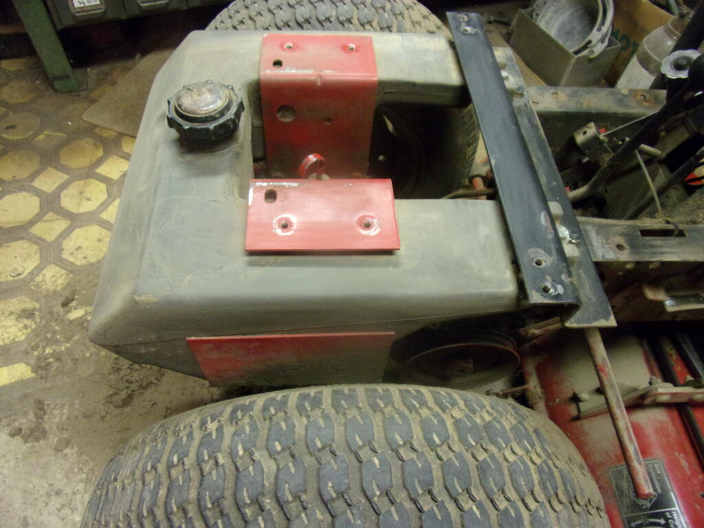

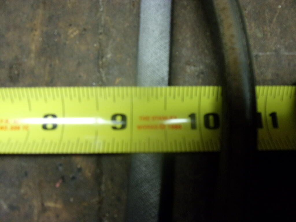

Ed Kennell 47,554 #22 Posted November 29, 2023 (edited) Too cold (20F this AM) to power wash, so I moved her into my heated shop to do some dry cleaning. There is a gas tank under the crud. The drive belt should be a 5/8 X 80.9. This one was worn down to just under 1/2" wide and measured 81.5" long and was only 3/8 thick. Off to TSC tomorrow. Edited November 29, 2023 by Ed Kennell 1 Share this post Link to post Share on other sites
