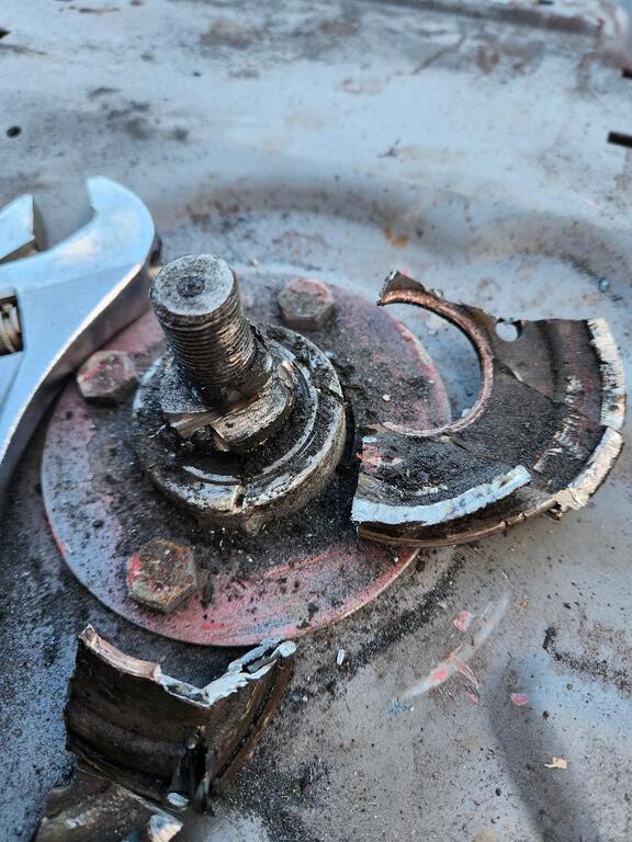

Brockport Bill 2,454 #7 Posted November 19, 2023 i asked same question here a few weeks/months ago -- after every idea possible over couple weeks, spraying, various tools etc -- -- Sadly, none worked --- it was as if pulley was welded it was so frozen -- i finally had to cut off the pulley -- then of course came the $60 cost for pulley replacement -- but heck now it has a new pulley -- haha - and my deck rehab came out pretty good - see photos 2 Share this post Link to post Share on other sites

peter lena 10,013 #11 Posted November 19, 2023 @elcamino/wheelhorse this is what works , the outer edge of a pulley is its weakest area , using 2 wonder bars , rocking on the spindle to deck bolts , opposed sides , bar edge up against the spindle hub , strong point , lets you push equally at either side of the hub. done this a number of times . makes it simple . also a good time to add a flat idler pulley , to the unsupported deck belt , bouncing play . just a suggestion , pete 1 Share this post Link to post Share on other sites
peter lena 10,013 #12 Posted November 19, 2023 @elcamino/wheelhorse that picture of the broken pulley , those spindle / deck bolts , give you the perfect , leverage / rocker snug fit for the wonder bar . like KROIL , PENETRATING OIL , first time I did this , the pulley just lifted off easily . the close bolt to pulley shoulder is key , leverage is solid smooth . any time I do a spindle re grease , just makes it simple , Pete Share this post Link to post Share on other sites

Brockport Bill 2,454 #14 Posted November 20, 2023 6 hours ago, peter lena said: @elcamino/wheelhorse that picture of the broken pulley , those spindle / deck bolts , give you the perfect , leverage / rocker snug fit for the wonder bar . like KROIL , PENETRATING OIL , first time I did this , the pulley just lifted off easily . the close bolt to pulley shoulder is key , leverage is solid smooth . any time I do a spindle re grease , just makes it simple , Pete tried the pry bars, including heat, penetrating oil, etc multiple times over a week - unfortunately pry bars wouldn't lift off the pulley Share this post Link to post Share on other sites
