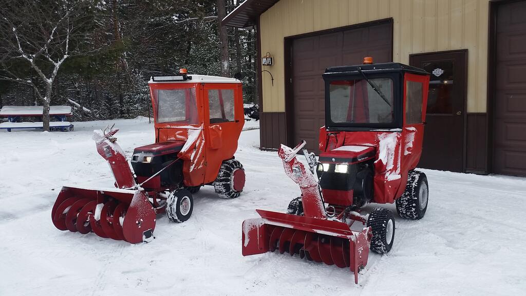

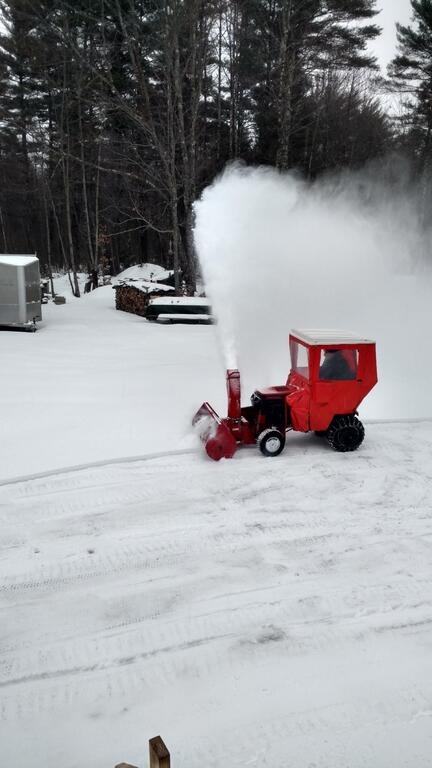

c-series don 12,361 #8 Posted November 3, 2023 Totally agree with @WHX?? nice complete ones come along now and then for a fair price. Then all you have to do is hook it up and blow snow. I have one, it’s one of my favorite attachments. If the moisture content of the snow is just right it will blow snow up to the phone wires! Mine is on a 417-A. 1 2 Share this post Link to post Share on other sites

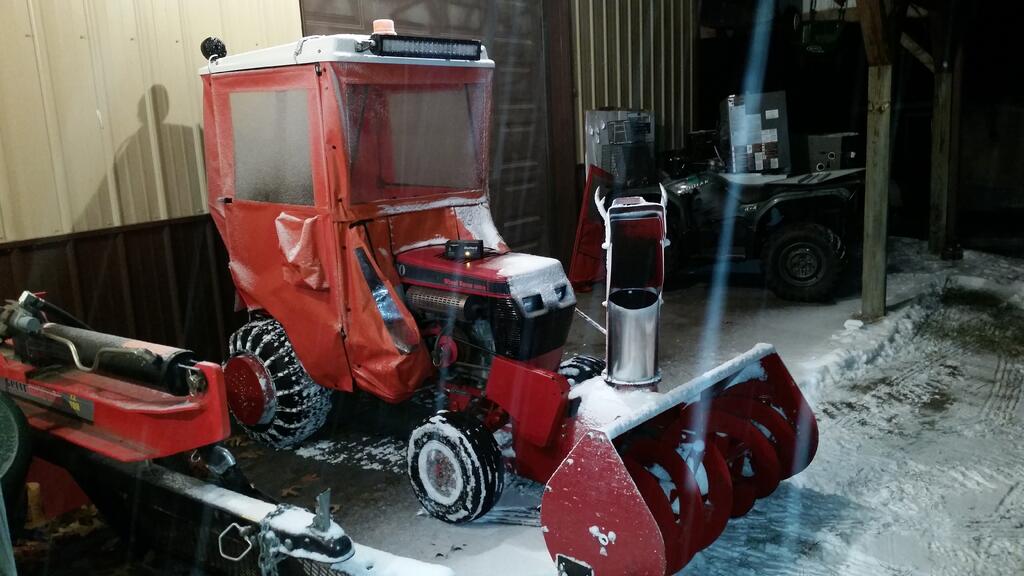

WHX?? 57,783 #9 Posted November 3, 2023 (edited) 39 minutes ago, c-series don said: it will blow snow up to the phone wires! Got that right Don. Slushy concrete not so much but cold powder look out. If your serious about moving snow with one do the mods. Rubber paddles & auger center support. Not difficult mods & been documented many times here. Pretty sure the Plunger has got one @JCM maybe he can offer additional advice. Edited November 4, 2023 by WHX?? 1 1 Share this post Link to post Share on other sites

WHX?? 57,783 #12 Posted November 4, 2023 47 minutes ago, wallfish said: There's no rocket science to them but it certainly has a unique bend. Surprisingly not as "beefy" as the SS lift poles. Got that right 'Fish... tried making one myself but I am obviously not a skilled back yard hammer mechanic. 'Nother member here had a good guy that show reproed them and scored one. I like the way you guys are putting them on 417s, 418s. Just more common to see them on 520s & such. My C160 ship ever comes in would like to mount one on that just to see what whistles. Always nice to see those pics Plunge... 2 Share this post Link to post Share on other sites

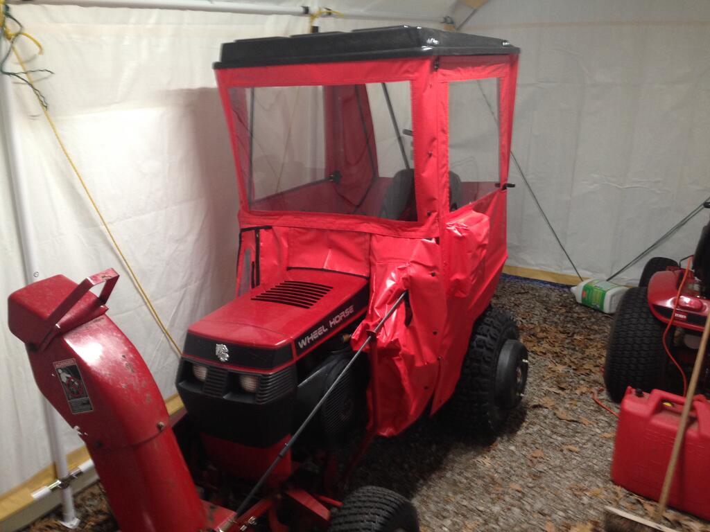

RJC1965 173 #13 Posted November 4, 2023 13 hours ago, WHX?? said: A deuce uses a whole different lift system. Hopefully it has the lift bar which is different than a single. You need to download the manual. It goes through the install on tractor & study the IPL to identify what parts may be missing. Certain missing parts brings the price way down. Very common to mount one on a 520. WHX what kind of a difference did you see adding that shield on the blower chute did you buy it or make it. Thanks 13 hours ago, WHX?? said: A deuce uses a whole different lift system. Hopefully it has the lift bar which is different than a single. You need to download the manual. It goes through the install on tractor & study the IPL to identify what parts may be missing. Certain missing parts brings the price way down. Very common to mount one on a 520. how well does the shield chute work and did you make it or buy it. 1 Share this post Link to post Share on other sites
RJC1965 173 #14 Posted November 4, 2023 19 minutes ago, WHX?? said: Got that right 'Fish... tried making one myself but I am obviously not a skilled back yard hammer mechanic. 'Nother member here had a good guy that show reproed them and scored one. I like the way you guys are putting them on 417s, 418s. Just more common to see them on 520s & such. My C160 ship ever comes in would like to mount one on that just to see what whistles. Always nice to see those pics Plunge... I have been close to buying the glass wind shield how much better do you like it as you have both and did you buy the wiper from original cab co or after market and is it electric or hand operated. You seem to have all the mods I am wanting to do. Thanks 1 Share this post Link to post Share on other sites
RJC1965 173 #15 Posted November 4, 2023 1 minute ago, RJC1965 said: I have been close to buying the glass wind shield how much better do you like it as you have both and did you buy the wiper from original cab co or after market and is it electric or hand operated. You seem to have all the mods I am wanting to do. Thanks 1 Share this post Link to post Share on other sites
wallfish 20,508 #16 Posted November 4, 2023 27 minutes ago, JCM said: Some of us know what it's like to get covered with no cab with an open station tractor when it blows back, not much fun. Before the cab and using a SS, I'd be covered and crusted with snow and ice. Fun or no big deal when you're 20 or 30 years old, Now, not so much! 11 minutes ago, WHX?? said: I like the way you guys are putting them on 417s, 418s I've been think'n about changing mine back to the 418-C. That thing cranked it out with plenty of power. Still believe it has better power than the 20 hp Onan does but it's also something I'm more familiar with. Tried tuning, adjusting, etc on the Onan but maybe I'm just a bit biased. Certainly easier working them Kohlers 3 Share this post Link to post Share on other sites
wallfish 20,508 #17 Posted November 4, 2023 2 minutes ago, RJC1965 said: I have been close to buying the glass wind shield how much better do you like it as you have both Glass windshield is the bomb!!! Easy with an electric wiper and clean the snow off with a switch. Can't do that with plastic I also use a little Harbor Freight 12v defroster heater mounted on the roof deck, Keeps the glass clear. 3 Share this post Link to post Share on other sites
RJC1965 173 #18 Posted November 4, 2023 (edited) 13 minutes ago, wallfish said: Glass windshield is the bomb!!! Easy with an electric wiper and clean the snow off with a switch. Can't do that with plastic I also use a little Harbor Freight 12v defroster heater mounted on the roof deck, Keeps the glass clear. Yup I think I may need to pull the trigger on that front glass and get a wiper for it also like the HF defrost great addition Edited November 4, 2023 by RJC1965 3 Share this post Link to post Share on other sites
