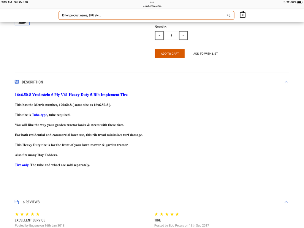

RJC1965 173 #1 Posted October 28, 2023 I am in need of replacing my front and rear tires on my 520h with a Kwik-Way loader. Many on here have suggested the Vredstein V-61. When reading the information on these they seem to suggest you need to install with inner tubes. Is it necessary to put tubes in these or are you ok going tubeless. Thanks 1 Share this post Link to post Share on other sites
ebinmaine 80,656 #2 Posted October 28, 2023 Can you link that info here? Why not use tubes? I now install tubes in every tire I swap, new or used. It makes setting the bead a non issue and fluid filling easier to accomplish. I don't see a negative to using tubes... BUT.... we don't have sharp thorns or things to cut tires other than occasional rocks. 2 1 Share this post Link to post Share on other sites
RJC1965 173 #3 Posted October 28, 2023 1 hour ago, ebinmaine said: Can you link that info here? Why not use tubes? I now install tubes in every tire I swap, new or used. It makes setting the bead a non issue and fluid filling easier to accomplish. I don't see a negative to using tubes... BUT.... we don't have sharp thorns or things to cut tires other than occasional rocks. 1 Share this post Link to post Share on other sites
RJC1965 173 #4 Posted October 28, 2023 I have a screen shot it recommends putting them in. I guess I will I tend to struggle putting them on. Maybe I will have these mounted professionally. I will likely fill them good point taken on tubes for filling. 2 Share this post Link to post Share on other sites
ebinmaine 80,656 #5 Posted October 28, 2023 50 minutes ago, RJC1965 said: it recommends putting them in. To my mind a "recommendation" is something one should do, but may do without. They used the word "required". That's a non negotiable term. I'd absolutely agree with getting the tires and tubes professionally mounted. Preferably by the same place that would fluid fill them. That way you KNOW the tubes are the proper ones for their machines. 6 Share this post Link to post Share on other sites
