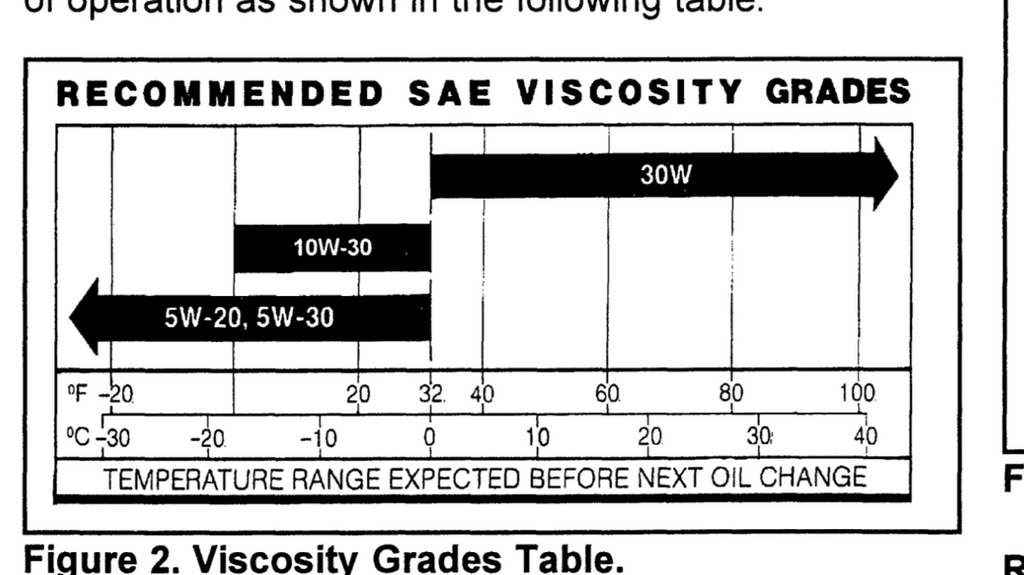

MAWHguy2019 23 #4 Posted October 20, 2023 Sylvan, do you know what the temp range is for the Shell Rotella? I thought SAE 30 was only good to 32 F. 1 Share this post Link to post Share on other sites

SylvanLakeWH 31,756 #7 Posted October 20, 2023 38 minutes ago, MAWHguy2019 said: Sylvan, do you know what the temp range is for the Shell Rotella? I thought SAE 30 was only good to 32 F. Nope. Garage kept and I warm them up. Never an issue. But I am sure it's a problem to some folks and that's ok. These are not fighter jets and it's worked really well for many years based on input from folks on this site and elsewhere who are way smarter than me. But for the record, it appears Kohler concurs with your 32 degree range. As @953 nut comments above, here's what Kohler owners manual says: 2 Share this post Link to post Share on other sites
