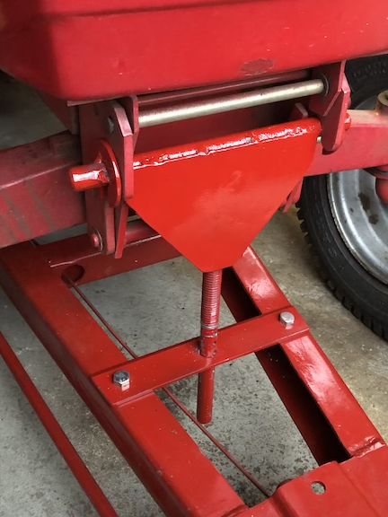

Handy Don 17,561 #5 Posted October 18, 2023 (edited) 13 hours ago, leabassett@sbcglobal.net said: Is there a lift assist spring for a snow plow blade for a 312-8? I know John Deere has them for the 212 and such. A couple of us have made a guide that helps keep the snowplow blade centered (mine is pictured below). I suspect you could add an adjustable spring to this setup to “lighten” the blade, but the trade-off would be reduced down-pressure on the blade for scraping the snow. Your question brings us to why many folks prefer a hydro (for lift and motion) when snow plowing! Edited October 18, 2023 by Handy Don 1 Share this post Link to post Share on other sites

leabassett@sbcglobal.net 190 #7 Posted October 18, 2023 I can lift it OK now but would like to know if there is a way to lighten it up some, I am thinking it will be a lot heavier when it is covered in wet snow 1 Share this post Link to post Share on other sites

wallfish 20,664 #9 Posted October 19, 2023 (edited) No reason why a spring assist couldn't be added like the blowers use. Probably doesn't need as much tension as the blower does. Personally, I like the weight on the blade and even added more to mine plus a solid link for down pressure by pushing on the handle. Wondering if it's connected to the outer most hole on the rock shaft. That would make it "heavy". You can gain mechanical advantage by moving the connection point closer to the fulcrum. Closer in to the shaft. Edited October 19, 2023 by wallfish 1 Share this post Link to post Share on other sites
