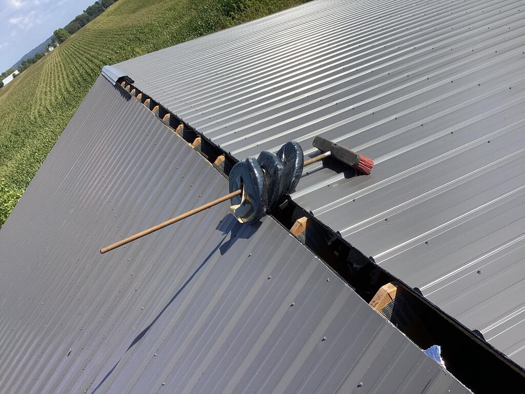

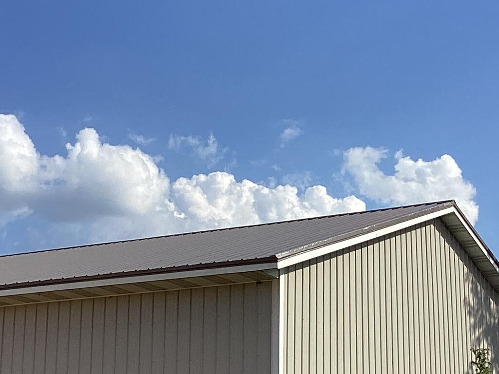

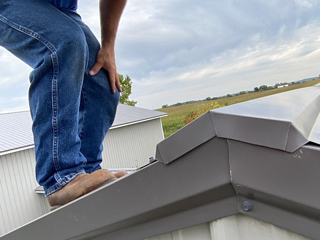

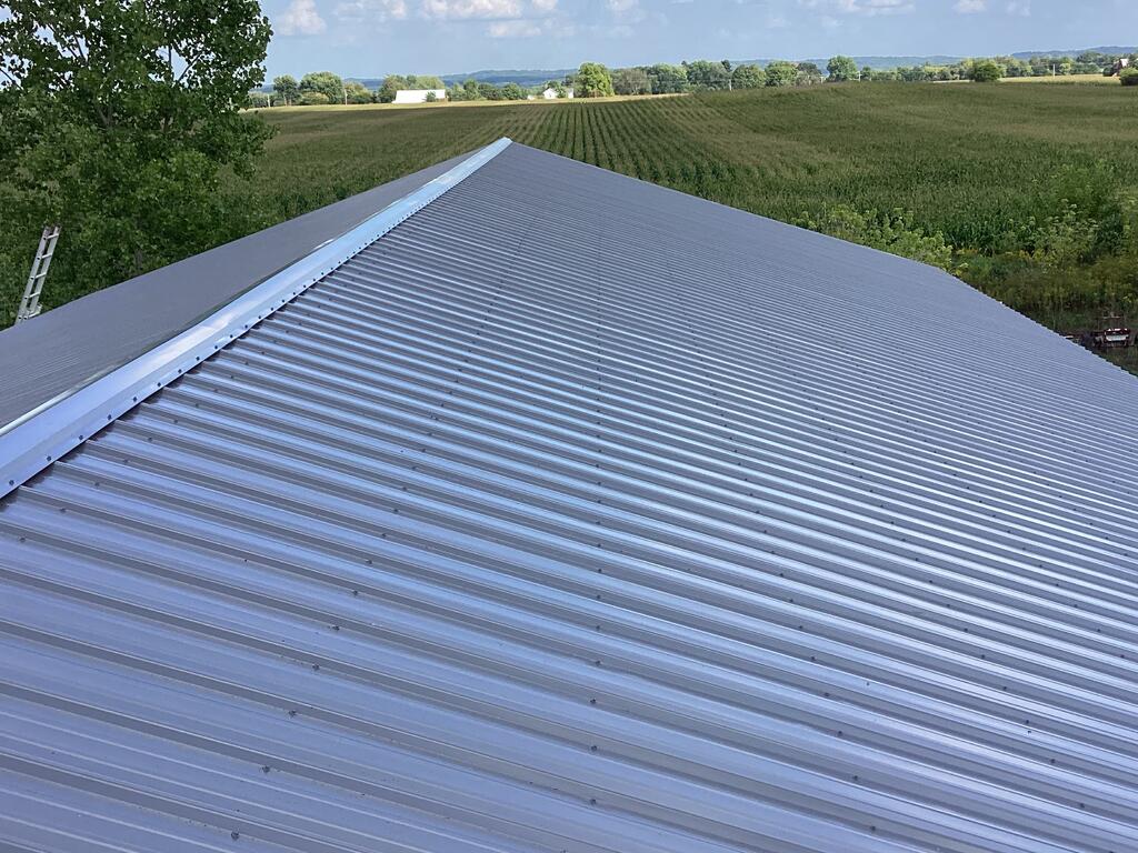

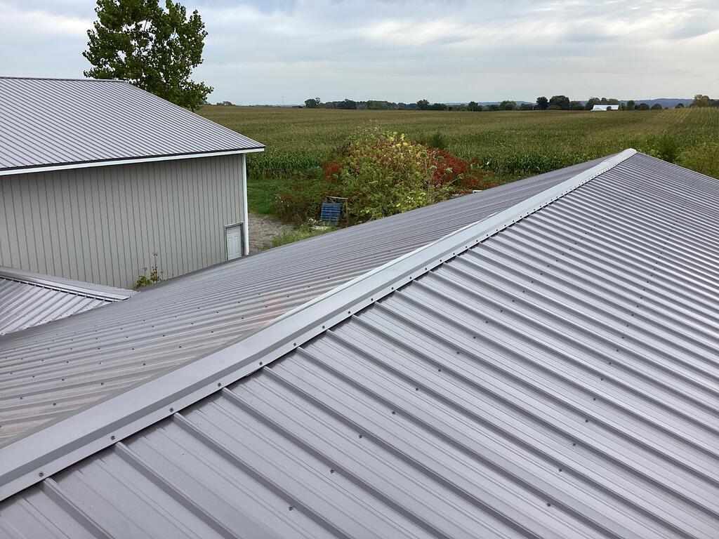

Pullstart 71,153 #6 Posted October 17, 2023 18 minutes ago, SylvanLakeWH said: @Pullstart just redid 3 barns in metal roof i believe... Kevin? only 2 I know it’s common practice to lay furring strips down and roof away, but I would never recommend that, even to my evil neighbor. Well…. Reason being, is metal will condense with temperature swings. Condensation will run down the underside of the steel, then hit the furring strip dam and eventually rot it out. Research local code, what is acceptable for going over, total layers, etc, then decide what to do. I don’t know about your average summer heat index, etc and too much heat is never great on structures. On the other hand, if it isn’t leaking and you go over it, it’s essentially another layer of protection. I prefer a premium underlayment no matter what I am roofing, it becomes the waterproof membrane. If insurance is paying for it and you’re doing the work, you can surely afford a good underlayment. This stuff I recently used was a foil backed bubble wrap type stuff. No matter what you decide, do not cheap out on ventilation! It is as important as the roof itself! 7 1 Share this post Link to post Share on other sites

RandyLittrell 3,945 #9 Posted October 17, 2023 2 hours ago, Pullstart said: only 2 I know it’s common practice to lay furring strips down and roof away, but I would never recommend that, even to my evil neighbor. Well…. Reason being, is metal will condense with temperature swings. Condensation will run down the underside of the steel, then hit the furring strip dam and eventually rot it out. Research local code, what is acceptable for going over, total layers, etc, then decide what to do. I don’t know about your average summer heat index, etc and too much heat is never great on structures. On the other hand, if it isn’t leaking and you go over it, it’s essentially another layer of protection. I prefer a premium underlayment no matter what I am roofing, it becomes the waterproof membrane. If insurance is paying for it and you’re doing the work, you can surely afford a good underlayment. This stuff I recently used was a foil backed bubble wrap type stuff. No matter what you decide, do not cheap out on ventilation! It is as important as the roof itself! Thank you Kevin!! What you posted is pretty much what I had in mind, just wanted to hear from you guys. I do believe in stripping it down and in the quality membrane under it. I have 4 aluminum vents that just got demolished and thought a ridge vent with metal is the way to go.. Your roofs look very nice, you do good work!! Thank you for the video link, I will get to watching!! Randy 1 1 Share this post Link to post Share on other sites

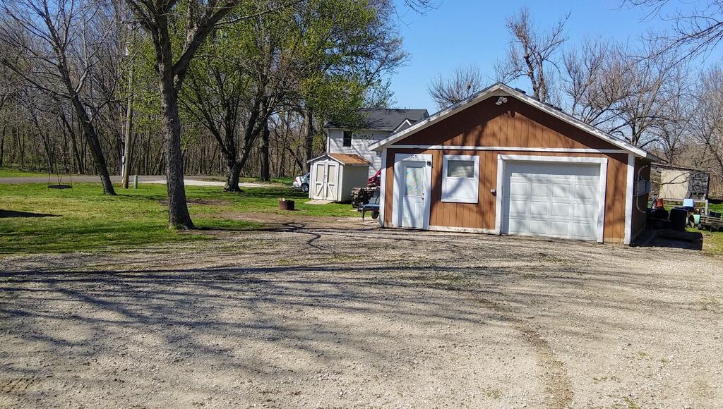

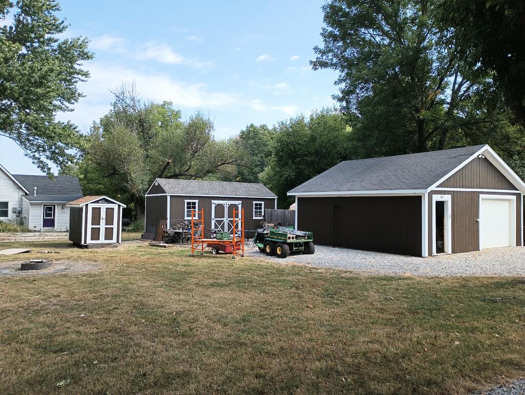

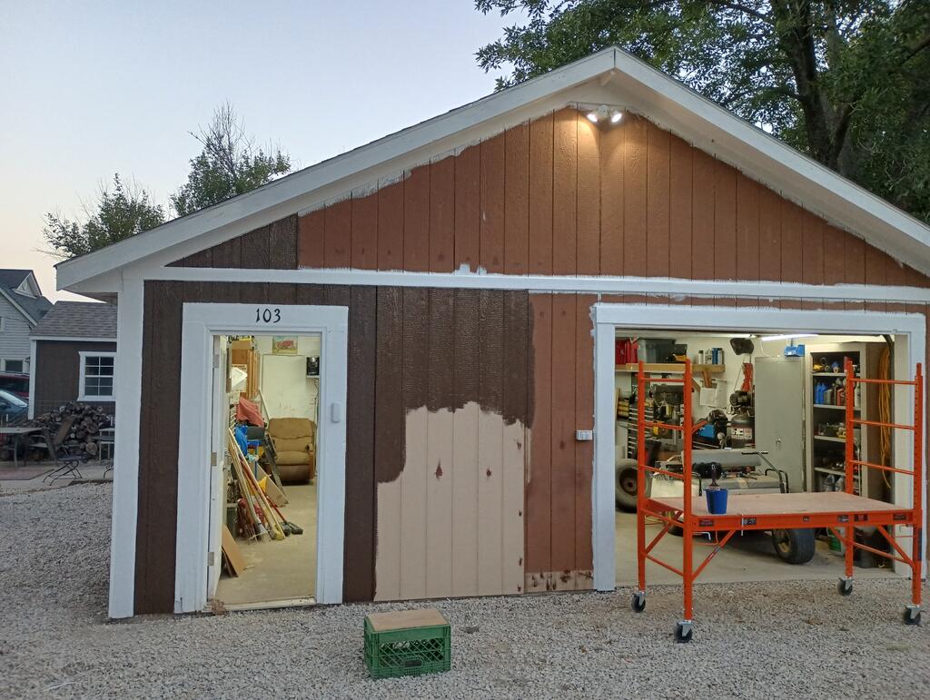

RandyLittrell 3,945 #10 Posted October 17, 2023 (edited) Here is what the shop and shed looked like before I started, now to just decide on the color of roof. White or brown is about the only choice with dark brown exterior. I bought a scaffold to help with the painting and it will most likely help with the roofing! Edited October 17, 2023 by RandyLittrell 3 Share this post Link to post Share on other sites

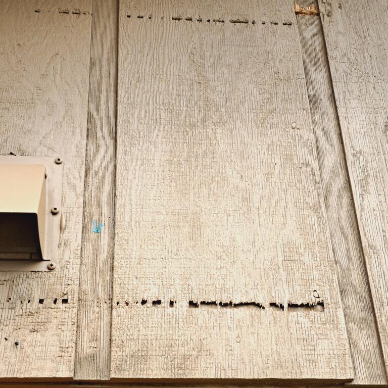

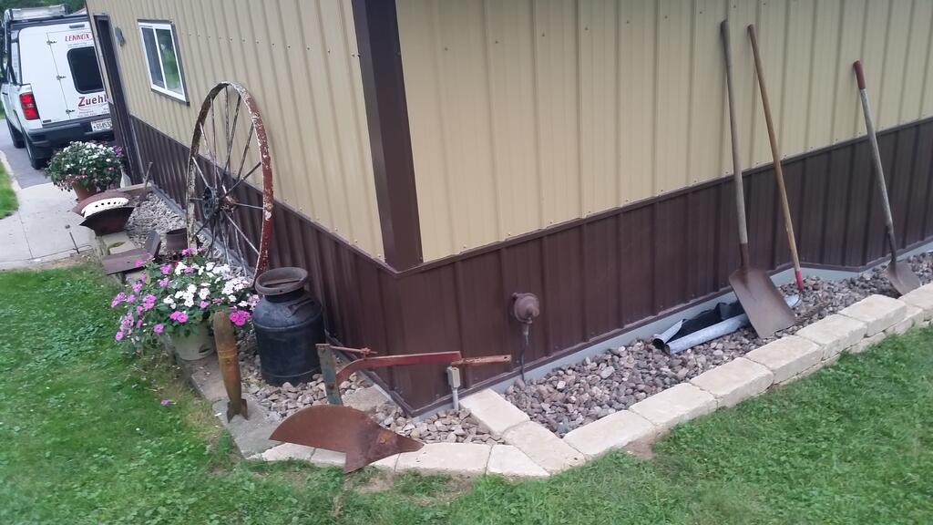

WHX?? 57,886 #13 Posted October 18, 2023 2 hours ago, RandyLittrell said: Your roofs look very nice, you do good work!! Don't tell Kev I said this he'll get a big head...but his roofs do look nice... T-111 siding Randy? I woulda been real tempted to cover that with steel too. Best thing that I did to my shop. This was over RB & B ... same junk as T-111. Get to be my age maintenance free is a real winner. 3 1 Share this post Link to post Share on other sites
WHX?? 57,886 #14 Posted October 18, 2023 1 hour ago, 953 nut said: prevent condensation from being able to form. They do offer a panel with a felt like coating on the underside now to prevent condensation. Regretfully unheard of in my day tho. My big warehouse has nothing and if conditions are just right it has been known to rain in ther. More so in the open air lean to. Now @953 nut needs to come and resurface the table saw... 1 1 Share this post Link to post Share on other sites
RandyLittrell 3,945 #15 Posted October 18, 2023 32 minutes ago, WHX?? said: Don't tell Kev I said this he'll get a big head...but his roofs do look nice... T-111 siding Randy? I woulda been real tempted to cover that with steel too. Best thing that I did to my shop. This was over RB & B ... same junk as T-111. Get to be my age maintenance free is a real winner. Yes, it is T-111 and it has some issues. But......I gave 10 grand for the property and the 2 car garage 8 years ago. I have added the big shed and luckily I bought it before Covid prices. The little shed I bought used for $200 and drug it home on my car trailer. I have about $500 in paint and my labor and I am just happy to have a nice place to play with my toys. The guy that built it knew about electrical, but nothing about pouring concrete of building a wooden structure. There isn't anything straight or level in the whole place. I can't imagine trying to make nice square metal siding fit it!!! I haven't put the tape to it yet, but I wouldn't doubt the roof isn't square either. I am trying to do the right thing but may end up going the easy route and just put shingles on again. I have a lot to process before I jump into the roof, it's not leaking at the moment, so I have some time to think. Thanks for all the help folks!!!! Randy 2 2 Share this post Link to post Share on other sites

Pullstart 71,153 #19 Posted October 18, 2023 I generally set my skill saw about 2” from the ridge on either side and rip away. Not a ton of precision in that cut. Once the steel is on, there is a very spongy synthetic ridge vent roll. On my pictures above, they were stabbed through by my shop broom. These had a sealant strip on them and stuck to the steel. The ridge cap then goes over that and smushes it in place. Bugs cannot penetrate and apparently water doesn’t either! One thing to think about, and the value is priceless as well, is a few hand tools needed for steel. I have an assortment of hand shears, and a 4” hand brake. My work shop barn has a lean to off the back of it. The roof line is 36’ long. The steel supplier recommended a 6” overlap if I chose to put up two panels. I went with a 19’ panel, which yielded 2’ overlap. Overkill? Yup. Worth the extra $112.20? Absolutely! 2 Share this post Link to post Share on other sites

WHX?? 57,886 #21 Posted October 18, 2023 5 hours ago, 953 nut said: I could do a virtual resurfacing Already done Richard... steel wool rust remover and alot of elbow grease. It's kept oiled and covered now. The 111 on the shop was defective. When it went through rollers the machine that applied material down skipped a beat for lack of a better word. It left horizontal voids. Bugs then went in it. Wood peckers then went after the bugs. Some instances right through the sheeting. Try that on steel Woody! Manufacturer Louisiana Pacific pretty much told me to pack sand. Wished we woulda had social media back then I'd left em smoking. This is RB & B style but same thing as 111 just grooved different. 3 2 Share this post Link to post Share on other sites
