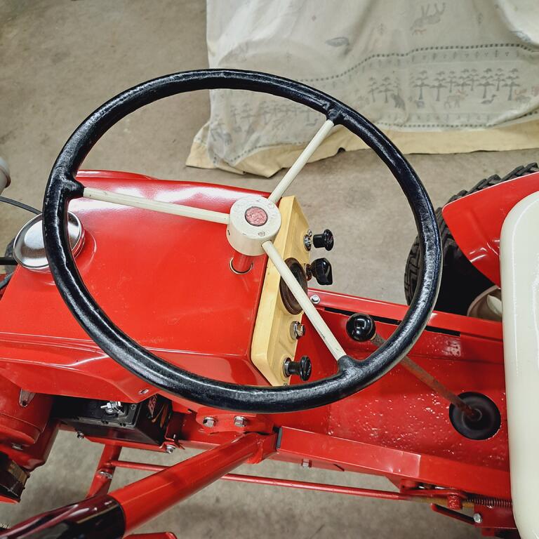

WHX?? 58,079 #6 Posted August 9, 2023 (edited) Gotta keep this guy in favorites. https://www.evergreengauges.com/steeringwheels Thanks @Wild Bill 633 this I did not know. And right here in WI ! Wonder if he can do the hen's teeth flat ones on '62 '63 models? I just did one with PC-7 at the advice of @oliver2-44 and it worked nicely. Lots of hand sanding but sands easily. Finished by a couple of coats of bedliner. Some have used body filler with good results. Another option is replace it with a new one. The replacement is splined for JDs but can be bored to 3/4. @Achto used one on a resto. Edited August 9, 2023 by WHX?? 4 Share this post Link to post Share on other sites

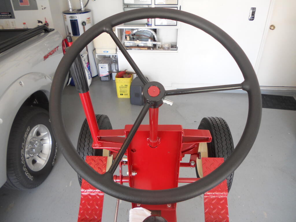

Achto 32,641 #7 Posted August 9, 2023 (edited) 50 minutes ago, WHX?? said: Another option is replace it with a new one. The replacement is splined for JDs but can be bored to 3/4. @Achto used one on a resto. This is the wheel that I used on my 701. Like Jim stated, I drilled the splined 11/16" hole out to 3/4" then cross drilled it for the roll pin. https://www.steinertractor.com/GTS002-Steering-Wheel Edited August 9, 2023 by Achto 7 1 Share this post Link to post Share on other sites

WHX?? 58,079 #12 Posted August 9, 2023 (edited) I have some that are way beyond PC7 or anything. Hence the bedliner Ollie. After the first coat it revealed some small cracks & imperfections I missed. The bed liner filled them right in. ! used a dremel with a sand drum to highlight & sand the finger grooves. @Racinbob did one with bedliner that looks nice he's the one who skooled me on it. Edited August 9, 2023 by WHX?? 2 Share this post Link to post Share on other sites

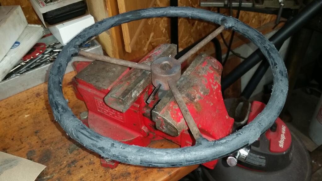

Racinbob 13,139 #13 Posted August 9, 2023 39 minutes ago, WHX?? said: I have some that are way beyond PC7 or anything. Hence the bedliner Ollie. After the first coat it revealed some small cracks & imperfections I missed. The bed liner filled them right in. ! used a dremel with a sand drum to highlight & sand the finger grooves. @Racinbob did one with bedliner that looks nice he's the one who skooled me on it. Here it is. It wasn't totally down to just a bare metal rim but the plastic was cracked and gouged pretty bad. I used bondo and sanding. Then Dupont bed spray in the black can, not the blue can. I tried the blue can as well as Rusteolum on other projects and didn't care for them. I like the looks and feel of this stuff. It's been about five years now and still holding up well. 2 2 1 Share this post Link to post Share on other sites

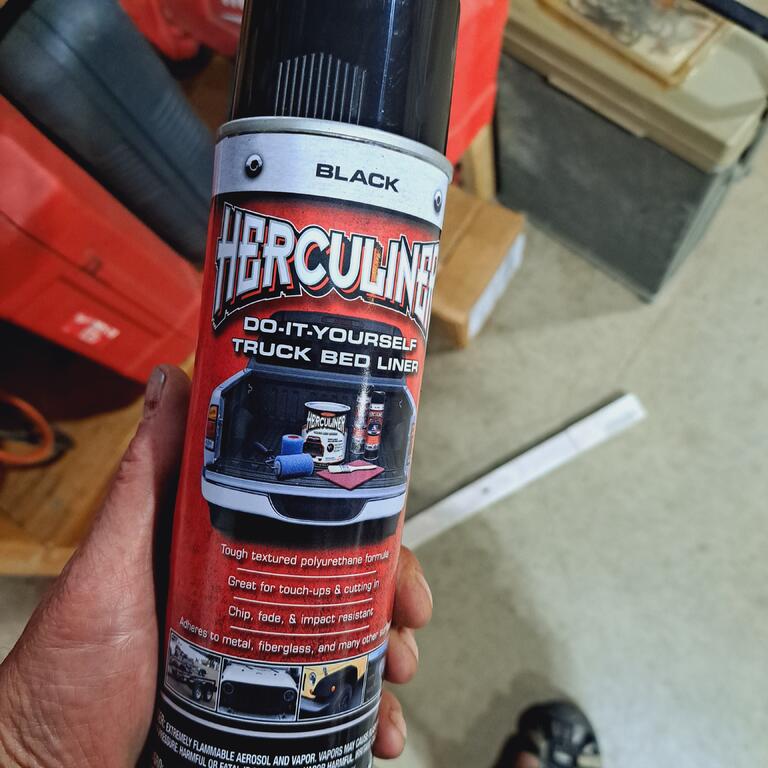

WHX?? 58,079 #14 Posted August 10, 2023 1 hour ago, Racinbob said: didn't care for them. I like the looks and feel of this stuff I hear ya Bob. I did this 400 oh golly 5 years or better ago. It was not cracked or anything but if you even looked at it crooked it left black stains on your hands. Kinda like anti seize ain't that right @Pullstart. I don't remember what brand it was but it worked after a small test. Gave a nice rubberized grip and sealed all the black inside... The product I used on the 701 above was this product ... 1st pic ...Left a nice glossy coat but not the rubberized grip. They had several brands so it was enni mennie mighty moe given my CRS. Still satisfactory so all is good. 2 1 Share this post Link to post Share on other sites
