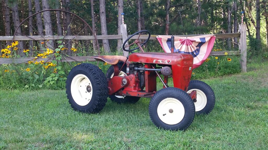

WHX?? 58,324 #21 Posted August 11, 2023 (edited) I used linseed on this tractor and like the patina. I also did this one with it. Note the tranny top cover has not been done yet. The before look. Edited August 11, 2023 by WHX?? 2 1 Share this post Link to post Share on other sites
