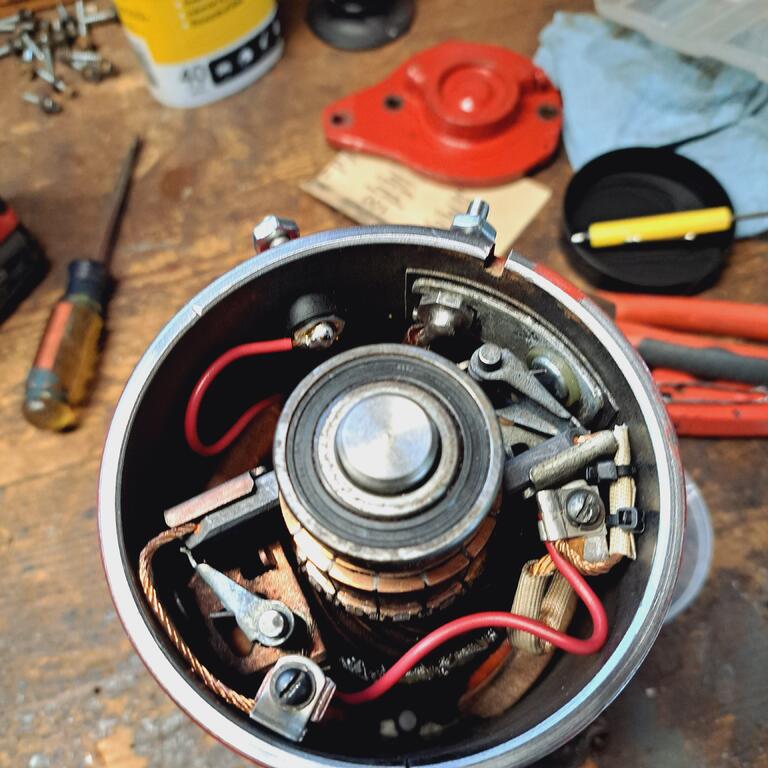

WHX?? 54,976 #1 Posted July 21, 2023 Completely rebuilt... new field coils, new armature, new brushes. All done by a pro auto electrical shop that does nothing but these and advertising in vintage restorations. Still will not turn motor over. Wheels it over big time with no plug in the hole but sometimes needs a a helping twist To get things rolling. Just seems ther is no starting torque. New belts but won't even slip them when loose. Fresh built K161 that runs great and compression that won't quit. What could I be missing? 1 Share this post Link to post Share on other sites

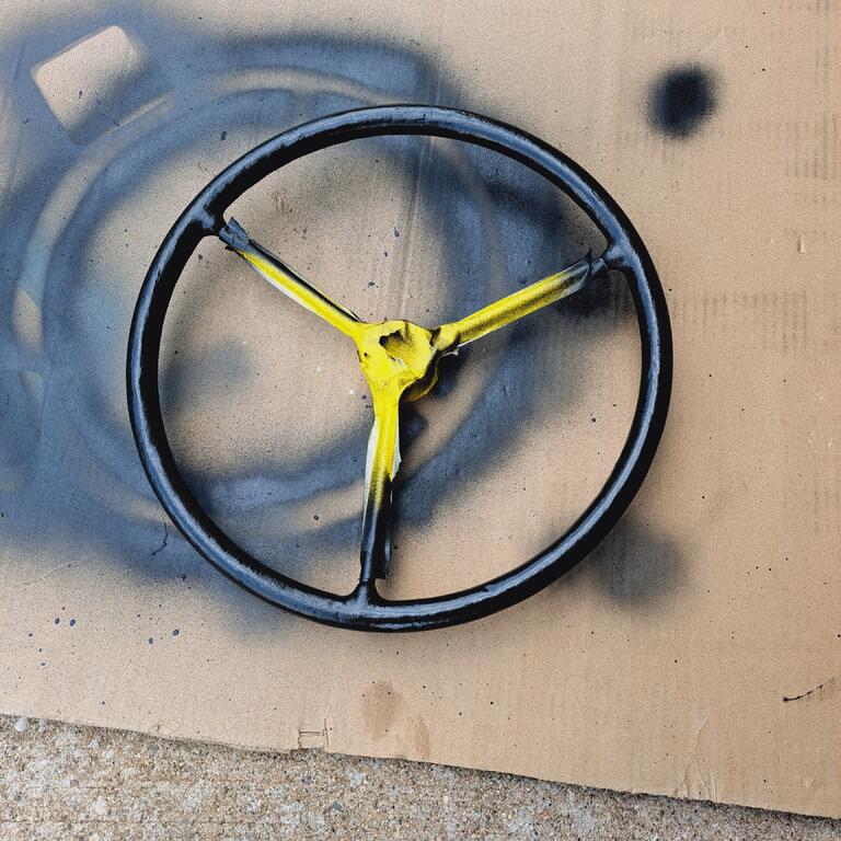

WHX?? 54,976 #18 Posted July 23, 2023 (edited) So pulled the starter again and cleaned the paint off surfaces. Was abit red... & added star washers. Zero ohms between regulator body and B -. Seems to pull a bit better and actually started it but had give it a helping twist by hand. Once it gets rolling and the flywheel has some inertia runs it no problem. Finished restoring the steering wheel so get that on and put some hours on the motor. @oliver2-44 PC-7 and lots of sanding. Don't much care for the bedliner i got. Doesn’t have that rubber feel to it but is glossy. Edited July 23, 2023 by WHX?? 2 1 Share this post Link to post Share on other sites

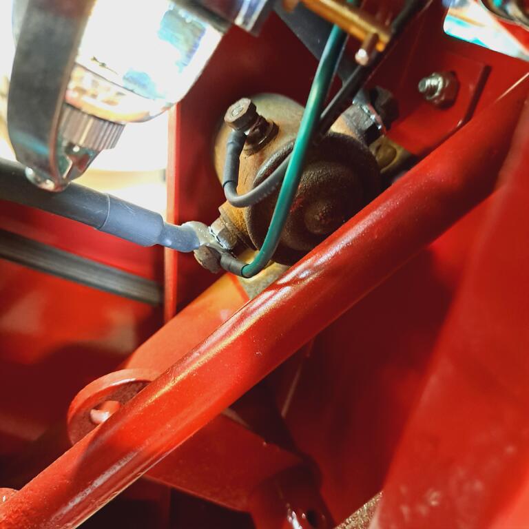

WHX?? 54,976 #20 Posted July 23, 2023 I had thought of that but the DMM says yes. I used the old solenoid cause it had a nice patina and thought maybe dropping voltage thru that but checked good. Maybe those cables that Dan made me are bogus... think I should ask for my money back? 1 4 Share this post Link to post Share on other sites
ineedanother 1,872 #21 Posted July 23, 2023 3 minutes ago, WHX?? said: I had thought of that but the DMM says yes. I used the old solenoid cause it had a nice patina and thought maybe dropping voltage thru that but checked good. Maybe those cables that Dan made me are bogus... think I should ask for my money back? I definitely don't want to start anything so I would swap the solenoid just to be sure @Achto or some other Dan isn't at fault here... 1 1 Share this post Link to post Share on other sites
