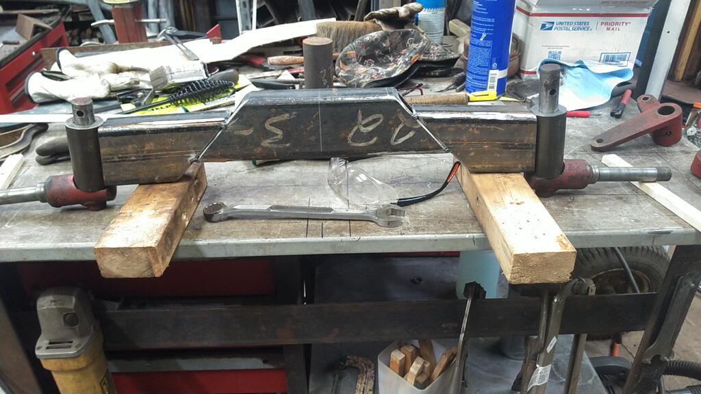

JPWH 6,544 #101 Posted July 23, 2023 Axle cut to length and tacked. Spindle bushings made. Need a little more fitting for the spindle bushings to axle and grease zerks installed. Also need to machine the bushings for thrust bearings. Axle pivot pin bushing is the next major task. 6 7 Share this post Link to post Share on other sites

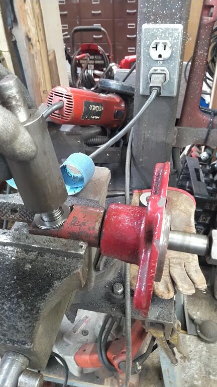

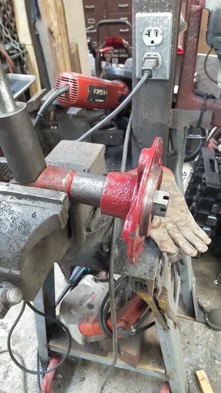

JPWH 6,544 #102 Posted July 30, 2023 (edited) Machined one hub today. Had to make a spacer so the hub would fit right. Also got the spindle sleeves machined for the thrust bearings. Edited July 30, 2023 by JPWH 5 8 Share this post Link to post Share on other sites
Pullstart 71,259 #103 Posted July 30, 2023 8 hours ago, JPWH said: Machined one hub today. Had to make a spacer so the hub would fit right. Also got the spindle sleeves machined for the thrust bearings. Awesome idea! We have another tractor that might get 10” front wheels like Poppy my 552 and tapered bearings in the hub is a sweet thought! 4 1 Share this post Link to post Share on other sites
19richie66 17,935 #104 Posted July 30, 2023 Interesting….. what bearings are you using in the front? Share this post Link to post Share on other sites
JPWH 6,544 #105 Posted July 30, 2023 (edited) 56 minutes ago, 19richie66 said: Interesting….. what bearings are you using in the front? Gt 14 bearings. I just machined the hub to the same diameter the wheel would be. Edited July 30, 2023 by JPWH 2 4 Share this post Link to post Share on other sites
19richie66 17,935 #106 Posted July 30, 2023 5 hours ago, JPWH said: Gt 14 bearings. I just machined the hub to the same diameter the wheel would be. Excellent 1 Share this post Link to post Share on other sites

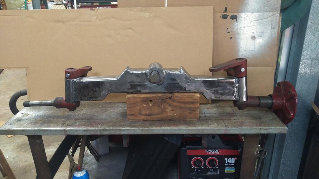

953 nut 69,357 #110 Posted August 1, 2023 On 7/22/2023 at 8:38 PM, JPWH said: Axle cut to length and tacked. Spindle bushings made. Need a little more fitting for the spindle bushings to axle and grease zerks installed. Also need to machine the bushings for thrust bearings. Axle pivot pin bushing is the next major task. Looking at the front axle layout your Tie-rod may be quite close to the bottom of the frame, might have to check that out before you committ to it and start the welding. Perhaps the spindles could be lowered a bit if clearance is a problem. 4 Share this post Link to post Share on other sites
JPWH 6,544 #111 Posted August 1, 2023 1 hour ago, 953 nut said: Looking at the front axle layout your Tie-rod may be quite close to the bottom of the frame, might have to check that out before you committ to it and start the welding. Perhaps the spindles could be lowered a bit if clearance is a problem. Thanks for pointing that out Dick. I have not thought about tie rod clearance. I'll check it before I install the axle pivot. 4 Share this post Link to post Share on other sites
JPWH 6,544 #112 Posted August 1, 2023 7 hours ago, JPWH said: Thanks for pointing that out Dick. I have not thought about tie rod clearance. I'll check it before I install the axle pivot. I checked for tie rod clearance and you were correct. I have a solution figured out that also makes installing the axle pivot easier. Thanks again Dick. 3 3 Share this post Link to post Share on other sites

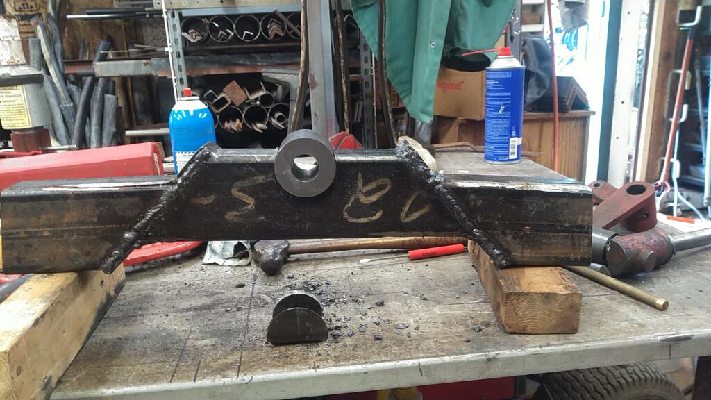

JPWH 6,544 #115 Posted August 19, 2023 (edited) A little more progress today. Welded up the axle. Still need to clean up all the welds. I also machined the axle pivot pin sleeve and cut the hole to mount it in the axle. Edited August 19, 2023 by JPWH 9 4 Share this post Link to post Share on other sites

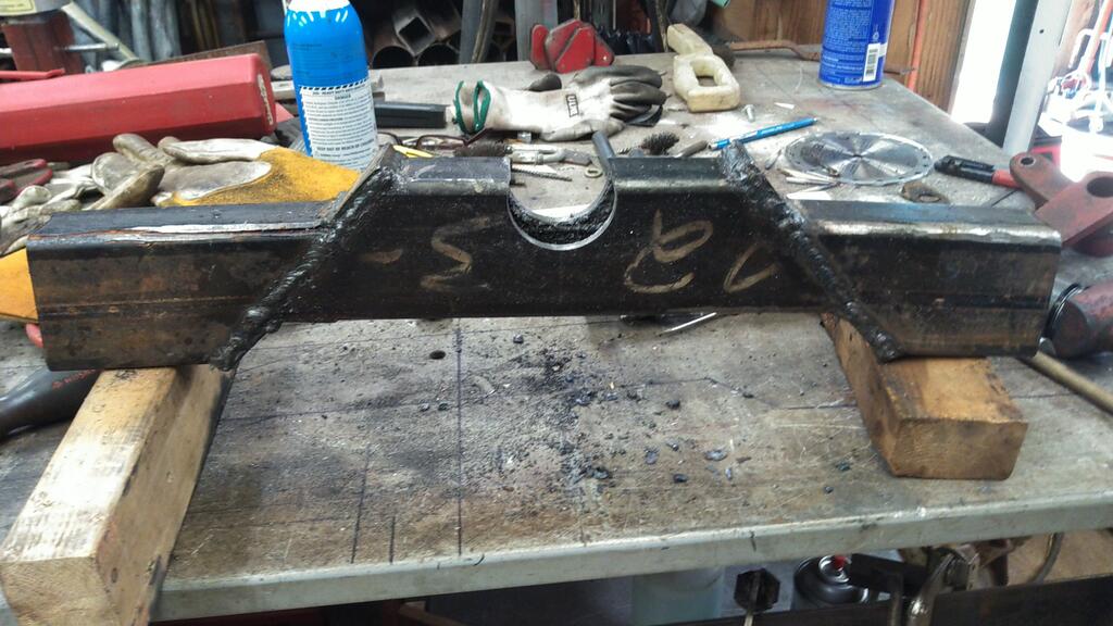

JPWH 6,544 #117 Posted September 4, 2023 I got the axle almost finished today. Some more welding to do on the ends and one more hub assembly to build. 12 Share this post Link to post Share on other sites
