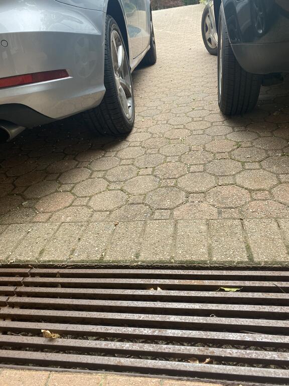

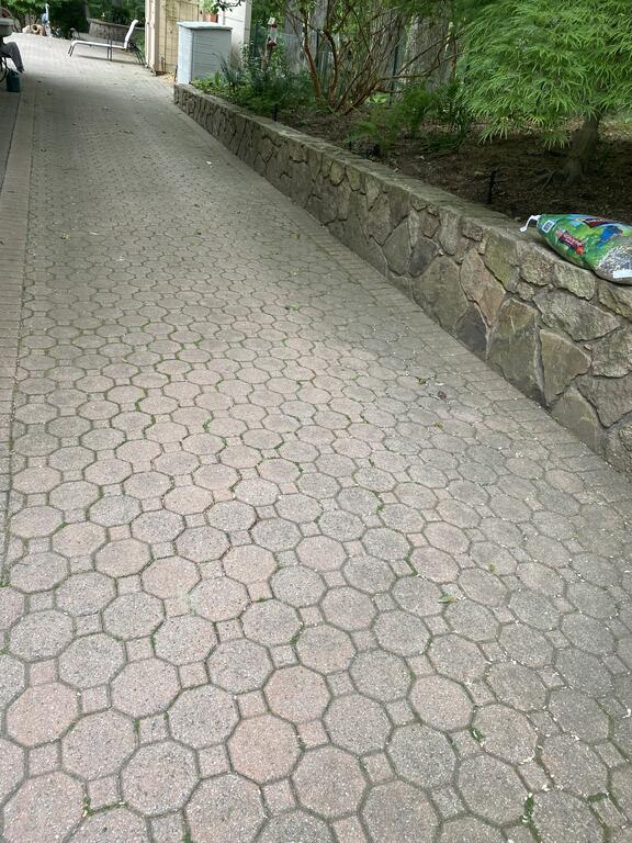

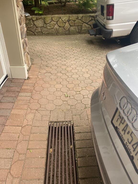

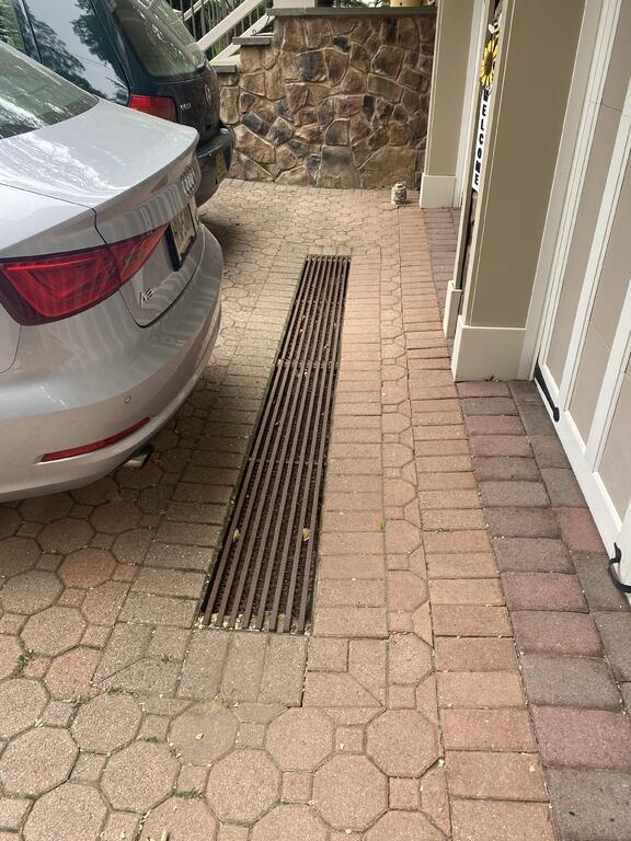

formariz 12,359 #26 Posted June 3, 2023 This one catches all the water from the steep driveway. It has also the front gutters piped into it. It then goes into another tank and it then goes underground into stream. Soon it’s going to have a large sump pump built into it to speed up draining from drive way rather than just relying on gravity. It is sufficient now but it does fill up on a heavy downpour. If it does overflow , driveway around it is canted to the right side putting all excess water to the back . Of course when stream across street blows up then nothing works. It has only happened 3 times in about 40 years but it was no fun. We are fully aware here of the power of water. I am constantly making improvements as far as drainage goes all around property. driveway and front gutters drain driveway is steep in case of drain filling excess water drains to right side of house water then flows to back where it is channeled by next system. 3 Share this post Link to post Share on other sites
Horse Newbie 7,402 #27 Posted June 3, 2023 1 hour ago, formariz said: Tank is not that large. It’s more of a junction box for all the pipes going into it. It’s accessible for cleaning or unclogging if necessary. Top of it is under the 5+ inches of stone. Exit from tank is also much larger than the inlets into it. I have a similar system in the main driveway in front of house. Yes sounds like a junction box… looks like you came up with a good plan to take care of the water problem, and also built it almost bulletproof, as Greasy Pete would say… I say almost bulletproof because mother nature’s gonna have her way. 2 Share this post Link to post Share on other sites
Horse Newbie 7,402 #28 Posted June 3, 2023 (edited) 1 hour ago, formariz said: This one catches all the water from the steep driveway. It has also the front gutters piped into it. It then goes into another tank and it then goes underground into stream. Soon it’s going to have a large sump pump built into it to speed up draining from drive way rather than just relying on gravity. It is sufficient now but it does fill up on a heavy downpour. If it does overflow , driveway around it is canted to the right side putting all excess water to the back . Of course when stream across street blows up then nothing works. It has only happened 3 times in about 40 years but it was no fun. We are fully aware here of the power of water. I am constantly making improvements as far as drainage goes all around property. driveway and front gutters drain driveway is steep in case of drain filling excess water drains to right side of house water then flows to back where it is channeled by next system. Man that is some nice hardscape ! All I have is plain old concrete, but I’m thankful for it ! Edited June 3, 2023 by Horse Newbie 2 Share this post Link to post Share on other sites

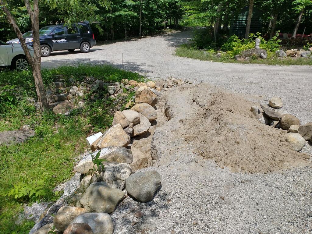

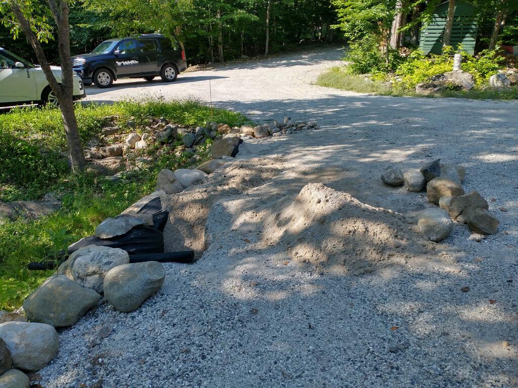

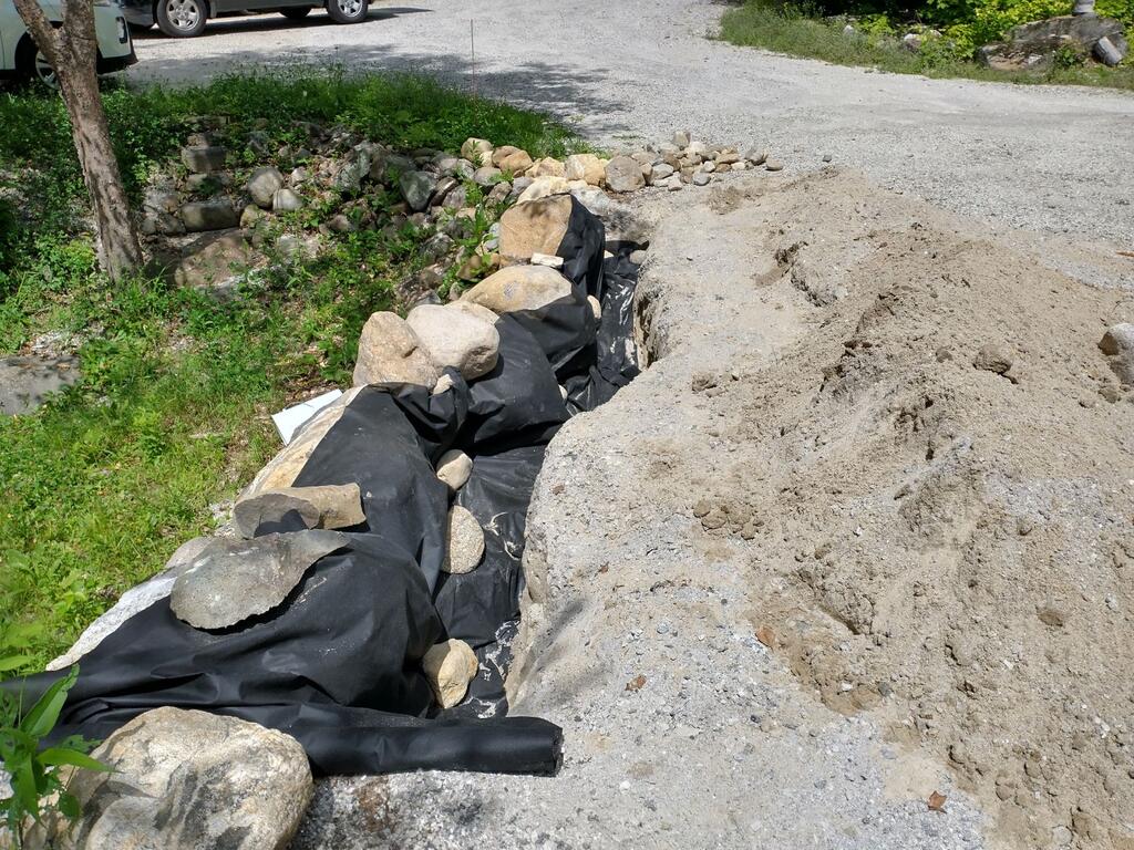

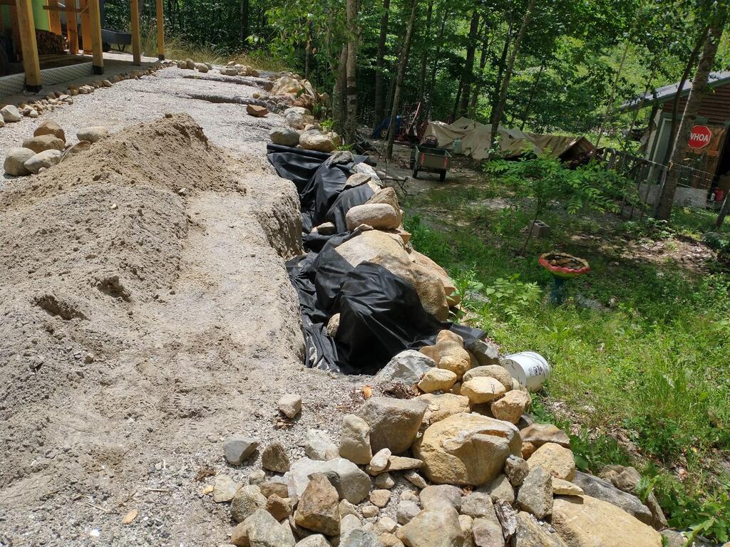

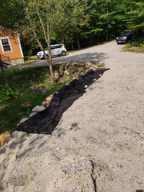

ebinmaine 78,380 #38 Posted July 23, 2023 Been doing some serious digging today. This ditch is just over 13' long and about knee deep one end, mid thigh the other. We layed in the landscaping cloth and I've started backfilling. 1 Share this post Link to post Share on other sites
ebinmaine 78,380 #39 Posted July 23, 2023 Got good progress done today. About 10 or 11 feet filled in. 2 1 Share this post Link to post Share on other sites

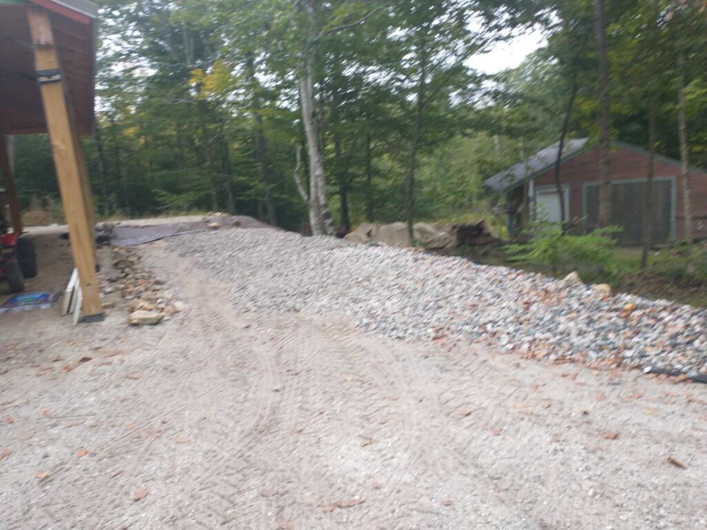

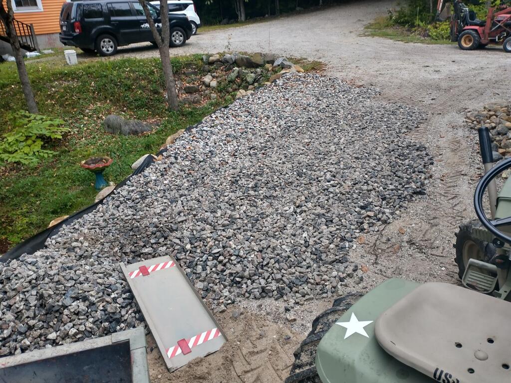

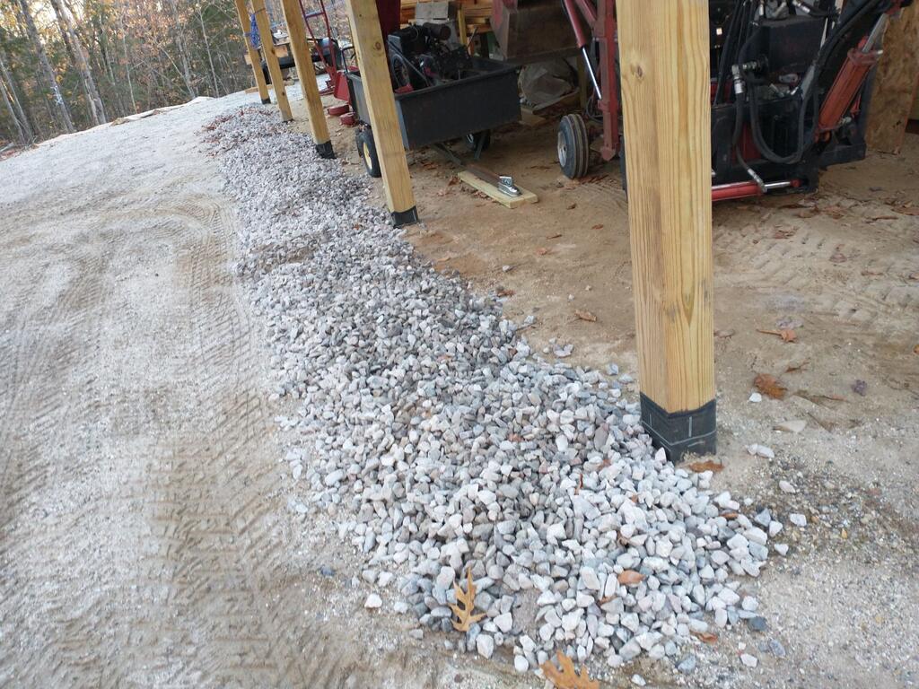

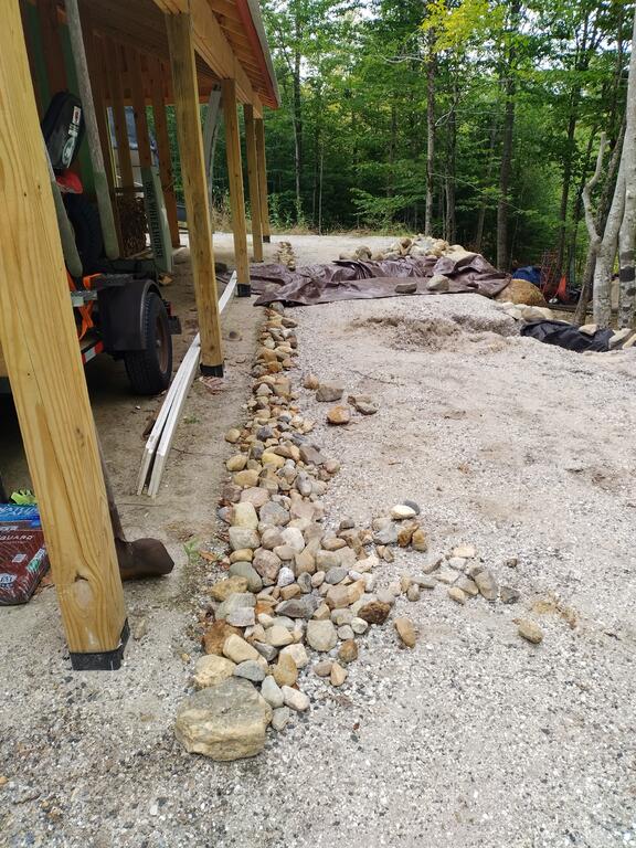

ebinmaine 78,380 #40 Posted September 2, 2023 We've been working slowly and surely on the project. After reading this thread (thank you all for the ideas) and talking to several other folks.. barn builder, excavator, town highway, folks at my work.. we decided to add a layer of 1.5" stone to a large area on the right side of the barn. Included in that will be a ditch or dry creek bed along the right side the building. That'll be 25"-30" wide and a foot or so deep at the middle. The ditch will be lined in the base with a tarp, filled in with stone and the roof drip line reinforced with flat-ish rocks layed out. The line of stones by these poles will be removed and reinstalled atop the creek bed. Today I used the Wally Digger Backhoe to start moving some stone around. I layed out the rocks behind the landscape cloth pictured here to raise the edge of wall. Then covered that with about 10 FEL scoops of stone. 3 Share this post Link to post Share on other sites

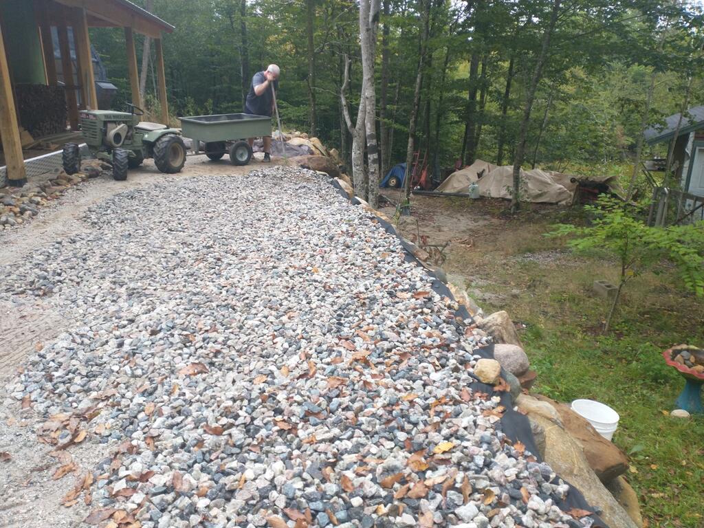

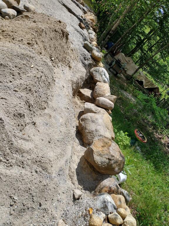

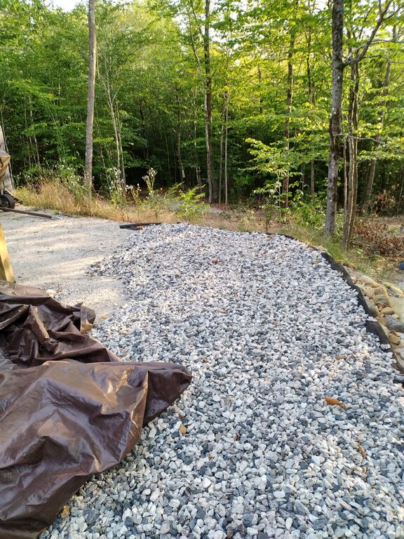

ebinmaine 78,380 #41 Posted September 11, 2023 We worked on the erosion control project for a bit this afternoon. Got some more sand and stone moved. We're some past the halfway point now. 3 Share this post Link to post Share on other sites
ebinmaine 78,380 #42 Posted September 12, 2023 While I was at work today Trina moved another 10 loads of sand with her Millie and small trailer. Her Momma helped shovel 3 of them. When I got home I ran the Wally Digger Backhoe FEL and filled in a fair amount of stone on top. Trina leveled it. You can see the darker stone we moved today. Full view. 2 Share this post Link to post Share on other sites

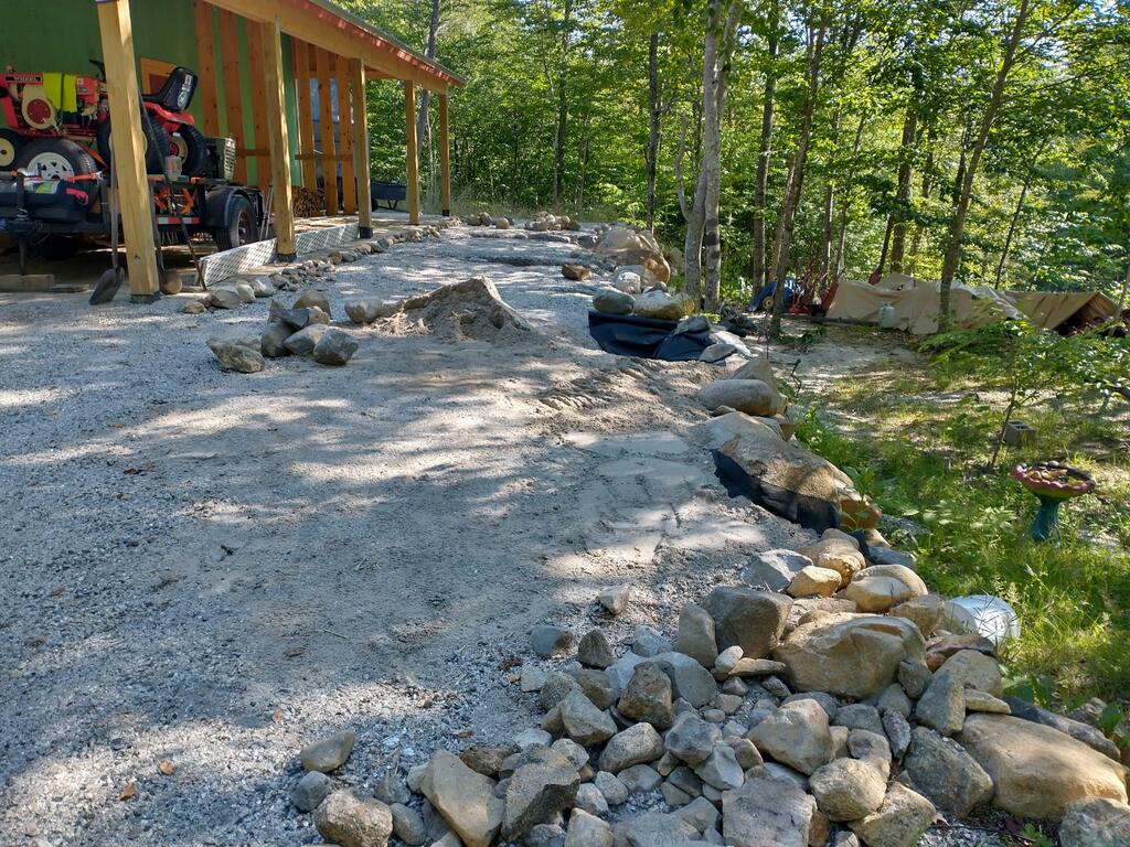

ebinmaine 78,380 #43 Posted September 26, 2023 A few days ago we got more of the stone layed out. We're now at the point of digging out the trench next. Some pretty fair rains have fallen and the waters seem to be flowing as they should. NOT moving cubic feet of gravel with it. 3 1 Share this post Link to post Share on other sites

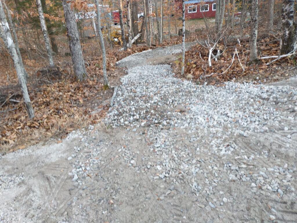

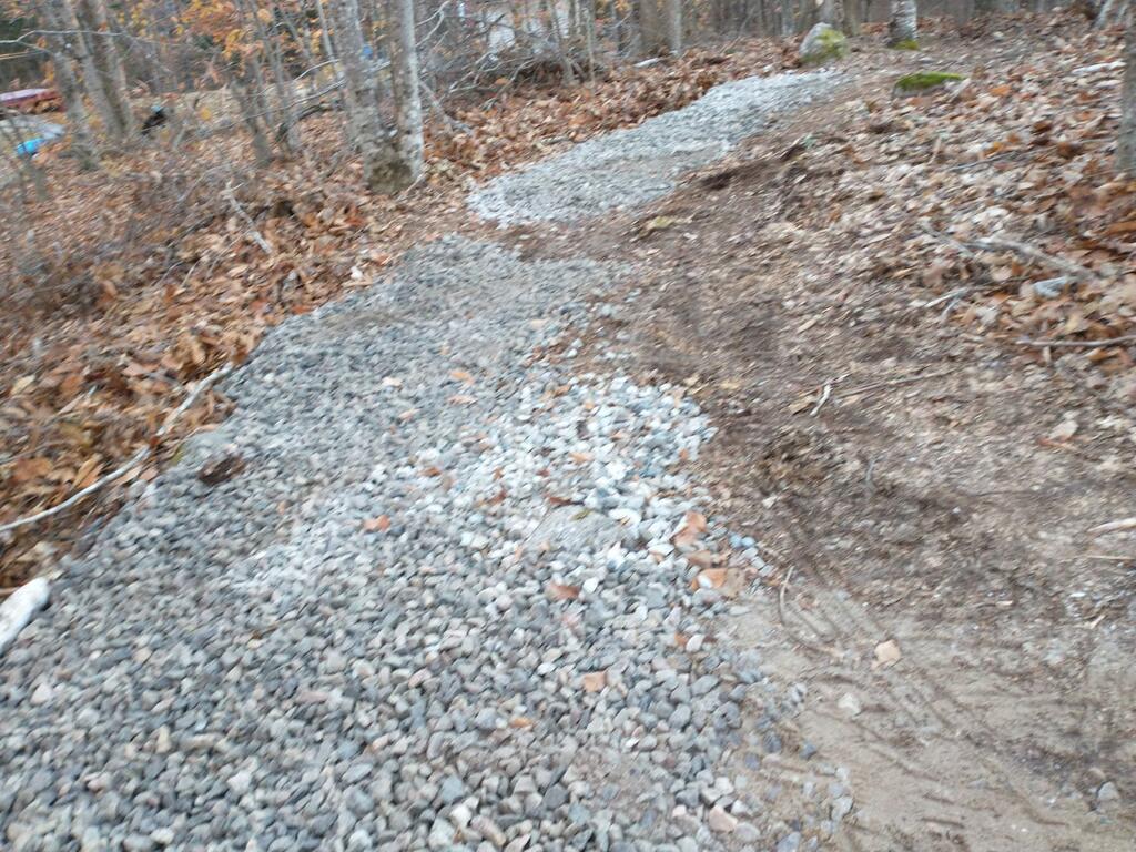

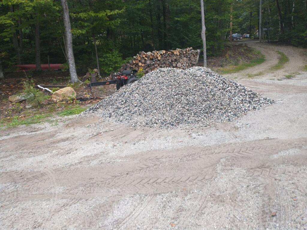

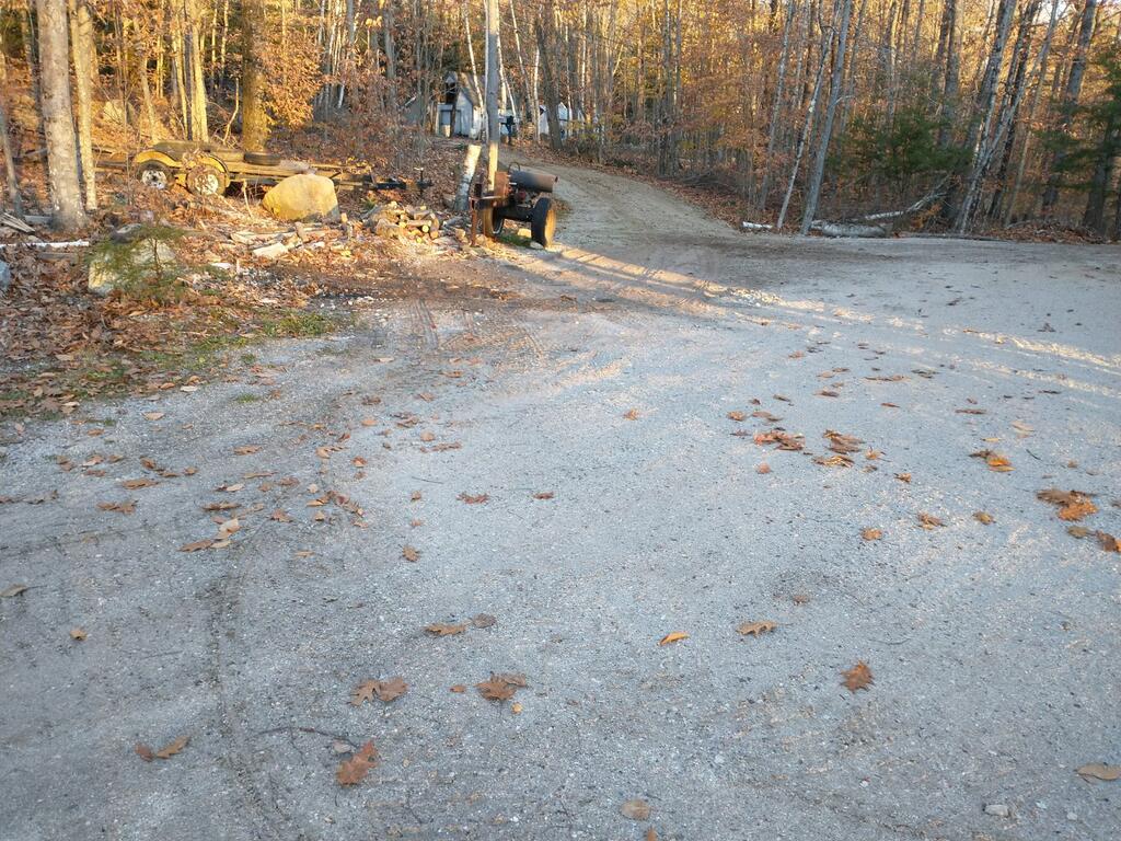

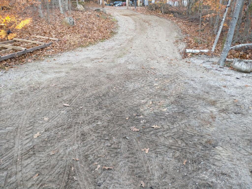

ebinmaine 78,380 #44 Posted November 12, 2023 On 9/10/2023 at 8:13 PM, ebinmaine said: Well folks we finally finished up on the Erosion control project today. The quoted pic above is a reminder of the 14+ yd pile we had delivered back in July. We got the rest of the stone moved today. The driveway is back. A dozen loader buckets by the left barn side. The rest down the path which will be our new primary forest entrance. Trina used her 867 and Mid Mount Grader Blade to level out the driveway and I used the Front End Loader. A LOT of work done today. 4 Share this post Link to post Share on other sites
Moparfanforever 926 #45 Posted November 13, 2023 Looks really good 👍!! Keeping my fingers crossed for you that it works well. 1 Share this post Link to post Share on other sites
ebinmaine 78,380 #47 Posted November 13, 2023 5 minutes ago, Moparfanforever said: Looks really good 👍!! Keeping my fingers crossed for you that it works well. Thanks! It's been good. Should continue to be fine. We've been monitoring the right side which was the main issue and haven't seen any damage since the 1½" stone was laid out. The issues in the left side were minor and addressed by where we put rocks out yesterday. Share this post Link to post Share on other sites
