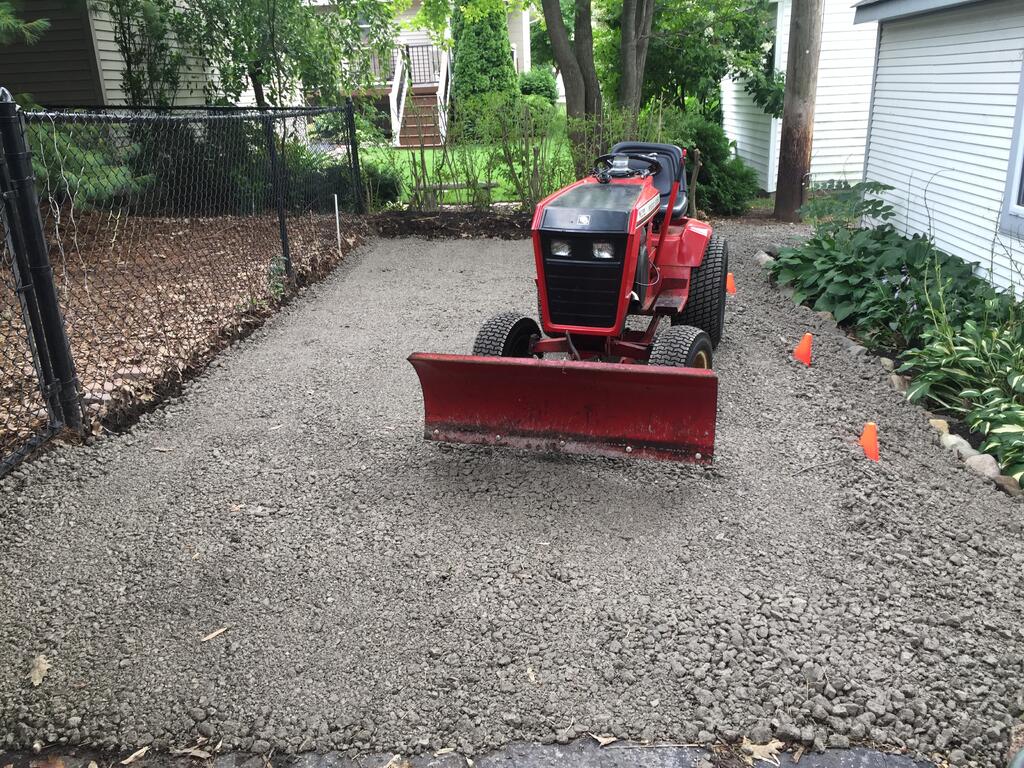

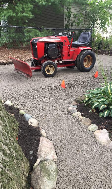

SylvanLakeWH 32,921 #2 Posted June 2, 2023 I have a 25'x12' area of 22aa limestone with fines. I kept it dead flat for that very reason. Sheet flows very slowly during heavy rain instead of accumulating in a channel. No erosion issues. 1'-2' higher than adjacent grade on one side. See pic. Could try french drain placed at roof edge in gravel. Drains directly from roof to linear box drain to 4" elephant trunk discharge at base of grade. 1 Share this post Link to post Share on other sites

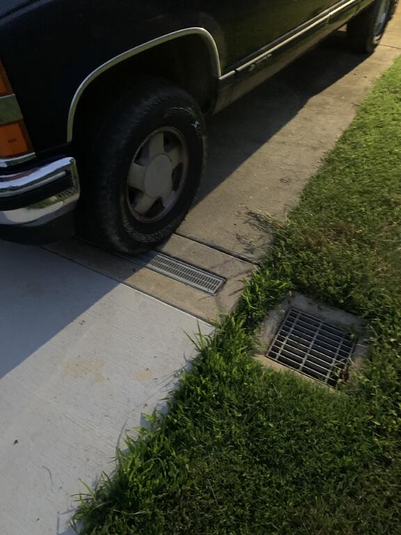

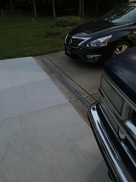

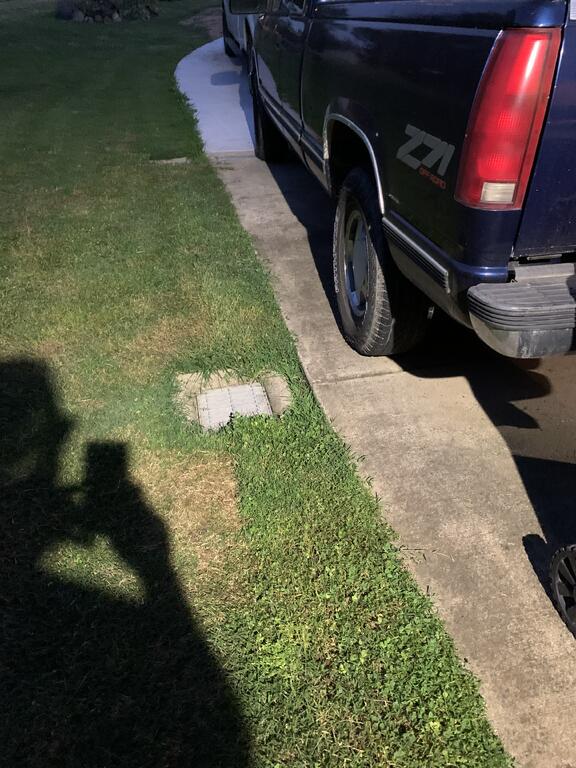

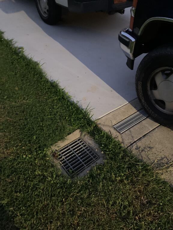

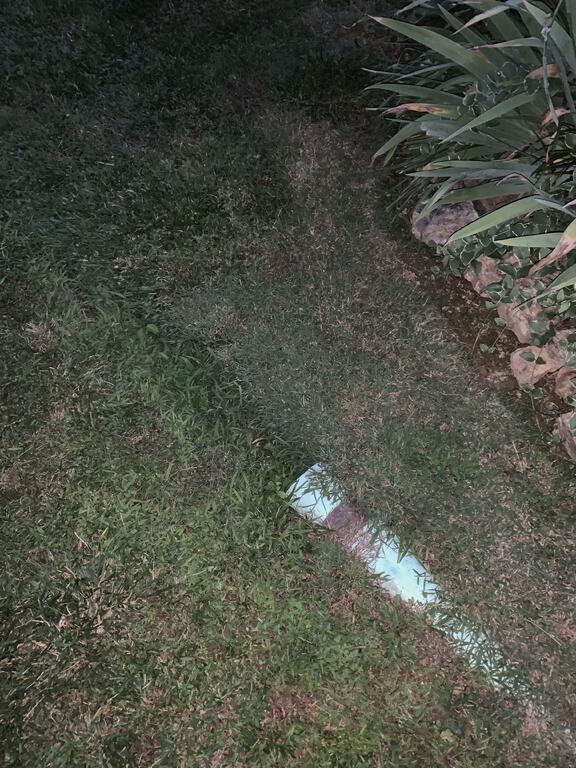

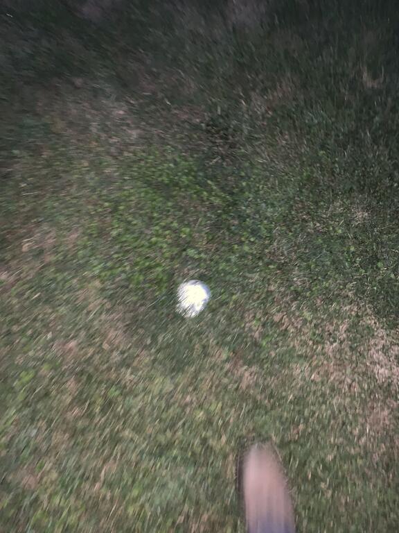

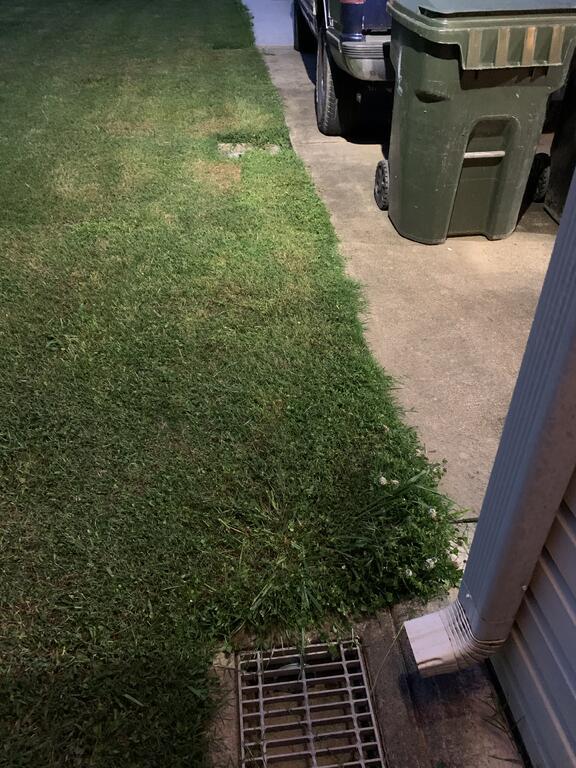

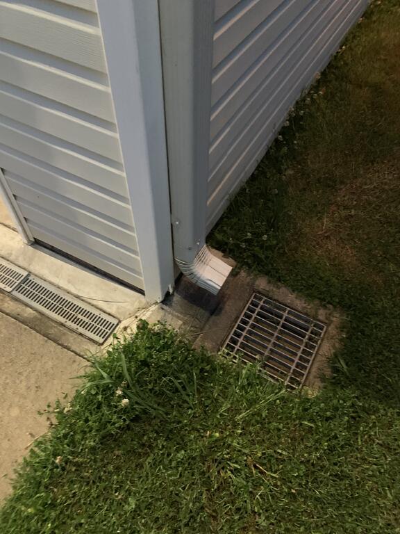

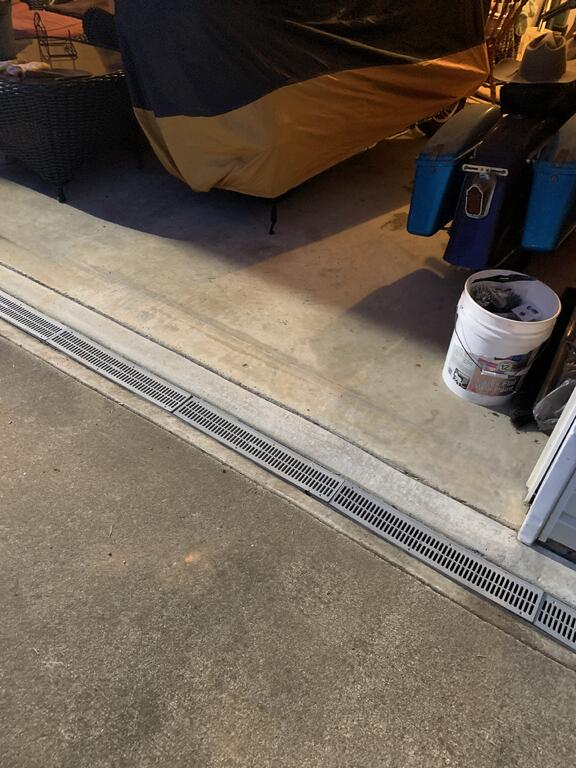

Horse Newbie 7,405 #12 Posted June 3, 2023 (edited) I used to have water coming in the garage when we would have a heavy or light rain… pad right off garage should have a little more slope away… So I cut the concrete driveway right off the garage door, installed a drain channel, built a catch basin under a downspout which was a source of a good amount of water coming off the house right near that garage corner. From there I went to another two catch basins to collect water coming toward the garage from across the yard. From there I installed drain channel across the front of the pad because water comes down the driveway (knowing that someday I would replace the gravel driveway with concrete).Then across the yard with a clean out at the bend… then to an outfall in the lower part of the yard well away from the house… This was not an erosion issue, but if you are in the mood for some hard labor, just an idea… BTW… all pipe is 4 inch PVC with no holes… easily stays clean on its own. I need to go ahead and screw down those drain channel grates with the recommended No. 8x1 stainless steel screws, as the grates are slotted and doesn’t allow anything in that would cause a clog… Edited June 3, 2023 by Horse Newbie 1 7 Share this post Link to post Share on other sites
SylvanLakeWH 32,921 #13 Posted June 3, 2023 @Horse Newbie - Nice!!! 1 1 Share this post Link to post Share on other sites
Horse Newbie 7,405 #14 Posted June 3, 2023 Thank you @SylvanLakeWH ! I don’t think I’m what you would call a perfectionist, but I do put well enough effort into a project so that it looks good, works well, and I’m not ashamed to say I did it. 😆 6 Share this post Link to post Share on other sites
