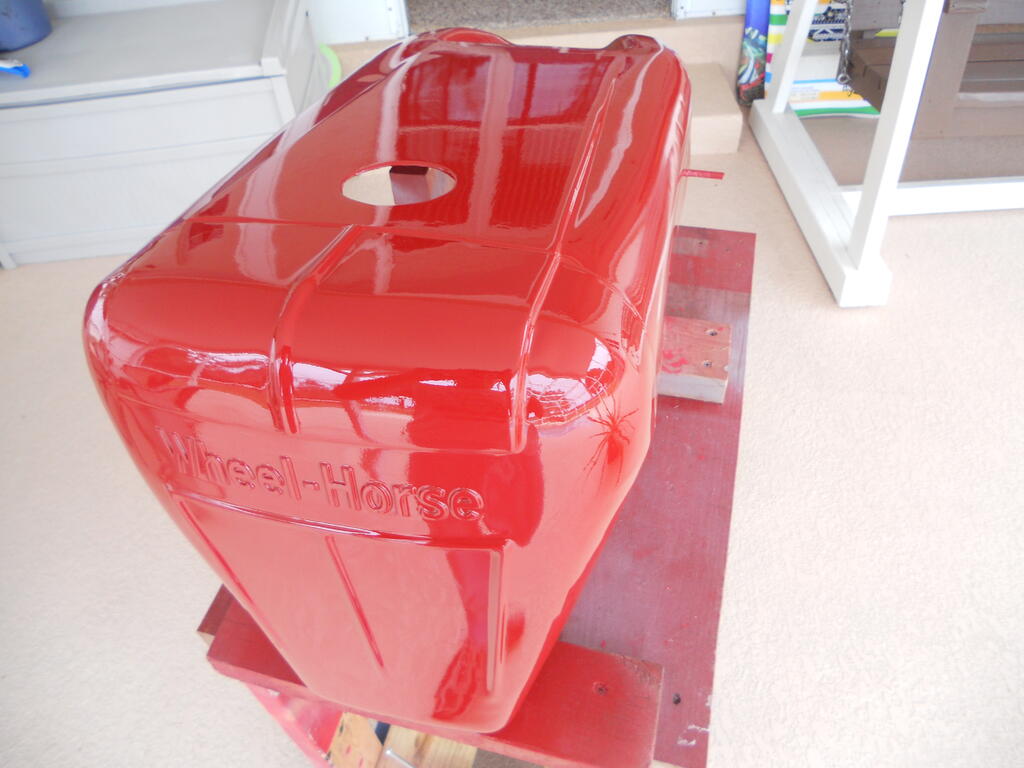

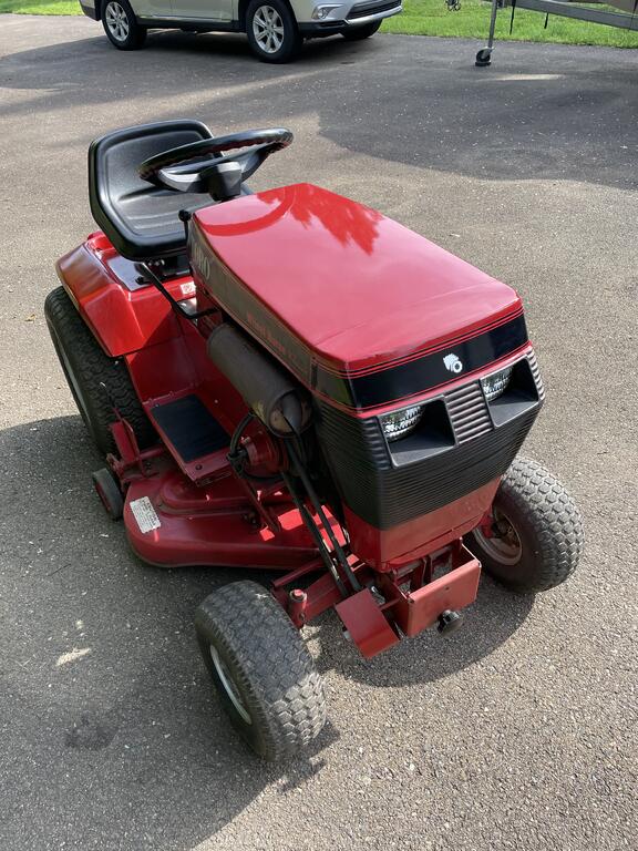

SPINJIM 1,997 #1 Posted May 10, 2023 (edited) Has anyone tried the Rustoleum 2X ULTRACOVER spray paint in Gloss COLONIAL RED? I used it on the hood of my 312H, and it seems a little closer to the original color as compared to the Regal Red. Seems a little less orange. Also, covers and flows a little better, but takes a little longer to dry. I'll be listing it for sale this weekend, along with a 48" plow blade and a good 37" RD mower deck that I got from Ed Kennell two years ago. I'll have pictures then. This has been my 'haul things around the yard' tractor for a couple of years, but have to downsize for a move. Jim Edited May 11, 2023 by SPINJIM 8 Share this post Link to post Share on other sites

ebinmaine 81,046 #4 Posted May 11, 2023 8 hours ago, SPINJIM said: Rustoleum 2X ULTRACOVER spray paint in Gloss COLONIAL RED? I used it on the hood of my 312H, and it seems a little closer to the original color as compared to the Regal Red. Seems a little less orange. Also, covers and flows a little better, but takes a little longer to dry We've had it here in our shop. @JCM chose it. I'll let him answer why. The Rust-Oleum 2x is very good. Flows well. Coverage is better than some others. Dries evenly. It will need a good strong 2 MONTHS to fully cure. It isn't as hard as a more industrial or road automotive paint in the long run. That doesn't matter to us because we only build workers for now. Just something to keep in mind. 2 Share this post Link to post Share on other sites

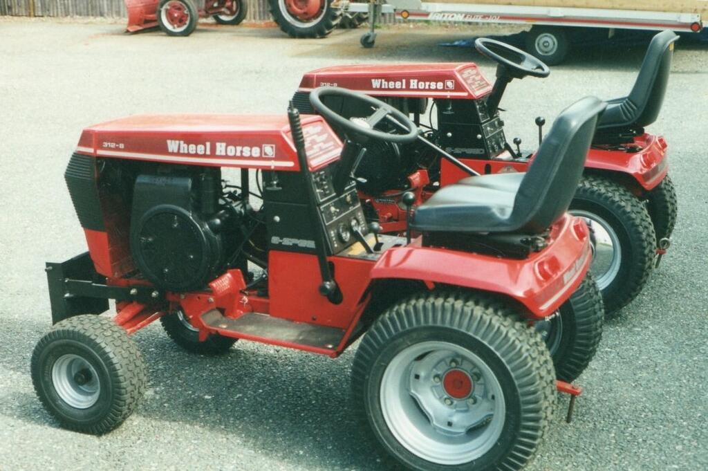

JCM 11,420 #9 Posted May 11, 2023 Side by side. 1986 312-8 painted with Toro paint done around 2001 and a 1989 312-8 with original paint for comparison. 2 Share this post Link to post Share on other sites
clueless 3,440 #10 Posted May 11, 2023 1 hour ago, JCM said: Side by side. 1986 312-8 painted with Toro paint done around 2001 and a 1989 312-8 with original paint for comparison. If your going to repaint or touch up a 300,400 or 500 series tractor the Toro New Red spray can is the correct paint. It is quality paint but a bit expensive. 1 Share this post Link to post Share on other sites

SPINJIM 1,997 #12 Posted May 12, 2023 13 hours ago, squonk said: That's why I spray the first clear while the red is still wet. Curious if it will work on the 2X like it does on the regular enamel. I had a week old test piece of metal with the 2X UltraCover. I sprayed it with Rustoleum Crystal Clear, and the 2X wrinkled. So much for their claim that you only have to wait 48 hours. 1 Share this post Link to post Share on other sites

SPINJIM 1,997 #23 Posted May 12, 2023 (edited) I put a second coat of the 2X UltraCover red within an hour after the first coat, while the first coat was still a little tacky, and there was no wrinkling. I'd imagine that a coat of Chrystal Clear within an hour would have the same result. The seat fender on this 312H is Regal Red. The hood is 2X Colonial Red. I like the hood color better. Edited May 12, 2023 by SPINJIM Share this post Link to post Share on other sites
