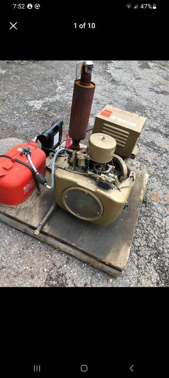

RetroMower 350 #1 Posted May 1, 2023 (edited) Saw this generator on marketplace and I was wondering if these have an identifying number like the single cylinder k241s or k301s etc... owner says no spark so maybe the $200 asking price is worth it for the motor alone Edited May 1, 2023 by RetroMower 1 Share this post Link to post Share on other sites

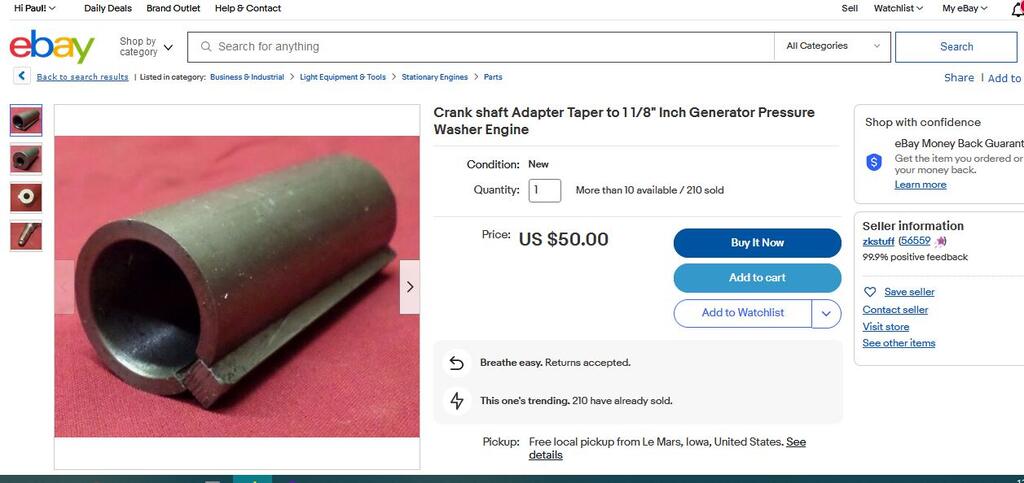

Achto 32,923 #2 Posted May 2, 2023 1 hour ago, RetroMower said: maybe the $200 asking price is worth it for the motor alone Depends on what you want to do with the engine. Being a generator engine, it more than likely has a tapered PTO shaft instead of a strait keyed shaft. 2 Share this post Link to post Share on other sites
RetroMower 350 #3 Posted May 2, 2023 47 minutes ago, Achto said: Depends on what you want to do with the engine. Being a generator engine, it more than likely has a tapered PTO shaft instead of a strait keyed shaft. Hmm that does change things. This is one of those things I'd love to have just to get ideas for it. Same goes for a Wisconsin 4cyl that I've been searching for. I want one to make an overpowered "hot rod" type rider. I probably wouldn't butcher a coveted WH for this and if I would I'd be hesitant to post it here for fear of the inevitable tar and feathering I'd receive for such blasphemy. Thank you forthe tip. I wonder if there's a certain way to determine this possibly tapered output shaft? 1 Share this post Link to post Share on other sites
Rick3478 477 #4 Posted May 2, 2023 4 hours ago, RetroMower said: Saw this generator on marketplace and I was wondering if these have an identifying number like the single cylinder k241s or k301s etc... owner says no spark so maybe the $200 asking price is worth it for the motor alone These were made in a couple sizes. Going from memory, I think maybe they were K482, K532, something like that. Probably old RV genset. Share this post Link to post Share on other sites

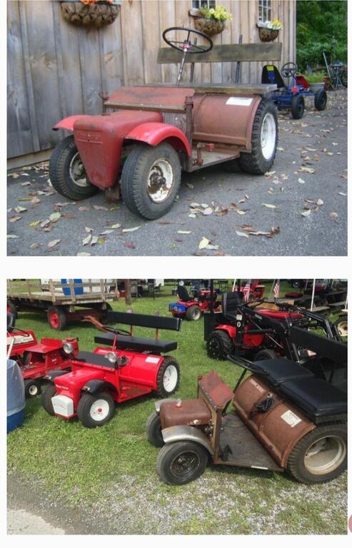

ebinmaine 81,139 #5 Posted May 2, 2023 3 hours ago, Rick3478 said: K482, K532 Rick's headed the right direction here. There were also K582 (23 HP) and a larger one that's over "K6xx" (24 HP). I don't know the year range in total. Somewhere in the 50s and well into the 80s. I have a K582 for a tractor project and a 24 HP that is a generator similar to the one pictured above but painted blue. 6 hours ago, RetroMower said: probably wouldn't butcher a coveted WH for this and if I would I'd be hesitant to post it here for fear of the inevitable tar and feathering I'd receive for such blasphemy Do NOT be concerned about that. Many MANY people have repowered or completely engineered whole machines using "coveted Wheelhorse" pieces. I wouldn't disassemble a good machine and hesitate to modify good parts but I'd gladly save an old rusty machine from the salvage yard or rotting in a field. I'm quite sure @Achto @Pullstart @wallfish @Wild Bill 633 and dozens more who have built AMAZING customs would tell you the same. Build the hot rod. DO post it here. Many of us would LOVE to see it. 2 2 1 Share this post Link to post Share on other sites
953 nut 70,325 #6 Posted May 2, 2023 11 hours ago, RetroMower said: owner says no spark so maybe the $200 asking price is worth it for the motor alone If you are interested in it take along a good battery, a coil and a test light or meter. Clean up the points, unhook the condenser, check the gap to be about .020" see if 12 volts gets to the coil "+" anc check for spark. If there is no spark replace the coil and see if it will run on one cylinder. If it runs on one then change plug wires and see if it will run on the other cylinder. 2 1 Share this post Link to post Share on other sites
pacer 3,181 #8 Posted May 2, 2023 @pfrederi Geez, thank you for that info on the adapter --- few yrs ago I turned down a nice k532 at $100 because it had a tapered shaft , ------course I'll prolly never see another Share this post Link to post Share on other sites
RetroMower 350 #9 Posted May 2, 2023 Heck with that adapter available I really don't have a reason to not go check it out. As suggested I'll probably take a battery and give it a go next time I'm off work. Hopefully the points are as easily accessible as the single cyl version I'm accustomed to 1 Share this post Link to post Share on other sites

RetroMower 350 #14 Posted May 3, 2023 (edited) 17 hours ago, ebinmaine said: Many MANY people have repowered or completely engineered whole machines using "coveted Wheelhorse" pieces. I wouldn't disassemble a good machine and hesitate to modify good parts but I'd gladly save an old rusty machine from the salvage yard or rotting in a field. I'm quite sure @Achto @Pullstart @wallfish @Wild Bill 633 and dozens more who have built AMAZING customs would tell you the same. Build the hot rod. DO post it here. Many of us would LOVE to see it. Wow you really weren't kidding Edited May 3, 2023 by RetroMower 2 Share this post Link to post Share on other sites
ebinmaine 81,139 #15 Posted May 3, 2023 6 hours ago, RetroMower said: Wow you really weren't kidding Nope. There are MANY custom machines out there made outta Wheelhorses or parts of em. 1 Share this post Link to post Share on other sites

RetroMower 350 #23 Posted May 5, 2023 Well I went to look at it with a battery, coil and tools in tow. I only needed the battery to tell it had serious issues as it was extremely tight and would barely turn. I knew enough to walk away. It probably could have been rebuilt but im not desperate for one and there are others out there. Thanks for all the help fellas 👍 1 Share this post Link to post Share on other sites
pfrederi 21,303 #24 Posted May 5, 2023 3 hours ago, RetroMower said: Well I went to look at it with a battery, coil and tools in tow. I only needed the battery to tell it had serious issues as it was extremely tight and would barely turn. I knew enough to walk away. It probably could have been rebuilt but im not desperate for one and there are others out there. Thanks for all the help fellas 👍 Good call.. Replacement parts for those are $$$$ if you can find them Share this post Link to post Share on other sites
