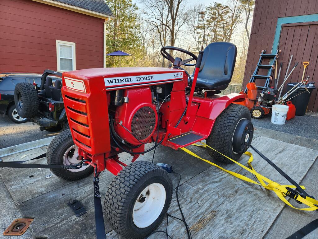

Crazy8 55 #26 Posted April 26, 2023 Guys the more I dig into this the more I'm wondering what I really have here. I'm trying to identify the transmission and then tie that back to what model and year it may be. I don't trust that the dash panel with the ID tag and ammeter hasn't been changed at some point. The transmission clearly has 1" axles, I put the dial verniers on them. According to the transmission repair manual # 492-4004 in section V the only reference to 1" axles is on page # 51 where it references "8 speed 4 pinion differential - 1" axles" then it says ( used in 5086 transmission ). Pages 4, 4a, 4b is a table of transmission usage giving the year, tractor model, and transmission # used. You have to go back to 1973 before you see a 5086 transmission used or forward to 1980 in a model called 1100 special. I guess the only thing I can say for sure is that it's definately an 8 speed manual transmission with 1" axles and it has a K301 12 HP engine in it. When it comes time to change the axle bearings and seals and maybe the shaft, I'll worry more about it then. 2 Share this post Link to post Share on other sites
Crazy8 55 #27 Posted April 26, 2023 A couple pics of the first horse in the barn. 7 1 Share this post Link to post Share on other sites

ebinmaine 80,311 #29 Posted April 26, 2023 52 minutes ago, Pullstart said: Looks pretty good from here! 1 hour ago, Crazy8 said: identify the..... @c-series don seems to have quite a liking for the type of tractor that you have in your possession. He may chime in, amongst others. I'd say what you have there is a 1978 or 79 C121. I'd also say it's reasonable to assume that your transmission has been swapped out at some point for an 80s vintage from (likely) a 310 or 312. They had the smaller axles and 4 pinion differential. Those transmissions are perfectly fine in their own right but because the heavier duty 8 speeds are so readily available I probably would not rebuild the one with the one inch axles. Throw an ad up in our wanted section for an 8-speed to fit that. Likely one of us has one or will come up with one, fairly close to you that they could sell. Rebuild that while the tractor is still running and drivable. Then when done, swap it in. That's a very very nice tractor from the appearance of the pictures that you posted and it certainly deserves the attention that you could give it. 2 Share this post Link to post Share on other sites

oliver2-44 11,694 #38 Posted April 27, 2023 What any of these tractors left the factory as after 50 years is always debatable. So you have a nameplate and transmission that indicate a C81. And a re-decayed hood and engine that would be a C81. My moneys on the C81 nameplate. Don’t sell the 8speed 4 pinion 1” axle transmission short. I have a c81 and a 312-8 with 1” axles. The 312 mainly gets mowing duty. But the C81 had had its share of dirt dozing, grading and boat trailer pulling work. Not many spare WH parts in my area so I rebuild what I have if needed. 3 Share this post Link to post Share on other sites

c-series don 12,363 #40 Posted April 27, 2023 (edited) @Crazy8I believe what you have there is a C-81 that someone repowered with a 12hp. If that were a C-121 it would have headlights, also (not that it matters) the hood decals are on backwards. Still a nice looking tractor! Good luck with it! As @ebinmaine knows the 78-79 C-series are some of my favorite tractors. Edited April 27, 2023 by c-series don 2 Share this post Link to post Share on other sites
