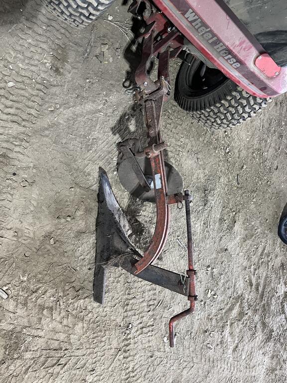

Torrence20 23 #1 Posted April 23, 2023 Ok so I have a 310-8 and I just put the part on it to be able to use brinly style attachments. I can’t think of the name of it currently. Anyways I also picked up a bottom plow that has a brinly style connection, although not brinly brand. I’m not actually sure what brand it is. I’ve got a couple questions after using it on the garden today. it does not seem offset enough. When the wheels are in the furrow it’s leaving a strip of unplowed soil. The plow pulls directly center line behind the tractor. I’m not sure how these plows are measured. But this one when it’s flat on the ground to the highest point on the moldboard is 10” the coulter wheel is 11.5. Unknown brand as the tag is not legible. My second question is on how far the plow is able to be lifted off the ground. The tractor I have has a cable coming out the back and a length of chain. The chain has Clevis that then runs to the brinly lift. I think it’s hooked in the 3rd link. But it barely raises the plow off the ground at all and with it being uneven it’s really gouging up the surrounding lawn. But I can’t get it to the next highest link. Idk if I’m missing some type of linkage or what. I was really impressed with how the tractor handled the plow though. Share this post Link to post Share on other sites
WHX?? 58,302 #2 Posted April 23, 2023 First thing I can suggest is to lose the coulter. You won't need it on a worked garden and it might be just in the way. We just flip them upside down in the bracket for safe keeping. Plows are measured at a right angle from the tip of the suck point to the widest point at the bottom of the share. Looks like an Ohio Steel? Moving the plow to the right abit would help but not gonna do it with a single hole hitch. I'll bring in some more plow knowledge @Achto @PeacemakerJack @Shynon@Streetrodchev @jeremi3210 As far as the lift height goes you might be able to lower the clevis on on the hitch arm or raise up front by the rockshaft. It's so different on different models. It's always trial and error and it sometimes seems impossible to get decent lift height given the geometry. 4 Share this post Link to post Share on other sites
Torrence20 23 #3 Posted April 24, 2023 (edited) 12 minutes ago, WHX?? said: First thing I can suggest is to lose the coulter. You won't need it on a worked garden and it might be just in the way. We just flip them upside down in the bracket for safe keeping. Plows are measured at a right angle from the tip of the suck point to the widest point at the bottom of the share. Looks like an Ohio Steel? Moving the plow to the right abit would help but not gonna do it with a single hole hitch. I'll bring in some more plow knowledge @Achto @PeacemakerJack @Shynon@Streetrodchev @jeremi3210 As far as the lift height goes you might be able to lower the clevis on on the hitch arm or raise up front by the rockshaft. It's so different on different models. It's always trial and error and it sometimes seems impossible to get decent lift height given the geometry. Great suggestion, I could drill a new hole lower down and that would gain me some lift height. I think I’m going to make a new hitch for the front of the plow with maybe 2 additional holes each side for better adjustability. I’ll have to remeasure the plow correctly tomorrow. Might only be an 8” plow Edited April 24, 2023 by Torrence20 1 Share this post Link to post Share on other sites
Achto 32,842 #4 Posted April 24, 2023 1 hour ago, Torrence20 said: The hitch on the front & the adjustment handle on the rear of the plow, It looks like it is a Simplicity plow for a two wheel walk behind tractor. 3 Share this post Link to post Share on other sites
Sailman 1,307 #5 Posted April 24, 2023 I have the brinley plow and it comes with a 3 hole hitch to be assembled and used to offset the plow based on the distance between the rear tractor wheels. Here is diagram https://brinly.com/wp-content/uploads/2022/04/uegd4rzwootqajx0ygqc.pdf Instructions might help with your questions. Go to step 3. Brinley also sells the 3 hole part if that helps or you could fabricate one. https://brinly.com/product/pp-51bh_sleeve_hitch_moldboard_plow/ Share this post Link to post Share on other sites
Pullstart 71,366 #6 Posted April 24, 2023 The tail of the plow I believe is called the frog. There may be a 1/2” bolt perpendicular to the frog that steers the plow if you will. You could try messing with that adjustment as needed. Share this post Link to post Share on other sites
Torrence20 23 #7 Posted April 25, 2023 23 hours ago, Sailman said: I have the brinley plow and it comes with a 3 hole hitch to be assembled and used to offset the plow based on the distance between the rear tractor wheels. Here is diagram https://brinly.com/wp-content/uploads/2022/04/uegd4rzwootqajx0ygqc.pdf Instructions might help with your questions. Go to step 3. Brinley also sells the 3 hole part if that helps or you could fabricate one. https://brinly.com/product/pp-51bh_sleeve_hitch_moldboard_plow/ thank you for the info. thats helpful. i actually picked up a cultivator tonight that has the 3 hole so i think ill just swap them. since the cultivator will be fine if its straight behind the tractor, i would think anyways. Share this post Link to post Share on other sites
Torrence20 23 #8 Posted April 25, 2023 22 hours ago, Pullstart said: The tail of the plow I believe is called the frog. There may be a 1/2” bolt perpendicular to the frog that steers the plow if you will. You could try messing with that adjustment as needed. thanks for the thought. the frog on mine does not appear to be adjustable Share this post Link to post Share on other sites
Torrence20 23 #9 Posted April 25, 2023 On 4/23/2023 at 8:09 PM, Achto said: The hitch on the front & the adjustment handle on the rear of the plow, It looks like it is a Simplicity plow for a two wheel walk behind tractor. i believe that, it seems a tad small for the tractor but it did perform very well 1 Share this post Link to post Share on other sites
Streetrodchev 1,202 #10 Posted April 28, 2023 Plow is from a two wheel, walk behind tractor. Could be a 6” or 8” plow. It will need to be mounted further to the right to work with your wheel spacing. 1 Share this post Link to post Share on other sites
