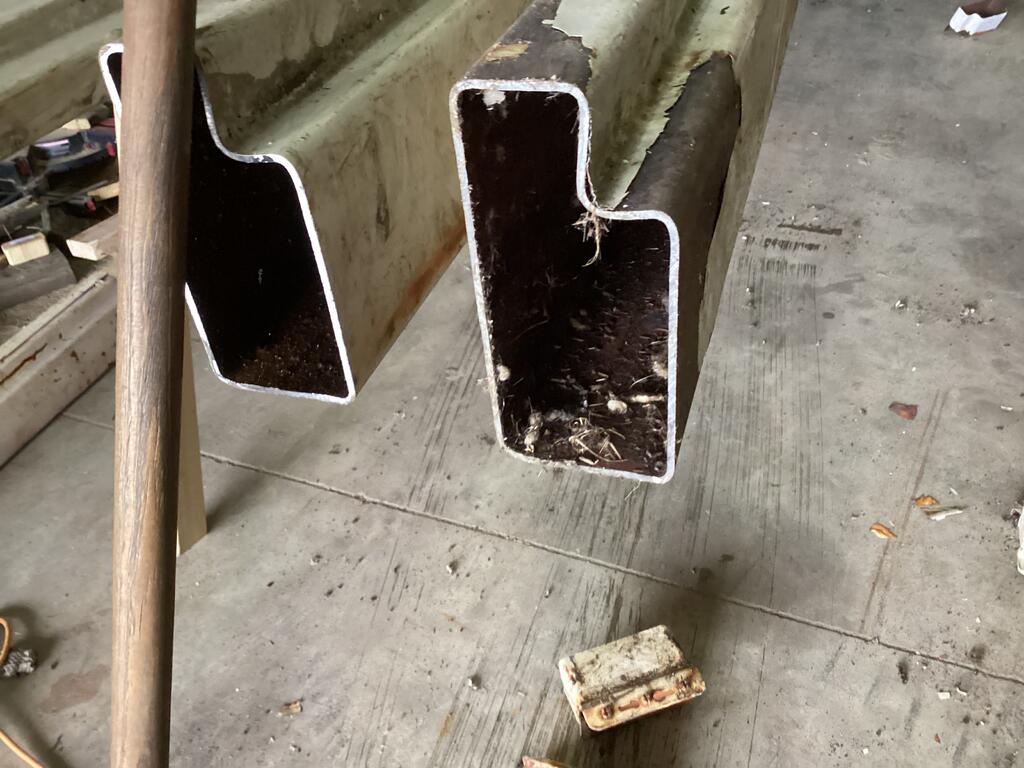

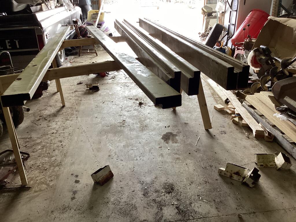

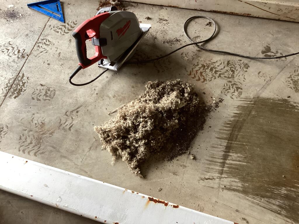

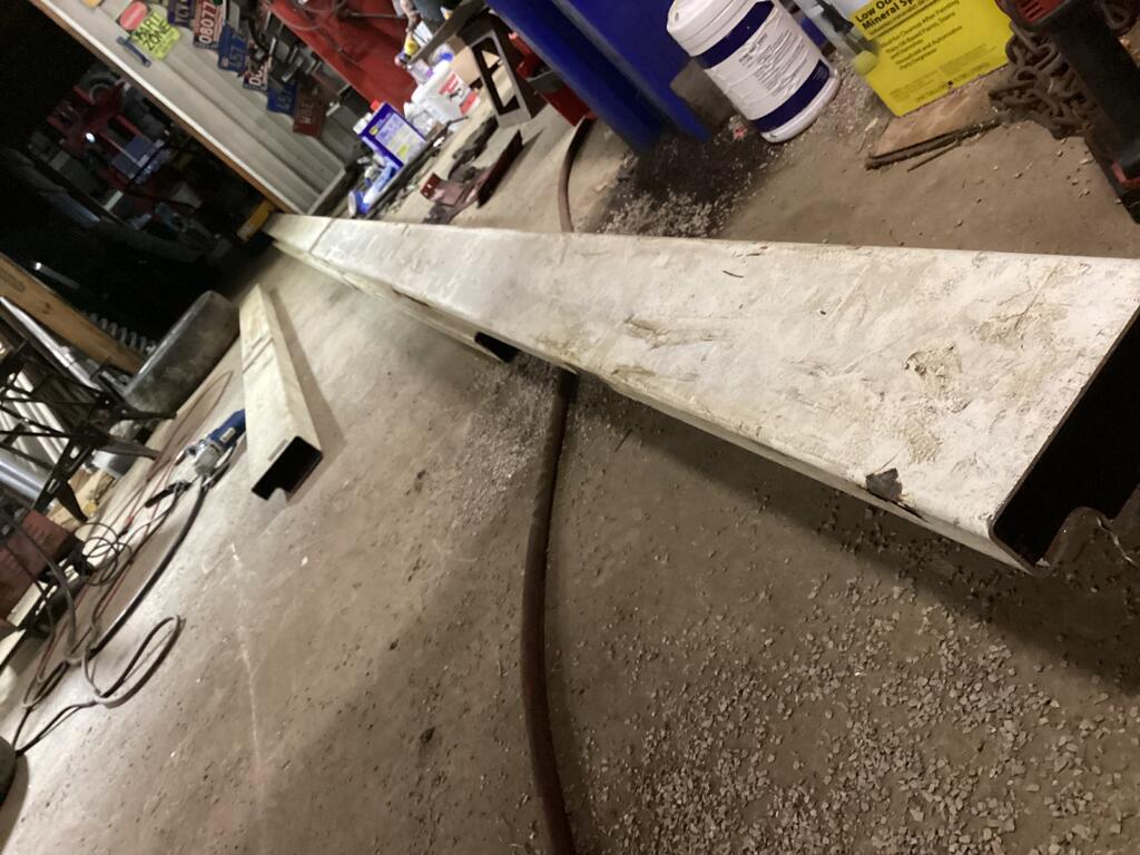

Pullstart 70,112 #1 Posted April 1, 2023 I have this thought in my head. I have about 10 days to make it work! We have 125 meat birds on the way, I need to make them a house. Momma wants it to fertilize our yard. I was planning on it fertilizing the deer pasture. Hey! What do I know? I have this thought of a greenhouse type frame, with a Predator 6.5 belt driving a truck axle to push it along. The drive and steer axles will need to be on some type of pivots, so the machine can drop to the ground once parked. I figure go-kart style swing arms, if you will. I might run a kart clutch, to start it up, and run the throttle from inside to be sure I don’t run any bawk bawks over. I can’t really delay. I’m starting by finding some material for the base structure. These pallet racking crossmembers are 6” tall and quite thick. They should do a decent job, once butt welded together. 4 Share this post Link to post Share on other sites

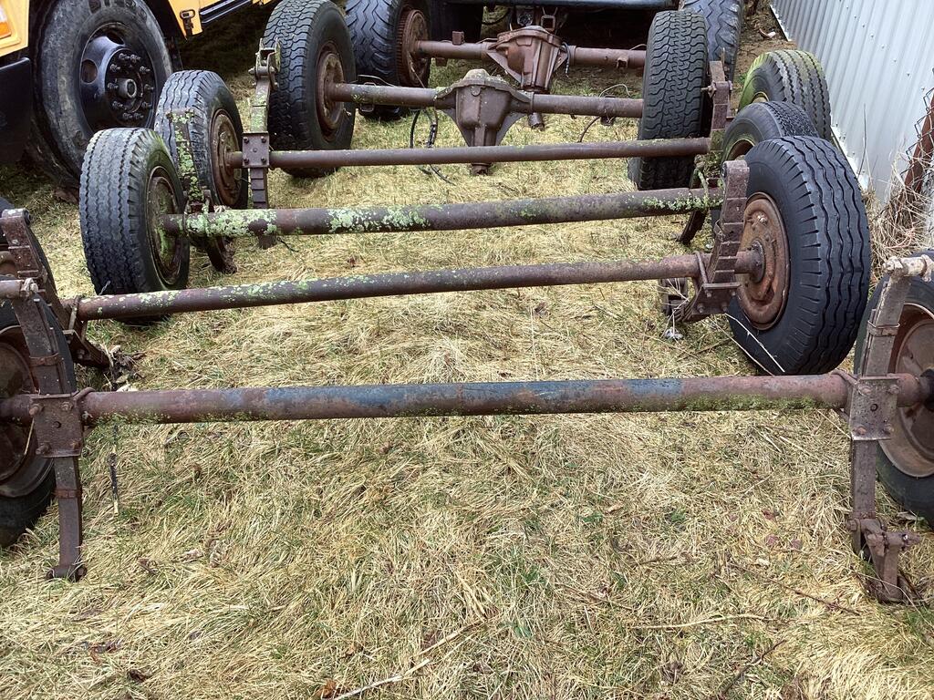

Pullstart 70,112 #2 Posted April 1, 2023 I’ve got some hoops and various types of axles. Front wheel drive steer axle? Rear steer rear wheel drive? Rear straight drive axle and pivot steer front axle? Lots of thoughts, lots of options. One thing is for sure. The birds are coming whether I’m ready or not! 3 Share this post Link to post Share on other sites

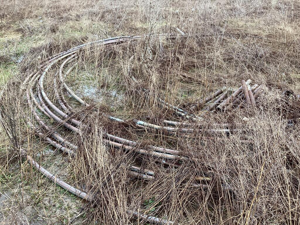

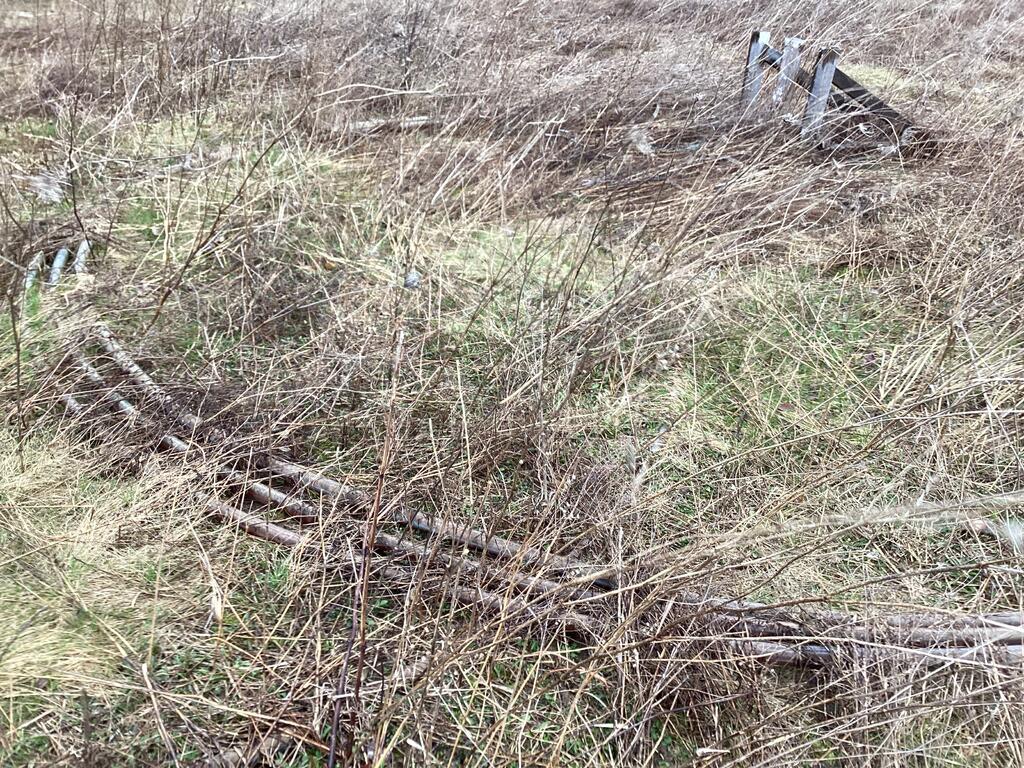

Pullstart 70,112 #5 Posted April 1, 2023 The idea and purpose of it being mobile, is to reduce the manure build up all in one place. Daily movements (of the tractor of course) will lend fresh pasture and fertilizer. 1 2 Share this post Link to post Share on other sites

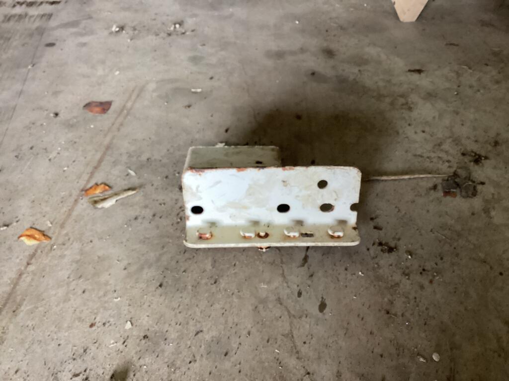

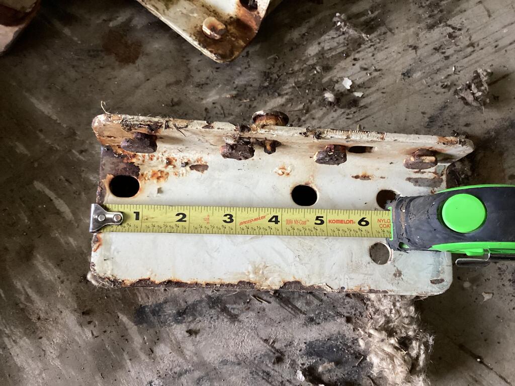

Pullstart 70,112 #6 Posted April 1, 2023 Apparently I’m not the only being who is fond of these crossmembers! 1 2 Share this post Link to post Share on other sites

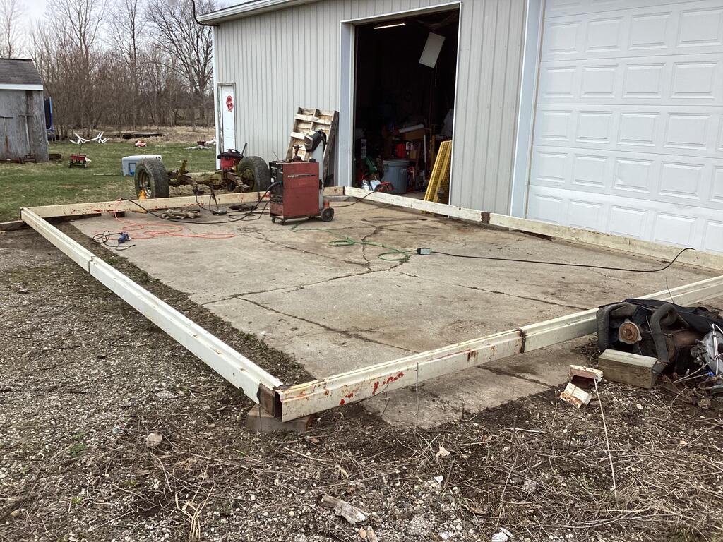

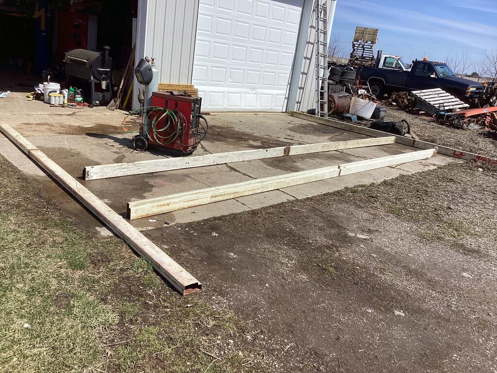

Pullstart 70,112 #8 Posted April 1, 2023 I will only be able to do so much welding INSIDE the shop, then it’s out to the gravel driveway. I am not doing every measure to make these beams PERFECTLY straight, just close enough. 1 Share this post Link to post Share on other sites

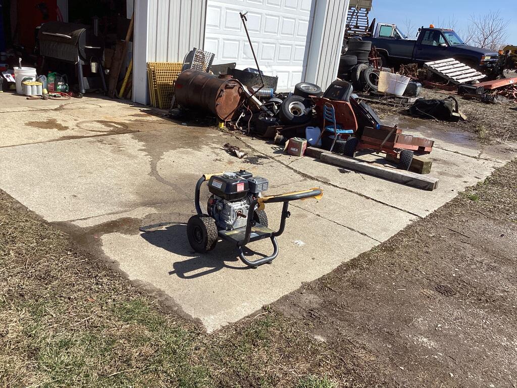

Pullstart 70,112 #14 Posted April 2, 2023 I did a little cleaning up, not much more I can do inside. I found a good running Honda GX engine on a pressure washer frame. I planned on using @elcamino/wheelhorse via @19richie66’s 6.5 Predator engine from the 2018 Big Show, but I might as well keep that one N.O.S. A little while longer! 2 Share this post Link to post Share on other sites

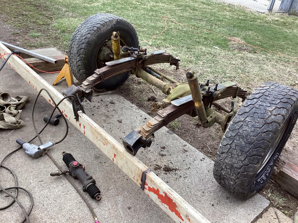

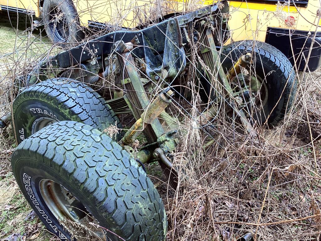

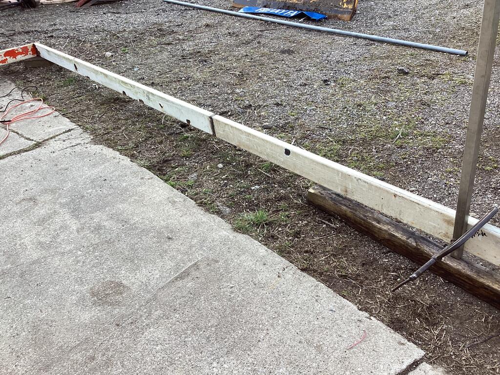

Pullstart 70,112 #15 Posted April 2, 2023 It is squared up and tack welded in the corners. We pulled this Chevy 10 bolt around front, flipped and rotated the springs, and now I’m working on a lift design. In my head of course! 2 1 Share this post Link to post Share on other sites

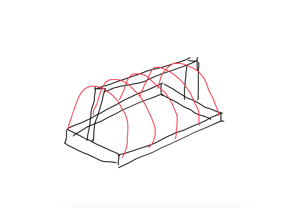

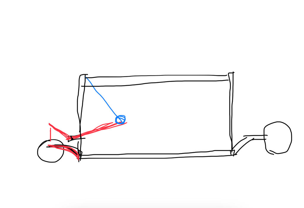

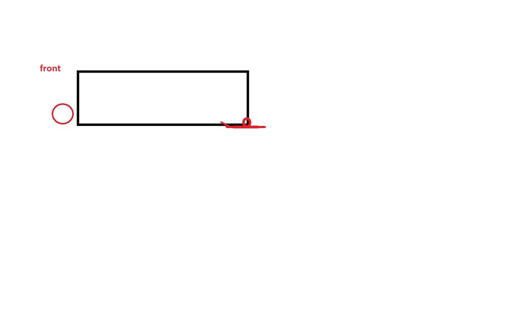

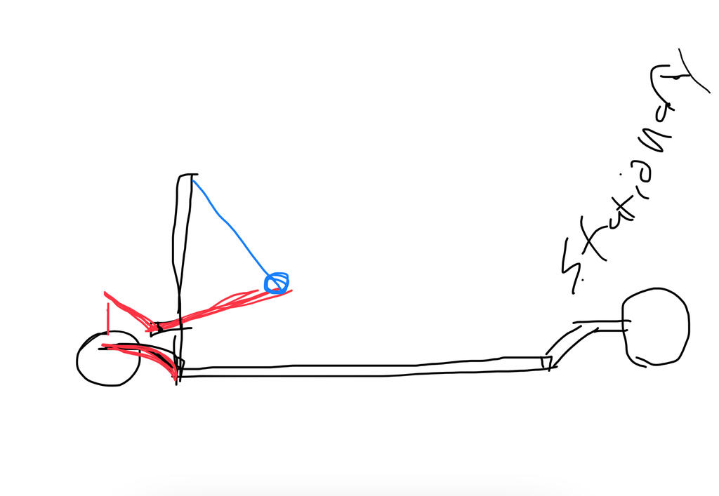

Pullstart 70,112 #16 Posted April 3, 2023 This frame structure is probably .100” thick. I’ll build whatever wall uprights needed. I’m thinking a large lever of sorts to lift the frame off the ground when needed. Crude drawing, but this is what is in my head. @wallfish, my lead hammer mechanic engineer? You out there? Have any ms paint drawings available for me? @8ntruck, my lead manufacturing design engineer, if my main frame is 24’ long, how far back does the stationary axle need to be to lift the frame an inch or two? 1 Share this post Link to post Share on other sites

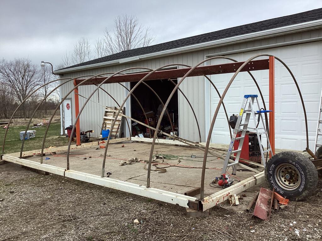

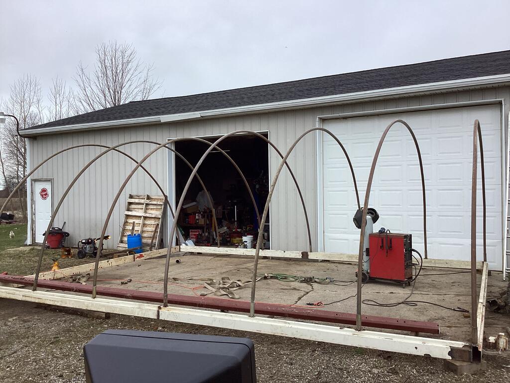

Pullstart 70,112 #17 Posted April 3, 2023 (edited) Today, I’ll be working on the rest of the frame work and hoops. I plan to have a solid upright and roof truss in the center of the structure, then hoops over top. Gussets where applicable, but I need to make sure the structure can flex and conform to the mostly flat ground. Edited April 3, 2023 by Pullstart 2 Share this post Link to post Share on other sites

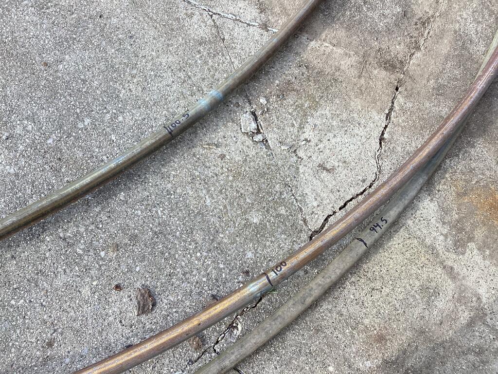

Pullstart 70,112 #18 Posted April 3, 2023 I made a “jig” of sorts to measure the hoops. I’ll cut them to the shortest height and mount ‘em up. 2 Share this post Link to post Share on other sites

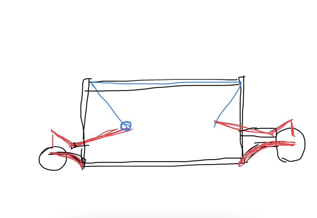

Pullstart 70,112 #19 Posted April 3, 2023 I have all the hoops welded. I had a thought. Run a winch cable through a couple pulleys. Let front and rear lift each other. The length of the lever and the fulcrum point to be decided once the machine is built. I’d like 4-6” lift travel if possible. 2 Share this post Link to post Share on other sites
wallfish 20,053 #20 Posted April 3, 2023 (edited) Do you have an old log splitter hanging around? Hydraulics I believe you are going to need to lift both ends to get 4-6" lift because I assume this needs to sit flat on the ground for the birds to stay in. What about Dick's ski/skid idea on one end and drag it with the drive end? Then you only need to lift one end. Doesn't appear like it's going to be very heavy Edited April 3, 2023 by wallfish 4 Share this post Link to post Share on other sites
SylvanLakeWH 31,558 #21 Posted April 3, 2023 Couple bottle jacks to raise / lower tires... combo skid / roll. only need to go length of the building... Still suggest trailer with dedicated puller... way less "stuff"... 2 Share this post Link to post Share on other sites
Pullstart 70,112 #22 Posted April 3, 2023 Lots accomplished. Weather break! 2 Share this post Link to post Share on other sites
wallfish 20,053 #23 Posted April 3, 2023 Here's another idea What about keeping it a fixed height all the time with the drive wheels and then put a thick rubber skirt around the bottom? It can flex for moving it and it should be heavy and stiff enough to keep the birds in 2 1 Share this post Link to post Share on other sites
Handy Don 16,760 #24 Posted April 3, 2023 2 minutes ago, Pullstart said: Planning on really tall chickens, eh? 3 Share this post Link to post Share on other sites
