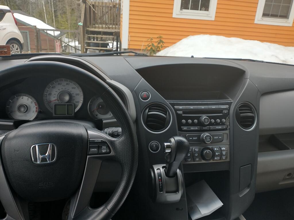

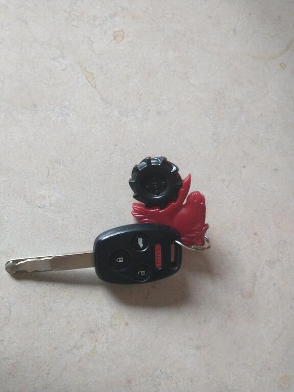

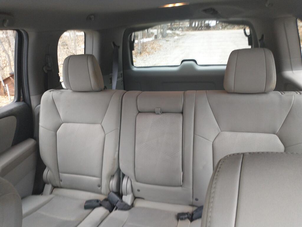

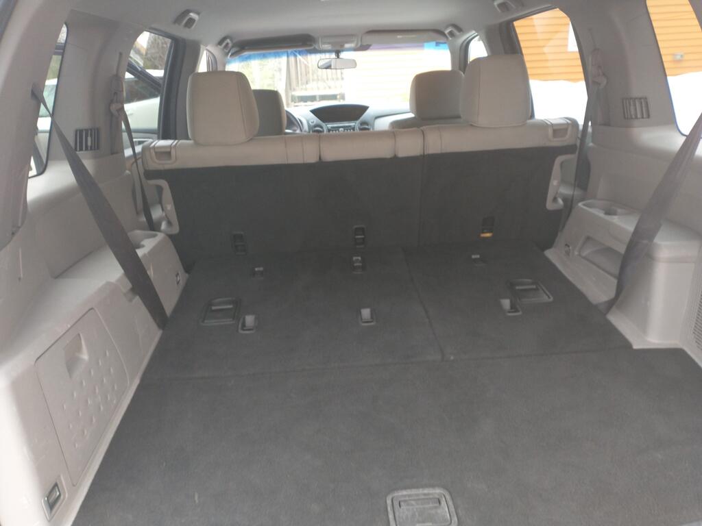

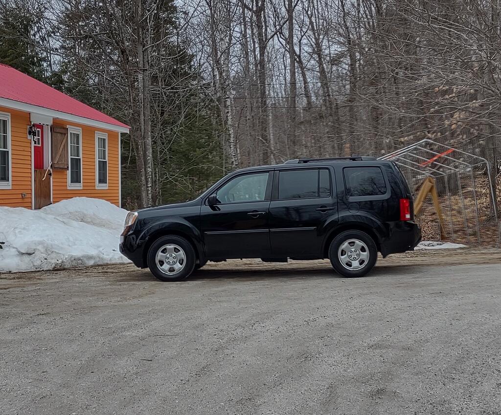

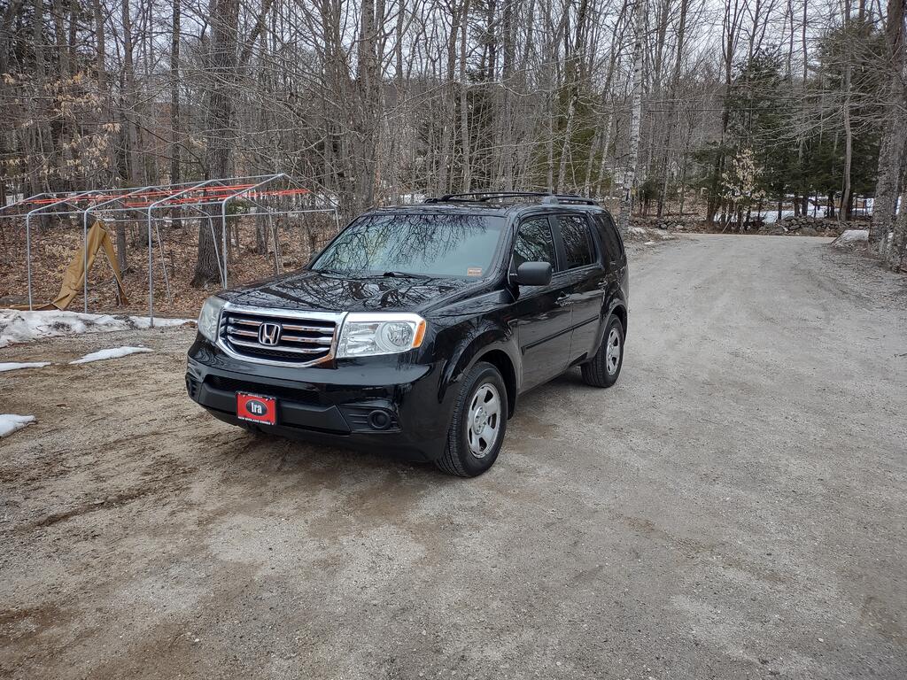

ebinmaine 80,756 #1 Posted March 25, 2023 Trina got herself a 2012 Honda Pilot. Huge volumes of space for camping gear and it can tow over 4K. We're looking forward to putting it to great use this year!! She's decided that the Pilot shall have the Wheelhorse keychain because it'll be the official Wheelhorse goes to shows puller. 13 11 Share this post Link to post Share on other sites
peter lena 10,074 #2 Posted March 25, 2023 @ebinmaine TRINA did well , hope you take advantage of its condition , have access to a lift? cans of aerosol , open gear cable and chain spray , in and on underside , wheel well arches , inside doors , every body seam . that would show itself in days to coverage protection . an oil slick on a seam and at the bottom of door edge seams is showing you rust protection . go oily, pete 2 1 Share this post Link to post Share on other sites

Stormin 9,988 #7 Posted March 25, 2023 1 hour ago, ebinmaine said: Trina got herself a 2012 Honda Pilot. Nice but I'd take it back. Steering wheel is all wrong. 1 8 Share this post Link to post Share on other sites
ri702bill 13,083 #8 Posted March 25, 2023 On THIS side of the Big Puddle - that is where you find 'em.... unless you deliver Mail for a living !! 3 5 Share this post Link to post Share on other sites
ebinmaine 80,756 #9 Posted March 25, 2023 7 minutes ago, Stormin said: 1 Share this post Link to post Share on other sites
ebinmaine 80,756 #10 Posted March 25, 2023 Just now, ri702bill said: On THIS side of the Big Puddle - that is where you find 'em.... unless you deliver Mail for a living !! @Stormin do you folks have vehicles with the left hand wheel for other reasons like our mail carriers? 1 Share this post Link to post Share on other sites
ri702bill 13,083 #11 Posted March 25, 2023 But you do enter a "roundabout" on the wrong side..... Share this post Link to post Share on other sites
squonk 48,141 #12 Posted March 25, 2023 37 minutes ago, Stormin said: Might as well move the road signs too! 1 1 Share this post Link to post Share on other sites
Stormin 9,988 #13 Posted March 25, 2023 1 hour ago, ebinmaine said: @Stormin do you folks have vehicles with the left hand wheel for other reasons like our mail carriers? Yes Eric. Road sweepers. 1 Share this post Link to post Share on other sites
ebinmaine 80,756 #14 Posted March 25, 2023 14 minutes ago, Stormin said: Yes Eric. Road sweepers. Aye. Ours can be either way here. Share this post Link to post Share on other sites
squonk 48,141 #15 Posted March 25, 2023 Road sweepers around here have steering wheels on both sides. You can have a job if you ever visit nORM! 1 Share this post Link to post Share on other sites

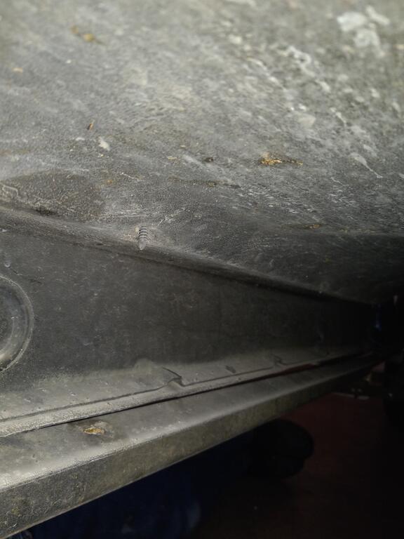

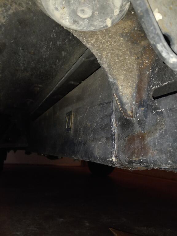

Beap52 2,507 #16 Posted March 25, 2023 (edited) That's a good looking vehicle! Probably bring a smile to the annual personal property tax--at least it would here in MO. Here a couple pictures of my 1992 GMC K2500. It's rust free--in part that the previous owner and I try not to drive on salt treated roads and I spend as much time washing the underside as I do the topside. I also believe that the Penetrol I use to coat underside with every couple of years also helps. I spray up inside the fenders and the frame and pop out the plugs to spray the rockers and doors. One of the other things I did was use the wax rings that seal toilets to the sewer pipes. I used the wax to seal the seam in the rear wheel opening hoping to prevent salty water intrusion from tires sending spray on them. The first picture is the passenger side frame right behind the front wheel. The other is the floor pan and rocker on the passenger side. This truck has 224,000 miles and 31 years old. I also spray our 71 El Camino and 47 Chevrolet sedan delivery with Penetrol. Penetrol is an additive for oil base paint to help it flow better. It's linseed oil based product and I was told years ago that folks used it for rust prevention--now I do. Edited March 25, 2023 by Beap52 4 4 Share this post Link to post Share on other sites
peter lena 10,074 #17 Posted March 26, 2023 @Beap52 totally agree with the linseed oil , that has a creep / penetrating factor thats vital. been using lubriplate fluids for years , especially open gear spray as a finish after , using chain / cable spray first as the base / creeper lubricant . the cost to day is nuts , used to be $ 2 a can , had a lot of it , your side under rail , shows good results . my son does his cars every year in vermont . from what I have seen on newer trucks , for rust / rot , its scary . stay after your stuff , if you want too, tyvek paper suit , pete 1 Share this post Link to post Share on other sites
