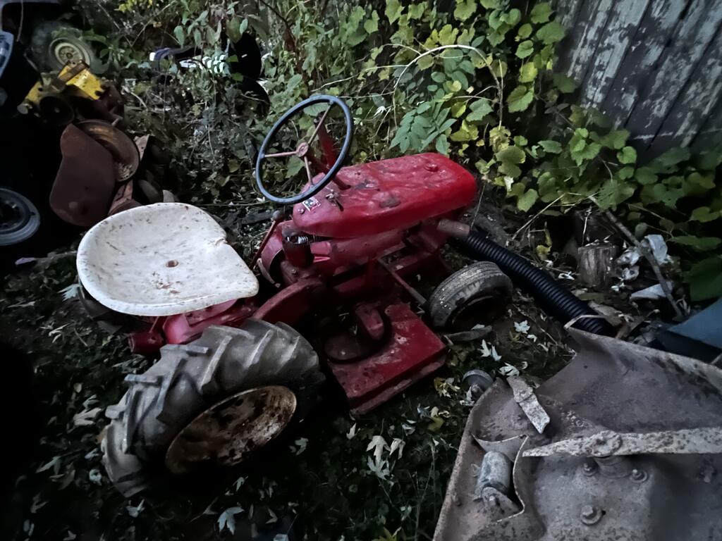

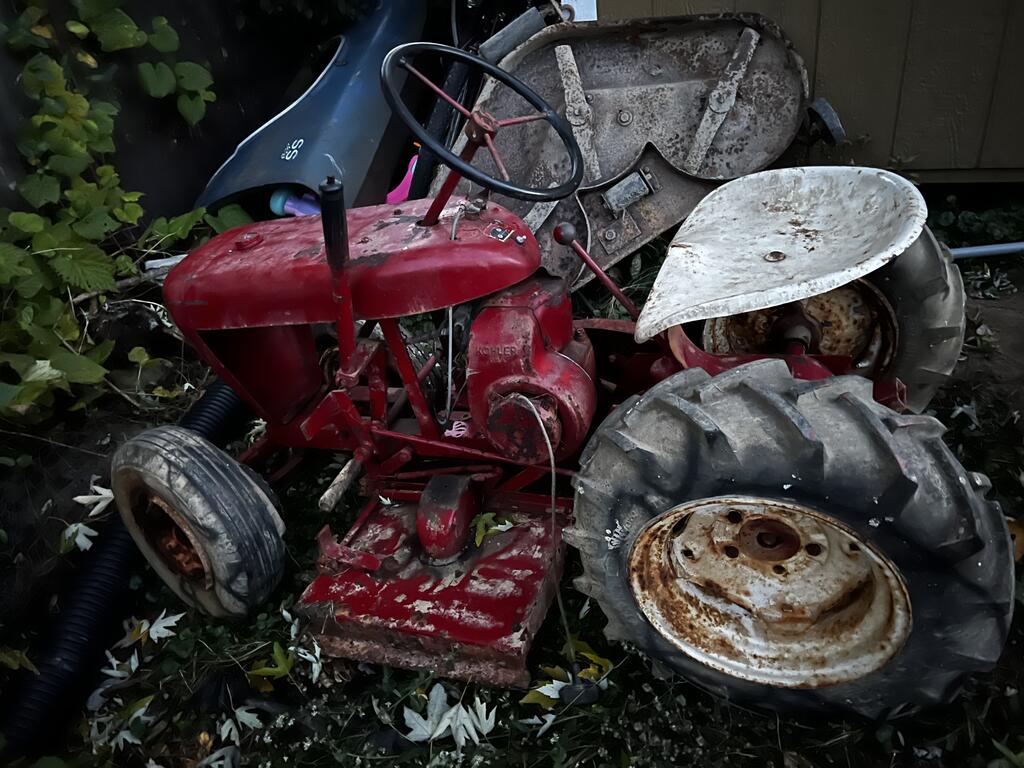

WH1618speed 543 #1 Posted March 13, 2023 (edited) Well, today marks the beginning of my 6th wheel horse restoration. This is definitely a unique one for me since I have zero experience with these tractors. This one I got from a guy that lived only 10 minutes from me for $400. He said it was restored (poorly) by someone in shop class at the local vocational school about 30 years ago then it was left in a barn for a while. The motor has compression and the trans seems tight. Everything is pretty much there even the deck (except the shower head muffler 😡). That and the air cleaner housing. The deck looks to be free of holes and the recoil works well too. which I consider a huge plus and . The front wheels were completely rusted out and had to be junked so I'll have to keep my eye out for those. This should be a fun one. Wish me luck! Edited March 13, 2023 by WH1618speed 5 7 Share this post Link to post Share on other sites

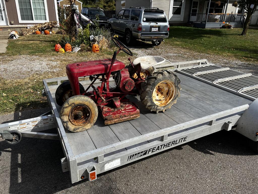

WH1618speed 543 #2 Posted March 13, 2023 Here's where I found her. 4 3 Share this post Link to post Share on other sites

WHX?? 58,324 #6 Posted March 14, 2023 (edited) I'm in too Be interesting where this project takes ya. The solid seat pan is taking me back to an 58 or 59 RJ? Maybe earlier is that a Schaefer recoil? Damn speller check ✔️ Edited March 14, 2023 by WHX?? 2 Share this post Link to post Share on other sites

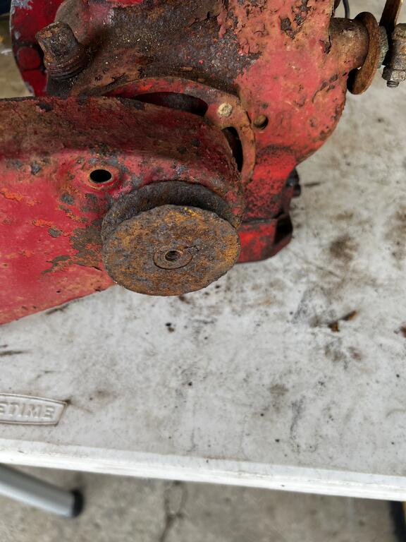

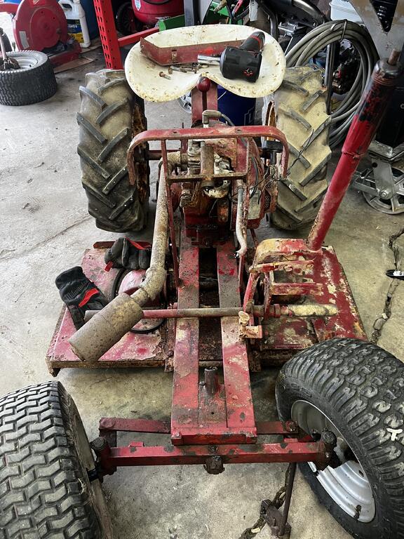

WH1618speed 543 #15 Posted March 14, 2023 This is gonna be fun 😳 2 1 1 Share this post Link to post Share on other sites
wallfish 20,724 #16 Posted March 14, 2023 4 minutes ago, WH1618speed said: This is gonna be fun 😳 Yeah, looks fun Then you only got another to go after that. That's too bad the pulley is gone to mother nature but it does leave the option for cutting it to get it off. Those pulleys have the set screw in the groove. Just be careful not to ruin that original belt guard. Might be worth what the rest of the tractor is. 1 Share this post Link to post Share on other sites
WH1618speed 543 #17 Posted March 15, 2023 (edited) My only thing is what am I going to do about getting another pulley if I trash it. Is there any replacements I can buy? I have a deck I’d like to use with it. Edited March 15, 2023 by WH1618speed Share this post Link to post Share on other sites
Handy Don 17,634 #18 Posted March 15, 2023 (edited) 41 minutes ago, WH1618speed said: My only thing is what am I going to do about getting another pulley if I trash it. Is there any replacements I can buy? I have a deck I’d like to use with it. They can be found. Best bet is an ad in the "Classified - Wanted" section of this site that’s clear about what you are looking for (include the picture). Edited March 15, 2023 by Handy Don 1 Share this post Link to post Share on other sites
wallfish 20,724 #19 Posted March 15, 2023 1 hour ago, WH1618speed said: My only thing is what am I going to do about getting another pulley if I trash it. Is there any replacements I can buy? I have a deck I’d like to use with it. That pulley is trashed anyway and basically unusable. Or at least it appears so from the pic but try to get it off whole first. Brian @buckrancher was making them. Not 100% sure if he still is but they are excellent quality and factory spec pulleys. Cutting the hub off new pulleys and tapping threads into a hole drilled in the groove is also an option. 1 2 Share this post Link to post Share on other sites

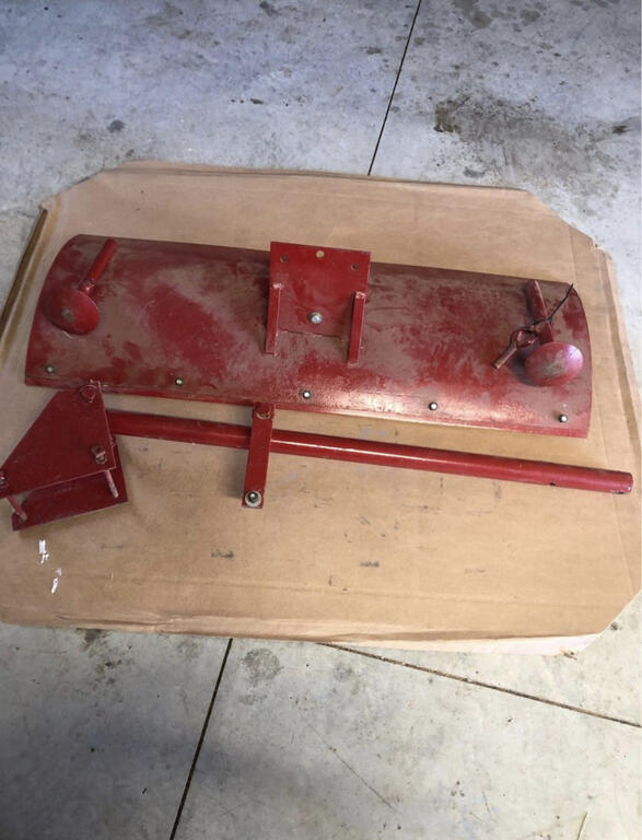

WH1618speed 543 #21 Posted March 16, 2023 Is this the right snow blade for this tractor? This one is “NOS” and it’s near me. The guy advertised it as an RJ blade. 2 2 Share this post Link to post Share on other sites
wallfish 20,724 #22 Posted March 16, 2023 Yes, that's an RJ dozer blade. Nice find! Go get it You would be surprised how well those little tractors push snow 1 Share this post Link to post Share on other sites

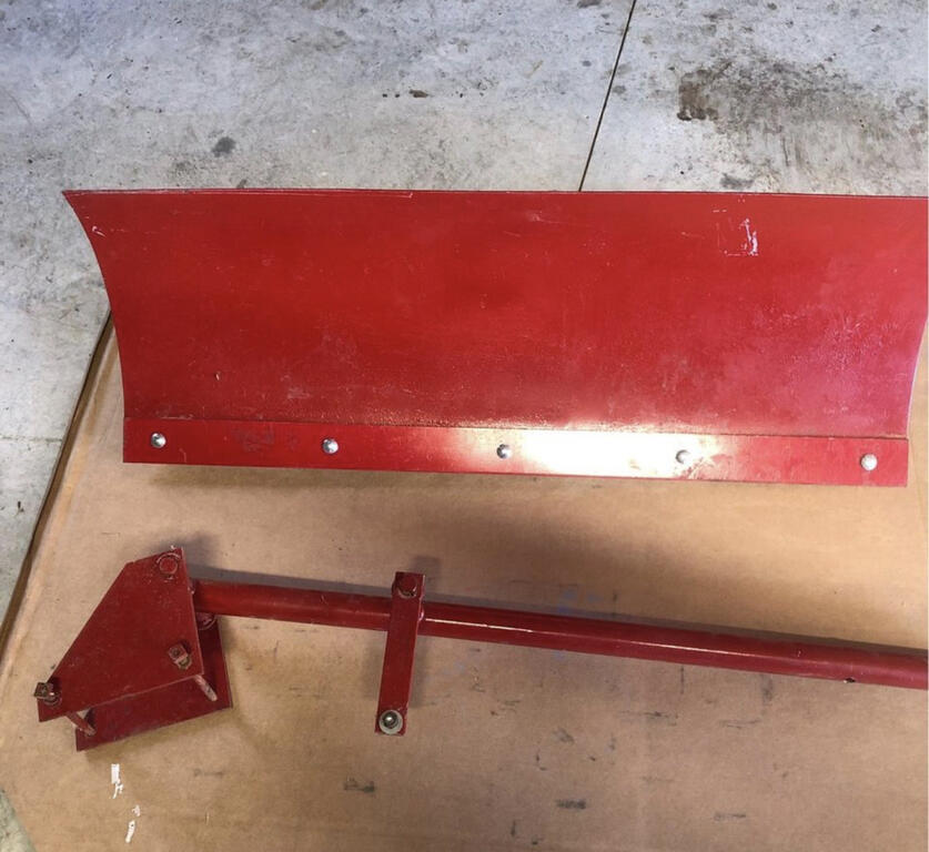

WH1618speed 543 #23 Posted March 16, 2023 1 hour ago, wallfish said: Yes, that's an RJ dozer blade. Nice find! Go get it You would be surprised how well those little tractors push snow Got it! It’s only $200 for that good of shape. 4 4 Share this post Link to post Share on other sites
oliver2-44 11,791 #24 Posted March 17, 2023 (edited) @WH1618speed I'm going to jump in your thread as I need some Suburban engine drive pulleys (originally WH 1608 2-1/2" OD x 3/4" ID ) which I think possible were the same ones for the RJ that you need. So maybe this will help both of us. I'm wondering if these cast steel pulleys from Surplus Center could be used. Question to ya'll RJ/Suburban guys @WHX?? @Racinbob @Lane Ranger @wallfishand others Did the WH1608 pulley have a side hub with the set screw in it, or was their no side hub and the set screw was in the bottom of the belt groove? https://www.surpluscenter.com/Power-Transmission/Pulleys/Finished-Bore-Pulleys/2-45-OD-3-4-Bore-1-Groove-Pulley-1-BK24-C.axd If there was no side hub am I thinking correctly that the hub on this surplus Center pulley could be machined off and a set screw added to the bottom of the pulley groove? Note: The Wh pulley is listed as 2.5" OD and this one is listed as 2.45 OD so it would make the tractor a tiny tiny bit slower. Edited March 17, 2023 by oliver2-44 1 2 Share this post Link to post Share on other sites
Racinbob 13,250 #25 Posted March 17, 2023 6 hours ago, oliver2-44 said: @WH1618speed I'm going to jump in your thread as I need some Suburban engine drive pulleys (originally WH 1608 2-1/2" OD x 3/4" ID ) which I think possible were the same ones for the RJ that you need. So maybe this will help both of us. I'm wondering if these cast steel pulleys from Surplus Center could be used. Question to ya'll RJ/Suburban guys @WHX?? @Racinbob @Lane Ranger @wallfishand others Did the WH1608 pulley have a side hub with the set screw in it, or was their no side hub and the set screw was in the bottom of the belt groove? https://www.surpluscenter.com/Power-Transmission/Pulleys/Finished-Bore-Pulleys/2-45-OD-3-4-Bore-1-Groove-Pulley-1-BK24-C.axd If there was no side hub am I thinking correctly that the hub on this surplus Center pulley could be machined off and a set screw added to the bottom of the pulley groove? Note: The Wh pulley is listed as 2.5" OD and this one is listed as 2.45 OD so it would make the tractor a tiny tiny bit slower. I've used Pulleys from Surplus on several occasions including that exact one on my 400. The original had the setscrew in the groove but the Surplus pulley worked fine. Yes. a smaller pulley on the engine will slow things a bit but in this case it's not noticeable. 1 Share this post Link to post Share on other sites
