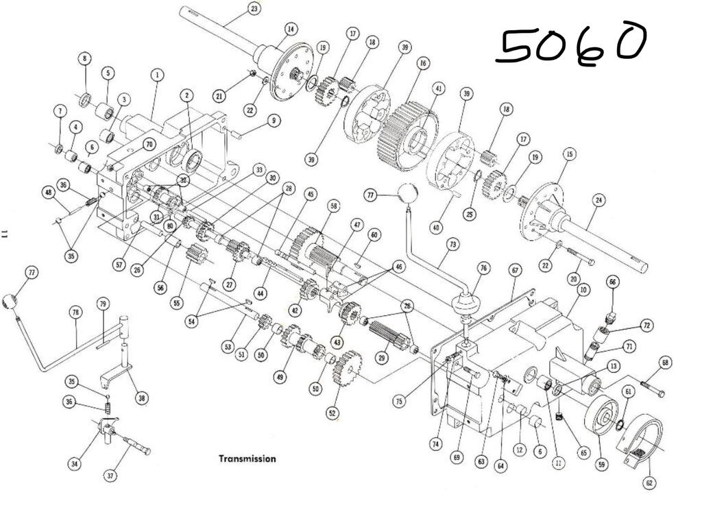

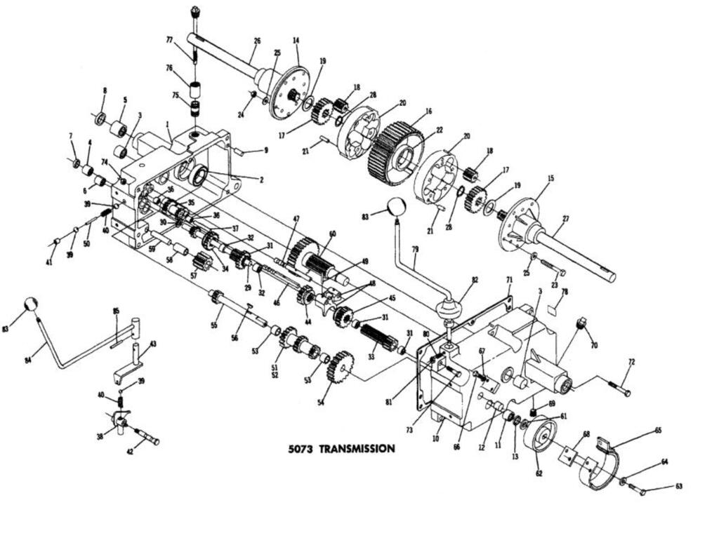

953 nut 63,634 #22 Posted February 25, 2023 8 hours ago, 23 Reo said: My numbers are model 1-0320 and motor K321S-60137. Is there a way to tell what transmission I have? Presuming we have determined it was a limited slip transaxle with 1 1/8" axles here is a quick way to figure it out. If your transaxle has a dipstick to check the oil it would be the 5073, If the oil level is checked by removing the fill cap located low on the left rear it is a 5060. The brake drum location is different too but not as easy to spot from the outside. 2 1 Share this post Link to post Share on other sites
kpinnc 16,692 #23 Posted February 25, 2023 (edited) 8 hours ago, 23 Reo said: Is there a way to tell what transmission I have? Jack the rear wheels up. Spin one side by hand. If the opposite wheel spins the opposite direction, you have a newer 8-pinion differential. If the opposite wheel spins the same direction, you have the original limited slip tranny. Edited February 25, 2023 by kpinnc 3 Share this post Link to post Share on other sites
Pullstart 68,682 #24 Posted February 25, 2023 (edited) 35 minutes ago, 953 nut said: The brake drum location is different too but not as easy to spot from the outside. You can tell brake drum easy enough, if there is a large gap or small gap between the brake drum and the left axle housing. There is a noticeable difference in the two IPL images too Edited February 25, 2023 by Pullstart 4 Share this post Link to post Share on other sites
953 nut 63,634 #25 Posted February 25, 2023 3 minutes ago, Pullstart said: You can tell brake drum easy enough, Also the 5060 brake band metal is thicker and pulls from the bottom whereas the 5073 has thinner metal and pulls from the top. I use the dipstick as an identifier because it is so conspicuous. 3 2 Share this post Link to post Share on other sites
