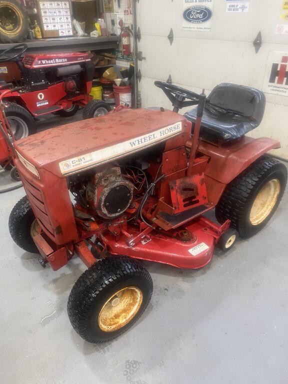

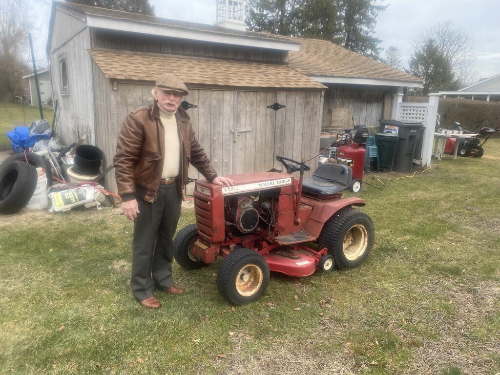

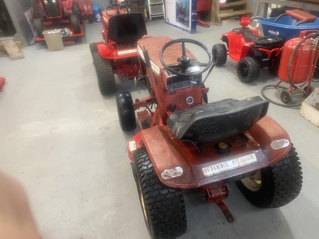

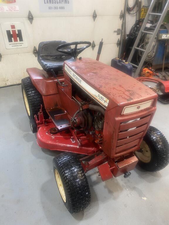

c-series don 12,109 #1 Posted February 20, 2023 About 10-15 years ago I was driving down the road and saw a gentleman mowing with a C-81. I knew he was relatively new to the area so of course I stopped to introduce myself and ask him about his tractor. Well don’t you know that even though he’s old enough to be my dad we became good friends. A couple of years ago he bought a new green tractor because it was easier to for him and his wife to get on and off. Well the C-81 was just sitting for a few years so he called me recently and said he wanted me to have it! It definitely needs some love but now it’s home in the Wheel Horse hospital (that’s what my friend calls it!) I’m going to repair whatever is necessary, then do a complete service on it. After that will be a light sanding and a @peter lena bath in WD-40 or whatever he recommends. 9 16 5 Share this post Link to post Share on other sites

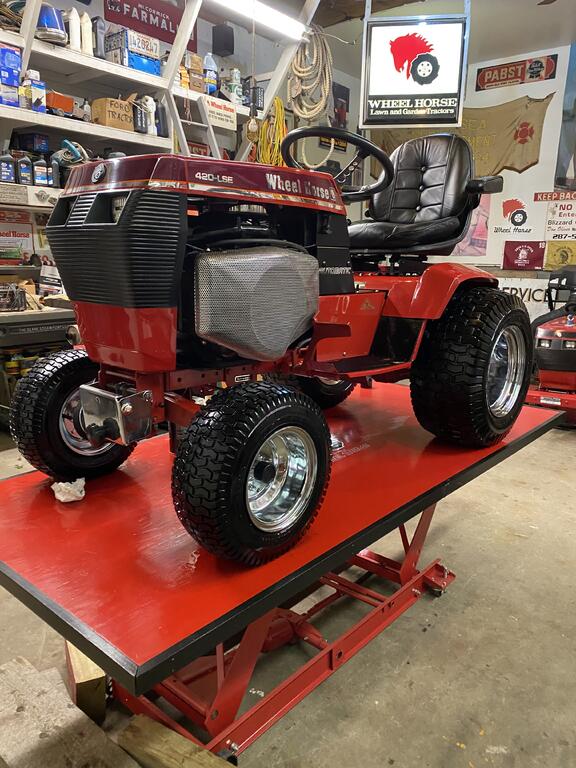

Brockport Bill 2,425 #12 Posted February 21, 2023 Don - how about telling us about that sweet lift table that WH is on in the background of that one photo ? NICE !!!!!! 1 1 Share this post Link to post Share on other sites

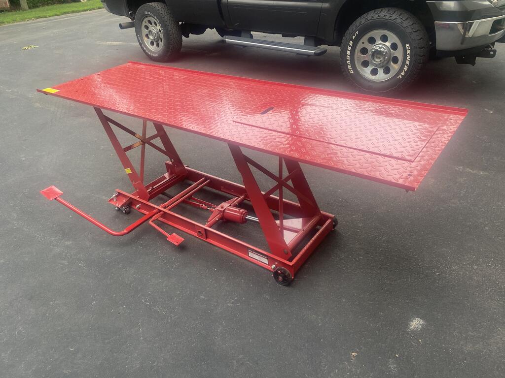

c-series don 12,109 #14 Posted February 21, 2023 @Brockport Bill Now that I have the C-81 up and running I’m going to drive it onto the table so I can stand up and work on it. Lots more to do! The table I purchased from Harbor Freight and widened the top with two sheets of 3/4” plywood. Of course I had to get a large decal from Terry! I waited until it went on sale, I think it was around $500 bucks. Honestly one of my better purchases as I have a bad back. I would definitely recommend getting one, as it makes working on them much easier. 3 8 Share this post Link to post Share on other sites

Blasterdad 3,167 #16 Posted February 21, 2023 I remember from a post of yours a while ago you knew where a 420 LSE was for sale but you were afraid of the Mrs. killing you.... Now I see that beauty on your lift table.... Is that the one? 3 1 Share this post Link to post Share on other sites
c-series don 12,109 #17 Posted February 21, 2023 @Blasterdad That’s the one! And I’m still married! Not sure how but I am 😜😂 2 2 Share this post Link to post Share on other sites
peter lena 9,939 #18 Posted February 21, 2023 @c-series don would not use any sandpaper on the finish , at first , just the lubricant soak to feed the paint , let it sit a day or 2 , see how it reacts to a drying wipe down. if its taken on a deeper color ,and wipes into a dull shene that will come back , with another soak down , and rub out . after that second oil soak , rub out . I use 6" ELECTRIC PALM BUFFER , with a cleaner wax . that flat hood would be a good test bed for results . pete 4 Share this post Link to post Share on other sites
Brockport Bill 2,425 #19 Posted February 21, 2023 6 hours ago, c-series don said: @Brockport Bill Now that I have the C-81 up and running I’m going to drive it onto the table so I can stand up and work on it. Lots more to do! The table I purchased from Harbor Freight and widened the top with two sheets of 3/4” plywood. Of course I had to get a large decal from Terry! I waited until it went on sale, I think it was around $500 bucks. Honestly one of my better purchases as I have a bad back. I would definitely recommend getting one, as it makes working on them much easier. lift table is awesome -- ( plus of course the LSE ) like many of us i know about the back aches -- YUK !! Table looks like would make the work much easier 5 Share this post Link to post Share on other sites
