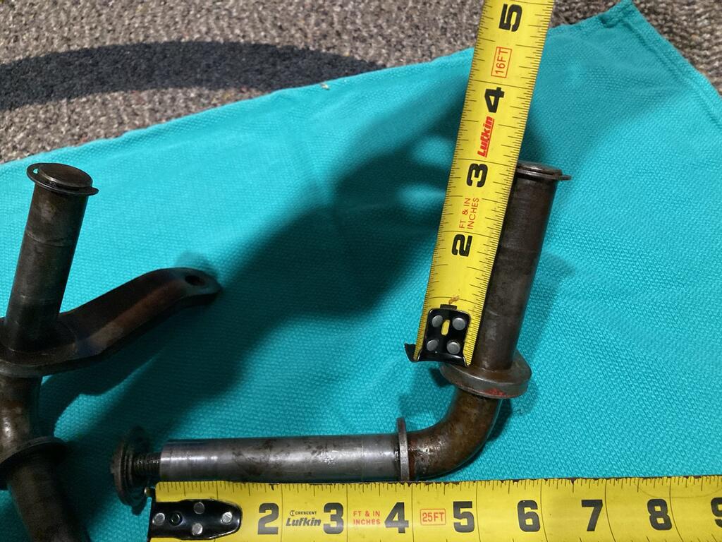

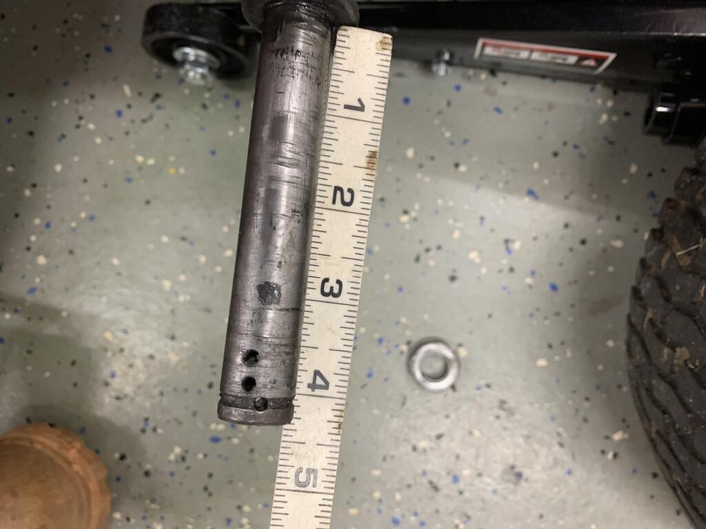

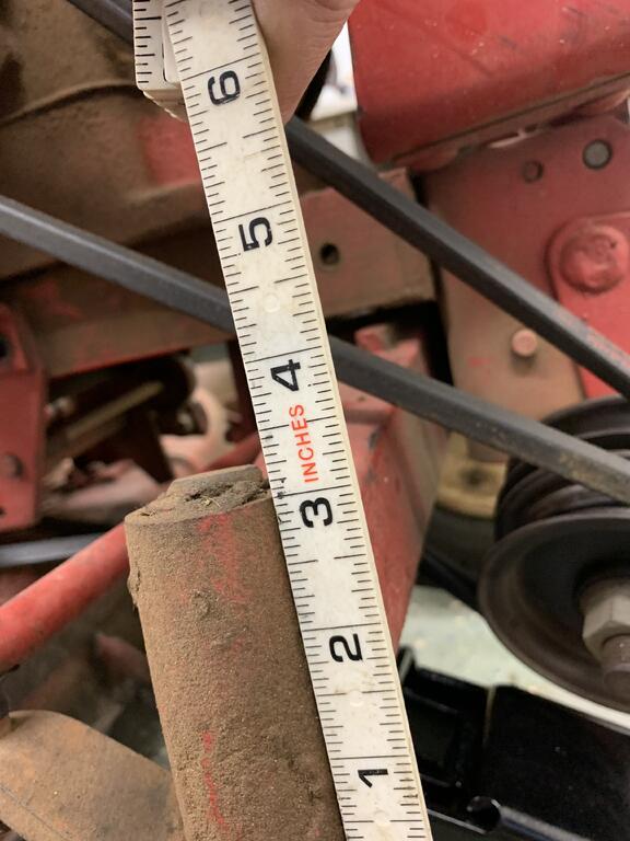

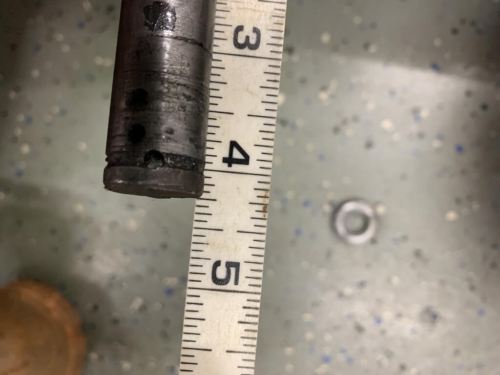

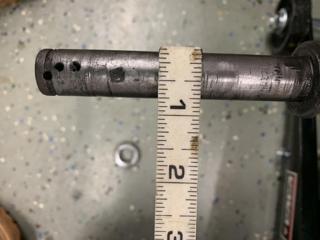

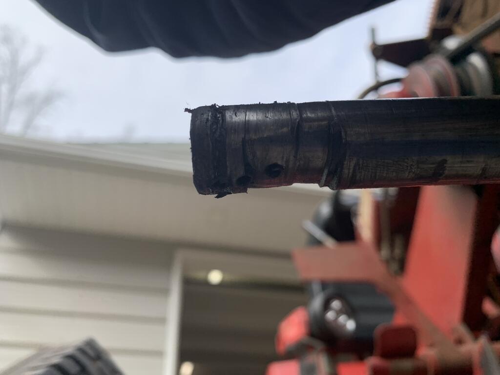

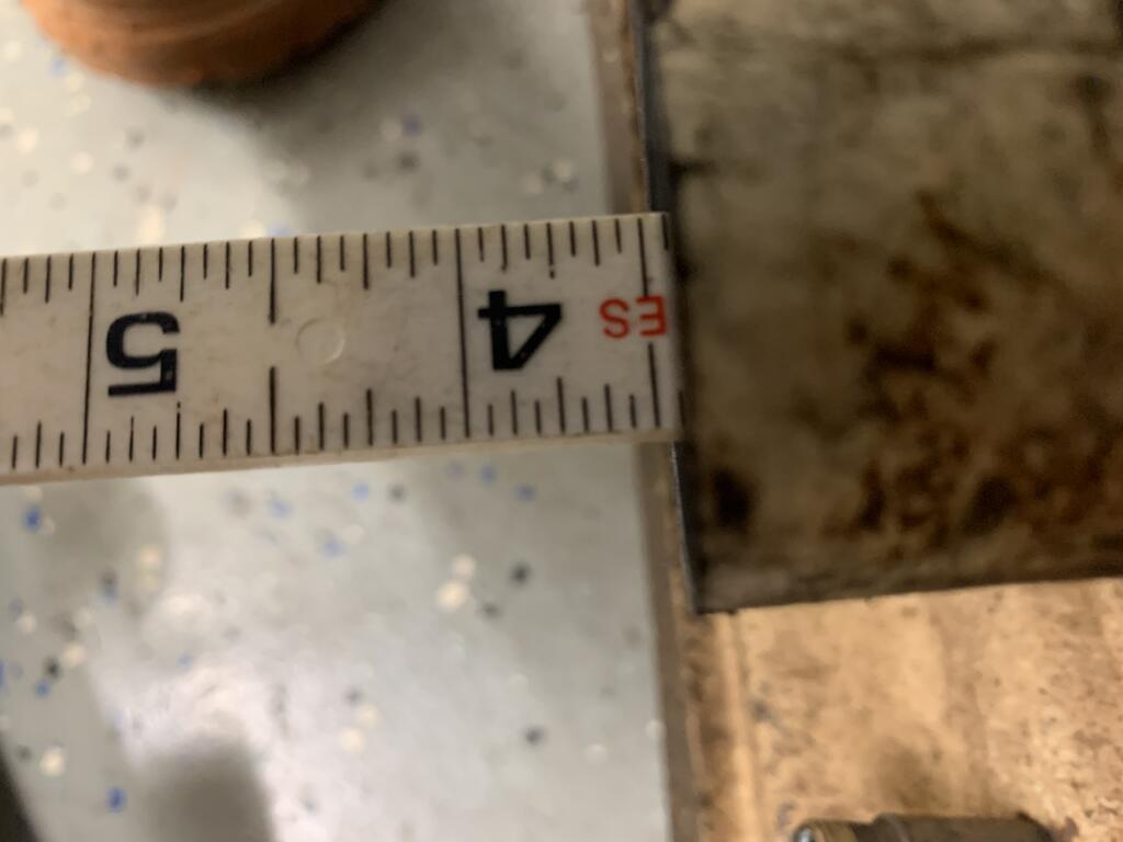

Horse Newbie 7,405 #78 Posted February 6, 2023 22 hours ago, ineedanother said: Hey Tim, I don't think you want to salvage that IMO. I know this might look a bit like scrap metal but it's actually pretty decent. I think it's from a b-100, I can't remember but I think it would work for you. The spindles are decent (not like NOS) and I can look around and maybe come up with a wheel. I'm a bit north of you but it's yours if you want it. @ineedanother, Here is some pics of the front wheel spindles on my C-160… spindle length = 4.25” spindle diameter = .75” spindle height through axle end(upright) = 3.25” depth/ length of wheel hub/ center = 3.5” Let me know if the spindles you have are the ones I need. 2 Share this post Link to post Share on other sites

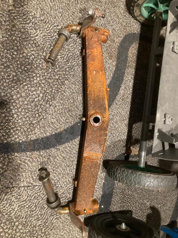

ineedanother 2,869 #82 Posted February 7, 2023 2 hours ago, Horse Newbie said: @ineedanother, Here is some pics of the front wheel spindles on my C-160… spindle length = 4.25” spindle diameter = .75” spindle height through axle end(upright) = 3.25” depth/ length of wheel hub/ center = 3.5” Let me know if the spindles you have are the ones I need. Those dimensions are typical. I'm pretty sure I have something here that will get you rolling again. I'll be back at the shop tomorrow and will confirm. 1 1 Share this post Link to post Share on other sites

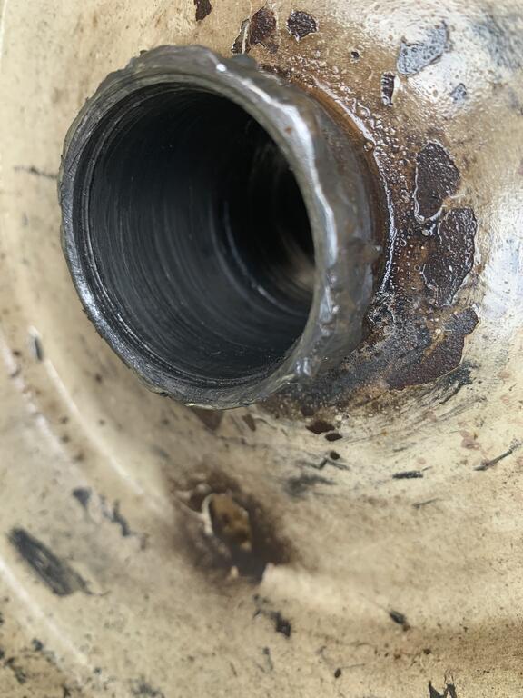

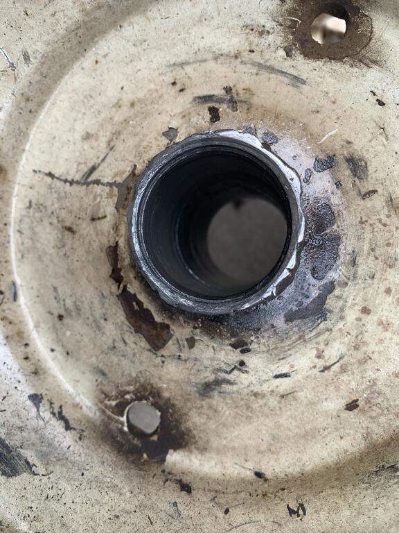

Lee1977 7,782 #86 Posted February 7, 2023 On 2/5/2023 at 1:42 PM, Horse Newbie said: So I started poking around a little bit with the 1977 (I think) C-160… I noticed ( after she was on the truck) that the front wheel bearings were beyond shot… Take a look at the bottom of the front right spindle. I don’t know if I’ll JB Weld it or try to acquire more spindles. I have some cheap China bearings I will throw in there for now, just so I can roll her, but first order of business is check the health of the Kohler and get these fried wires fixed… Time to go with trailer wheels, spindles and hubs. There isn't a way to fix those wheels they won't hold a bearing tight and will destroy another set of spindles. 1 2 Share this post Link to post Share on other sites
peter lena 10,070 #87 Posted February 7, 2023 @Lee1977 found that firming up those bearings and related areas to tougher lubrication , has prevented galling / scoring to movement areas . very solid / smooth . washer up that lateral / side bearing play , thats the killer to bearings . when they shuck / slide impact , side to side , that is their weakest point . washers eliminate that . since doing that to my horses , there is no bearing issues . when I grease the front end its off the ground for better grease coverage , and you can verify how it feels for function . bearings fail when they are out of their strong point and grease that will not hold in place. only a suggestion , pete 2 1 Share this post Link to post Share on other sites
ebinmaine 80,751 #88 Posted February 7, 2023 26 minutes ago, Lee1977 said: those wheels ..... won't hold a bearing tight @Horse Newbie Have you gotten to try to put new bearings in those wheels? I had the same thought as Lee. I'm wondering if the hole in those wheels is worn so badly that they won't hold a bearing for any reason. 2 Share this post Link to post Share on other sites
peter lena 10,070 #89 Posted February 7, 2023 @ebinmaine as you know chinese junk , barely makes anything right . lube/ and lateral firming helps a lot , also better if wheel / tire can slide rather than grip ground for less lateral loading , pete 3 Share this post Link to post Share on other sites
Lee1977 7,782 #90 Posted February 7, 2023 Mine was not that bad on my C-120, It was only 12 years old at the time, but it destroyed the spindle. I also had a bad hub on my 1989 520 when I got it the bearing was loose, but the spindle was still good. I used the good wheel came off my C-120. 3 Share this post Link to post Share on other sites

ineedanother 2,869 #92 Posted February 7, 2023 On 2/6/2023 at 5:00 PM, Horse Newbie said: @ineedanother, Here is some pics of the front wheel spindles on my C-160… spindle length = 4.25” spindle diameter = .75” spindle height through axle end(upright) = 3.25” depth/ length of wheel hub/ center = 3.5” Let me know if the spindles you have are the ones I need. Hey Tim, what I have should work fine. The spindles aren't as long because no extra length is needed beyond the hub for a washer and cotter pin but everything else looks right. You can have them both so you have bolts on both and not one with a bolt and one with a cotter pin. PM your address and I'll get them shipped off as soon as I can. 3 Share this post Link to post Share on other sites
ineedanother 2,869 #93 Posted February 7, 2023 Based on your measurements, I think worst case scenario you might have to grind a bit from the top of the axle to slide the clip on but I think you'll be good. 4 Share this post Link to post Share on other sites
