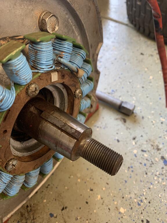

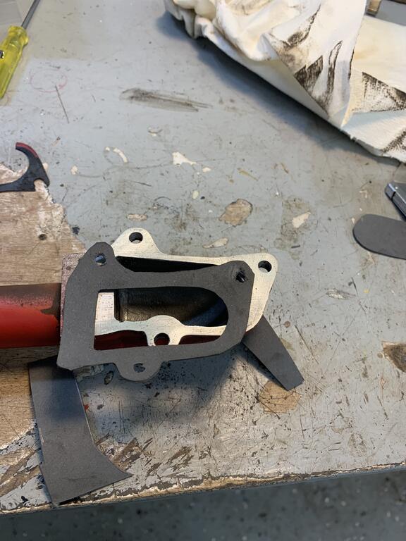

Horse Newbie 7,405 #261 Posted October 25, 2023 So today while waiting for the colonoscopy prep medicine to work, I put the K341 oil pan, flywheel, and oil dipstick tube back on. Cleaned the stator before reattaching… Had to make a dipstick tube gasket… I had to drop things and run a few times…😆 1 4 Share this post Link to post Share on other sites

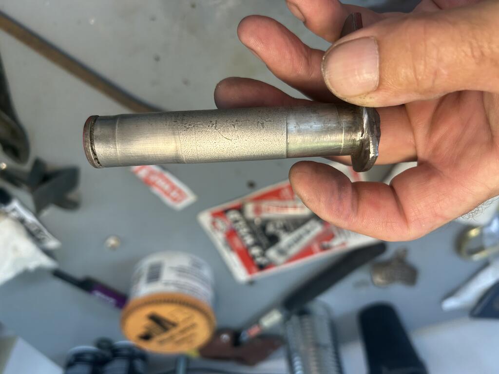

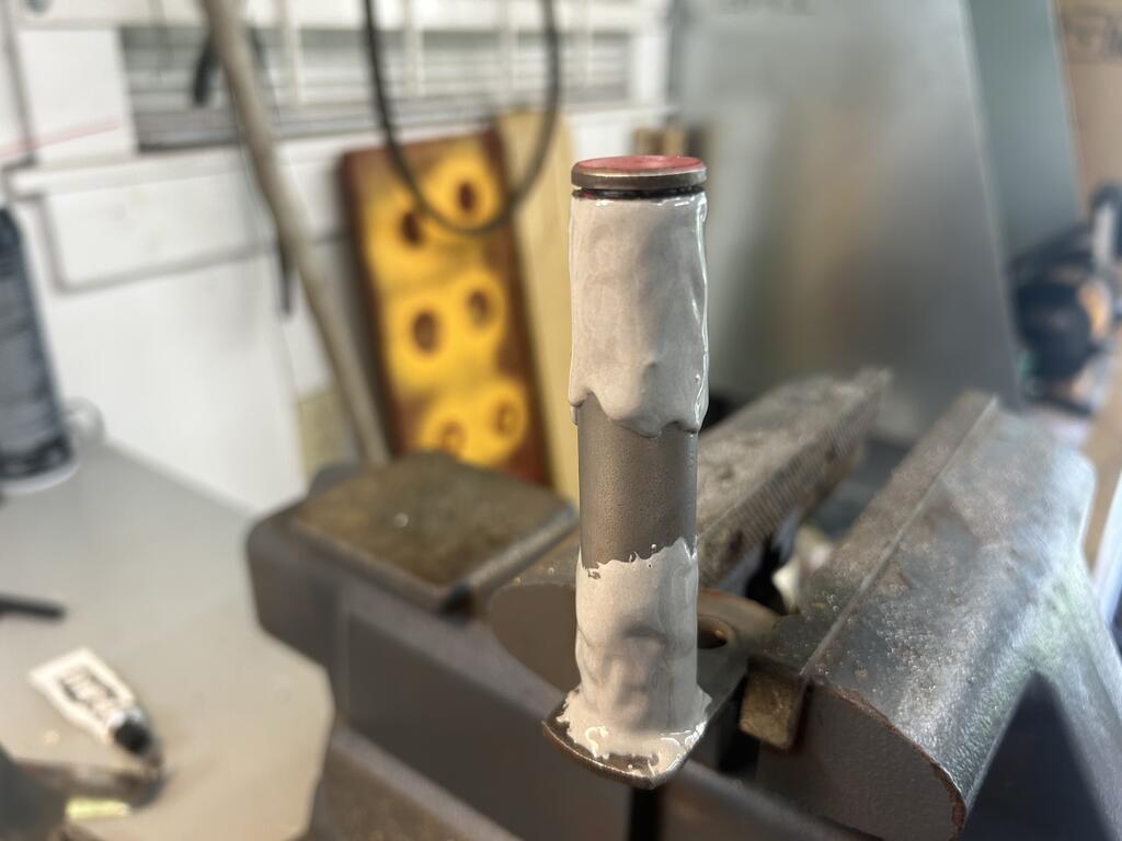

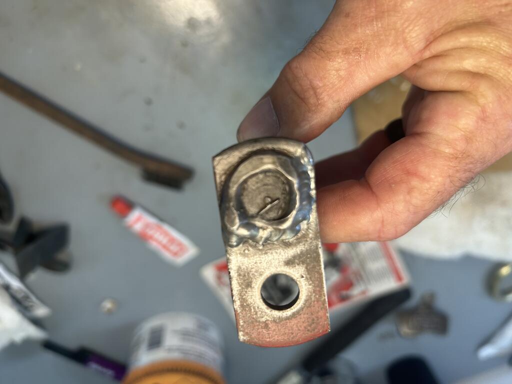

Horse Newbie 7,405 #263 Posted May 4, 2024 Okay, so it’s been awhile since I messed with my C-160. I finally got my welder/ blacksmith/ artist/machinist to weld the tab back on the front axle kingpin ( that’s what I call it). It had some worn places on it. I know there’s a lot of you fellows who would not take this approach to the repair, but I decided to just fill the worn spots on the shaft with some JB Weld. I think it will go another 40 years or so with this repair. I know there will be plenty of filing and sanding to get it somewhat back round… 3 Share this post Link to post Share on other sites

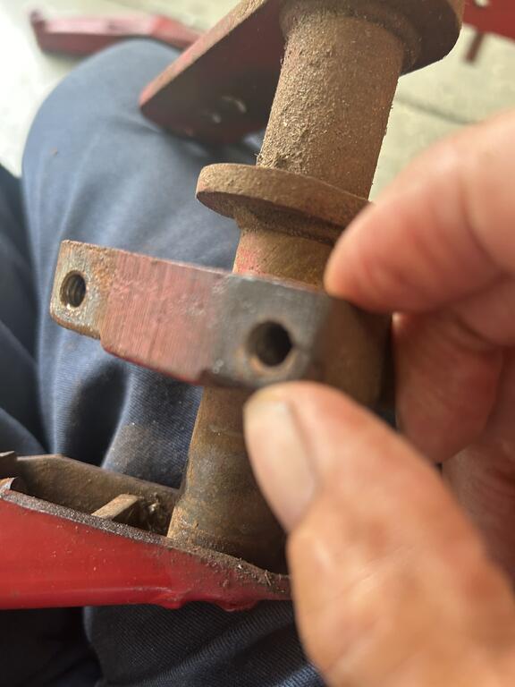

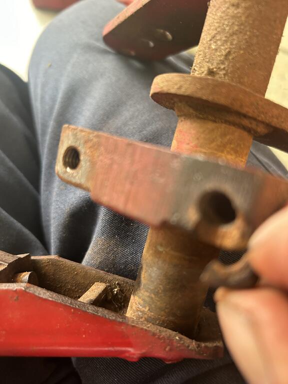

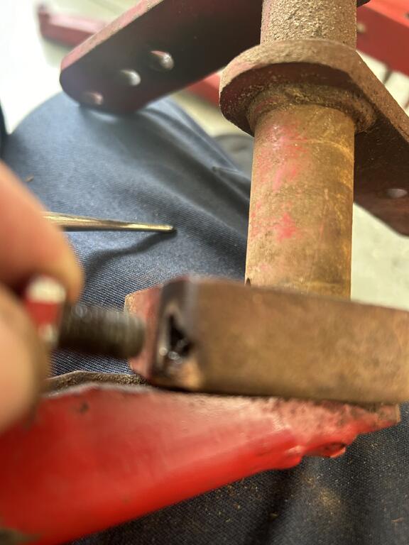

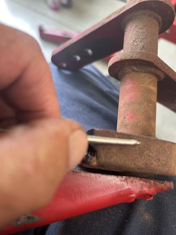

Horse Newbie 7,405 #264 Posted May 4, 2024 Not planning a refresh or restore on this C-160… was cleaning and true to my nature I started taking things off to clean hard to reach places. Well I was taking off the height adjustment lever and when I did a little corner of the cast iron base piece fell off. Would you guys try to get my welder friend to try to weld the corner back, or maybe just tap the hole deeper and use a longer bolt ? The hole already goes about an inch deep so I wouldn’t have to drill it. Share this post Link to post Share on other sites

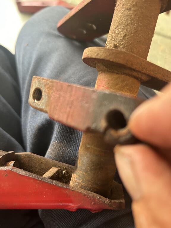

Horse Newbie 7,405 #265 Posted May 4, 2024 Also found a stress/ metal fatigue crack in the dash tower where the base piece for the height adjuster bolts on. Guess I will have my friend weld the crack up… 1 Share this post Link to post Share on other sites

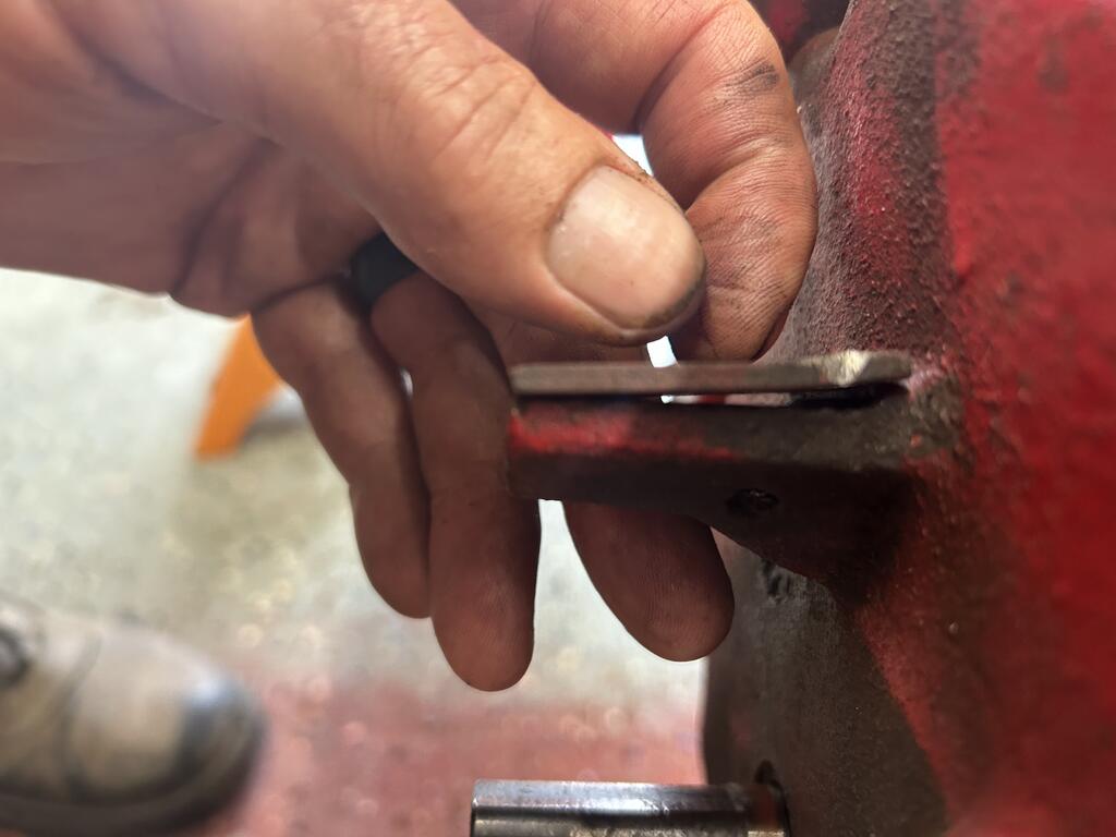

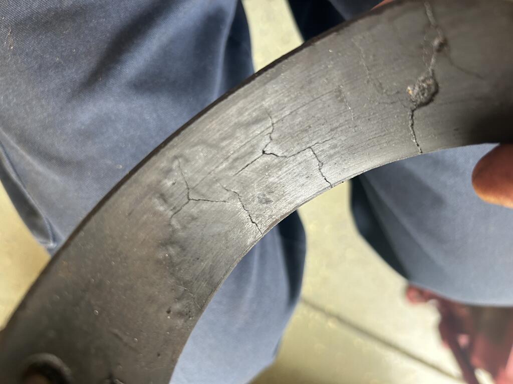

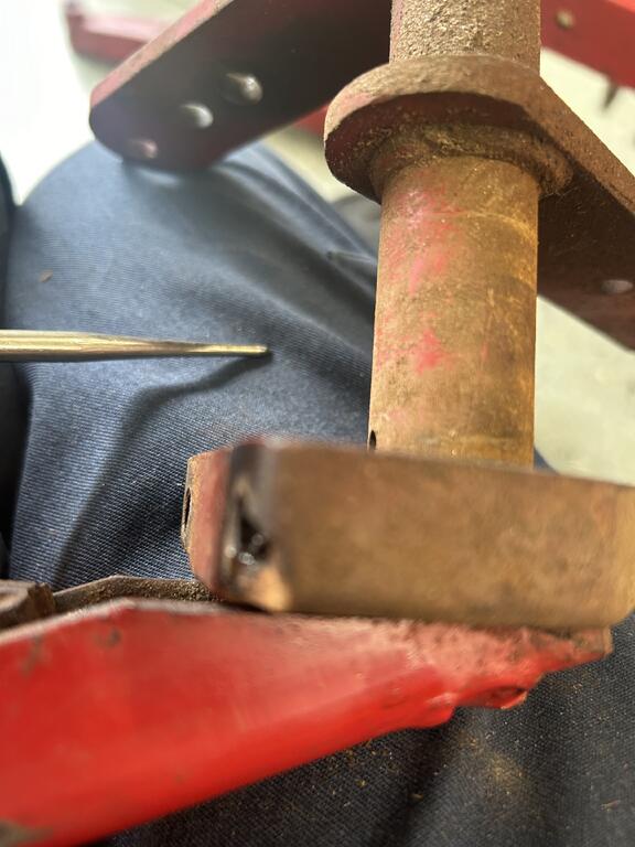

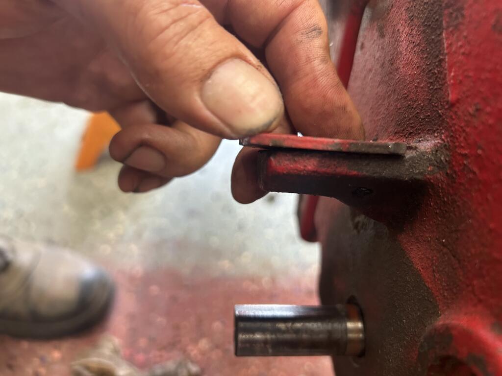

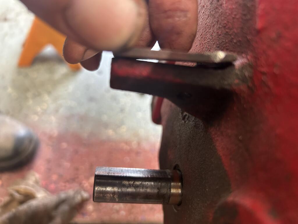

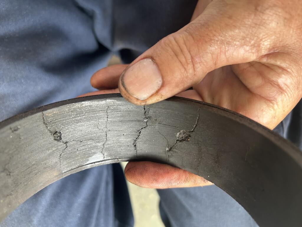

Horse Newbie 7,405 #266 Posted May 4, 2024 I have a few questions concerning the brake band and the small metal plate that bolts on top of the brake band to the cast piece on side of tranny… The way I took the piece off, it has a gap and doesn’t bolt down flat… the cast piece on side of tranny holds it up. You can see in the picture… But if I spin it around then it lays flat , but then more of it hangs out toward the left side of the tractor. Would you bolt it flat, as long as it doesn’t interfere with anything ? Next, I noticed the brake band pad has cracks… use or order a new pad ? Share this post Link to post Share on other sites

ebinmaine 80,750 #268 Posted May 4, 2024 1 hour ago, Horse Newbie said: the height adjustment lever and when I did a little corner of the cast iron base piece fell off. Would you guys try to get my welder friend to try to weld the corner back, or maybe just tap the hole deeper and use a longer bolt ? You could try to tap that but it may be cast iron. Still doable but special care. I'd do that instead of welding it. 1 hour ago, Horse Newbie said: Also found a stress/ metal fatigue crack in the dash tower where the base piece for the height adjuster bolts on. Guess I will have my friend weld the crack up… Definitely repair that. I've never seen one but I understand that's fairly common. A LOT of stress there. 25 minutes ago, Horse Newbie said: Would you bolt it flat, as long as it doesn’t interfere with anything ? Yes. 25 minutes ago, Horse Newbie said: Next, I noticed the brake band pad has cracks… use or order a new pad ? DO NOT use that shoe. The cracks are from heat stress and age. Reinstalling it would "get you by" but you're only exacerbating the issue. If you need shoe material McMaster Carr sells it. ...by the foot (?) 1 1 Share this post Link to post Share on other sites

Horse Newbie 7,405 #270 Posted May 4, 2024 11 minutes ago, ebinmaine said: If you need shoe material McMaster Carr sells it. ...by the foot (?) Who’s the brake pad man on Redsquare… would rather support a member… 1 Share this post Link to post Share on other sites
Lee1977 7,782 #271 Posted May 4, 2024 1 minute ago, Horse Newbie said: You tracking me Don?… Guess I need to stay off Fakebook… You provided pictures right here on Redsquare, I don't do Facebook. 1 Share this post Link to post Share on other sites
ebinmaine 80,750 #272 Posted May 4, 2024 2 minutes ago, Horse Newbie said: Who’s the brake pad man on Redsquare… would rather support a member… @rmaynard Our friend Bob. 1 Share this post Link to post Share on other sites
Horse Newbie 7,405 #273 Posted May 4, 2024 14 minutes ago, ebinmaine said: You could try to tap that but it may be cast iron. Still doable but special care. I'd do that instead of welding it. Thanks Eric, That substantiates what my welder/ machinist says.. and with you being a masta mo-can-ic, I went ahead and tapped the 5/16-18 hole and will use a longer bolt upon reassembly. 19 minutes ago, ebinmaine said: Definitely repair that. I've never seen one but I understand that's fairly common. A LOT of stress there He said cast can easily be tapped… just use plenty of lube and go easy. Said it may dull the tap a bit. Will definitely be welding that stress crack… 2 Share this post Link to post Share on other sites
ebinmaine 80,750 #274 Posted May 4, 2024 4 minutes ago, Horse Newbie said: 5/16-18 Get a grade 8 bolt in there too. Extra strength won't hurt. 1 Share this post Link to post Share on other sites

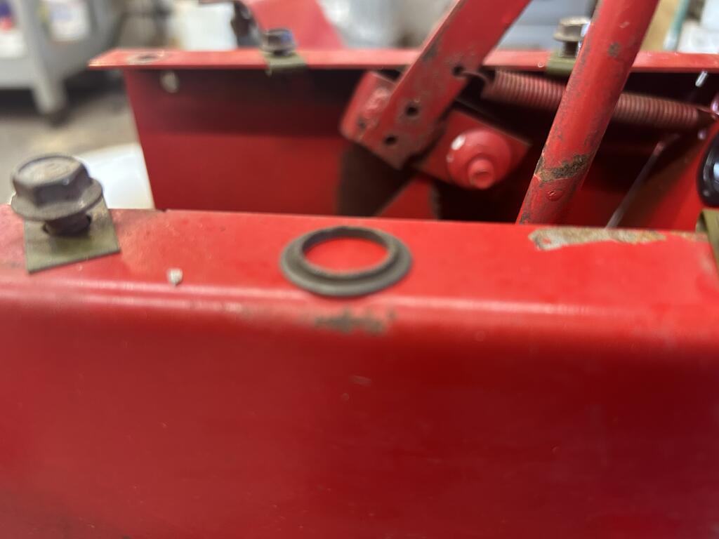

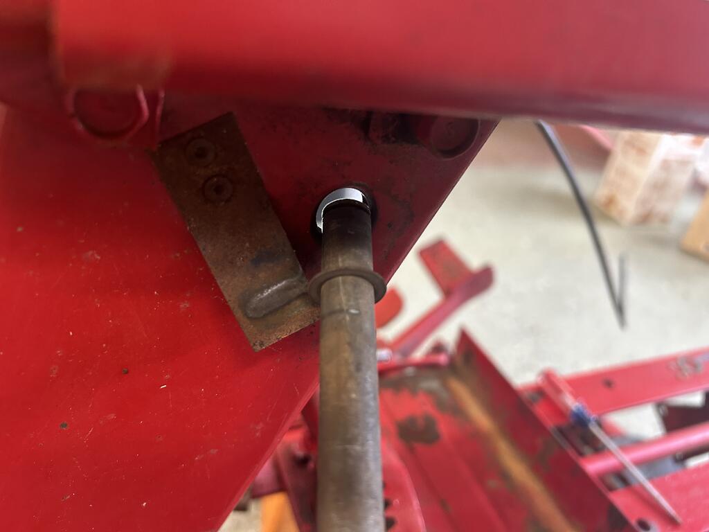

Horse Newbie 7,405 #275 Posted May 4, 2024 Guys, I hate to ask so many little questions, but I don’t know things… what are the little bushings called that go on certain shafts where they pass through sheet metal pieces?… Like in this particular case, the PTO engagement lever going through the steering wheel tower… and shouldn’t it be like a ring/ washer type thingy with a shoulder? Hmmm… would it be called a shoulder bushing ? Share this post Link to post Share on other sites
