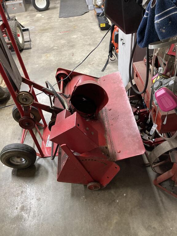

Blasterdad 3,164 #29 Posted January 31, 2023 (edited) You will need one tha fits a C-Series or 300 400 or 500 Series or a 2 stage... The single stage will look like this & have the drive pulley on the left (facing it) & lines up with the PTO. Edited January 31, 2023 by Blasterdad 2 1 Share this post Link to post Share on other sites

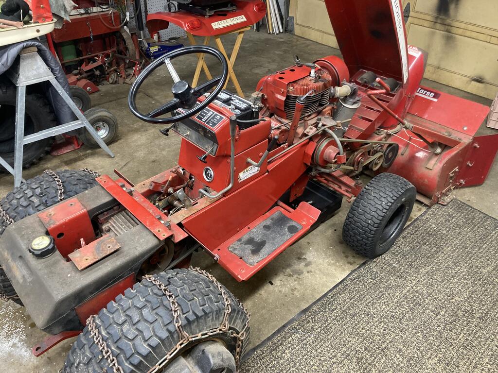

peter lena 9,899 #31 Posted January 31, 2023 @Blasterdad noting your blower drive belt set up , do anything to improve / verify the idler pulley spin up ? also the spring tensioned idler frame mount areas ? did a grease change in bearings , and increase the tension spring pull , also changed the trunnion to a heim joint ,and freed up the pto lever start . washers / grease , like this .looking at washer fill in on start of pto lever , that is also a ground rail, note the battery cable in last photo , going to engine corner / frame , from battery ground bolt . and plug in for battery tender . that ground enhances , rectifier charging , and head light connection , also wakes up your amperage gauge . any nagging problem , was removed , pete 2 Share this post Link to post Share on other sites

peter lena 9,899 #41 Posted February 1, 2023 @Dreamcatcher typically the mule bearings are the same as the deck spindle bearings , use a small putty knife or a slim pocket flat screwdriver for that seal pop, no need to beat them up ,pop right off. pto inner cone needle bearing , thorough wipe out , very slim amount of grease , or it slings to clutch face , the hi temp grease is typically polyurea rated , ant sling . once the bearings clean , repack to same amount as original , mush in . note , added heim to replace trundle , eliminate sloppy fit . also show added washers at start of pto lever connection, makes it solid/ smooth , that battery rail is a gold mine of improvement opportunity . ask away , glad to help , pete Share this post Link to post Share on other sites

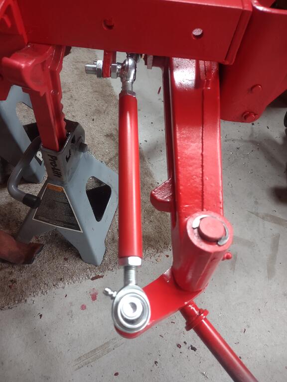

Dreamcatcher 102 #42 Posted February 1, 2023 29 minutes ago, peter lena said: , added heim to replace trundle , eliminate sloppy fit . I apologize, i'm not familiar with what this is. Share this post Link to post Share on other sites
peter lena 9,899 #43 Posted February 1, 2023 @Dreamcatcher open up the lever action picture above , top of battery / pto lever mount start point , go down to second / third pictures , that is a ball swivel HEIM JOINT . much better than the original trundle hook up wich is usually sloppy in its function . just part of the complete elimination of the original intended set up . if you like yours , leave it , no problem pete 2 Share this post Link to post Share on other sites
