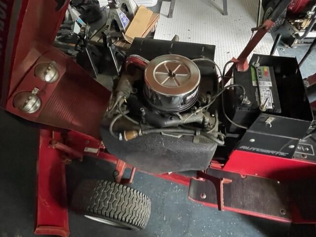

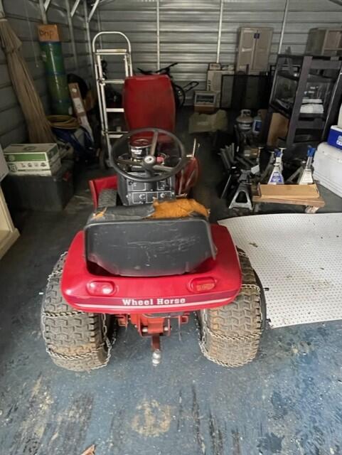

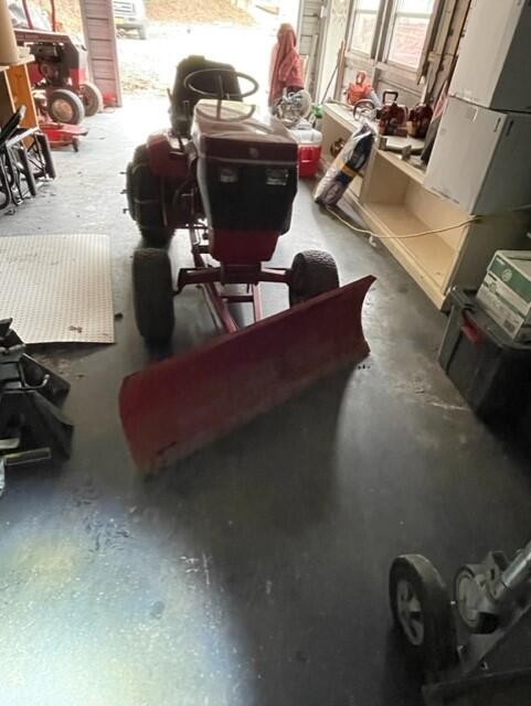

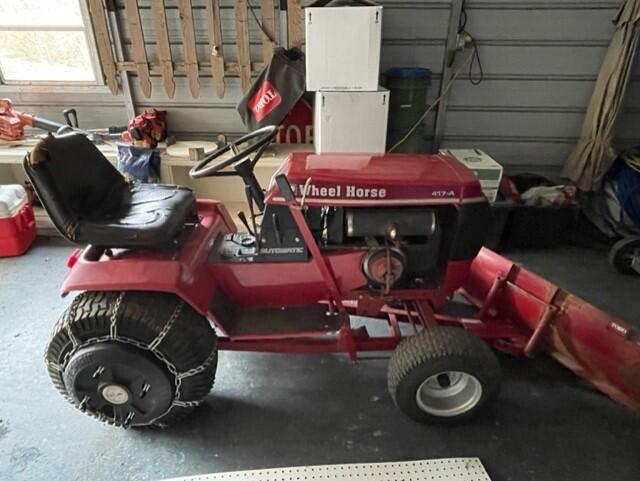

Dreamcatcher 102 #1 Posted January 28, 2023 Well, I did it. Not the B80 O posted about yesterday but a pretty nice 417A. Came with a relatively complete second tractor, 2 total decks, 2 total front blades. It has no leaks, fires up almost instantly and for its age looks pretty darn clean in my opinion. Now the fun begins cleaning up the deck for some paint and spring duty. Might get to plow with it this winter. I need to find a manual so I can get some new plugs, filters, etc. I'd like to get a 'new' seat but other than that i'm excited to start tinkering and using it. The pictures aren't great, I just wanted to get it put away so I could return to family stuff. 5 9 Share this post Link to post Share on other sites
Dreamcatcher 102 #2 Posted January 28, 2023 One more pic 4 9 Share this post Link to post Share on other sites

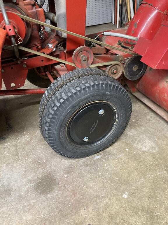

midpack 1,148 #3 Posted January 28, 2023 That's a nice looking machine i have a 417-8 And I Love it! If you plan in plowing, some #40 chain wrapped around the front wheels will make a big difference in steering 2 Share this post Link to post Share on other sites

Blasterdad 3,167 #6 Posted January 28, 2023 51 minutes ago, Dreamcatcher said: Thank you. I do plan on plowing iwth it. Is this a specific kind of chain? Do you have a pdf manual or know where to ge tone for the tractor? Yours has the smooth hood, should be a 1985...?. Tractor Supply, 10', enough for both front wheels....$25.00 7 1 Share this post Link to post Share on other sites
Dreamcatcher 102 #7 Posted January 28, 2023 Yes I found the chain but how is it used on the tires? I apologize....complete rookie here 1 Share this post Link to post Share on other sites

Dreamcatcher 102 #9 Posted January 28, 2023 5 minutes ago, Blasterdad said: Yours has the smooth hood, should be a 1985...?. Tractor Supply, 10', enough for both front wheels....$25.00 Yes I see now. How is it fastened to the tire? 1 Share this post Link to post Share on other sites

Blasterdad 3,167 #11 Posted January 28, 2023 Just now, Dreamcatcher said: Yes I see now. How is it fastened to the tire? Wrap it around the center of the tire tight when flat, blow it back up, done. ( about 100 links is a good starting point, if too loose keep removing links till tight ). 5 Share this post Link to post Share on other sites
953 nut 68,519 #12 Posted January 28, 2023 I have a 418-C which is the same tractor with a Magnum engine, it is a great snow mover, love it. You may want to cut the bolts on the wheel weights before you hit your shins on them. 5 1 Share this post Link to post Share on other sites

ri702bill 12,817 #15 Posted January 29, 2023 (edited) On 1/28/2023 at 6:45 PM, 953 nut said: I have a 418-C which is the same tractor with a Magnum engine, it is a great snow mover, love it. You may want to cut the bolts on the wheel weights before you hit your shins on them. OR.. do as I did.Cut 2 opposite flats in the head of the carriage bolts, reverse them and use a pair of small locking pliers to hold them while you tighten from the back of the rim... no more protrusion isue.. Edited January 31, 2023 by ri702bill 5 Share this post Link to post Share on other sites

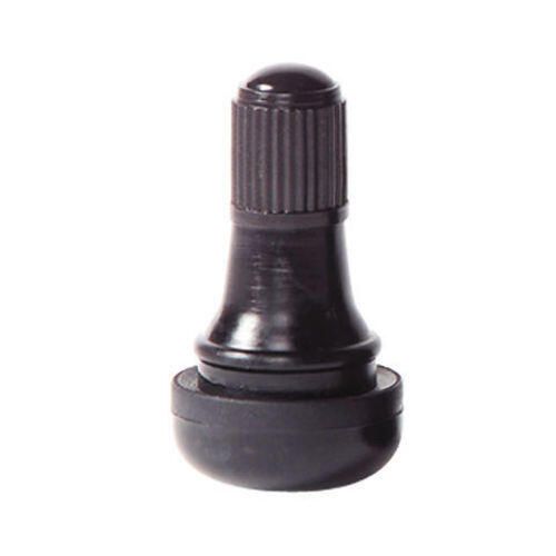

Dreamcatcher 102 #16 Posted January 30, 2023 I've been looking up tires and see many suggest to go to 23x8.5 12. Assuming my current research is accurate I have a couple of questions. 1. These DO NOT use a tube correct? 2/ I'll replace the valve stems too; any gotchas here? 3. Vendor suggestions? Amazon? Forum Sponsor? 4. This is a DIY job correct? 5. Any tire suggestions? Or stay away from? I appreciate everyone's help. 1 Share this post Link to post Share on other sites

lynnmor 9,013 #19 Posted January 30, 2023 2 hours ago, Dreamcatcher said: 1. These DO NOT use a tube correct? 2/ I'll replace the valve stems too; any gotchas here? You can go tubeless, if you do use short TR412 stems. 3 Share this post Link to post Share on other sites

Dreamcatcher 102 #22 Posted January 30, 2023 Taking a closer look durin lunch I don't see an motor oil filter. If it had an oil filter where would it be? So far my reading finds the motor oil can be 10w-30 and 30 weight oil for the transmission? Where abouts is the drain plug for teh tranny? I assume I fill the trans using the dipstick under the seat? 1 Share this post Link to post Share on other sites

c-series don 12,363 #24 Posted January 31, 2023 There’s no engine oil filter, however there is a transmission oil filter. I believe NAPA1410 is the correct filter. I use 30W in the engine and 10W-30 in the transmission. The drain plug is on the bottom of the transmission just forward of the trailer hitch. It’s a 3/8” or 5/16” Allen key. 2 1 Share this post Link to post Share on other sites
