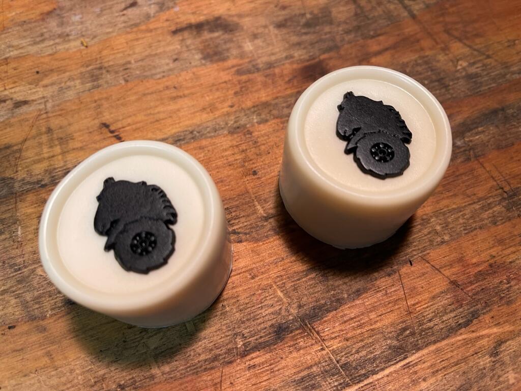

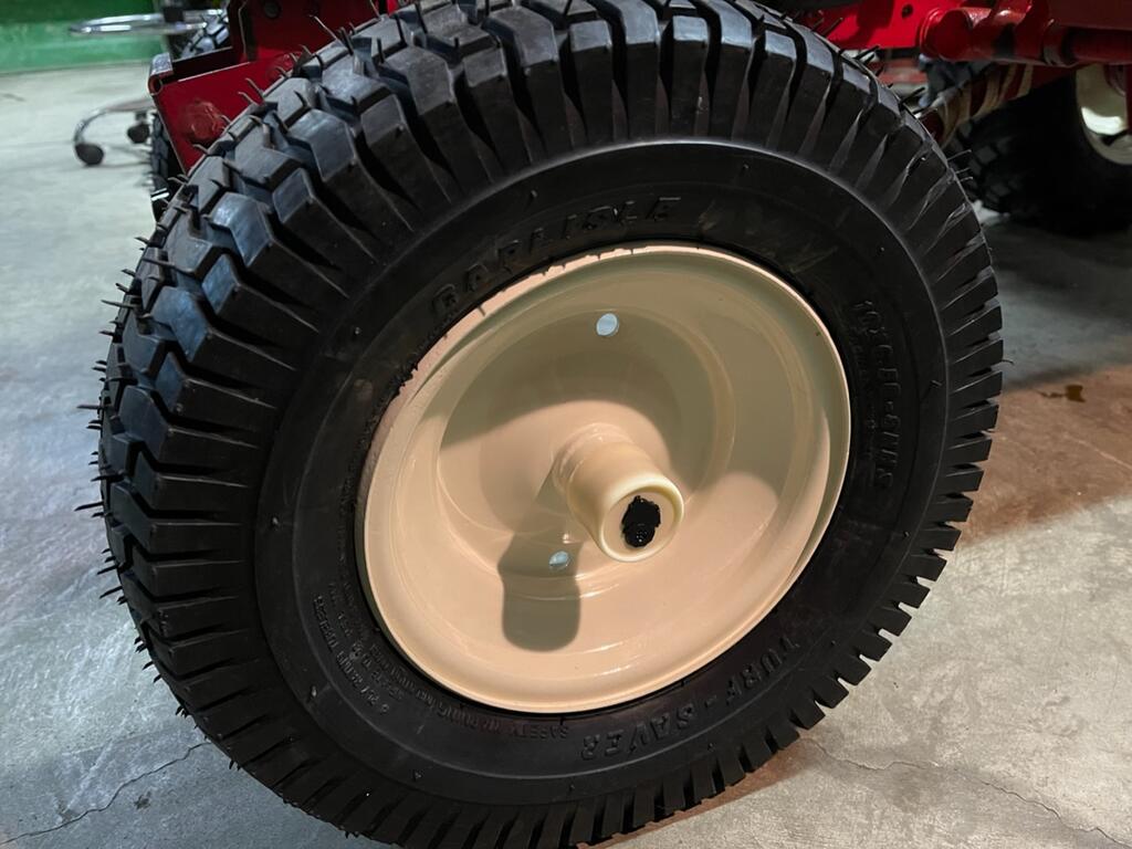

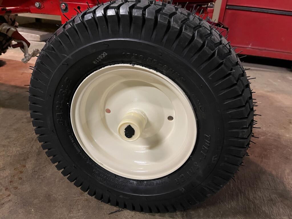

I put on some special front hub dust covers, too.
  • Excellent 4

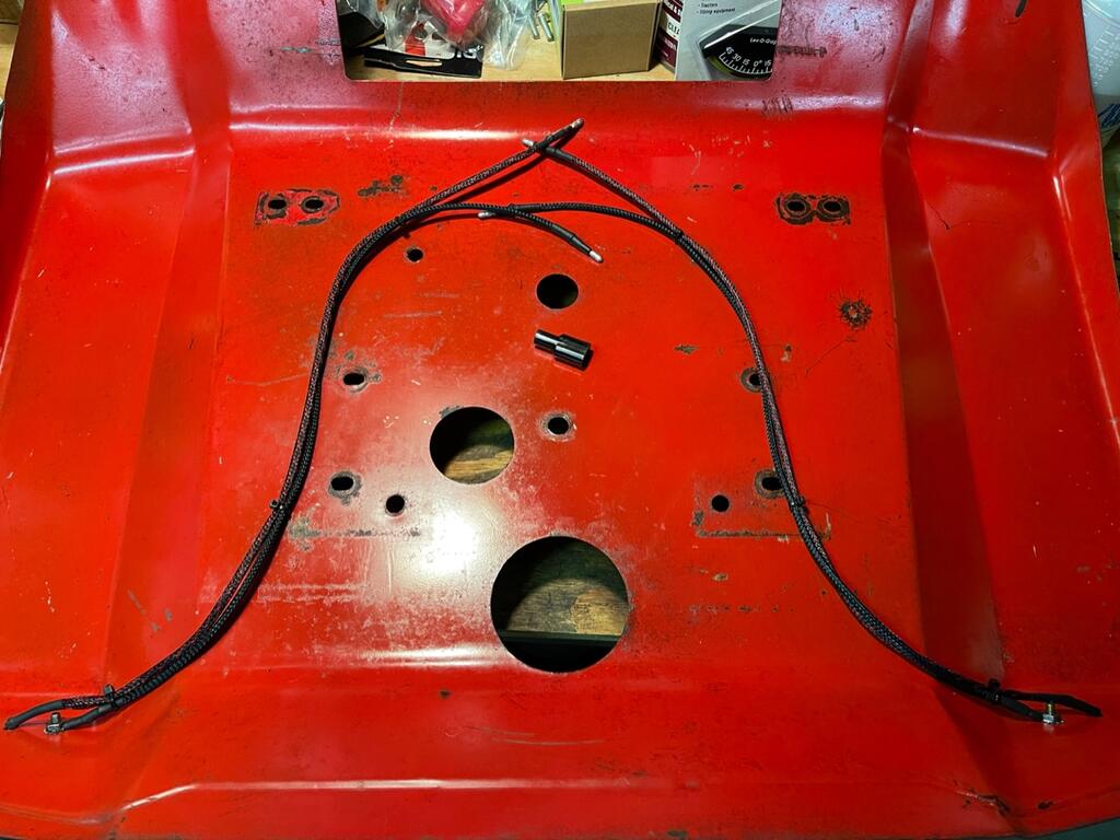

And I re-ran the ground for the taillights and used one of those 3-way bullet connectors.
I can’t show it hooked up very easily; sorry no pic of that.
Edited by TractorEd
3 hours ago, TractorEd said:
dust covers
Them wheels look snazzy!!!

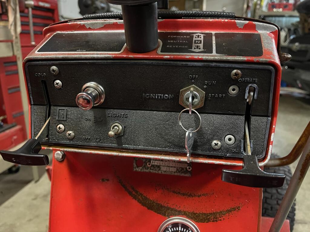

A white paint pen and some patience will make that dashboard look new!
WHX??
:text-yeahthat:There is a really good thread in instructionals on doing it.

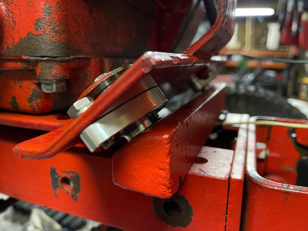

On 1/27/2023 at 6:01 PM, Blasterdad said:
What do you mean by "Bucks like crazy"?
If the rubber isolators in the shaker plate are in good the engine should move very little.
It's very common for those rubber mounts to be rotten, & from what you're describing they're probably shot.
One of the best mods for the shaker plate engines is to replace them with solid mounts.
Toro wants a fortune for the rubber replacement mounts & the solid mounts make everything rock solid.
I just put a set on my C-161, they make a BIG difference.
These are what they look like, I think they were around $60.00. (precision machined billet aluminum & way less expensive than the rubber ones).
@Blasterdad where can I get a set of those solid engine mounts?
Thanks,
Ed
Ed-it:  I guess the Zach Kerber photo gave it away, lol.  I see them on that site, but just to be sure, it is one size fits all, right?
Re-Ed-it:  Thanks for the info on these!  I just bought a set.  :thumbs:  And my apologies, my brain is scrambled today.
Edited by TractorEd
TractorEd

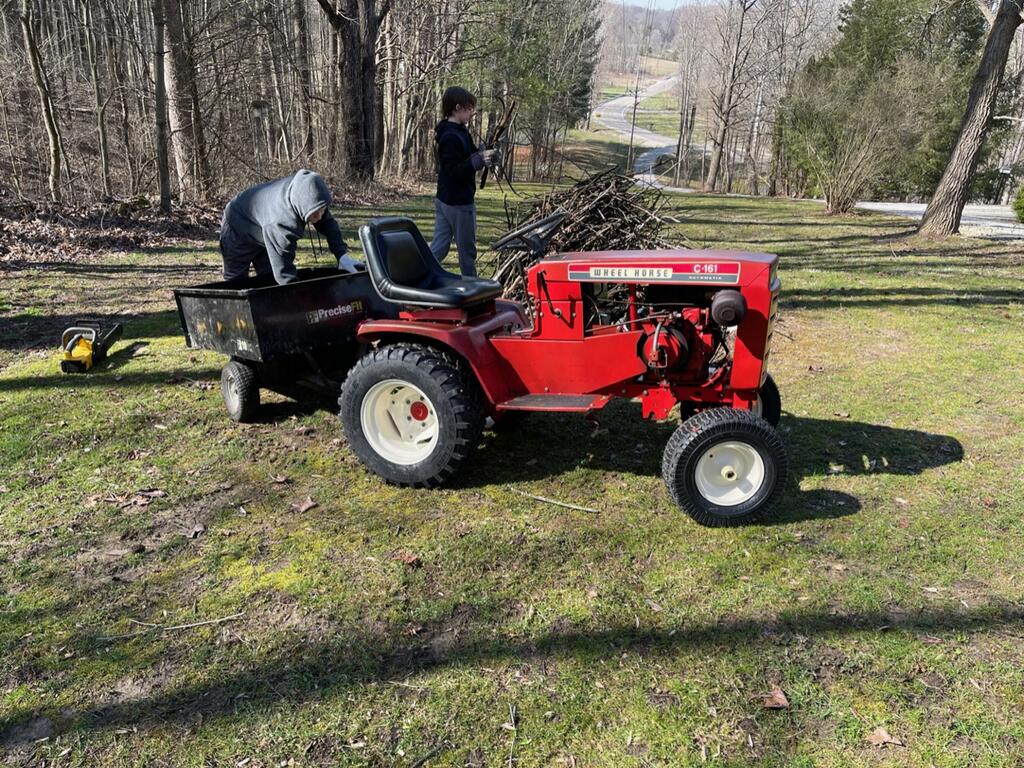

We had some help Saturday collecting sticks and cutting down a couple trees.
Those 2 really enjoyed learning how to operate that parts tractor.  It ran and drove real nice!

I am back to working on the c161 after a very busy year.  Finally got those Zach Kerber engine mounts installed!
Edited by TractorEd
  • Like 6
c-series don
Nice! Apparently everyone that installs them loves them. When I restored my C-121 and 161 I got new rubber ones which when new I think work just fine but they are expensive and I believe NLA.If I do another C-Series restoration I will definitely go solid mounts.

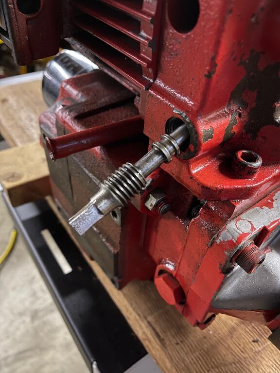

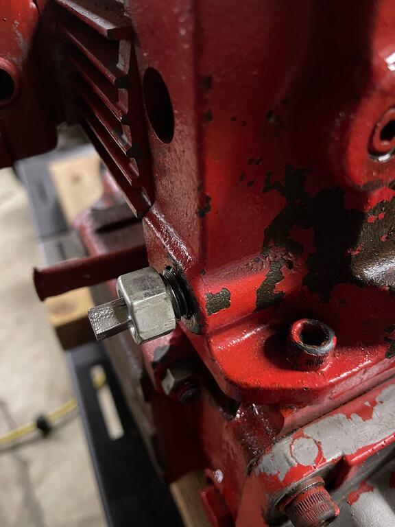

TractorEd
@ebinmaine
I pulled the tranny off so I could get at that push/tow valve better.
Was finally successful removing it using a pipe wrench.
Thinking about welding a nut on there; not sure JB weld would hold.
That nut is just sitting there for a visual.
Edited by TractorEd
I put J. B. Weld on mine because I didn't want to screw up the two washers/ Orings that are on the shaft. It's been holding fine.
If you have the welder handy and you're replacing the soft parts anyway that would be a better option.

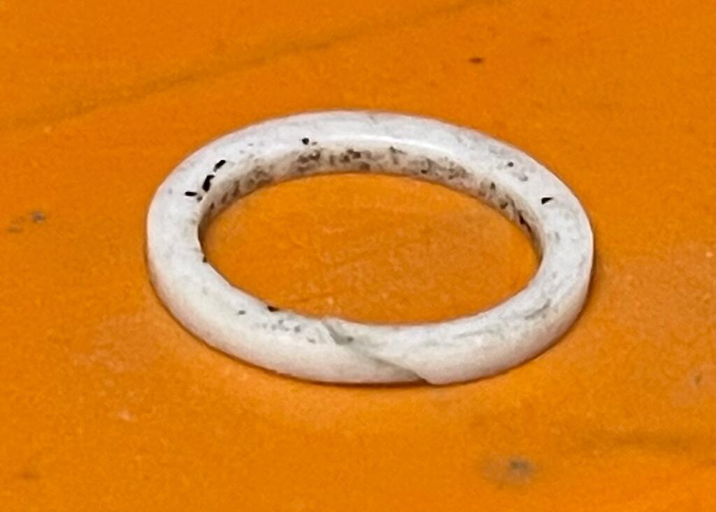

I have several replacement o-rings.  The nylon “spacer” has a (looks to me like) factory diagonal split in it that allows it to be removed and installed.
I said I needed to stop complaining about it, but my welder isn’t the best.  Not sure it would be hot enough for this task.
Adding this as info for me and others:
In other posts, the o-ring for this (WH #971012) says it’s a dash 905 (-905).  My o-ring kit uses R-DD codes and -905 cross references to R-05.  Which is AS568 number 012.  I’m not an o-ring aficionado so that took me a while to get to that R-05 code.
What to do about that welder…
Edited by TractorEd
Added nylon spacer pic
