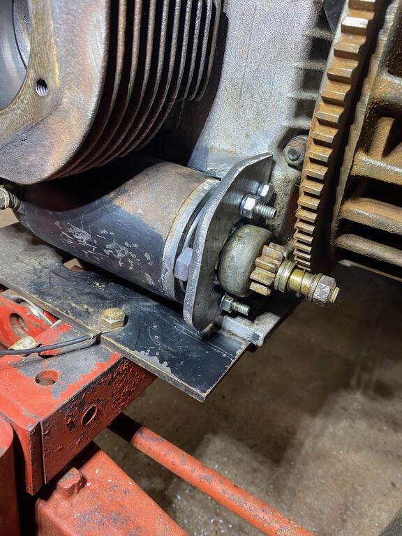

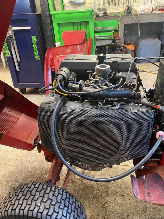

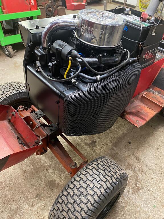

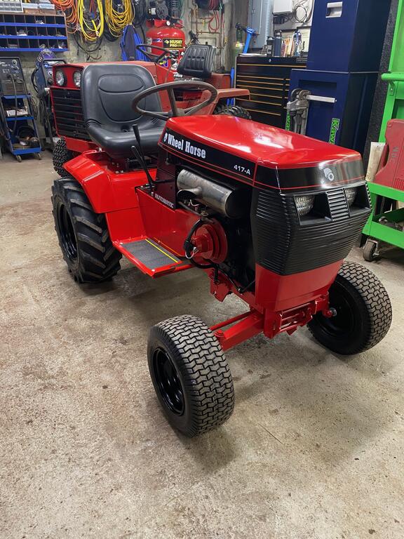

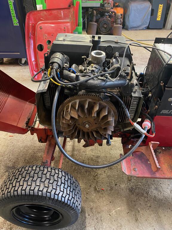

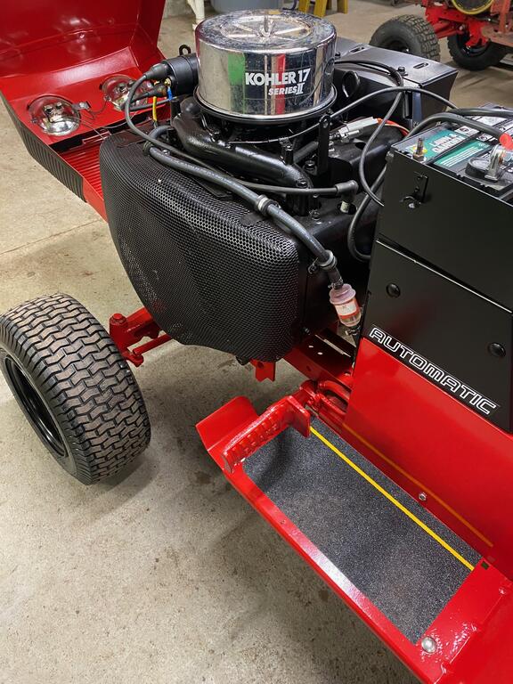

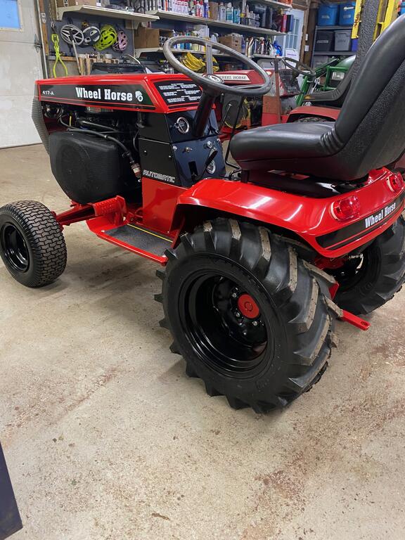

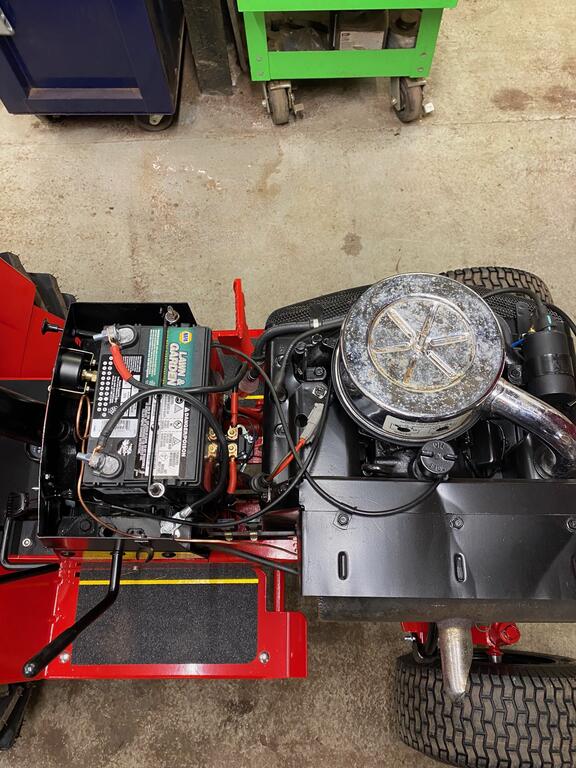

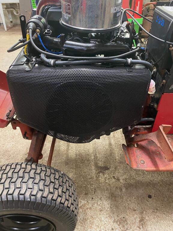

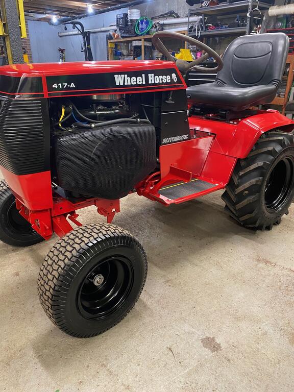

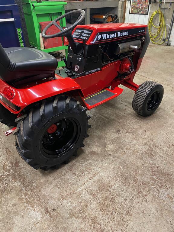

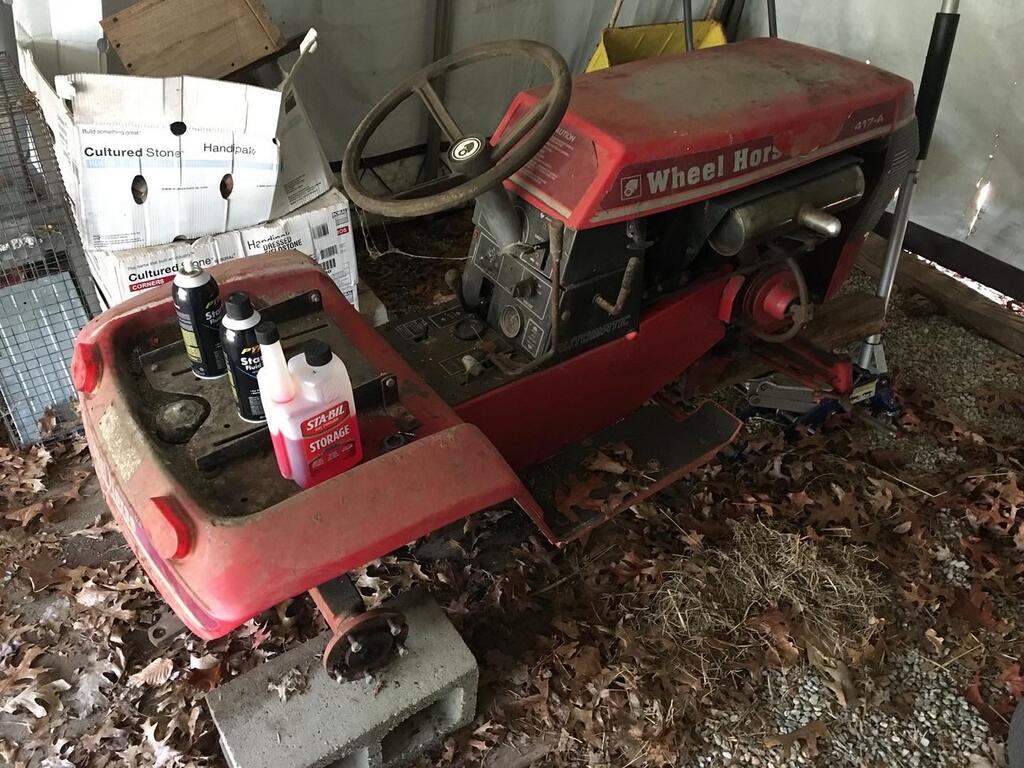

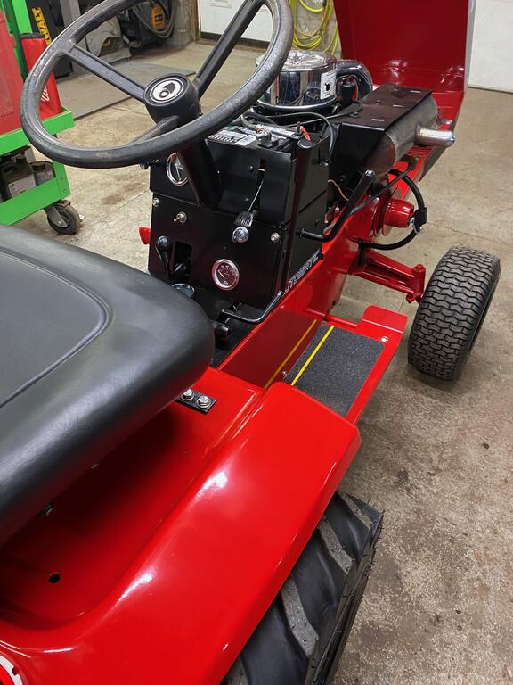

RedPower47 111 #1 Posted January 17, 2023 Picked this 417-A up 3 weeks ago in someone's barn, last time it ran or moved was unknown. When you put your mind to something its amazing what you can accomplish! Brought it home, power washed it, found the starter ears were broken off the block so I repaired them, Also #2 cylinder had bad head gasket, did a full tune up on the KT17 while I was there. Added an oil pressure gauge to help tell the life of the engine. cleaned the fuel tank and put all new lines with a rebuilt carb. The old kohler fired off within 3 cranks and is putting out about 60IBS of oil pressure. Re wired a lot of loose ends and splices that were cut in over the years. Brand new Carlise turf savers up front and True Powers in the rear. Stripped every piece down to bare metal and primed and painted all in 3 weeks! I absolutely love this stuff. 4 22 2 Share this post Link to post Share on other sites

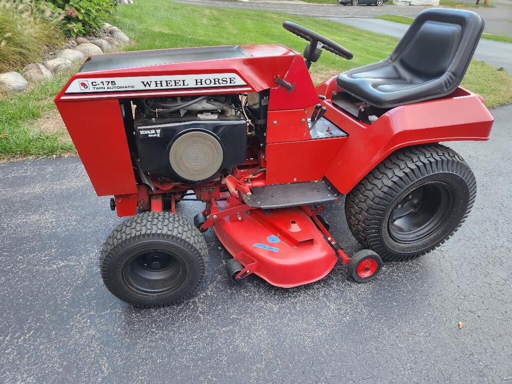

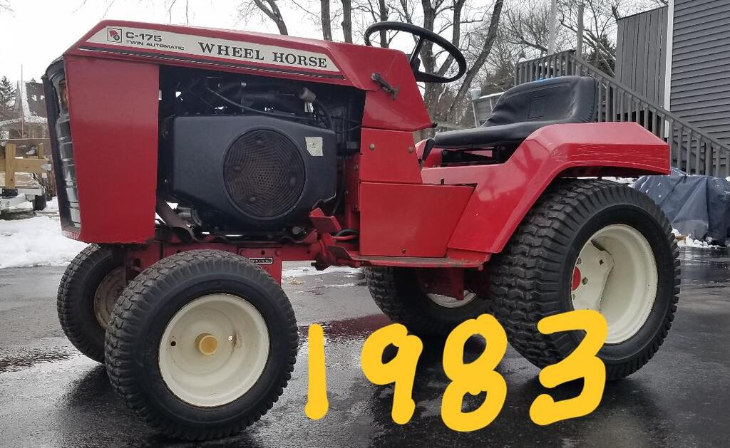

Brockport Bill 2,498 #14 Posted January 18, 2023 53 minutes ago, RedPower47 said: @Brockport Bill Thanks Bill! nice looking 175 you have there. here's the '83 Series 1, C175 ----------- i've never tackled the "full restore" like you did -- you did awesome job - i've just done partial mechanical and body 5 Share this post Link to post Share on other sites
Tonytoro416 1,393 #15 Posted January 18, 2023 Beautiful tractor. Saved another one. What color red did you go with there ? 1 Share this post Link to post Share on other sites
RedPower47 111 #16 Posted January 18, 2023 7 hours ago, Brockport Bill said: Another nice looking tractor Bill! and there is nothing wrong with fixing things up here and there, i have done that plenty of times where you just take the bad parts of the body and freshen them up a little with some new paint! it takes a lot of dedication and motivation to do a full tear down and restore and a lot of people don't have the time or patients. Share this post Link to post Share on other sites
RedPower47 111 #17 Posted January 18, 2023 @Tonytoro416 Tony, I used Rust oleum Sunrise Red, i know a lot of guys use IH Red or Regal Red from Rust oleum but i think the sunrise is just a few shades brighter and looks a little better but that's just my opinion. I have painted plenty of Farmall's in my life and the IH red is definitely darker. 1 Share this post Link to post Share on other sites

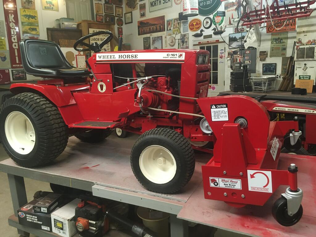

c-series don 12,609 #18 Posted January 18, 2023 I too, am a fan of the sunrise red! I think for some reason though regal red looks better on the 60’s and earlier tractors. I’m not sure why? Here’s my C-161 with E-Z Rake dethatcher and C-165 hiding in the corner of the picture, both in sunrise red. 3 1 Share this post Link to post Share on other sites
RedPower47 111 #19 Posted January 18, 2023 I agree Don, I still like the look of Regal or IH but Sunrise just gives it a little more shine to it Nice looking 161 too 1 1 Share this post Link to post Share on other sites
