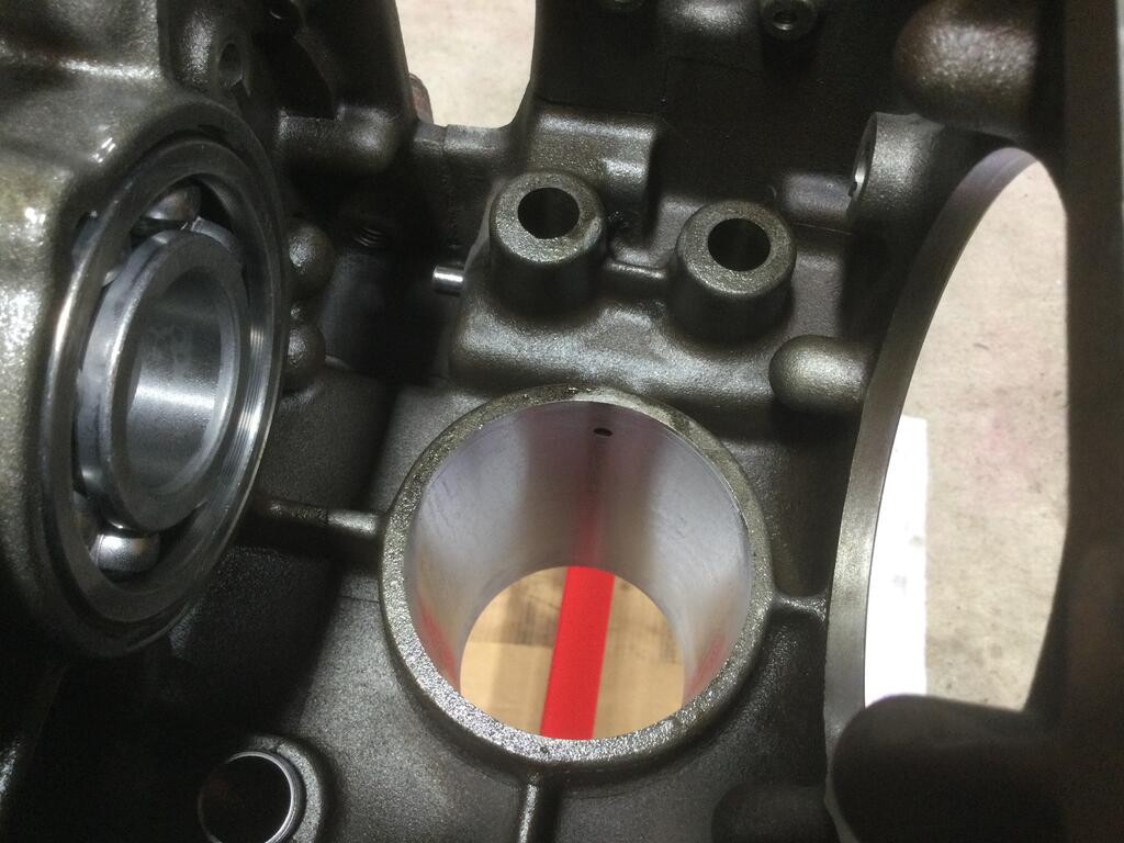

953 nut 66,542 #5 Posted December 31, 2022 5 hours ago, Bob Nakon said: I wonder if they can be left in the tractor? I watched a friend rebuild his engine and he left it in the tractor. About the only thing you can do while the engine is in the tractor is an ignition tune up. The base/oil-pan needs to come off to get at the rod bolts. You can save some money by doing the disassembly work yourself. Depending on your skill set and the tools you have. This thread will give you some idea of what needs to be done for a proper engine rebuild. 2 1 Share this post Link to post Share on other sites
