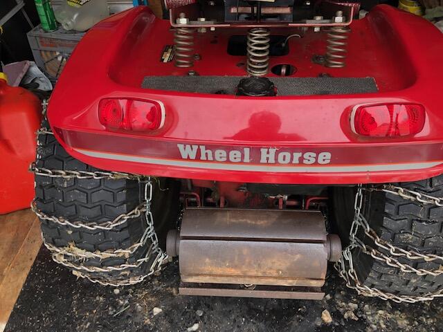

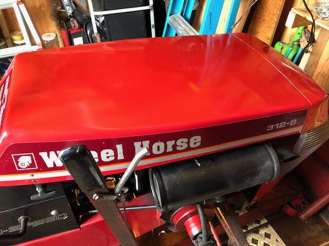

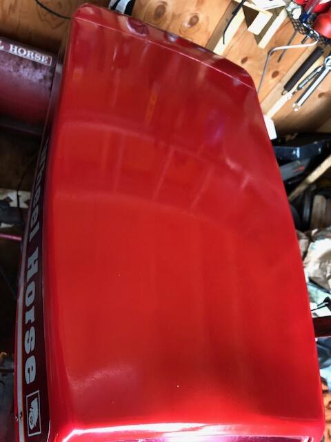

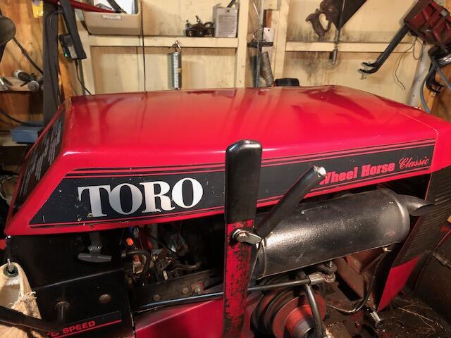

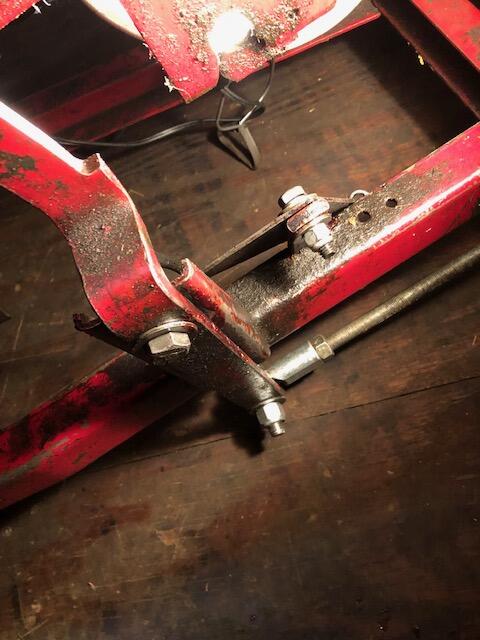

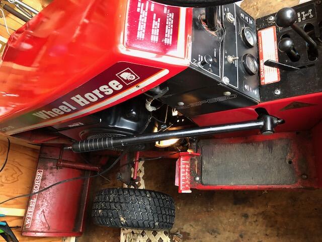

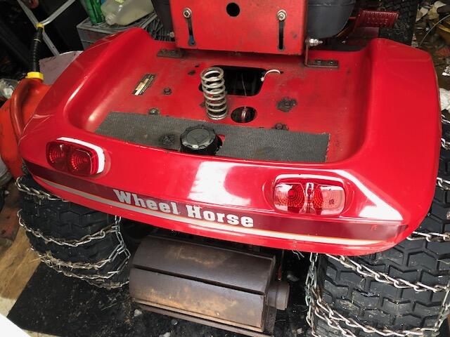

peter lena 9,845 #1 Posted December 15, 2022 often refer to aerosol lubrication on dry / faded / neglected paint , basically feeding / recovering that paint . let the oil soak do all the hard work, the related pictures , went thru a 2 day spray , soak wipe down , do it again phase. after 2 soaks , there was a definite color base , used a 6" palm buffer with cleaner wax , paint just came right out as you see it , typically just rub them down wit clean cloth , lubricant , thats what they look like . amazing to me how once recovered , how easy it is to keep it that way . also show a heim joint to plow blade lever rod, 3 7 Share this post Link to post Share on other sites

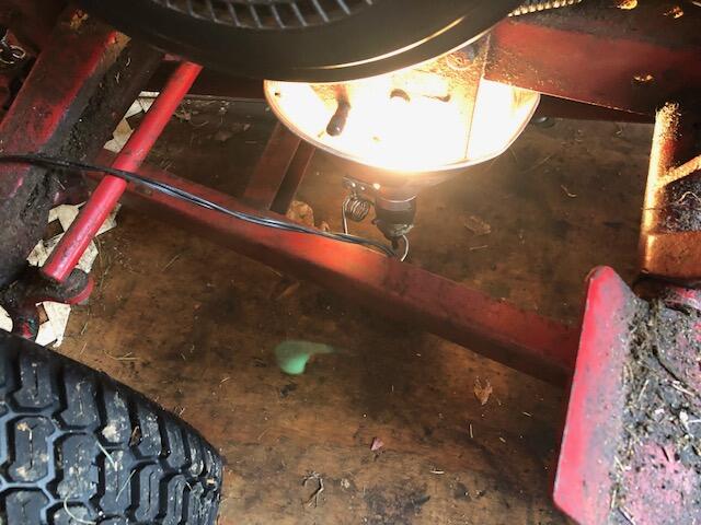

peter lena 9,845 #3 Posted December 15, 2022 @ri702bill also note old type incandescent rough service bulb standing vertically under center frame mount , just gives off enough heat to make a quick start cold shed difference , pete 2 2 Share this post Link to post Share on other sites

peter lena 9,845 #6 Posted December 15, 2022 @SPINJIM like Kroil , marvel mystery , also use 2 2-6 dielectric aerosol spray , won't harm plastic. once you start doing this easy , spray down , let sit a day , wipe down ,clean cloth , till dry . do it again next day , you start to see results , note , NEVER use a rough scrunge pad or sandpaper to remove paint , let the oil do the conversion , doing this in hot weather , with warmer metal , you can watch it change . also do your plow blade , that slick finish stops rust , and moves snow without effort . as said , once done , a simple oil lubricated cloth , freshens it right up , beads water like a duck , pete 3 1 Share this post Link to post Share on other sites

peter lena 9,845 #11 Posted September 12, 2023 @gwood its so slick, that the regular dusty road pick up , on the trunk area , is not even there ! always trying something , also have a 6" electric palm buffer , that makes buffing very easy , used to detail cars , in my other life , Pete Share this post Link to post Share on other sites

peter lena 9,845 #14 Posted December 16, 2024 @gwood sorry about any confusion , but if I mentioned bolt , probably related to the , plow STEERING QUADRANT . the hand squeezed lever , directly related to that , is squeezing the slide pin spring , that is pushing the entire functional movement release point , slide pin , at the back of the quadrant . its the detailing and lubricated related points , that make this swing with little to no effort . often refer to , setting this up , on 2 milk crates , off floor 1 in the back , at rear of frame , front 1 just behind plow swing mount area , roller stool around it , as someone else , moves the squeeze lever , thats where it will show you , its hang up areas . often dry / rust , will stop movement , also squeeze lever , is not pulling related wire rod , to quadrant slide pin , enough , making it hang up at rotation point . done a number of these , you have to verify , function at every stage , or you will not get it , often just detailing , lubricated , step / step motion . get a helper , so you can see what's not , fully moving at every stage , red grease , pete Share this post Link to post Share on other sites
