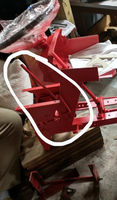

ebinmaine 79,646 #4 Posted December 14, 2022 1 hour ago, Kblack said: side lever 3 minutes ago, 953 nut said: from 1965 to 1980 were Sundstrand and have the center shift lever Methinks that depends on ones idea of a side or center.....? My 1975 C160 Automatic has a motion control lever I'd consider to be on the side. Circled in white .. It certainly leads to the center, yes. 1 Share this post Link to post Share on other sites

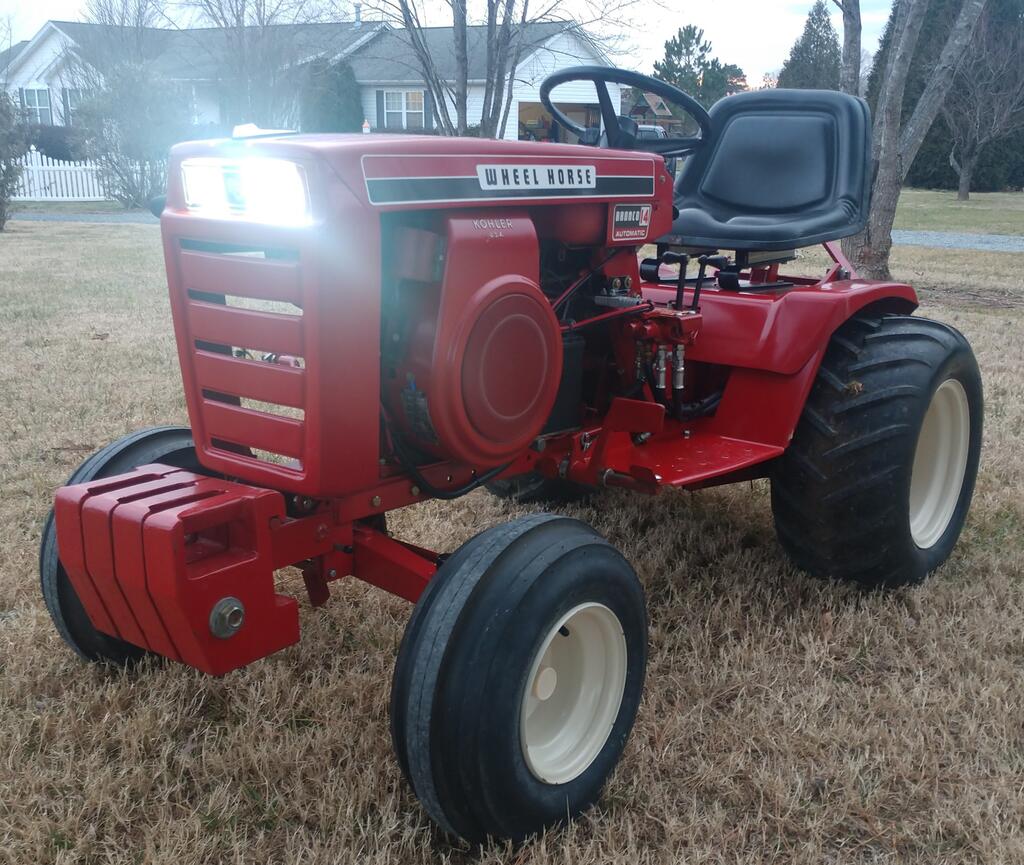

kpinnc 18,740 #7 Posted December 14, 2022 1 hour ago, Kblack said: 14hp automatic That's a very capable tractor. Direct successor to the 1971/72 Bronco 14- one of my personal favorites. Congratulations! 3 1 1 Share this post Link to post Share on other sites

Kblack 12 #13 Posted December 14, 2022 3 hours ago, kpinnc said: That's a very capable tractor. Direct successor to the 1971/72 Bronco 14- one of my personal favorites. Congratulations! That thing is beautiful! Double hydraulics. I like it 3 Share this post Link to post Share on other sites
daveoman1966 3,884 #14 Posted December 14, 2022 (edited) I had a 73 no-name 12hp Auto with the Motion control lever in the center of the hoodstand...like yours is. Its a PITA to operate...just awkward. So, after doin' a little digging, I was able to REMOVE that center lever and replace it with a right SIDE control lever. I actuall did this with mine and for a friends 16hp Auto. It involves: 1)pull out the original lever with friction components. 2)transfer those friction parts to the new side-control lever. 3)...MAYBE--- Trim a small slot out of the belt cover to accommodate the vertical side lever. 4)reinstall the new side lever, with fiction parts, in exactly the same place as the original lever. DONE. You'll need a side lever like this: I have two of them. you MAY even consider swapping out the ENTIRE Hoodstand. NOTE the the side control lever is a WELDED assembly with the square BOX containing the friction parts. Edited December 14, 2022 by daveoman1966 1 2 Share this post Link to post Share on other sites
