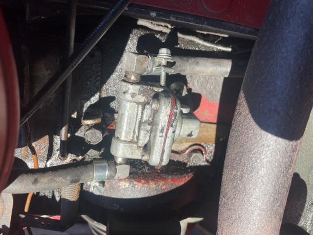

AHS 1,703 #1 Posted November 29, 2022 @ebinmaine @OldWorkHorse I used my last steel fuel pump on a tractor that I’m gonna be selling. On eBay, if you type in “K301 fuel pump” they bring up these cheap plastic fuel pumps. I realize they are not making steel fuel pumps anymore. What are vacuum ones? They have to have a vacuum hose? I’ve heard of electric ones. Do they have a block off plate for the fuel pump once you use an electric one? What do you just wire the electric fuel pump off “I” on the ignition switch? The reliability of electric vs vacuum vs stock? I’m full of questions! I wanna see what you have, post pictures please! 2 Share this post Link to post Share on other sites

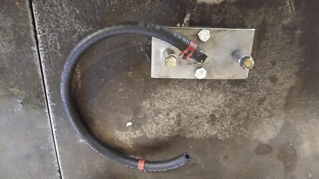

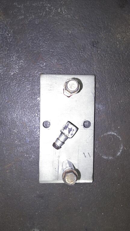

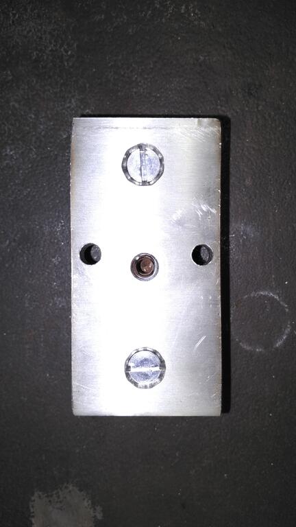

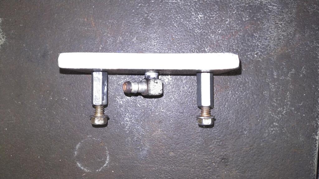

Bill D 3,213 #6 Posted November 29, 2022 I started using vacuum pumps awhile ago. I made a plate to mount it to the engine in place of the stock mechanical pump. Works great. I use either Kawasaki or Briggs pumps. They are made in Japan by Mikuni. If you're going to do something like this use a high quality OEM pump to lessen the chance of having gas in your crankcase oil. 6 Share this post Link to post Share on other sites

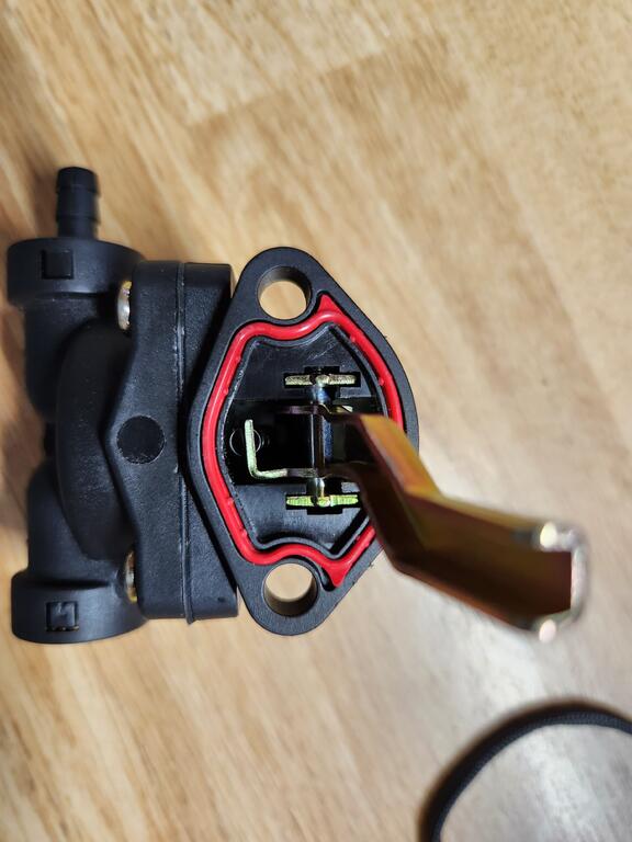

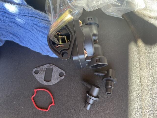

pacer 3,181 #15 Posted November 30, 2022 This is the type I've had problems with, short life, dead out of box, etc This type I have had good luck with, no problems. @953 nut Have been seeing that type you show lately and may try it next time. 1 Share this post Link to post Share on other sites

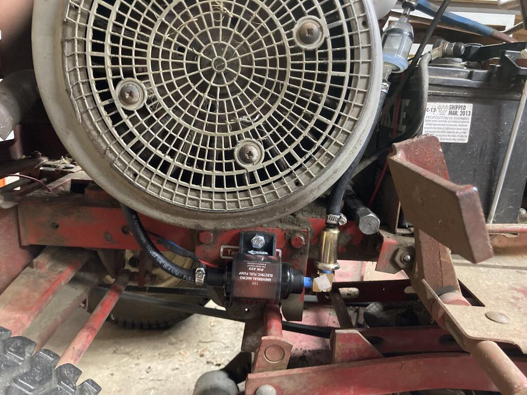

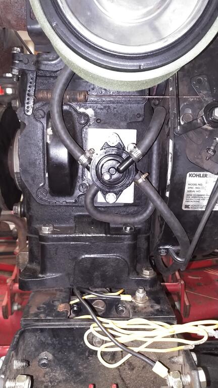

oldlineman 1,821 #18 Posted November 30, 2022 Very good up grade for many reasons such as Richard has mentioned. Here is how I did mine, no regrets fast starts. Bob 4 Share this post Link to post Share on other sites
